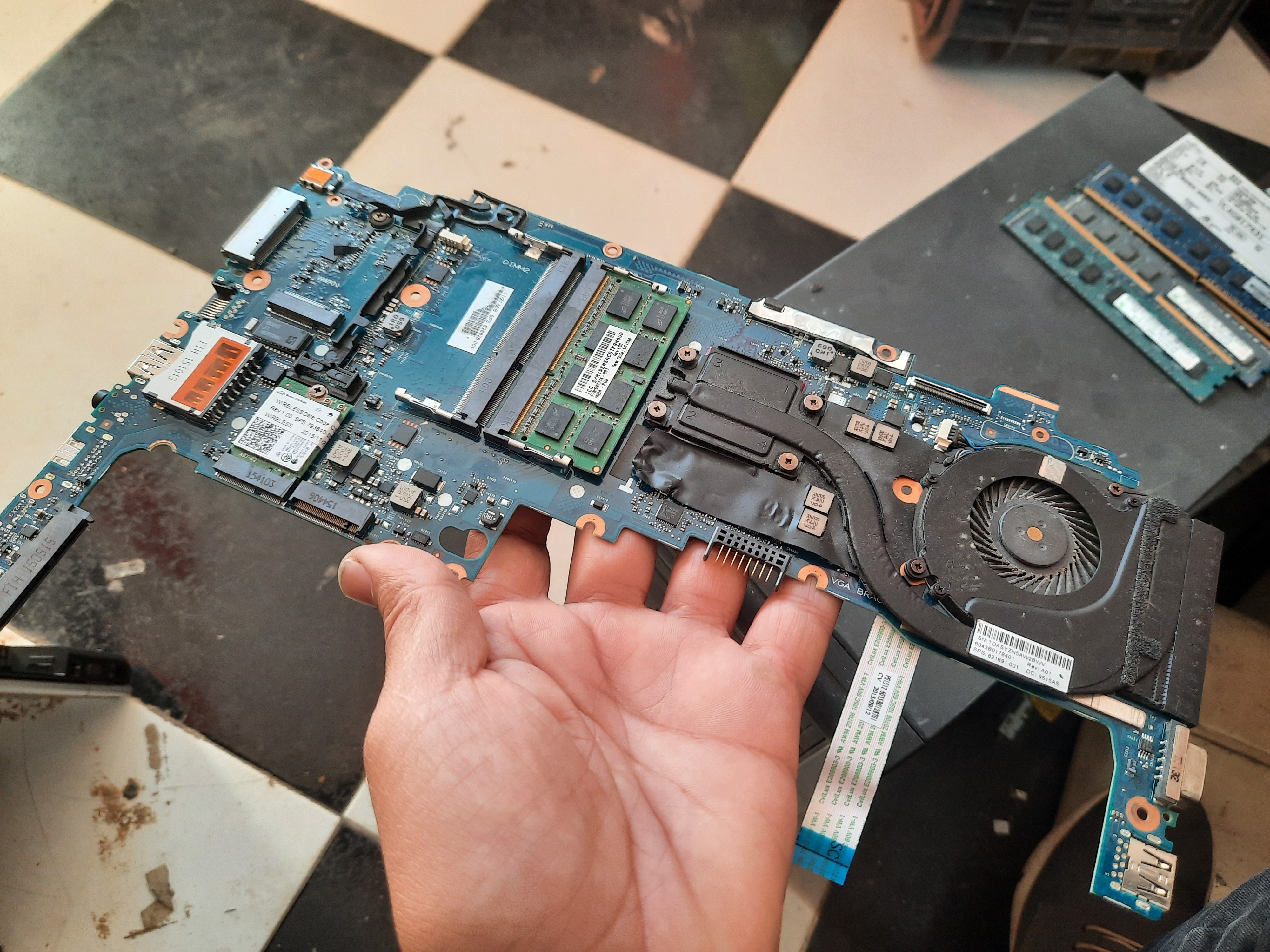

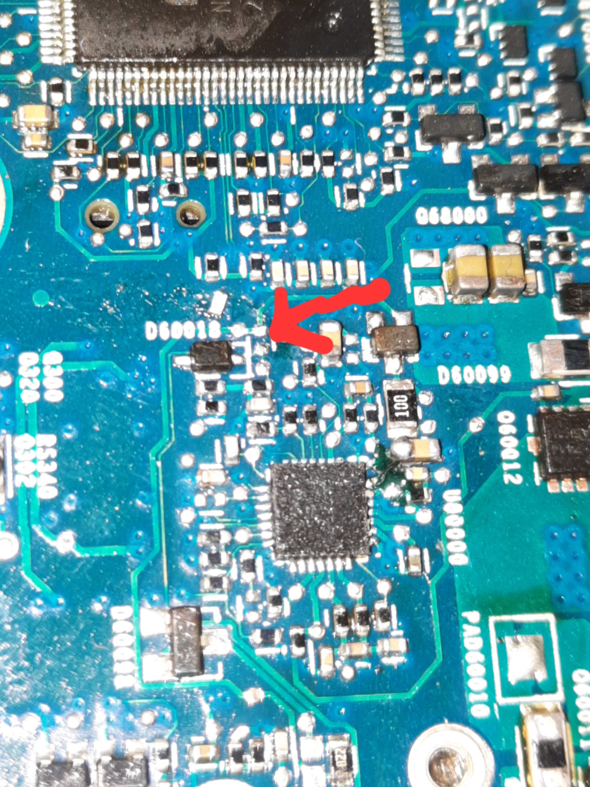

    Hello freind i have hp elitebook 725 g3 White liquide damage
    after cleaning the board i find à damage resistor white no value i test it not reading in multimeter
    could some one tell me the value of this resistor
    Thank you

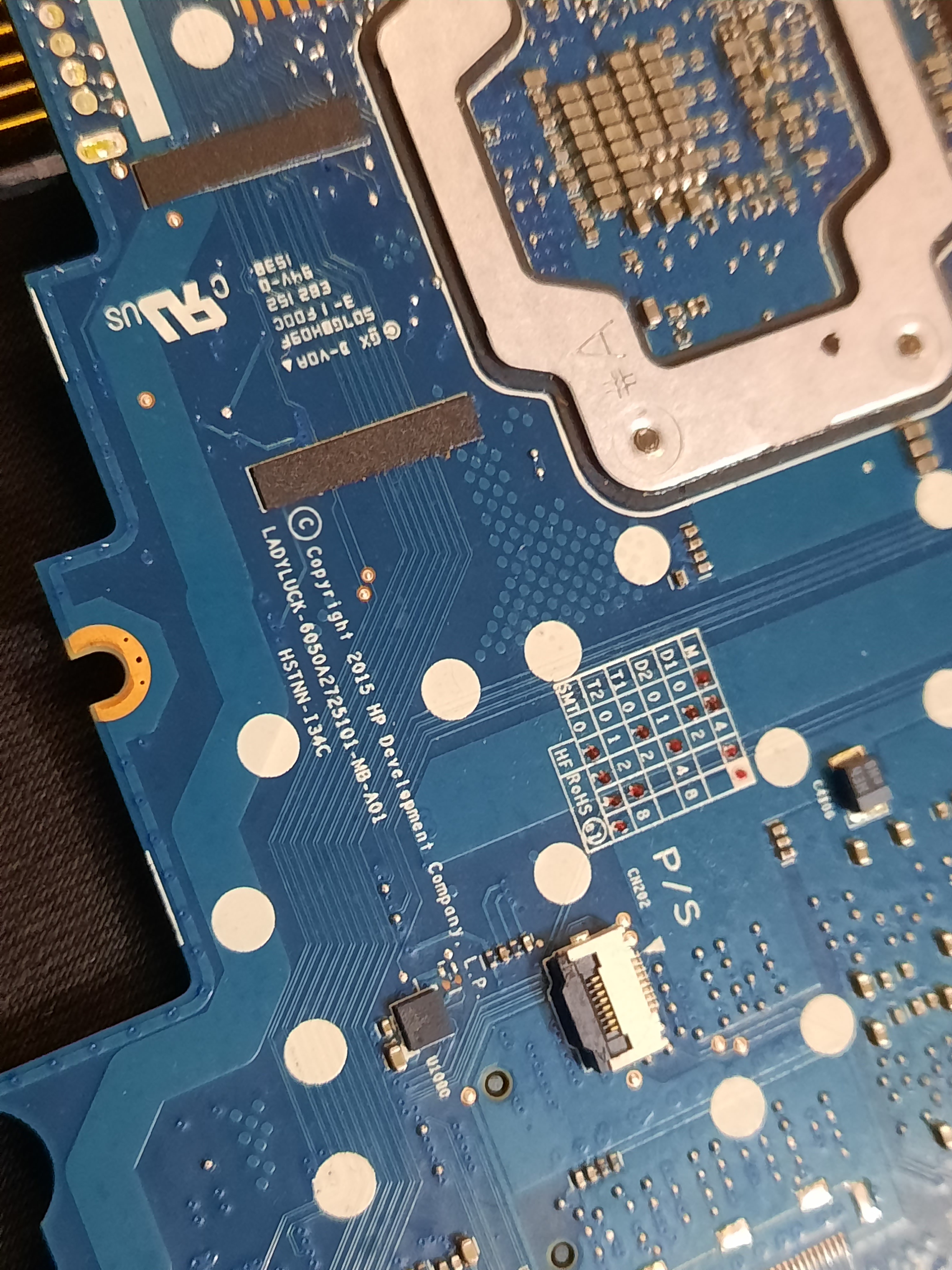

      model of board: LADYLUCK-6050A2725101-MB-A01

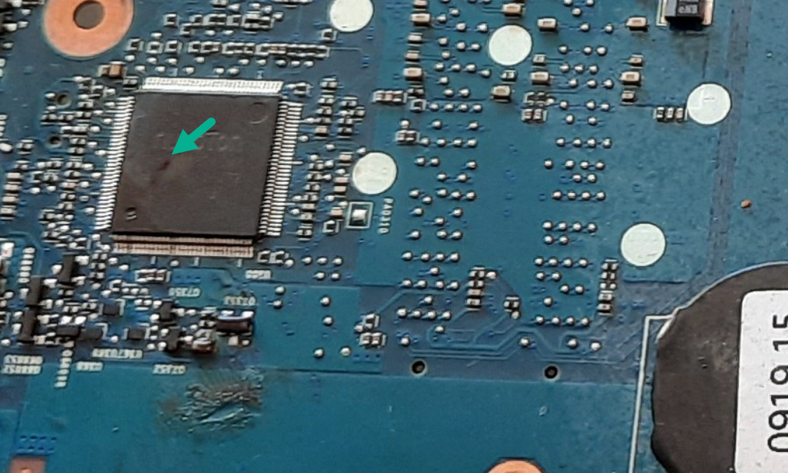

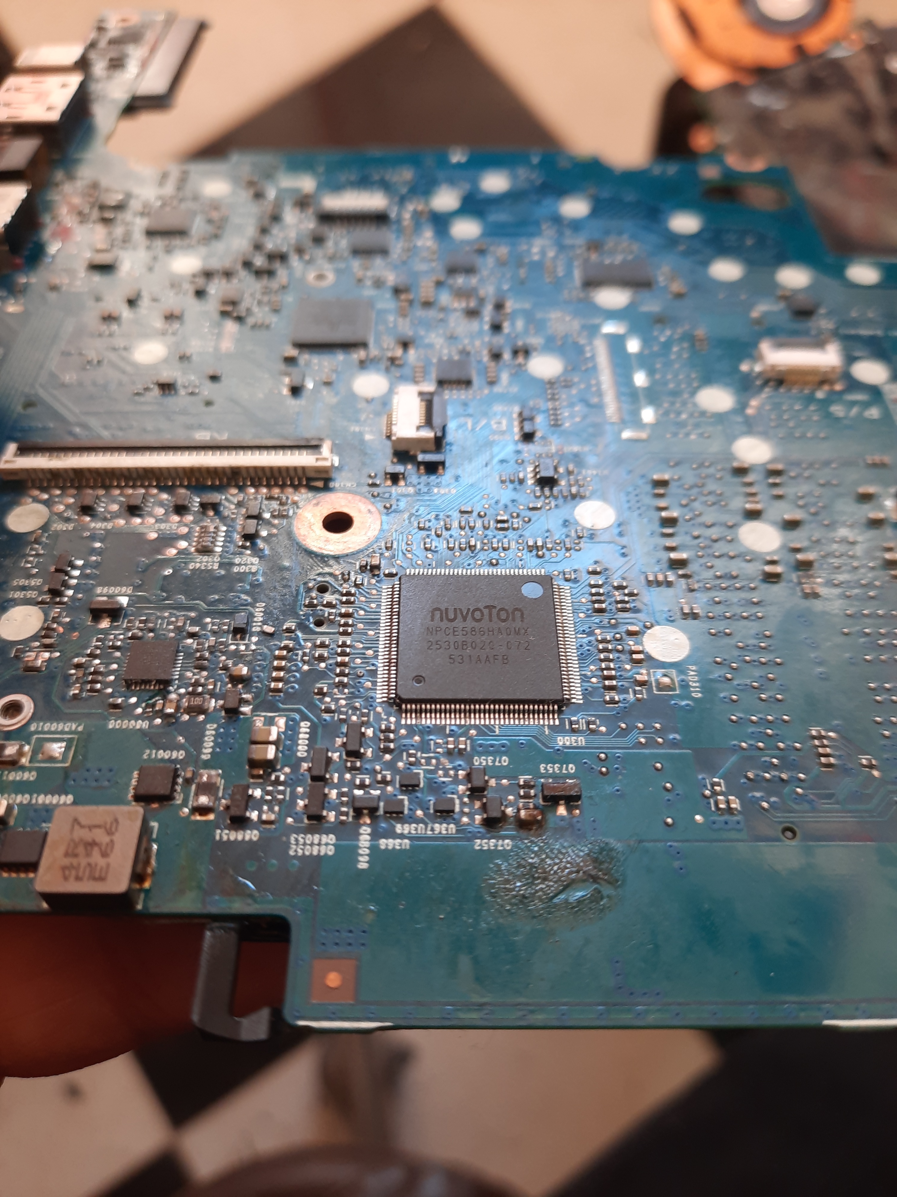

        See attached. Is that a defect in the surface of the EC chip? If yes, this EC is very likely to be defective.

          Thank you for helping no its just rusin not clean
          There is no chort in motherboard just wather damage
          this resistor i want to find his valeu to replace it

            Since no info is available check the resistor is connected to which IC. to me it seems like charging IC REGN pin. You can then proceed to similar schematic with same charging IC to found the value of resistor.

                Carefully inspect each square chip on the board for their topside markings. Hunt for one with 'BQ' or 'TI' in the part number. Post clear pics of the chip. This may be your charger IC on the logic board. This part should be close to where the power adapter mates to the logic board.

                  yes its (BQ) charging ic
                  laptop its good after cleaning
                  But this this resistor is damage
                  I don't Know his valeu i want to replace it
                  i think 10k resistor butte i'm not sur

                    Trace the pin which connects to this resistor and charger ic. Then review sample schematics that use this charger ic to learn the resistor value.

                            I search for bq24780s schematic and i find resistor valeu its 100k resistor
                            i put 100k resistor its in (ACDET) pin
                            no power the mosfet has no signal bq24780s to switch the 19v i make bridge wire and BOOM🔥 laptop turne on butte not charging battrie after i replace bq24780s and BOOM🔥 again😅 and laptop start another life thanx to ALL
