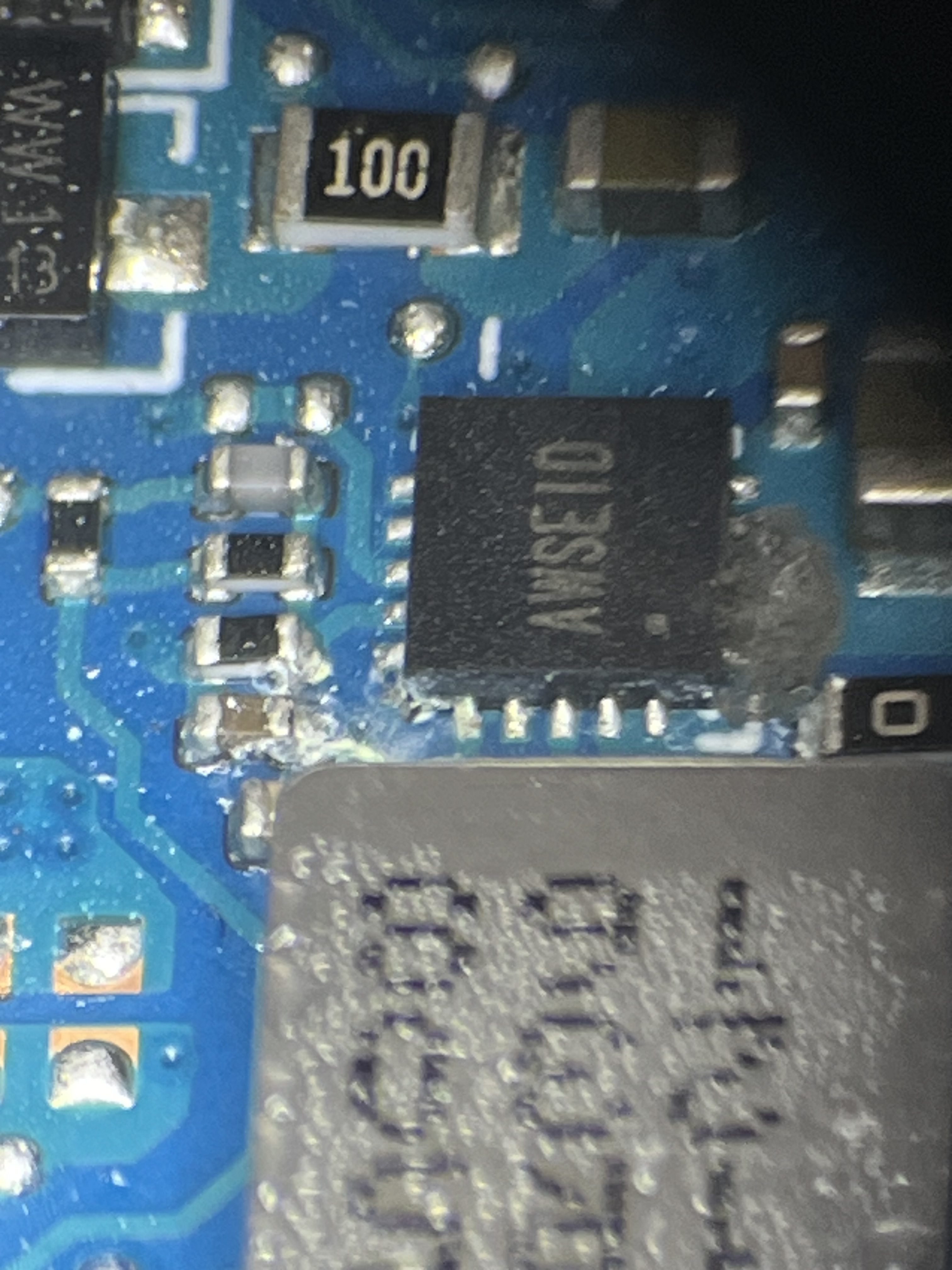

    Hello, i got an HP EliteBook 840 G8 that has water damage, and i found this component has damage on it U60600. What is that component? I have schematics and boardview and the par no is:
    SINERGY_SYV128RAC_QFN_20P i cannot fount it anywhere. Is this component have some other name?

    Silergy SY8288RAC
    Just found this amazing item on AliExpress. Check it out! US $2.71 | 5pieces SY8288RAC SY8288 (AWS5MZ AWS...) SY8288BRAC SY8288B (BAB5ZD BAB...) SY8288CRAC SY8288C (BAC7LN BAC...) QFN-20
    https://a.aliexpress.com/_mPSOv5K​
    Be sure to confirm the ‘AWS’ marking code with the vendor before ordering. Others are on AliExpress.

      What do you ment by confirming the AWS marking code?

        The part is sold with different configurations. The original part is written the ‘AWS’ prefix. You must state the same details to order the exact part. You can show the vendor the top side pic before ordering. Otherwise you may receive the wrong product.

          Ok i will contact the seller, thank you
