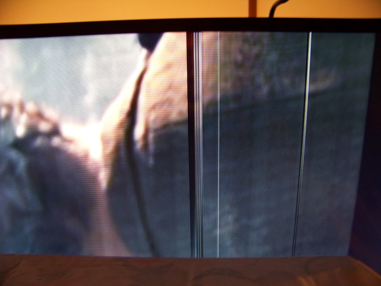

                      So... in time it took to write the preceeding post and the set was left "running", I went back (from upstair to basement work area), the set reverted to the 2-5 flash... :-( However, using the remote and hitting the power button twice (once for "off" I guess and then to turn it "on"), the set came back up, running again like it did before, perimeter lighting, menu screen seen (strobing effect), etc.
                      I am wondering about the strobing as I have no input so perhaps an input my help stabilize the video output... ?
                      Anyways, some progress but not there yet.
                      Ideas on what to do. My guess is that I may try getting access to the other ends of the ribbon cables at the panel connects and cleaning those.

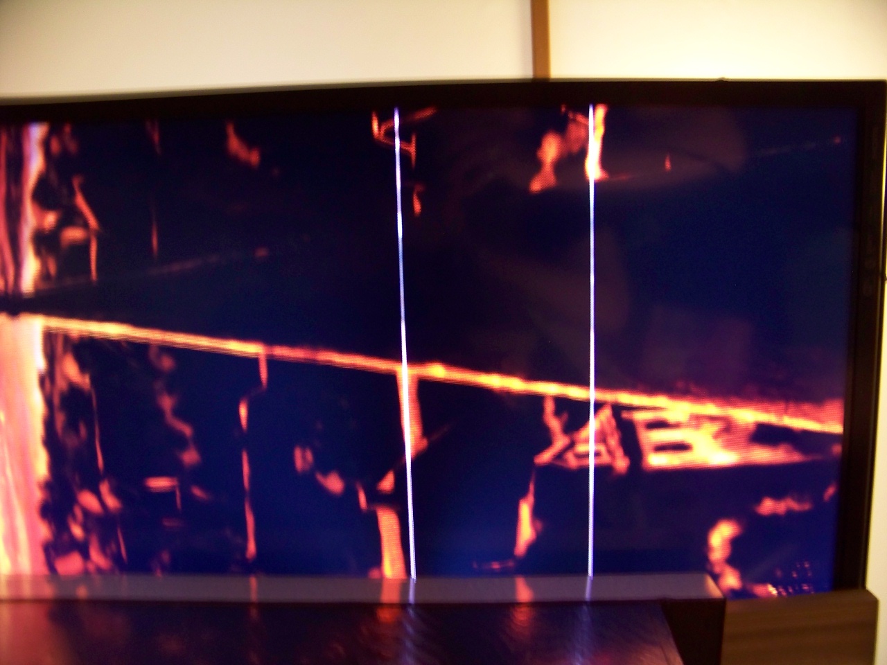

                        Seem to have "lost" being able to have all tcon cables attached after it had shut down in 2-5 error again. Now can only run every time with 3 cables, either right or left unplugged, gets the set up into "run" without code 2-5 happening. I "ventured" into trying to clean the other ends of the two cable in question... they are attached to boards on the rim of the panel. Might have been a mistake as they are hard to get at without disassembling the bottom portion of the panel (don't really want to go there). Anyways cleaning didn't help and further it appears to have added a "line" across the screen. When the left cable is off, before there was a prefect set of vertical lines on that side of the screen. Now, the same vertical lines are there BUT there is a small (one or two pixel wide) line horizontally thru those lines. That "horizontal error" wasn't there before I had attempted the cleaning of the opposite end. Attached is a couple of picture of the vertical lines (and error) along with a picture of a "Menu screen" when the oppose cable is removed. The menu screen shows larger portions of "horizontal errors". I am not sure if those were there earlier because I never looked that close because of the "surprise" that the set even turned on.... but I suspect they weren't.

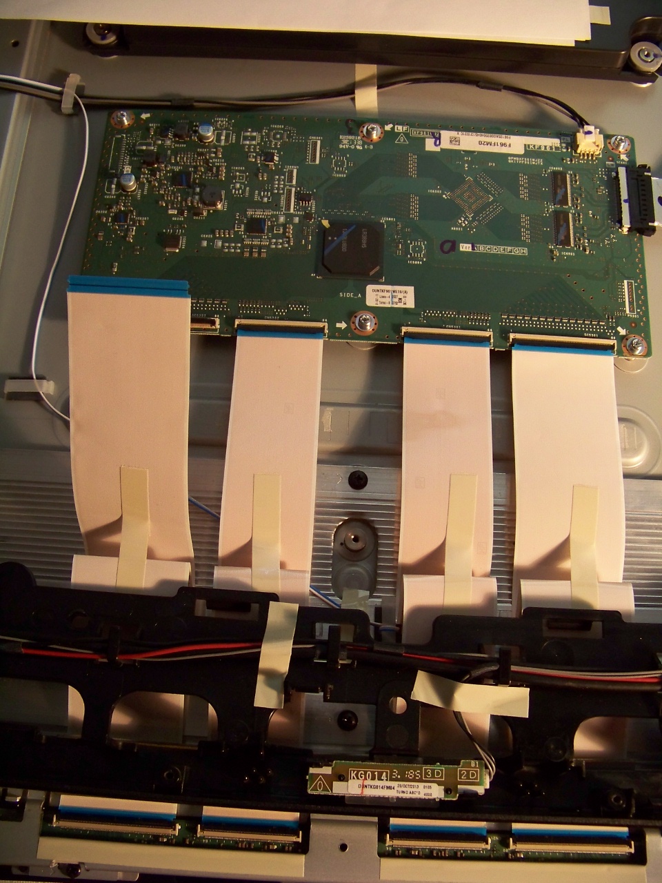

                        I feel that some of this reflects the potential of poor connections between the tcon board and panel but not sure what is "normal" display for an lcd panel when one cable is detached. I know from some reads that people "trouble shooting" other lcd screens have suggested reseating cables XY ???? or otherwise to remove lines and such. Is this appropriate in this case... just poor seating / alignment / connectivity?
                        The picture of the tcon board and cabling shows the disconnected left ribbon cable and with a portion the lower plastic panel frame removed to access the other cable end. To get full access to the panel end, is significant work removing metal frame members.
                        Another question, is there a technique for cleaning the contacts on the clamp down ribbon connector without damaging them or the board?

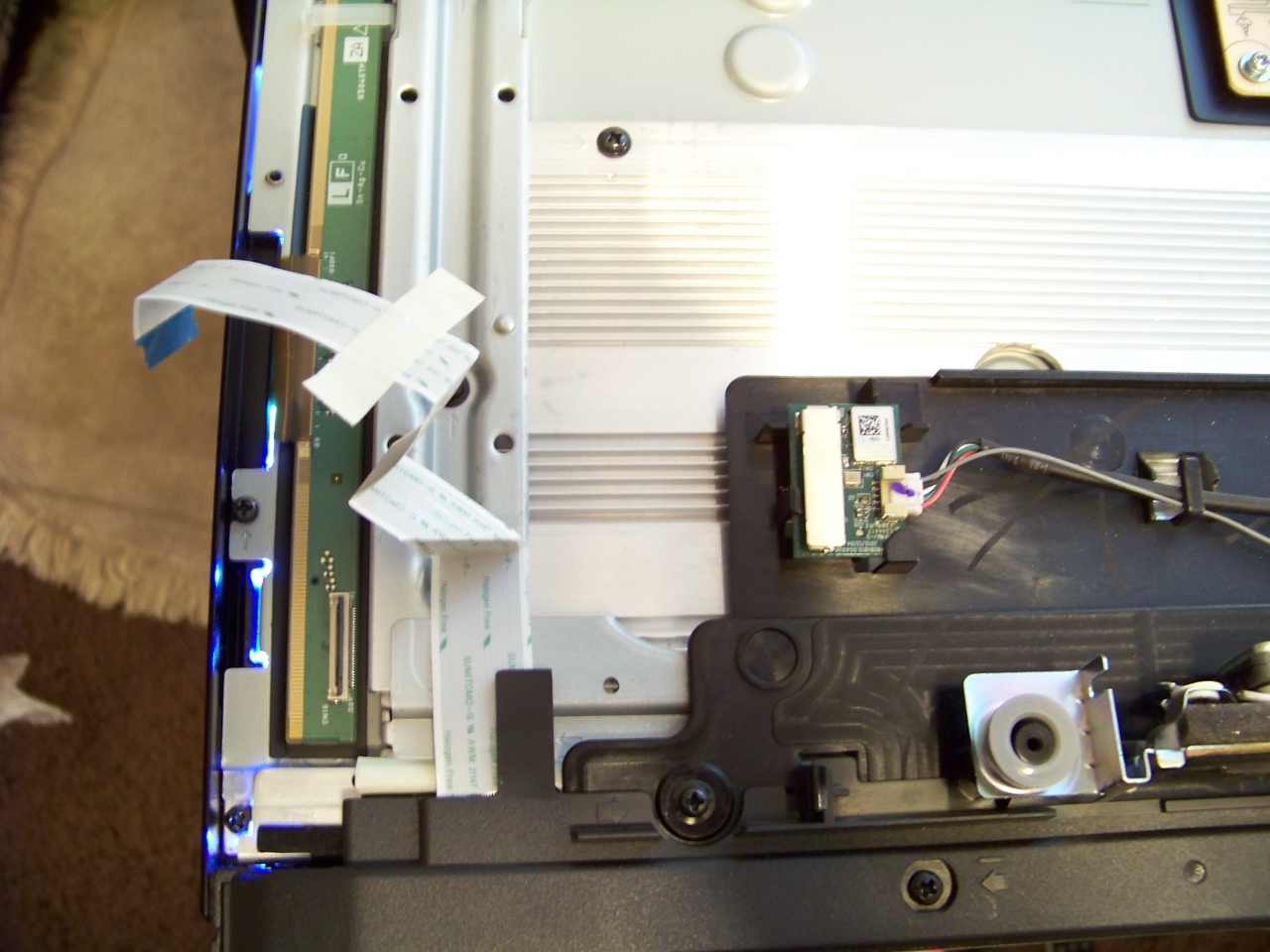

                              I took off the lower support rail to access where the Tcon cable connect in the boards around the edge of the set. There are four boards about 10in long by about 1 in wide. Two tcon cable connect to one board and the other two connect to the other board. The outlying two other board are interconnected to the those with removable "flex cables" (I think that what they are referred to as). The four boards have "bonded" flex cables that leave the boards in various place to connect to the panel. I found that if I brushed my finger across one of those cables, I could cause a set of vertical lines to appear on that side of the screen. ???? Doing the same to all the other flex cables does nothing to the screen. I don't know enough about how the buffers move the data towards the driver to cause "pixels" but it seems strange that one particular "bonded" cable can cause that effect. I can't see any direct issue with the "bonding" or the cable itself.

                                • mmartell
                                  • Oct 2013
                                  • 3189
                                  #36
                                  Re: Sharp LC-70LE757U Flashing 2-5 :-( can it be saved economically?
                                  Originally posted by budwich
                                  Its more of a learning exercise now although hope is still in the background.
                                  Now that you've been messing with that obviously faulty tab plug all tcon ribbons in and see if the set starts normally. That bond may be your problem or maybe just ANOTHER problem the set has or was going to have had it not quit when it did.

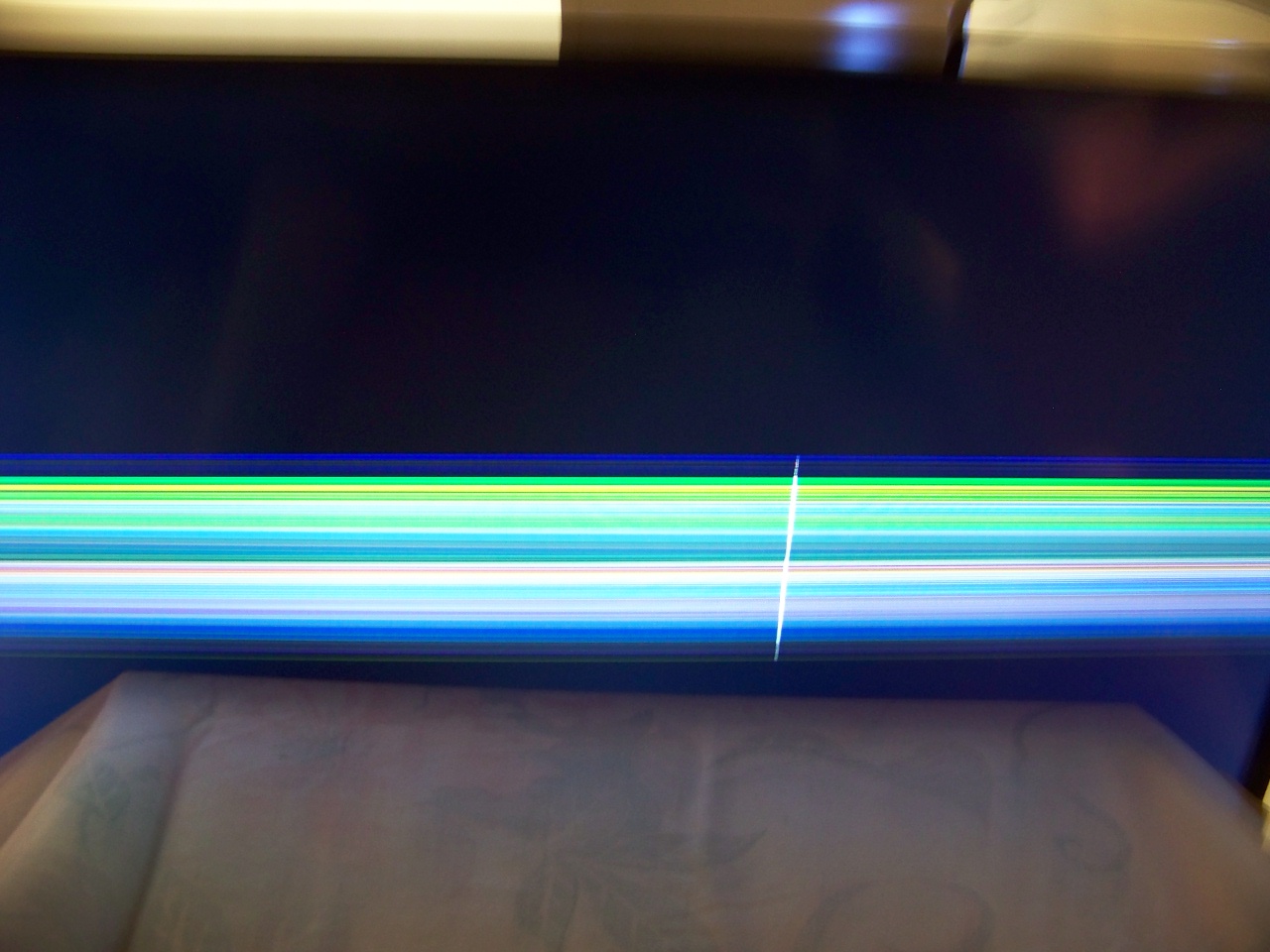

                                      Last week, after re-assembling the lower half of the framing and mechanicals there abouts to get access to the various bonded cables and other "frame boards" (ie. boards around the frame edge) and connectors, I tried various power ups (ie. 2, 3 , and 4 tcon cables). Basically, I couldn't get any further than 3 cables connected which gave me a "run" set but of course, missing half of the screen. When ever the 4th cable was connected, I ended up in a 2-5 code ... :-(
                                      Fast forward to the post holiday weekend (hope people had a good one), I was going to start putting the full back on but thought I would power up the unit one more time. There were just 3 cables connected so I was expecting it to "run", it did. No surprise. I used the remote to power it off (not unplugging the main power). I then decided to plug in the 4th cable because I didn't want the cable freely dangling once the back was replaced. Plugged it in and then decided to try one more power up. IT DID. So now I have it powered up and feeding it an SD video and audio signal from a dvd player.
                                      The attached picture is a still of the screen. The video display is still kin of doing a "scrolling" type effect, almost liking a ground loop hum type screen or like an old set that has lost one of its hold (vertical?) but the picture isn't flipping just a "rolling pulse" of "brightness" moving vertically across the screen.
                                      There are some groups of horizontal lines in the middle and lower portion of the screen.
                                      What is the cause of these? Is it something that is repairable or still a sign (good or bad) that the panel is not operating properly? Is it possible that the long "rest" is a sign that perhaps the power supply is marginal and that once some components were unpowered for a bit, that it is running "better" for the time being? Other reasons? My hopes are a little higher again. I am not turning the tv off... :-)
                                      Thanks again for any further guidance.

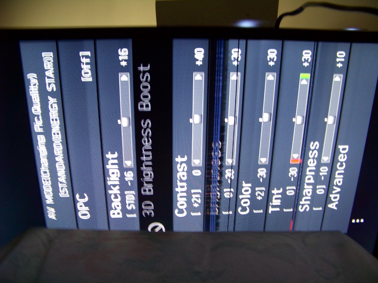

                                        I thought since things are kind of "broke", I probably can't make them worse... right... :-)
                                        Anyways, with the set powered up and running with 3 tcon cables connected, I "carefully" plugged in the 4th (left most on the back), the set is staying in "run mode" now for over 1.5 hours, The picture has the "scrolling" along with the horizontal lines in the middle and lower section. The "scrolling" and lines are across the screen as I have now looked at both halves. So somehow during a startup, there is some process / check that isn't satisfied but once past, the set seems to be able to get around the 2-5 code / failure and run. Any ideas as to what the system is looking at / to during that initial process?

                                          well, the plugging in of the tcon cables while powered doesn't work any more. As soon as the 4th one is plugged in, the set shutoff and flashes 2-5 codes... :-(
                                          I continued to play with things and found some more things out. By unplugging the corner ribbon cable on the left backside, which connects the edge boards on that side to the bottom edge boards (that are ultimately connected to the tcon board / cables), I can now start that tv with all 4 tcon cables connected. The resulting picture appears to be relatively "stable" except for "two lines" mid / lower screen (right half viewed from the front). The lines do go out on black picture backgrounds (ie. for pictures less than full res, ie. dvd). They also are not horizontally across the entire screen, but disappear about 2/3 of the way across. Also appear to have some sort of "pixel data" as they do "change" color elements with the picture, just seem to be out of "time".
                                          Not knowing enough about the overall tv operation in terms of the side boards, does any one know what the right side edge boards control? The picture seems "OK" outside of the lines (which are there with or without the corner cable attached). Further, doing a similar test of removing the corresponding connector on the other side, results in the set not turning on and flashing 2-5.
