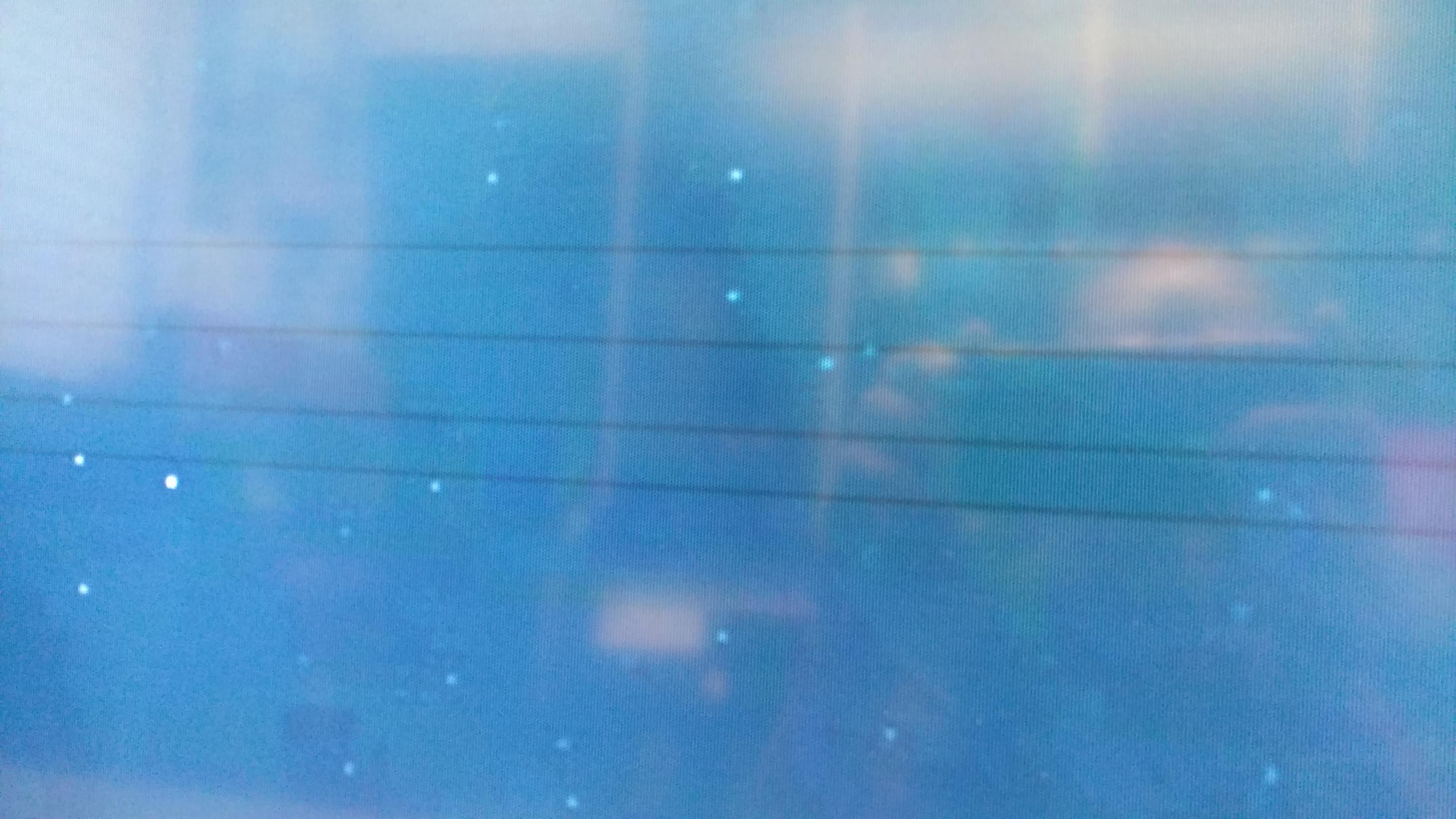

    Re: Sharp LC-70LE757U Flashing 2-5 :-( can it be saved economically?
    well, I can't really tell from your pictures... but maybe. As a better test, disconnect one of the corner cables (going from the bottom edge boards to the side board). Leave the tcon cables connected, what happens? Do the reverse for the other side, what happens. Further feed in a known test pattern (dvd or computer file source), it will help in understanding what you are looking at in terms of issues.

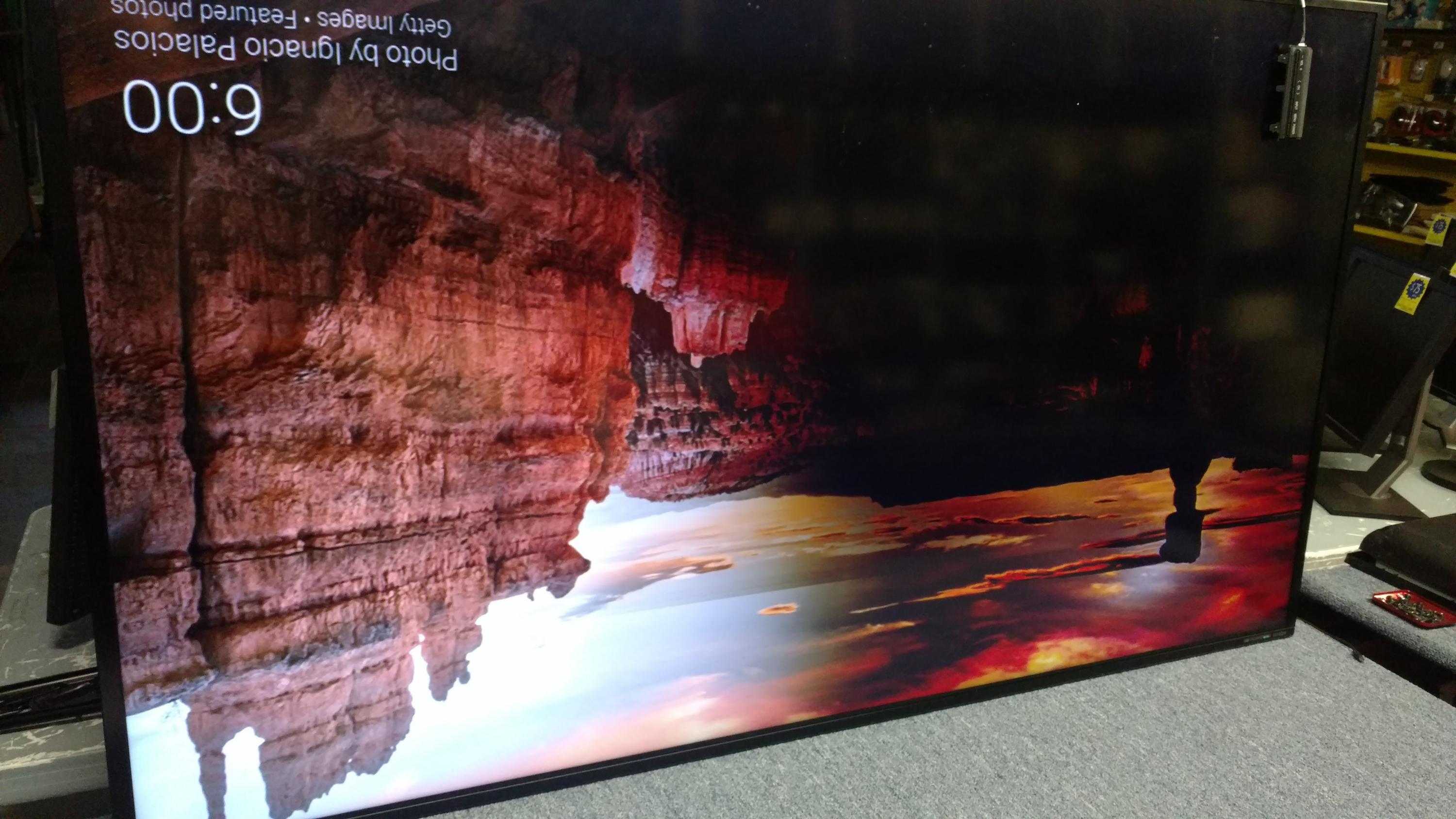

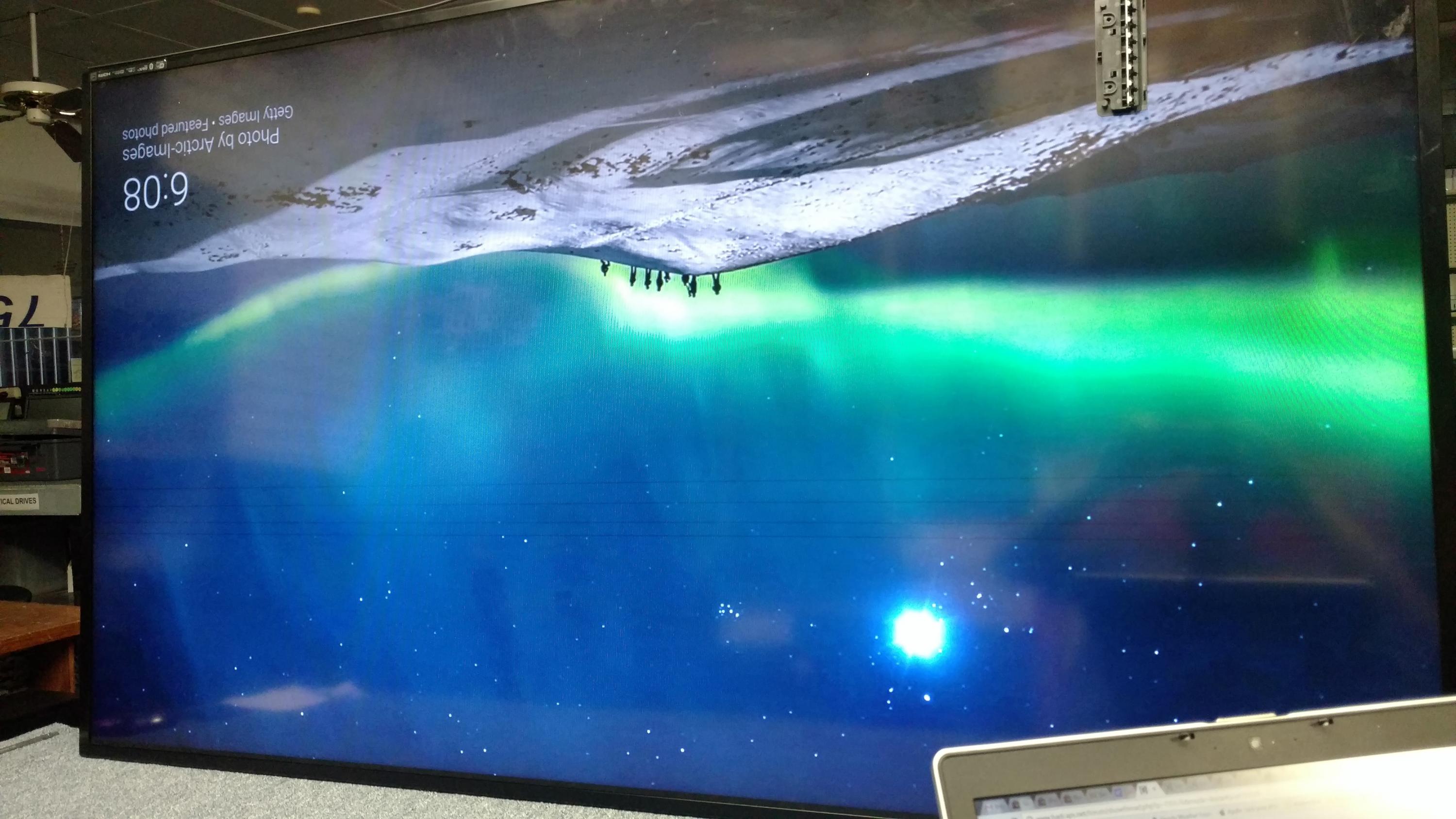

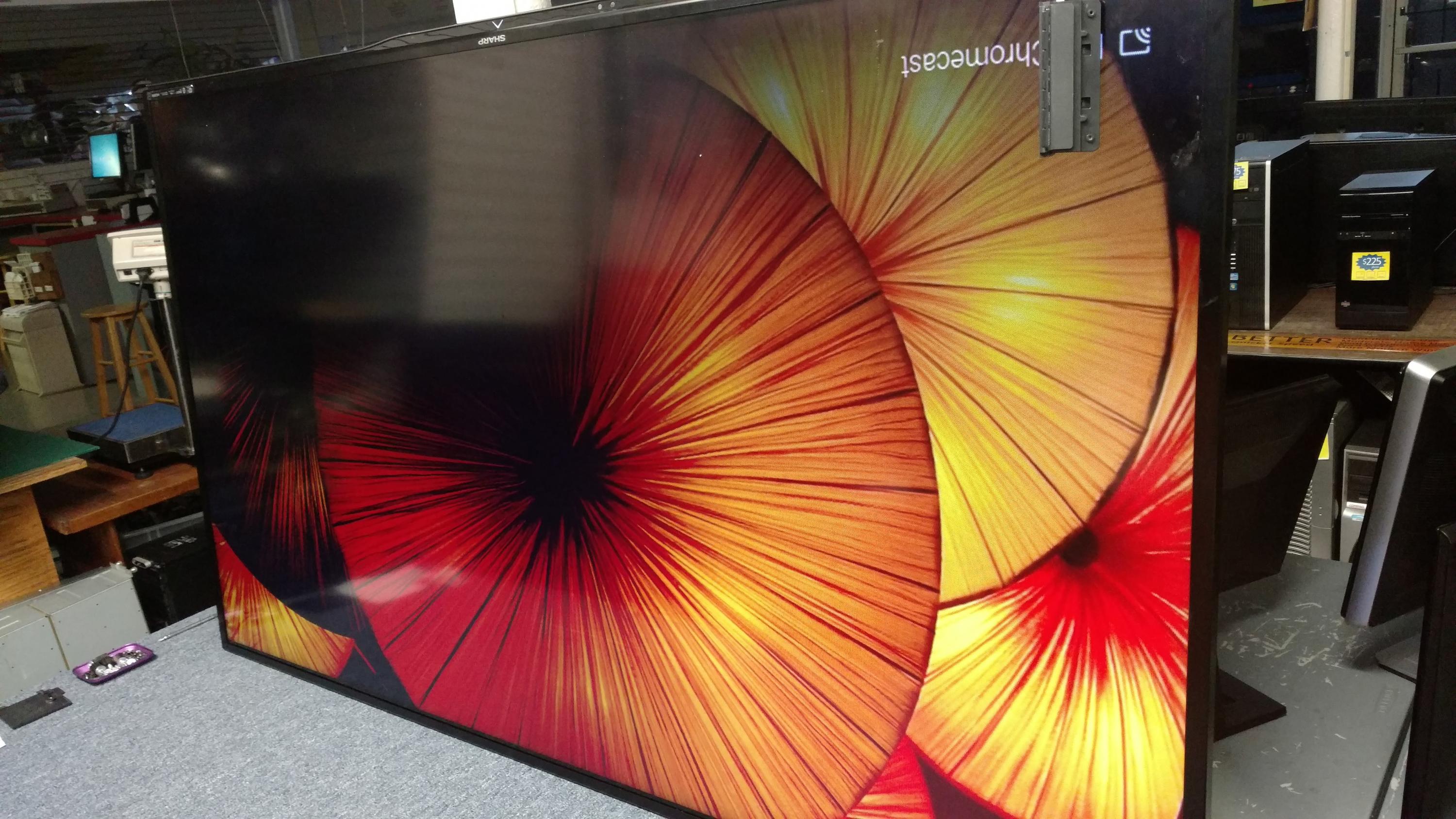

        Ok so here are some pictures with the corner cables disconnected and also with them both connected as the tv is now working when everything is plugged up normal.
        Left/Right is based on tv face down (bottom of tv closest to me)
        Pic1: Disconnected left driver board only
        Pic2: Disconnected right driver board only
        Pic 3/4: Normal

          #184
          hmmm... there are others that have found similar results.... BUT without seeing a KNOWN test pattern so that one can thoroughly examine the display, it is difficult to provide any better guidance. Further, picture 4 does show some sort of "horizontal lining"... maybe (since I don't actually know what the picture is of).... which is a sign of tab issues.

                #187
                Something is definitely wrong with the drivers. You may find that moving them around while the tv is on will produce the original problem. The lines you are seeing is the original area for concern on tje output horizontal driver I would remove the black frame bezel on both side and inspect the drivers on the carrier package to look for obvious signs of overheat or shorted driver IC. there you will find your answer.
                Without a picture that would provide a full white image or something of that nature it would be hard to tell right now which side is causing the problem.
                Tcon cannot and will not produce sporadic horizontal lines.

                  #188
                  Originally posted by budwich
                  did you read my post (#181)?
                  Budwich, yes I read your post but what I didn't understand is "known" to whom? I plugged up a Chromecast and that is known to us .. but maybe you meant known to you.
                  When you said, "Further feed in a known test pattern (dvd or computer file source)" what did you mean?
                  I will your advice freakaftr8 and provide pictures on a white background tomorrow morning.

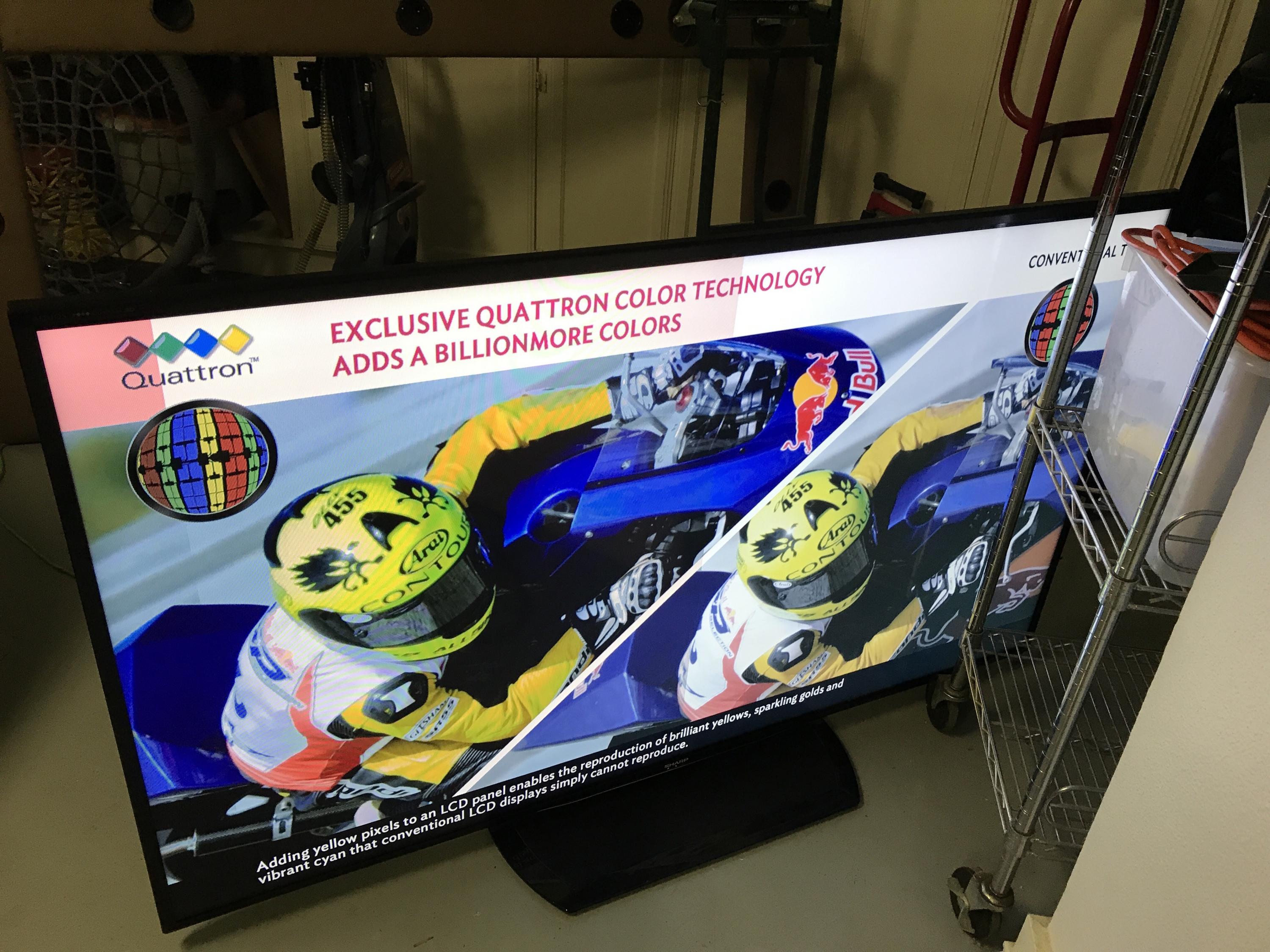

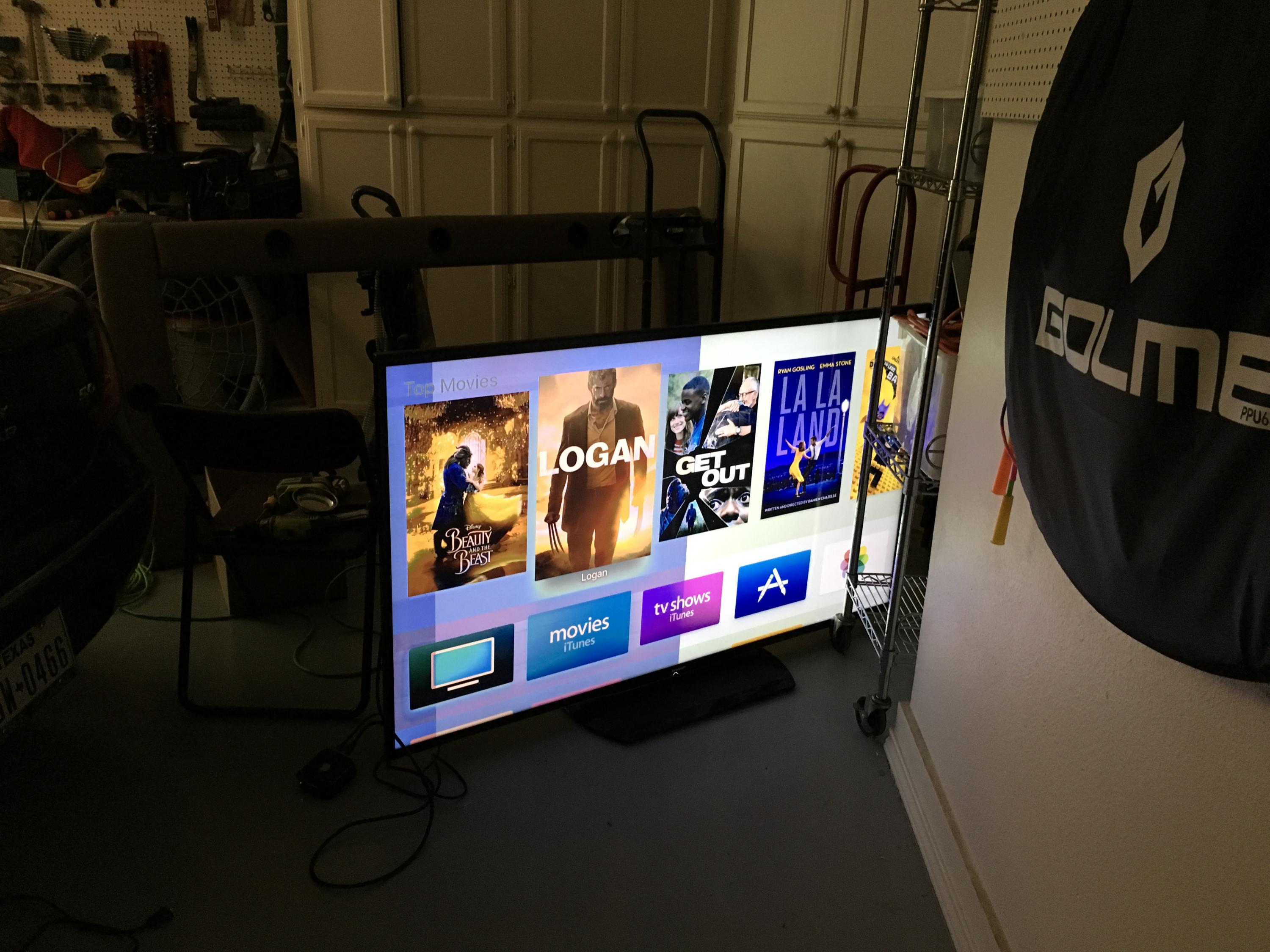

                              #194
                              Many thanks to those on this board. I too had the 2-5 issue. I removed the left connector and still had the 2-5 issue, I reattached it and removed the connector in the lower right corner and the set came on. I un screwed the bezel and removed the 5 ribbon connectors and the side section from the corner connector up.
                              Put tv back together again, powered up and it is mostly good. The left hand of the the tv is darker than the right side. See image from an Apple TV, the background should be the same all the way across.
                              Any suggestions?

                                #195
                                put on a test pattern to get a good idea of what's up. make sure the places where the ribbon tab bonds have been removed are clean ... nothing is left behind from pulling the tabs off. ot sure what else to say... I can't really say because I don't know that "picture" is supposed to look like... that's the reason for using a known test pattern so people can evaluate what is being shown and they have a "reference" in their minds or otherwise.
                                Anyways, on the set that I saved, there very little to no difference across the set. It is still working for the owner.

                                  #196
                                  As far as removing the tabs, should I be removing anything that is under the panel bonded area. I removed the tabs up to the point where they were bonded into the panel and well past the little black component on each ribbon. Some tore and I had to pull the remainder off separately.
                                  Not sure how to get the test pattern on the screen. This is a picture of the demo mode. The background at the top is supposed to be all white but it instead it has three different shades. The same lack of brightness occurs vertically across the entire screen. The right side is thr brightest which happens to be the side where I removed the side drivers.
