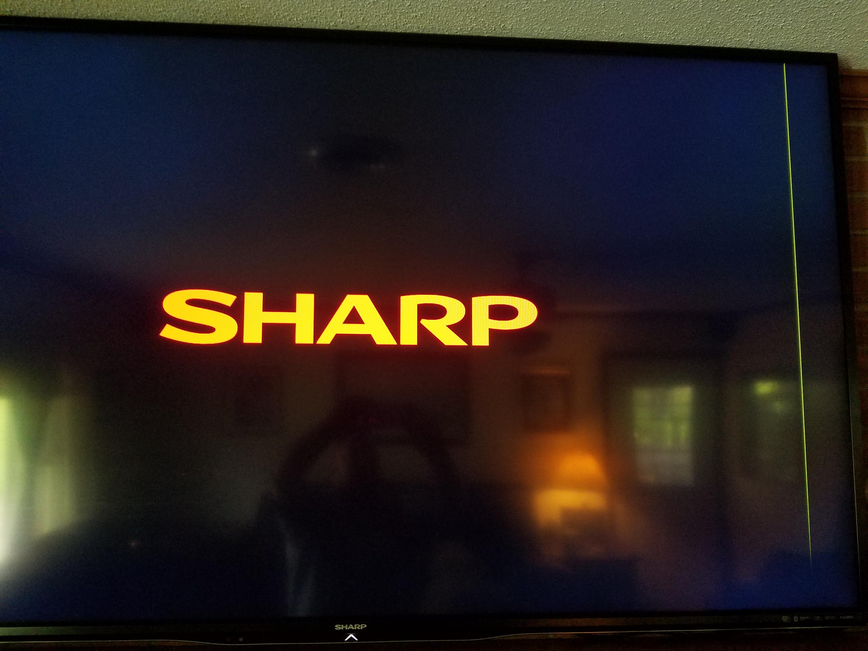

            Re: Sharp LC-70LE757U Flashing 2-5 :-( can it be saved economically?
            Has been about 1 month no problems until now, have a thin vertical line on right side of screen just today. Any thoughts?
              #206
              It looks like your panel has bitten the dust. That would be a source driver fault which sadly cannot be repaired by removing tabs. Did you do the side tab removal before? It's unlikely it stressed it, but maybe this is sign that Sharp did the bonding wrong on these panels on both axes.

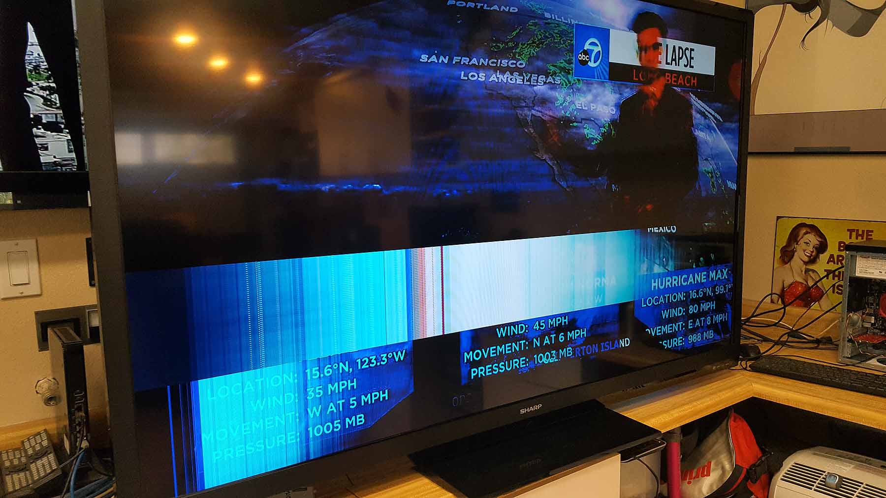

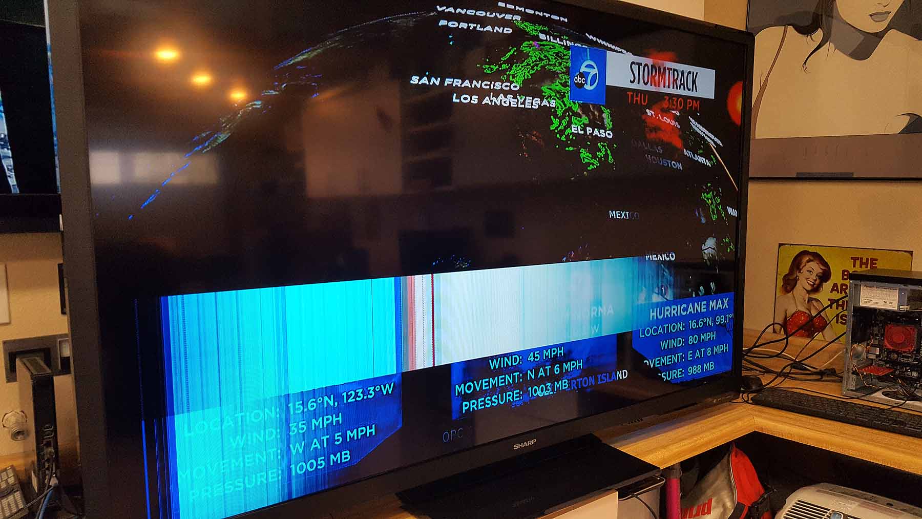

                  #208
                  I got a Problem with my Sharp LC-70C6400U, I got from my Neighbor.
                  (Sorry for hi-jacking, I can't post a new Thread yet.)
                  Take a look at these Pics and give me some pointers?
                  I've been reading posts all afternoon, but haven't seen a real solution yet.
                  It looks like the T-con board is shot?
                  • deja-vue
                    Challenged
                    • Sep 2017
                    • 7
                    • US
                    #209
                    On the last two pictures, you'll see two almost identic TV's.
                    The left one on the Wall is ok.
                    lol.

                        #211
                        Thanks, Budwich. Tried to log on yesterday but the Forum was closed.
                        What I did is some basic voltage measurments around the PSU, all seems normal.
                        Here is what puzzles me:
                        As soon as I remove the Back Cover from the TV, the Picture is normal again. Put the Cover back on, the picture eventually (after 2 days or so) craps out.
                        I guess I have to wait until the picture fails when the Cover is removed to get some readings from the components.
                        Cheers,
