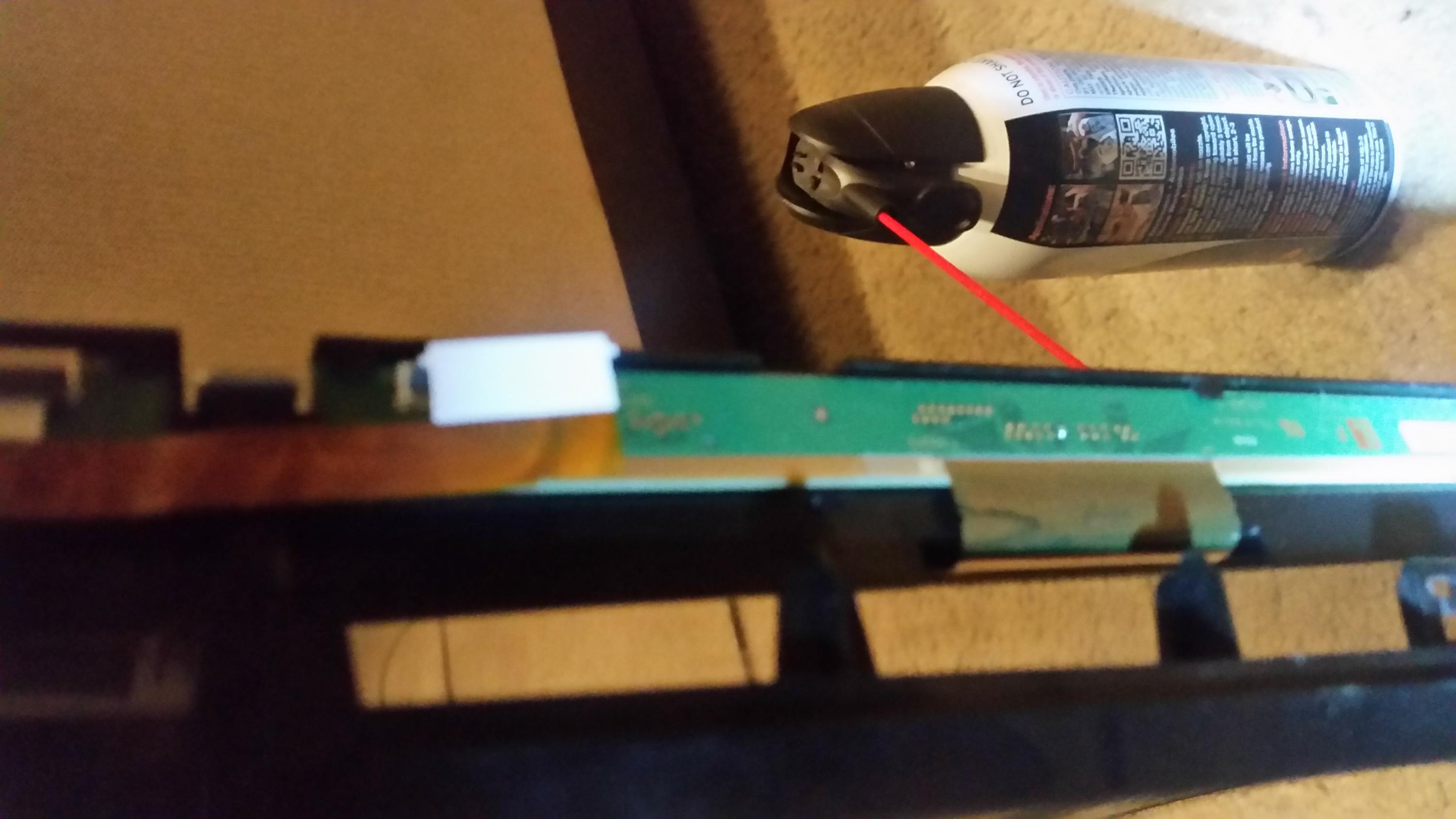

                An LCD panel is row scanned, that means that data is programmed into each row using the source drivers (top most drivers) and the rows are selected individually by the gate driver ICs on the side of the panel.
                What you're seeing is a failed gate driver IC which is keeping a row permanently selected. This driver is probably internally shorted between the VGH and VGL lines (+25V and -8V typically) at those particular rows that are lit up, causing the 2-5 error code.
                Across the panel, there is a direct connection between the left and right gate drivers. The idea is these ICs work in parallel. The problem is, if the side is disconnected the internal body diodes in the gate driver outputs (which are just push-pull, totem-pole style outputs, using CMOS technology) will bias the internal supplies drawing current from the other driver and weakening the drive for the whole panel - hence the effect of half the panel being dark (although it starts further back than midway.)
                There is one last thing you can try, I have never tried this myself, but essentially you want to physically disconnect ALL the side driver ICs from the LCD panel itself (not just the board, they need to be removed from the panel.) This will mean the left hand side ICs are doing all the driving. These ICs will now dissipate FOUR times as much power (P=I^2), so they will probably not last long even with improved heatsinking. However if you only kept this as a man-cave TV or bedroom TV it might work long enough to enjoy some years out of it. Obviously, this is physically changing the panel - it will never be possible to return it to the original condition - and it may well only work a few minutes... but if all else fails...

                    The idea is to physically remove the driver from the panel glass. Each flex has an IC embedded, this is the failed component. For all intents and purposes they may as well be embedded in the panel, they cannot be replaced.
                    If the idea works you may well have a 100% functional panel, just one that won't run for long.
                    The edge boards work in parallel on most panels, driving the same lines in the same order. Depending on how the control logic works the drive signals may be split so each driver works on a 50% duty, so removing one set of drivers would make the panel flicker more (may not be noticeable) or may reduce the frame rate.
                    If there are drivers on both the top and bottom then they will drive their respective halves, which is different to the gate drivers. However this type of driving is very rare - I have only ever seen this once, coincidentally on a 52" Sharp, which was one of the first frame-interpolated (100/120Hz) TVs made. The extra drivers were required for the higher frame rate. (Similar to early "dual scan" plasma displays)

                        Yes, the plastic bezel needs to come off, exposing the LCD module. The shielding on the LCD then needs to go, finally exposing the ribbons.
                        If I'm right, the left side is working OK, and the right side has shorts. The right side ribbons would therefore be cut in this operation (think of it like a "hemispherectomy" - try to isolate the bad portion!) The ribbons need to be cut close to the glass, most likely they can simply be peeled off without a cutting tool. It's important that there are no shorts where the ribbon is cut.
                        The disclaimer is that I have *no* idea that this will work. If it does not work then the panel will be irrevocably dead, so use it only as a last ditch attempt!

                              I took the back off with the set standing upright (on its stand). Attached picture shows the edge board (lower side) that I have been referring to.
                              Tom66, there are two flex cables that go under the board to the screen. Are the "gate drive" ICs connected on the reverse side of that board or do I have follow those cables around to the panel by taking the bezel off some how to find the corresponding gate drive ICs??? Note: this is the opposite side of the panel in terms of the trouble but its not easy for me to get at the other side right now.
                              thanks again for your help on this "operation".
                              PS. I see we clashed with our posted... :-)

                                  Guys and Tom it's amazing that you guys are talking about this right now because I just repaired a Vizio width 70 inch with a sharp LCD panel and it's the dreaded e701i- that I was talking about in an earlier post that kept blowing t-con boards. Anyways I repair the t-con board and did the one side at a time and realize the right side was having a problem where it was dark and it would lock the t-con board up. I realize that one of the gate drivers were shorting out because in that section and had a perfect picture and when I press on the gate driver it would get them like the rest of the screen the only way to tell would be to disconnect the gate drivers from the bottom driver board on the panel. With nothing to lose I removed all the gate drivers off of the panel very carefully peeling them off. What I have now is a perfect picture with no problems. There are no more right hand gate drivers but the picture does work perfect. I shouldn't say perfect on a full grey screen the very bottom middle is just a little bit darker. This is probably because the left-hand get drivers cannot pull the current that are required when both the gate drivers on the left and right were there before for the dual duty cycle like you were talking about. But it is worth a shot removing those gate drivers from the field side of the TV screen.
                                  So in essence yes it does work. My question is how long?

                                    Here are some pictures of my Repair just to give you an idea of what your up againt
                                    The last.pic is what you will end up with when the job is complete.

                                        To recap the side of the screen that is having problems is most likely the gate driver is on that side and those are what I carefully peeled off of the LCD panel. You cannot remove just one you have to remove all of them so therefore the boards are no longer connected to the bottom flat ribbon cable that goes from the bottom of the panel to those boards. You can leave the ribbon cable in there if you like but there will be no more ribbons and no more boards on that side of the panel that has the defect to recap the side of the screen that is having problems is most likely the gate drivers on that side and those are what I carefully peel off of the lcd panel. You cannot remove just wanted you have to remove all of them so therefore the boards are no longer connected to the bottom flat ribbon cable that goes from the bottom of the panel to those boards. You can leave the ribbon cable in there if you like but there will be no more ribbons and no more boards on that side of the panel that has the problem. For me it was the right side first tab on the lower right side board of the panel..
                                        Before and after
