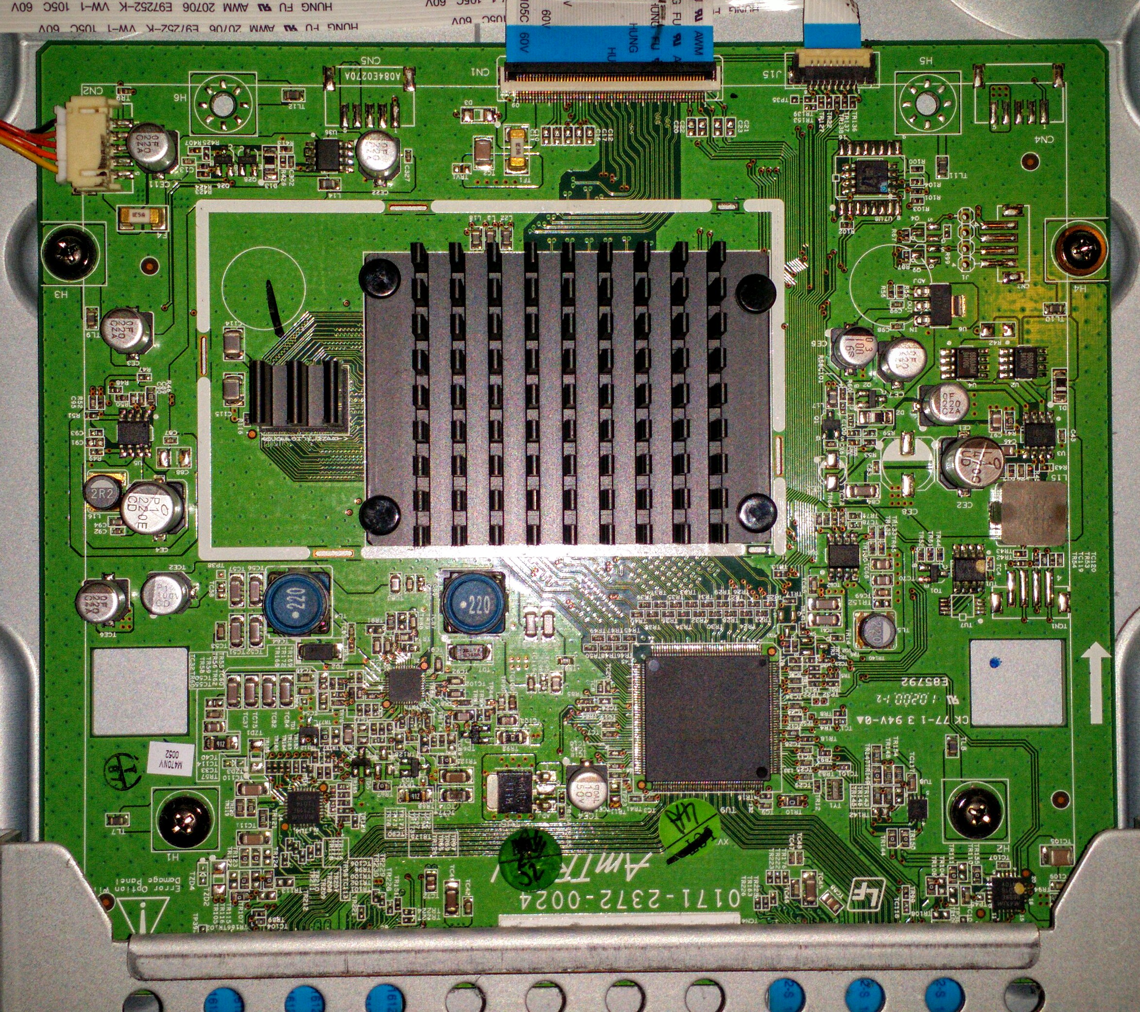

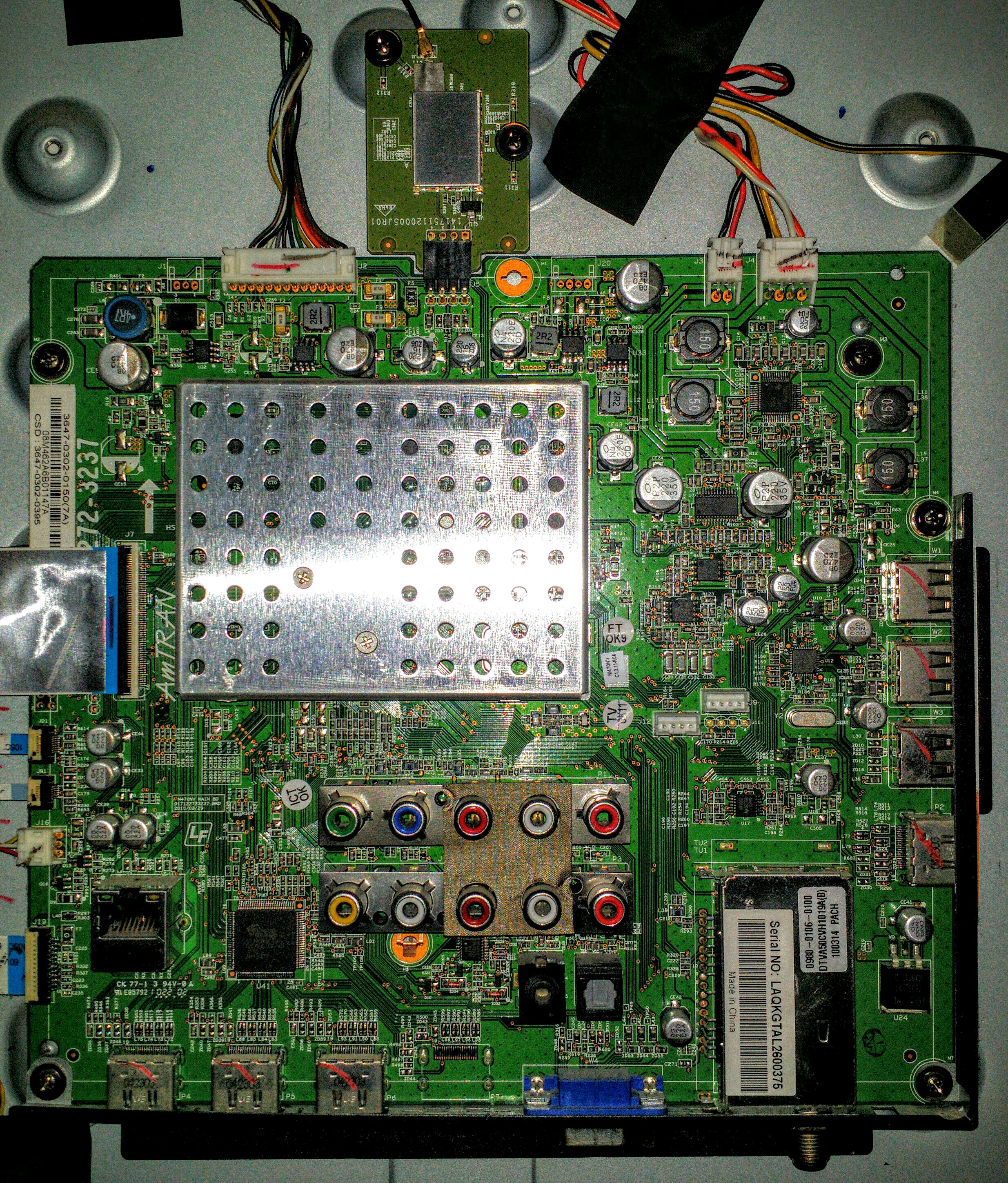

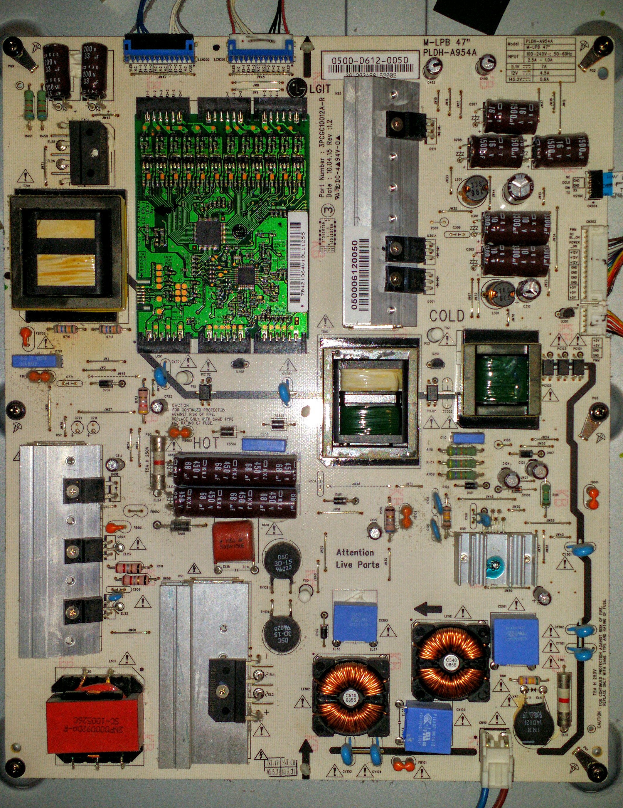

      I don't think there is a T-Con board. I looked and found nothing.
      I only see a Main Board, Daughter Board, and Power Board. There's also a Wifi Board, a board for the Infrared sensor, and another board for the power button.
      I've attached the main, daughter, and power boards. The main board has the wifi board attached to it at the top. All of these pictures are rotated so that the bottom of the picture is the part of the board facing the floor.
      After taking a look at all of the boards I don't see any capacitors that are bulging or leaking. There are also no black spots on the board either.
      What are some good next steps for troubleshooting this problem? I do not think I'll be able to get access to an oscilloscope.

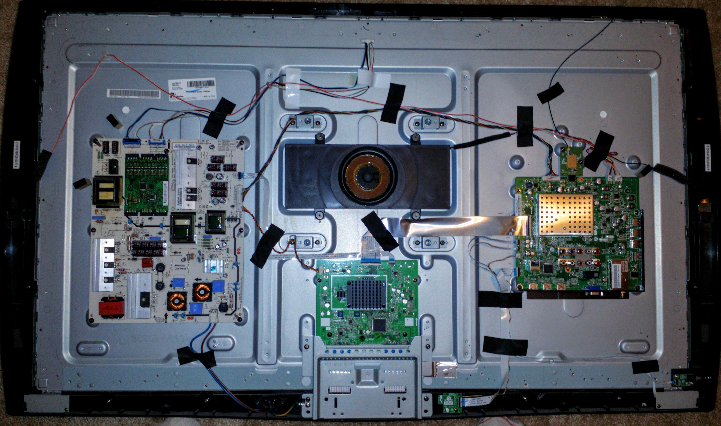

        Another pic of the whole back of the tv with everything connected, please.
        • jortgonfreit
          • Aug 2015
          • 12
          Re: Vizio M470NV - No Picture, but has sound backlight
          Here you are.
          You can see at the very bottom of the television what appears to be the infrared sensor board. And the very right of the television is the board for the power button.

              See the board in the middle of the tv with the big black heatsink? That's the t-con. With all the boards connected like it should be, check if the t-con gets any power (5V) from the PSU. Check fuses TF1 and F4 on the t-con.

                I'm a bit confused why you call it a t-con board and it's called a daughter board here: http://www.shopjimmy.com/vizio-3647-...hter-board.htm
                • TVRepairNoobie
                  • Feb 2015
                  • 158
                  Possibly the board has the T-CON chip on it. so, most would call it that.

                          I just decided to buy a new Daughter (or TCon) board off eBay. It was only $40 and if that fixes it then it was worth it.
                          • jortgonfreit
                            • Aug 2015
                            • 12
                            So I swapped out the T-Con (or Daughter) board and still have the same issue.

                              Try checking the 3 fuses on mainboard. I can't read the part number of U24 in the lower right corner of the mainboard. It might be a voltage regulator. Check it's output voltage.
