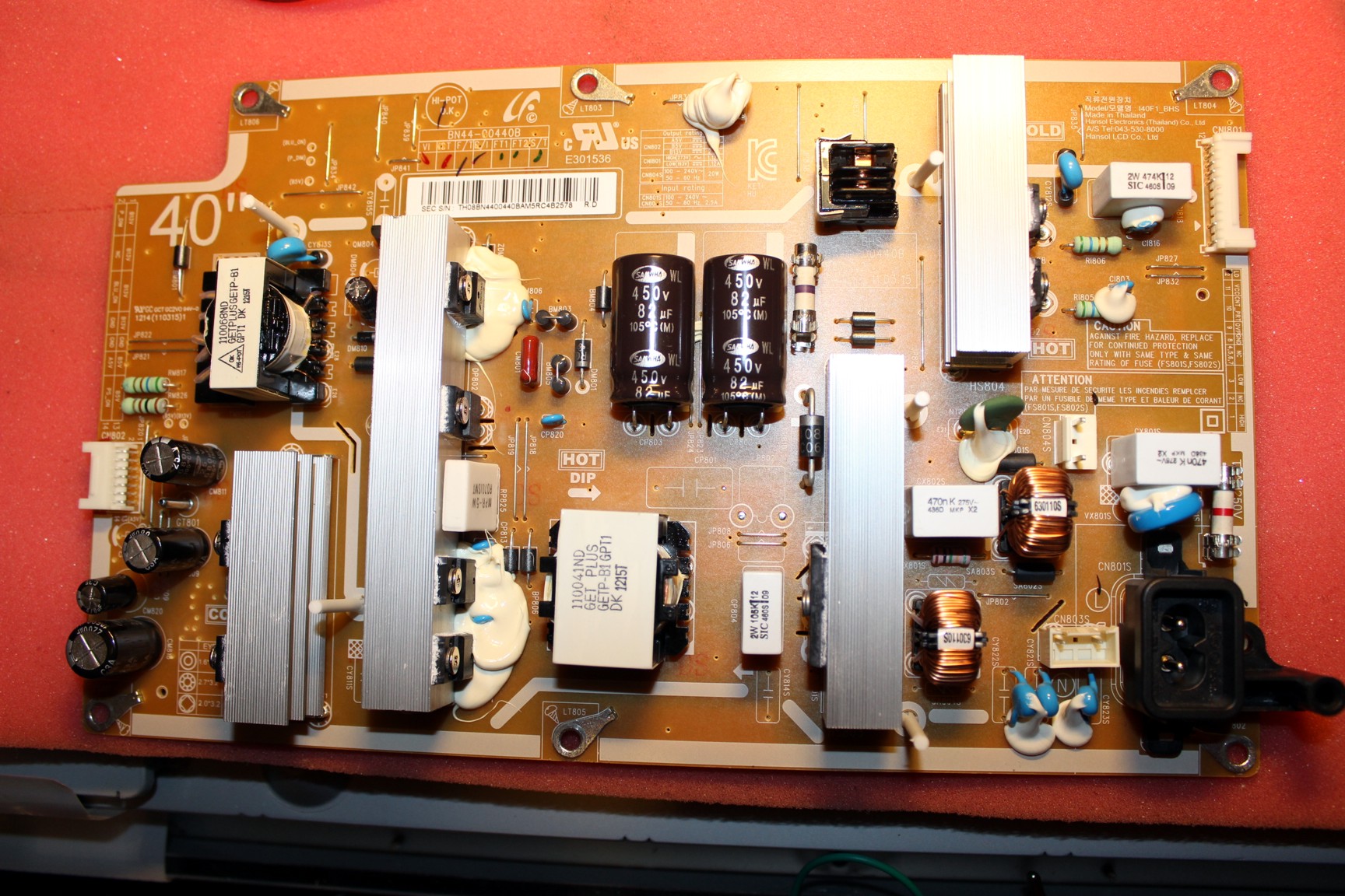

                          I have been able to piddling around with it some. I believe, too, that the schematic I have isn't jiving with the components I have on this BN440-0440B board. I have searched for the stby 5.3v rectifier (DM857) but have yet to find it. I guess I'm used to Sams Photofacts…..”spoiled”.
                          Anyway, I didn't find the 5.3 stby volts. I measured for this voltage at the cable that runs from the power supply board to the board where the IR pick-up is located. All the fuses are OK. 120V AC is there. I have ~165v DC on the 2 filter capacitors (100uf @ 450v) as related to HOT ground. That's where I stand now. Any photos that are need can be supplied.
                            Re: Samsung LN40E550
                            Please upload good clear straight shot of the top and bottom sides of the board.

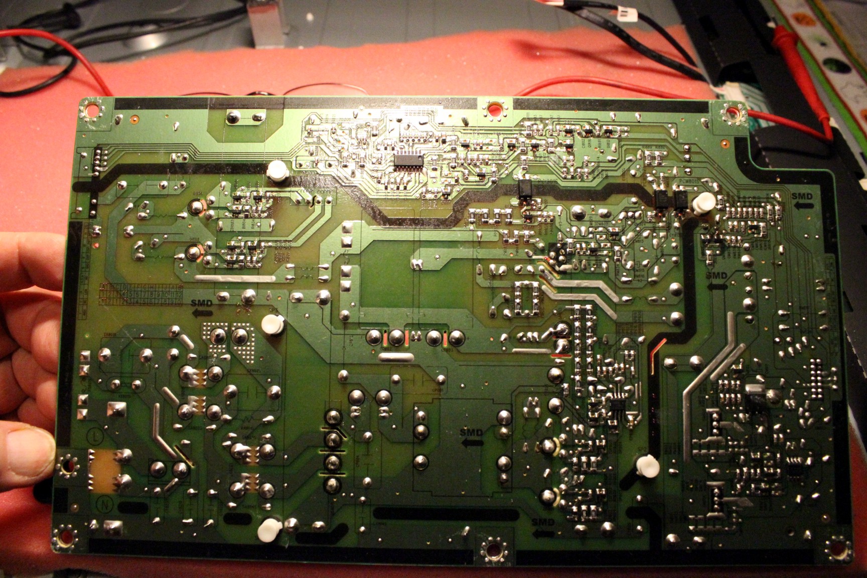

                                  Here are photos...if not adequate, please advise......Thanks!

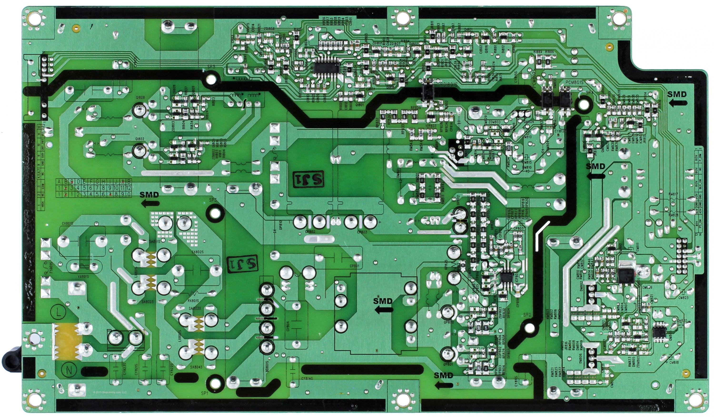

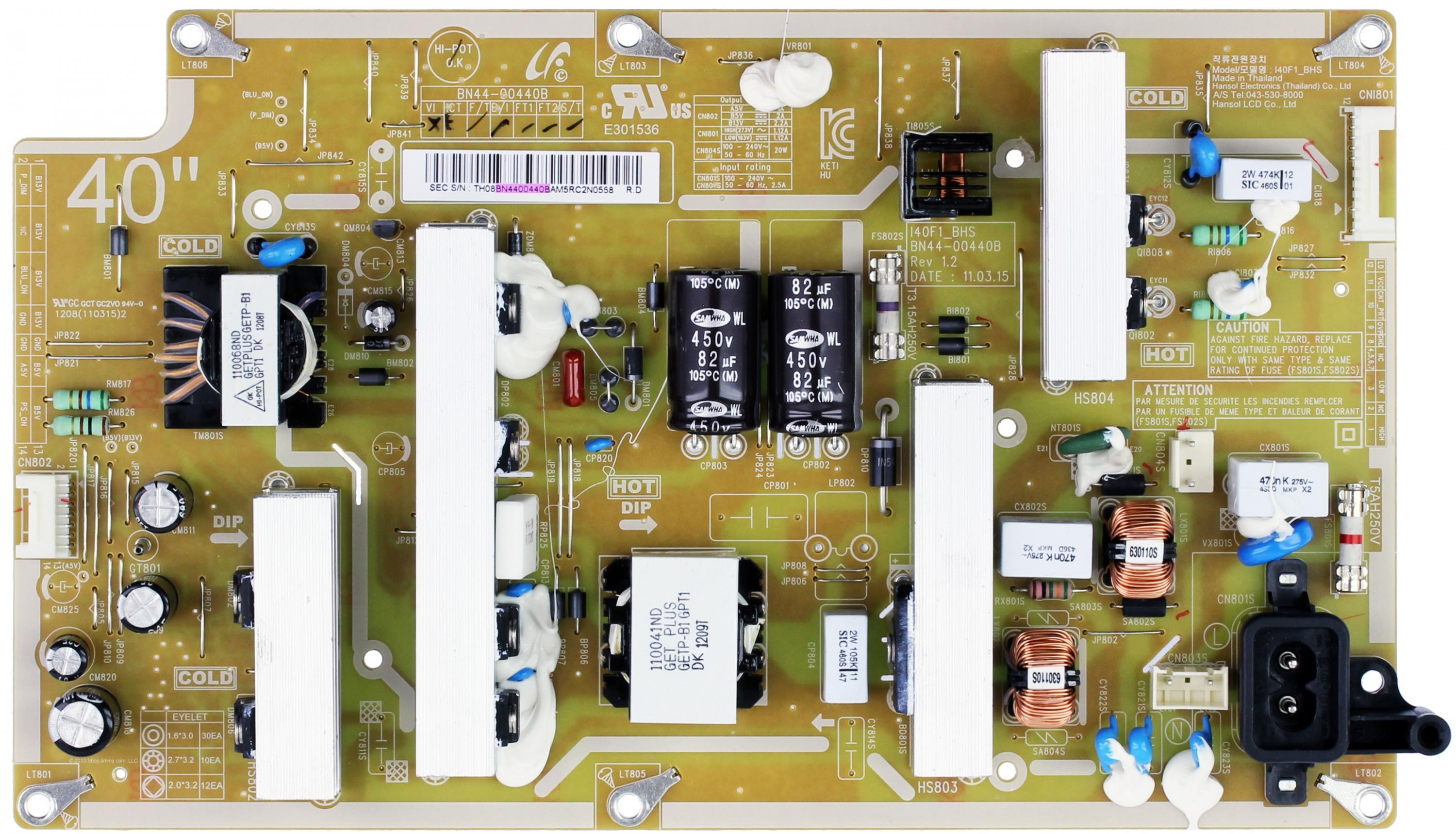

                                    OK, What DCV do you have on connector CN802, make sure to put pin number, follow by pin name, and follow by the DCV reading for each pin.
                                    Pictures provided by shopjimmy.
