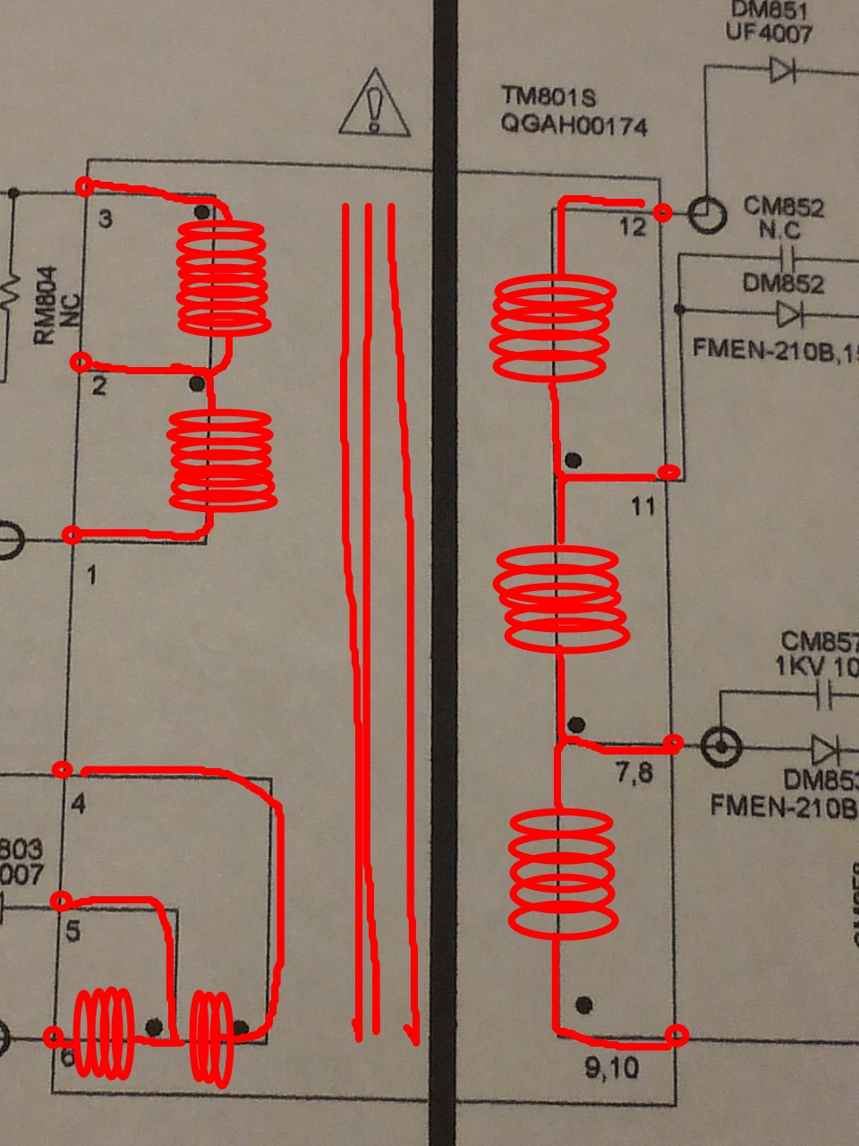

TM801S is a transformer with many windings.what is this suppose to represent??.....A transformer? ....Just trying to get a better understanding on some of the unfamilair items on this schematic. Sorry if I'm being a PITA! Please bear with me as it has been a few years since I was expised to these 'new fangled' items on a scematic.Attached Filesif you find these attachements useful please consider making a small donation to the site

Yes. You can run the power supply board by itself without having any other board connected to it, the STBY is an always ON power supply.Never stop learning

OK..before I power up, I did some checking and found that the 2 rectifiers that were highlighted in previous pix, have an ohms reading of .3 (reference...cold ground) on the 2 outside connectors.....you said, those 2 are connected to each other. Are these 2 rectifiers going to a transformer that connects to ground after the windings? Do you have any idea where I can get a correct schematic for this board? It's very frustrating not knowing if measurements are correct.Comment

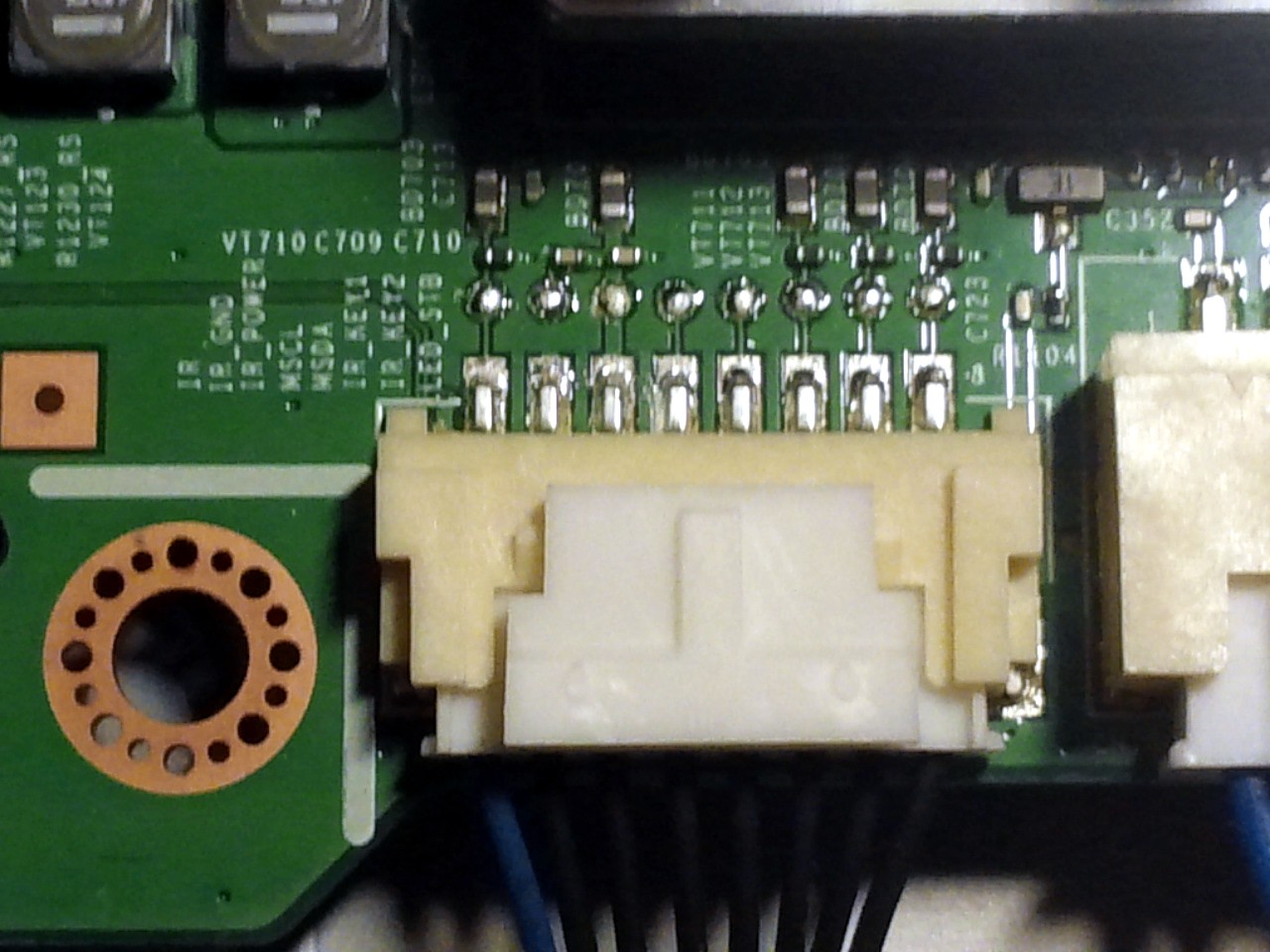

I connected the main board to the power supply board and got these results:
POWER SUPPLY PCB
Plug CN 802
Pin 13 (B5V) 0 V
Pin 12 (A5V/stand-by) 5.2 V
Plug on Main PCB going to IR:
3.3 V going to IR from (I assume)
Pin 3 3.3vAttached Filesif you find these attachements useful please consider making a small donation to the site
Re: Samsung LN40E550
So the 5.2VSTBY is fine when the main board is connected to the power supply board, but you do not have the switched B5V which is turned on when the power supply board gets the PS-ON signal from the main board.
You need to locate and check the PS-ON pin on the connector of the power supply board to see if it is present or not.Never stop learning
