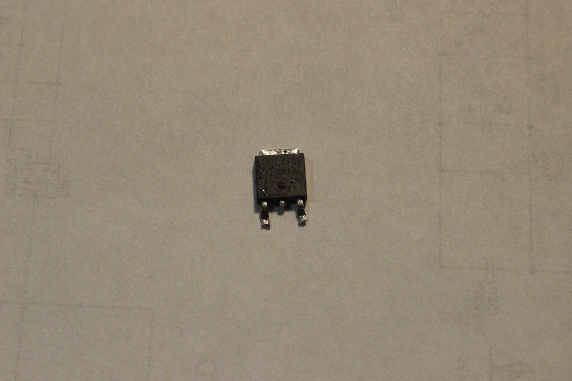

                    Can we see the pictures of this shorted part?

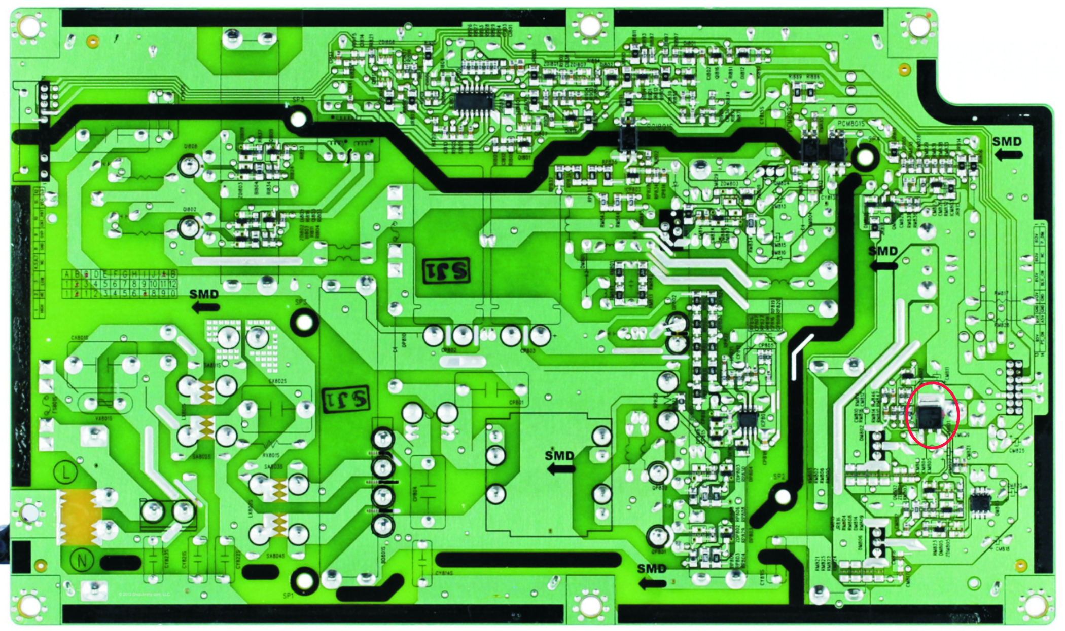

                        OK...here it is!! It was soldered on the foil side of the board. The only one that was on the board.
                          #32
                          Re: Samsung LN40E550
                          What section of the board is this part in?
                          Shorted Source pin to Drain pin?

                            This component is shorted on all 3 of the connections......shorted to each other.
                              #34
                              That is a Power MOSFET used as a switch to provide switched 13VDC on connector CN802 PIN 1, 3, 5, 7.
                              For that to shorted out you need to check the resistance be tween CN802 pin 1 and GND the main board connected to see if it shows very low resistance.
                              BTW, that should not stop the board from producing the STBY 5V at CN802 PIN 13.

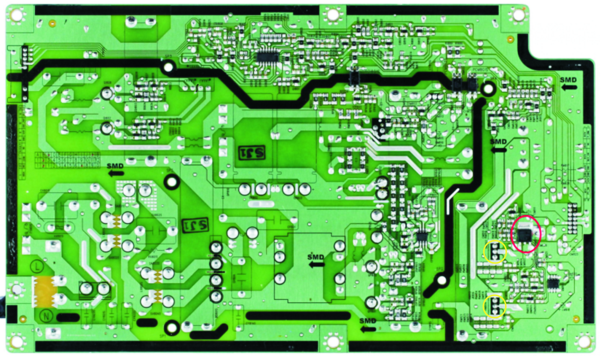

                                Just looked @ your last post....will do ASAP......FYI: found two transistors that (I thought were shorted E to B, circled yellow in attached pix). Removed one of the transistors from the board, & it measured good. Checked the connection points and found the E/B had a reading of .1 ohms. The other xtransistor checked the same. Collector(s) to ground, OK.>

                                      Those two in the yellow circles are Dual rectifier Common Cathode, the two outside Pins are Anodes which are tied together to form two diodes in parallel.

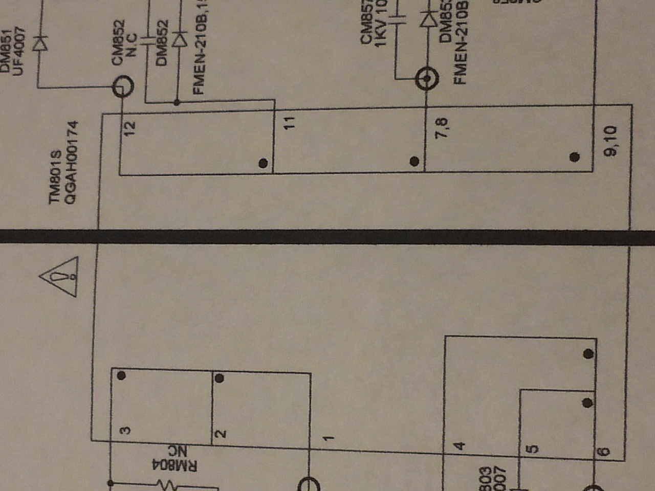

                                          what is this suppose to represent??.....A transformer? ....Just trying to get a better understanding on some of the unfamilair items on this schematic. Sorry if I'm being a PITA! Please bear with me as it has been a few years since I was expised to these 'new fangled' items on a scematic.
