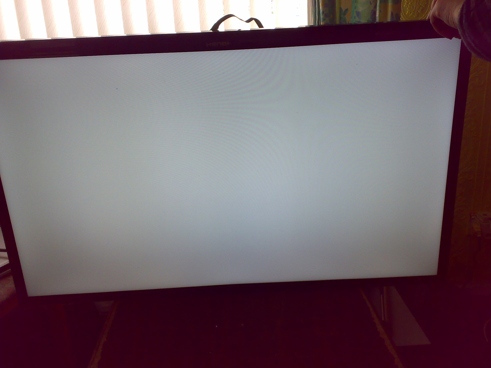

Bush DLED40127FHDS white screen
  • RULEX
    • Sep 2013
    • 7
    • IRELAND

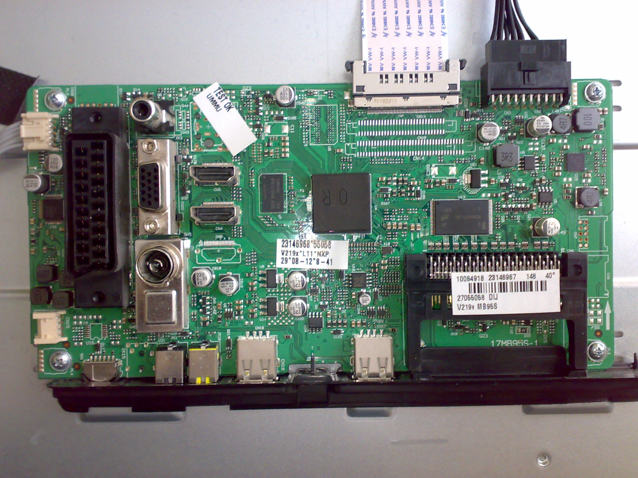

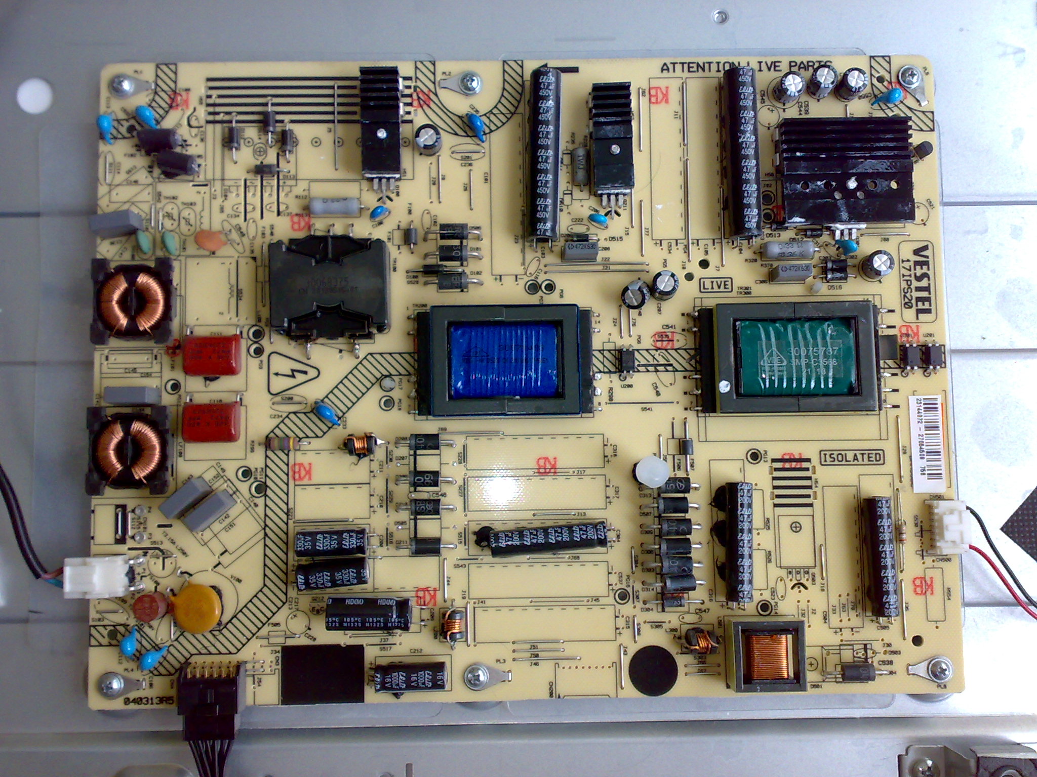

    I have Bush DLED40127FHDS with white screen,sound is good.Power supply is Vestel 17IPS20,
    mainAV 17MB95S-1,

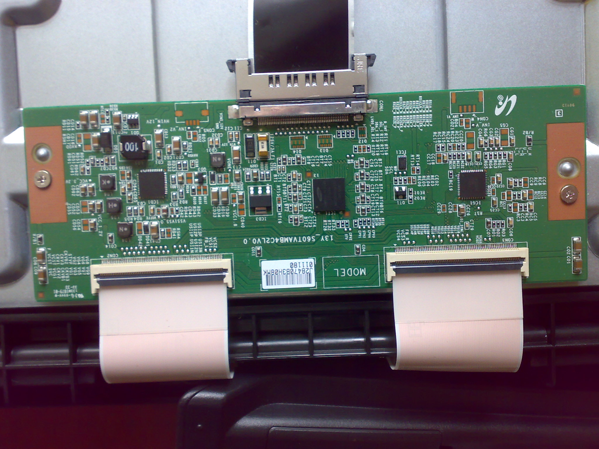

    T-CON S60TVAMB4C2LV0.0
    Power supply output voltages is 3.3v,5.3v,11.9v,23.4v
    T-CON board fuse is good,voltage on it 11.7v also is 1.8v and 3.2v.

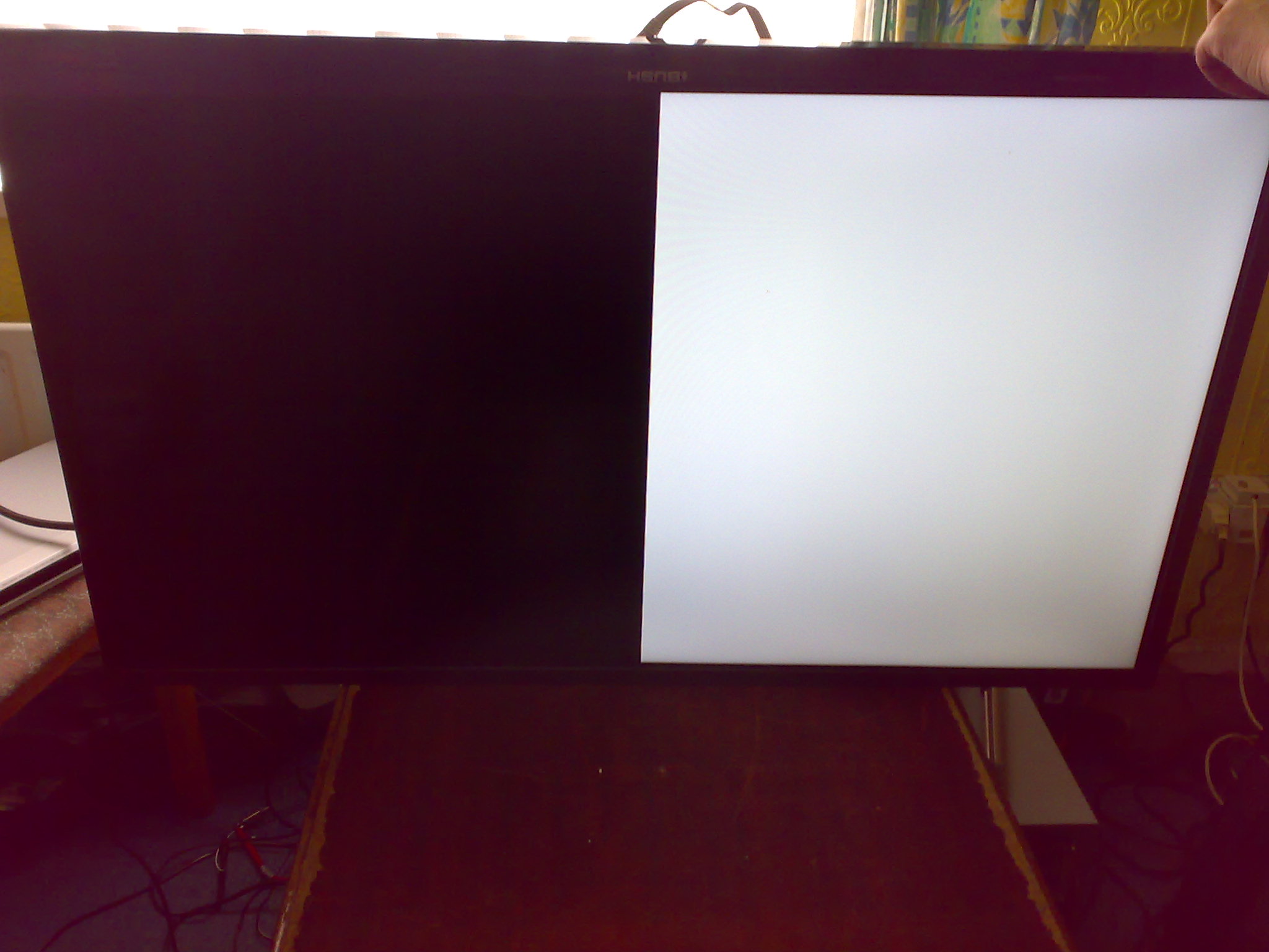

    When T-CON LCD panel ribbon cable unplugged one screen side get black other stay white,same when unplugged other ribbon,only changes black and white with out picture.What should I check?Which board could be faulty?

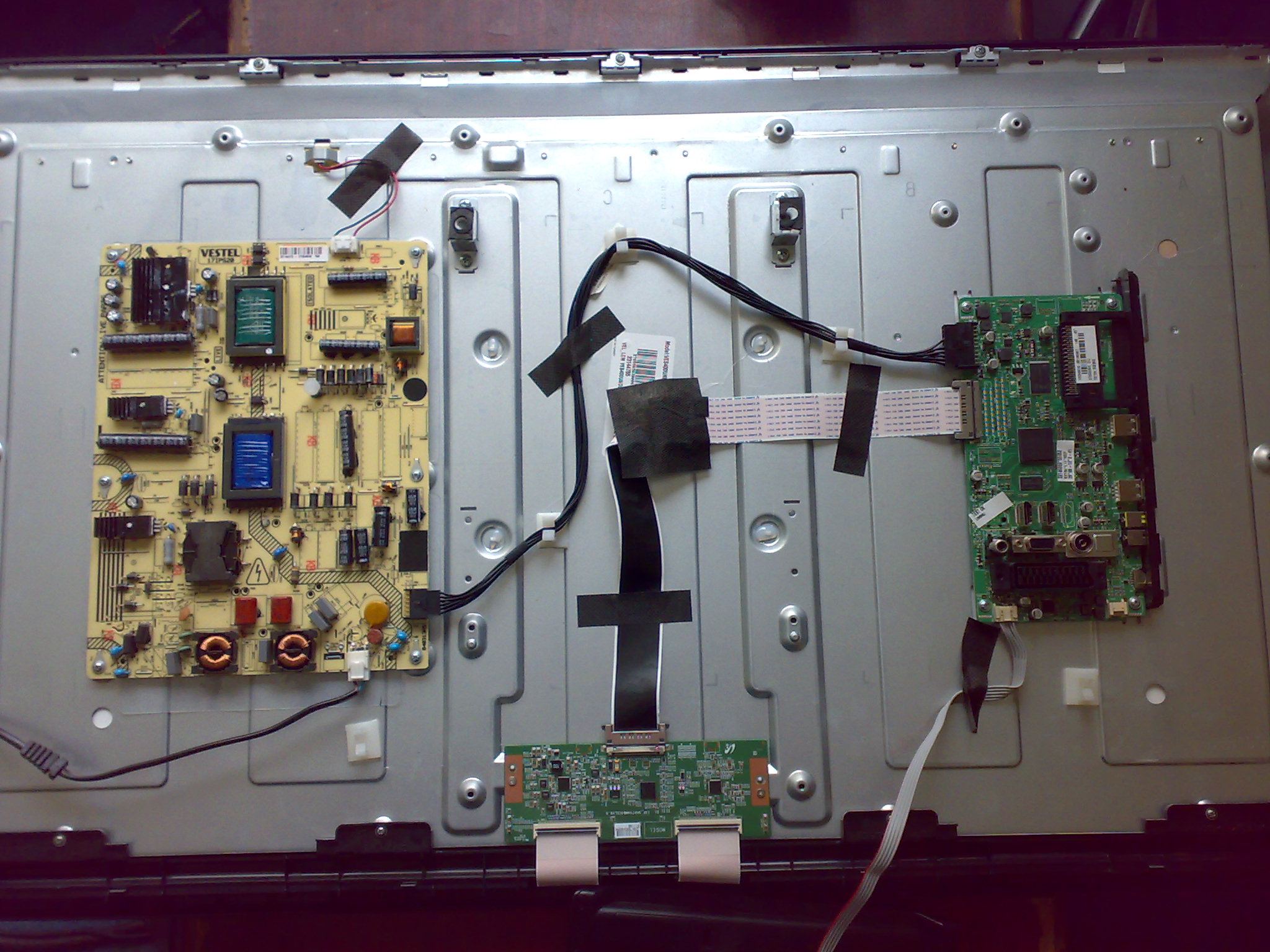

    Pictures of the T-CON board?
    You will need the Oscilloscope to see if you are getting any signals at all on the LVDS connector.

      Hi,thanks for quick reply.There is TV board pictures.
      I don't have the Oscilloscope,is there other way to diagnose the boards?

        using a oscilloscope and check the LVDS signal from the main board is the only way I know how to make sure that the main board is putting a signal out. Other than that, I'd say you have a T-Con problem. If you want to make sure it isn't the main board, you have to borrow an oscilloscope.
