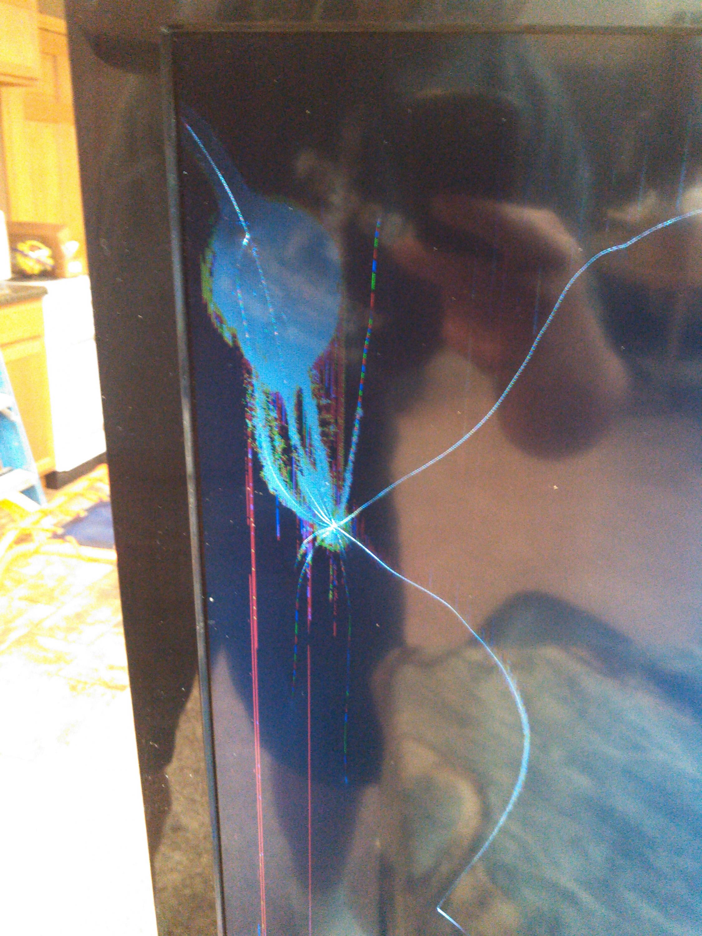

                    Well that was a waist of time and resources!!!! Couldn't see this one until the back light came on. My Protect3 voltage was .87 also.
                    Thanks again budm
                      • 31303
                      #130
                      Re: LF501EM5F No Power, Chirping/Beeping Transformer
                      smashed screen wont effect the protection circuit.
                      so you have a smashed screen, bad mainboard and bad led's?
                      sounds like an un-natural combination - did someone sell you that tv?????
                      if you fix or bodge the led issue to get the tv running, and verify it sort-of works,
                      you can sell the boards.
                      if you take out the led strips you can sell the working ones.
                      or you can scrap the mainboard and glass, mod the psu to keep the leds on and use it as a workshop lamp.

                        Ha Ya what a deal. I have a friend that picked it up from the curb and asked me if I could get it running for him. And of coarse you always dream of the easy bad cap issues, But that never seems to be the case for me. Ha Ha. So I told him I would take it to the shack and look at it. I'm thinking the main board went bad first with a shorted ceramic cap on the 3.3 vdc voltage regulator circut, and then it made it to the curb and in the process I think it was dropped or damaged or who knows. So that the deal. Thanks for asking.
