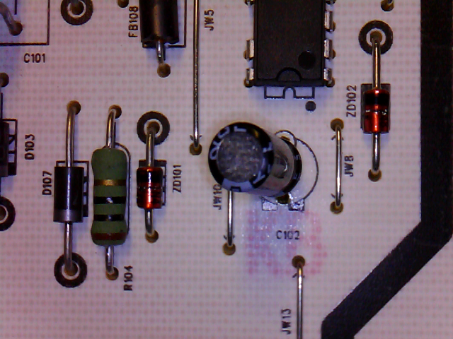

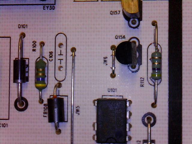

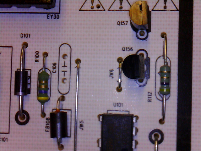

                          I guess I did speak too soon. I have been turning this one on and off at random and now the same thing is going on.I turn it on, Vizio light may or may not come on and then nothing. Voltage on main caps is around 370VDC for a bit and then falls down to 162VDC. At this point, it won't turn on. If I heat up the area that we replaced the cap in, unit will come on and work. There is something there labelled FB108. Does anybody know what this is? Right side of power supply board in 5V section. Seems discolored.
                            #33
                            Re: VIZIO E470VA Dead
                            FB108 is more likely to be Ferrite Bead inductor, it should have <1 Ohms of resistance.
                            • bwilliams60
                              • Aug 2014
                              • 109
                              #34
                              I placed my ohmmeter across it and it does indeed have less than 1 ohm across it. In fact I can't even get a measurement on it it is so low but there is definitely continuity. Budm is there anything else in that section that may cause this and how can I test for it.
                              I have tested all the diodes cold and they are all okay (.522). I am ssuming because I am in the 5V section I can put my meter to chassis ground. Can I measure voltages to the VIPER KB2105 chip or the KT2222A/KTN2907A transistors or the three Everlight BC115 chips. I know when I warm that area for less than 1 minute, the TV will work fine afterwards.

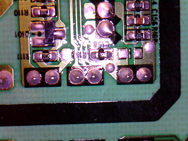

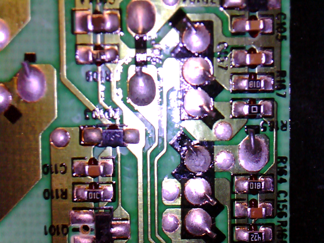

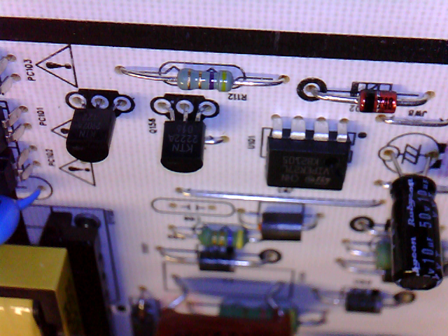

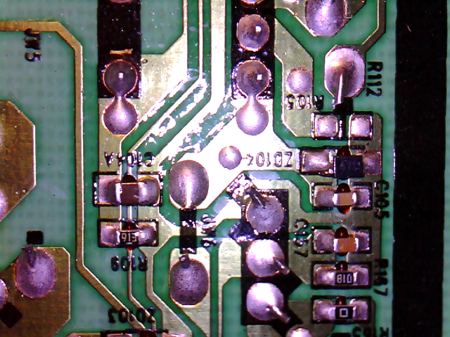

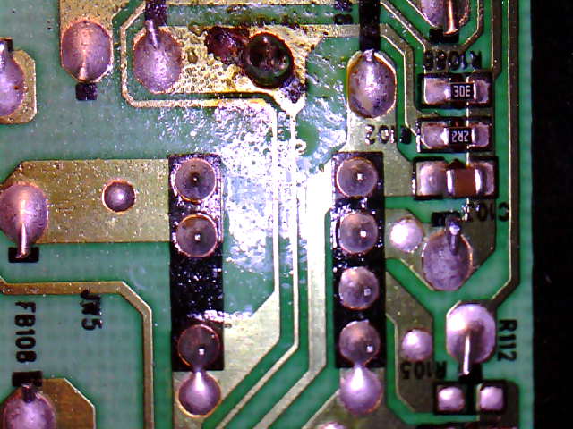

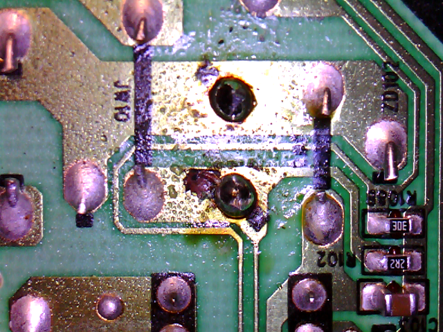

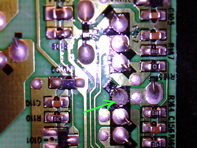

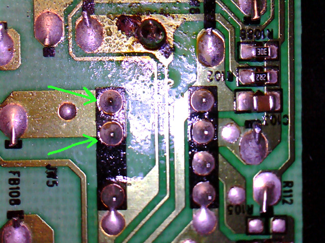

                                  I removed the board and inspected again. I still don't see any bad joints and I am posting pics. Perhaps someone else can see it.

                                      Look again. There are some joints which look cracked - you can see a slight ring next to the arrows I have added.
                                      Use your iron on all the through-hole component joints in that area an add a touch more solder to reflow all the joints.
                                      Also try to upload JPG files as they can be previewed more easily.
                                      -David VanHorn
                                      • bwilliams60
                                        • Aug 2014
                                        • 109
                                        #39
                                        Good eye. I will reflow all the joints in that area and get back to you. One other thing I did was check the optocouplers and the one in the middle gave me readings on both sides in both directions where the two outside ones did not. When I say that, I mean both directions on the diode side and both directions on the transistor side. Would this be because it is in the circuit or should all three read the same?
