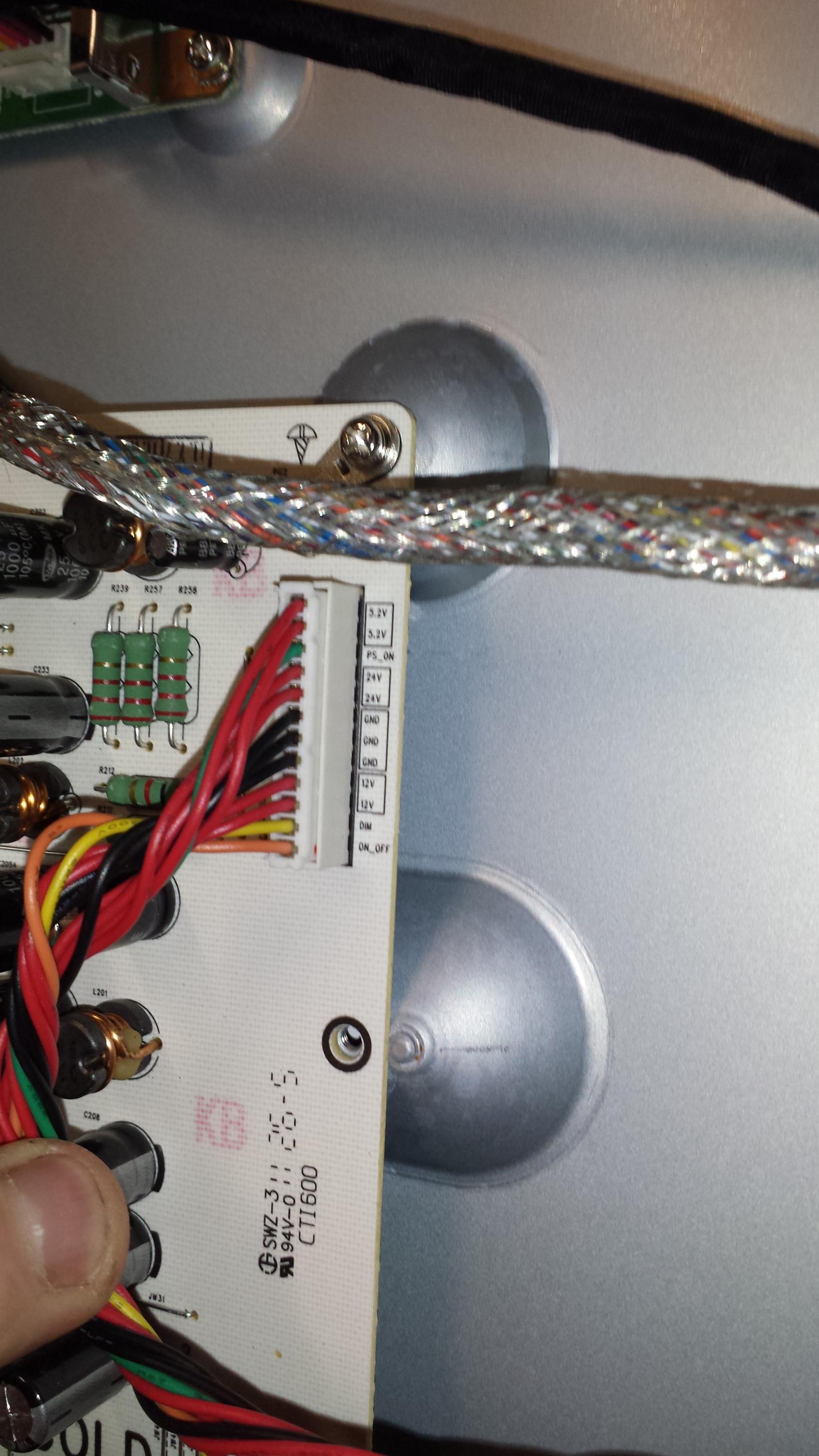

    I have this 47" Vizio that shows no signs of life. No indicator light, no video, audio, nothing.
    Checked power supply, no voltage out of any of the connector pins and no voltage for PS ON. Checked on the cold side of the transformers - no voltage.
    Went to hot side, checked voltages at rectifier - found 60V, 120V, 0V, 60 V respectively from left to right.
    I will post pics later for this unit but just wondering if anyone might have a schematic for this power supply. I know it is dead, just need to know where it died.

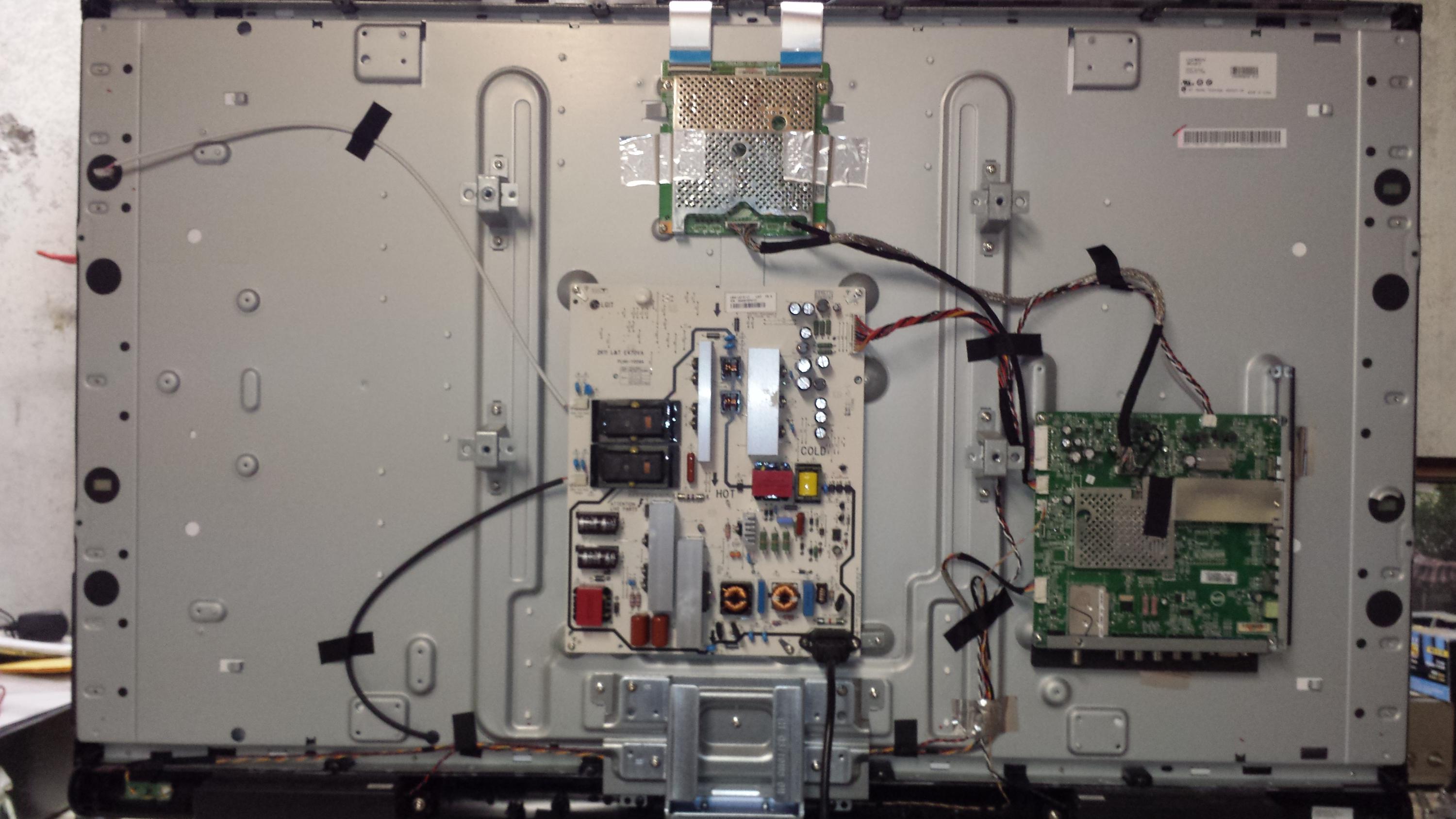

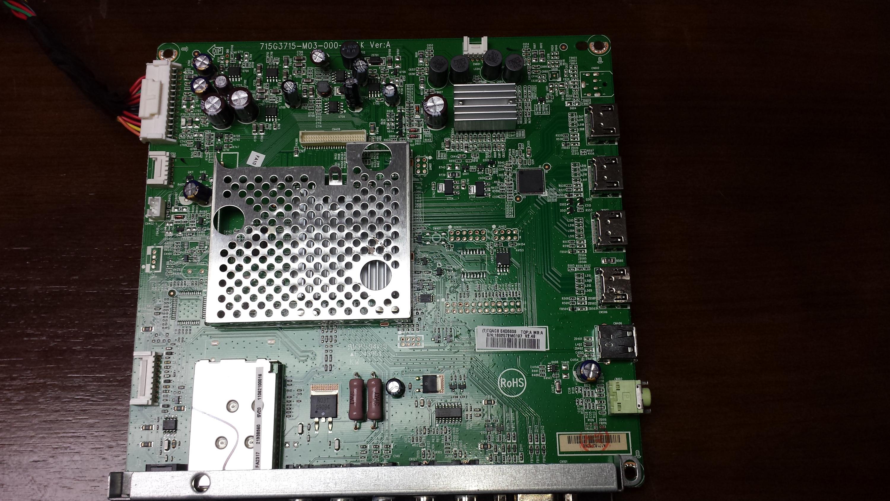

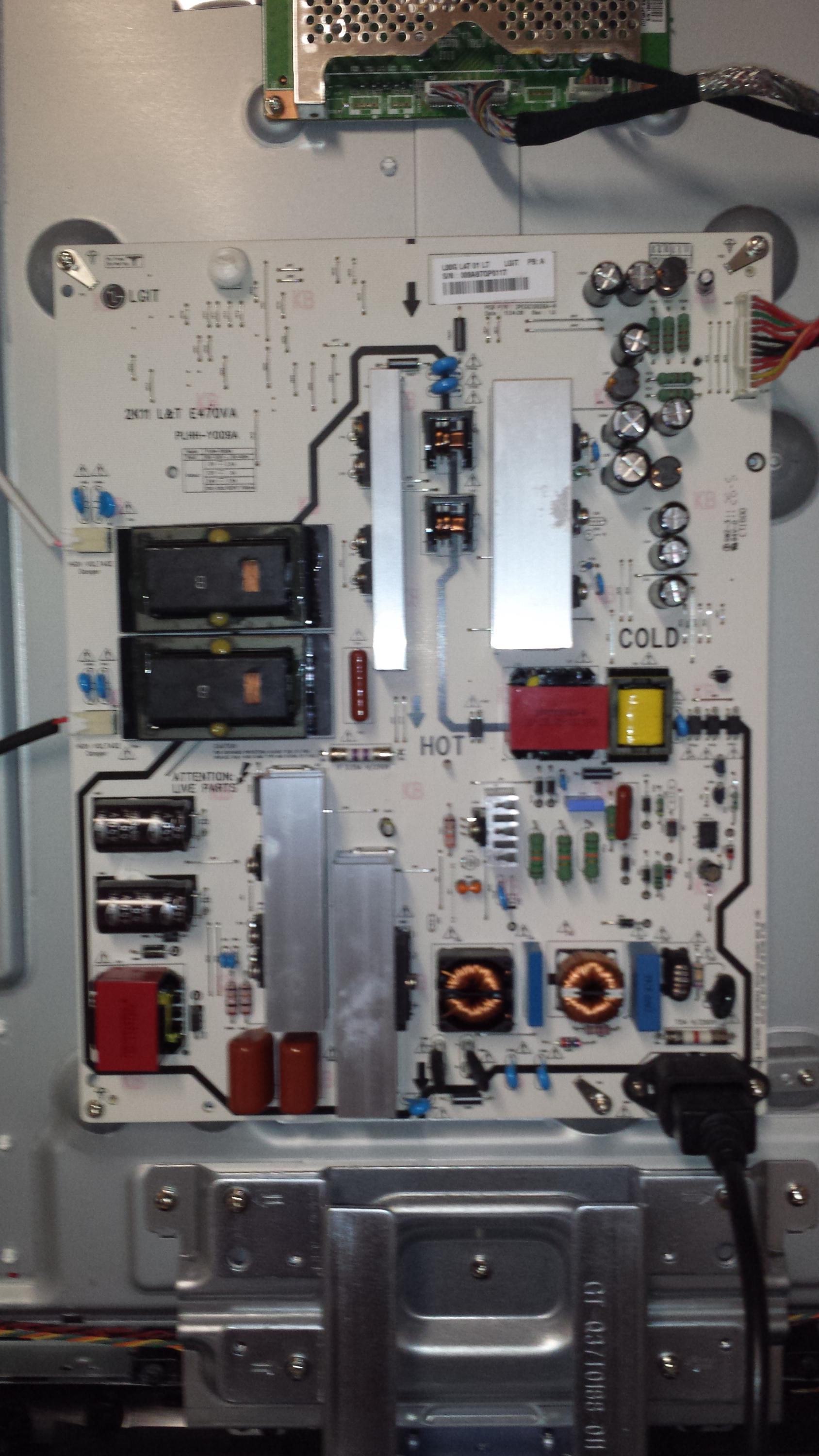

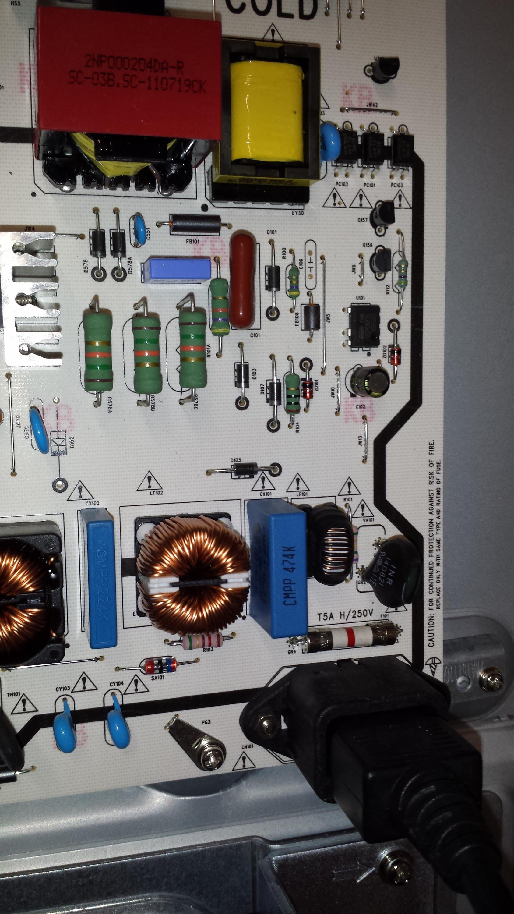

    Update to my dead Vizio. I am uploading pictures of the set. There seems to be no voltage from the power supply to anything. All voltages including PS ON is 0VDC. I would like to troubleshoot the power supply if that is where I should be. There is no screen, not even VIZIO logo lighting. Dead.
      Re: VIZIO E470VA Dead
      When you make measurement in the Primary side you do not use chassis/safety Gnd as a ref. for your meter, the Negative leg of the main filter cap is the GND ref. for the Primary circuit. For Primary AC measurement, you will measure between Line and Neutral.
      So what DCV do you have when you measure between the two legs of the main filter caps.

          Okay I checked the DC voltage across the 68uF 450V caps and it measured at 165 VDC. I also have a new observation. When I first plug the unit in, the VIZIO logo lights for a moment and then goes out. Also 5V found on PS ON for that same duration.
          budm, thank you for the ground tip. I was measuring from the chassis for all my measurements. So when I am checking primary side, best spot is on -ve leg of filter caps?
          Where to from here?

            So the standby 5.2V is no longer there?
            So none of the pins have any DCV at all for sure?
            http://assets.shopjimmy.com/media/ca...cgc10026ar.jpg
            It seems to me that the standby 5V was there and then disappear otherwise you will not see the VIZIO logo comes on at all.
            It may be EEPROM problem.

              Hi budm. As I said in post #5, the 5V can be seen on PS ON but only for the exact same amount of time as the VISIO logo lighting up. After that, it is gone. No other power that I can see.
              Can this be repaired at the component level? What else can I check?

                I am not looking for PS-ON signal, I am looking for the standby 5.2V to see if it is present and stable or not, no steady standby 5.2V then nothing will work.
                So per your statement "No other power that I can see" so the 5.2V appears and then disappear at the 5.2V pins?

                  I am sorry budm, I am fairly new to this so I hope you have some patience. I measured the 5.2V terminals, which are the top two in the connector as I turned the set on. It came right up to 5.09 v right away and then dissipated down to 1V when the logo shut off. After that it slowly drained down to nothing. I tried it again with the control board disconnected and it did the same thing, but took longer to do so. I will recheck my other voltages as I power it up and see what comes up.
                  EDIT: Here is what I found on each terminal as I powered the set up.
                  5.2 -> 5.1 and then dissipates down near zero
                  PS ON -> 4.92 and then dissipates
                  24 -> 24.87 and then dissipates
                  12 -> 11.82 and then dissipates
                  DIM -> 3.4 and then dissipates
                  ON_OFF -> 0.5 and then dissipates
                  Hope this helps

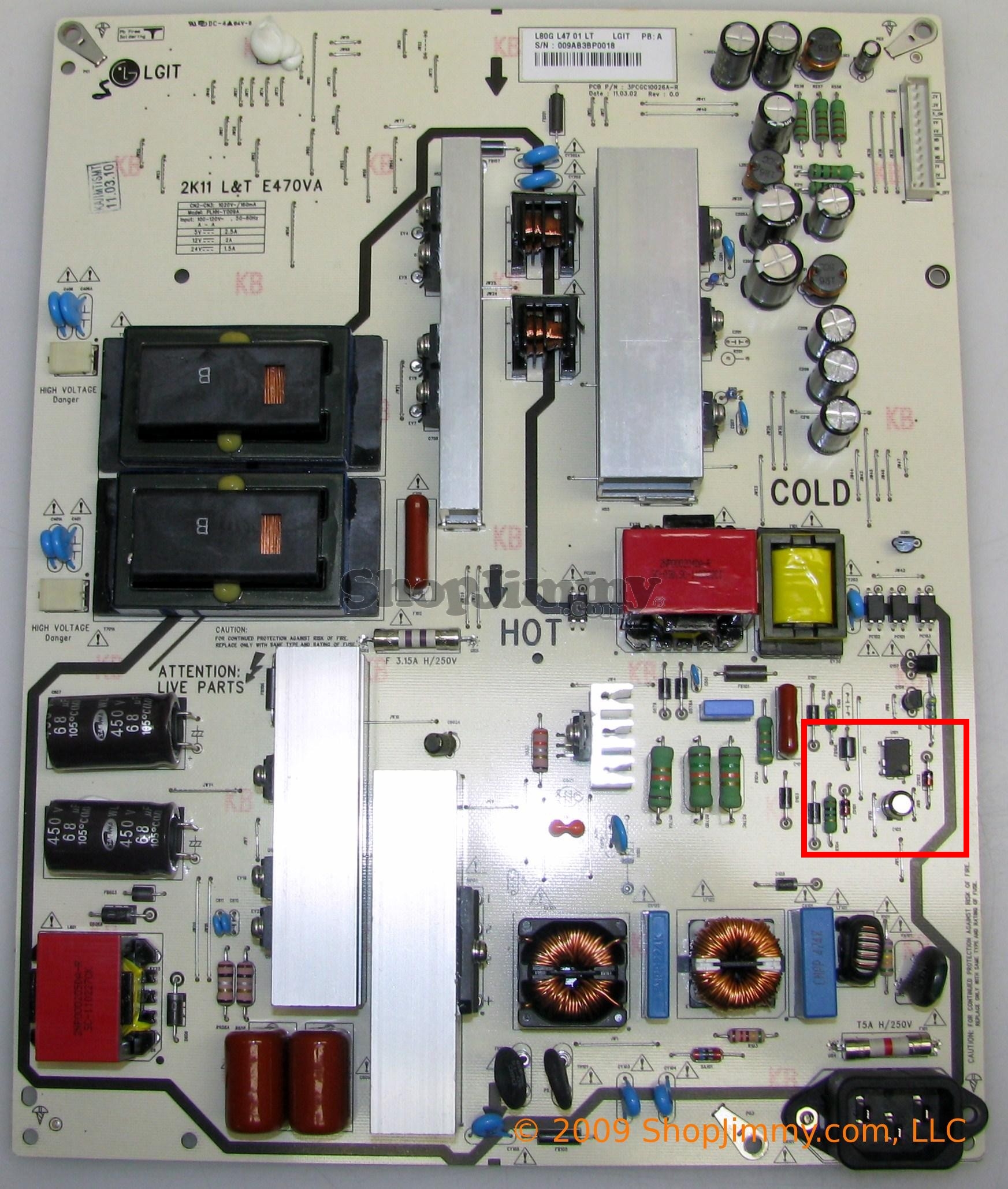

                    "It came right up to 5.09 v right away and then dissipated down to 1V " OK, that is not normal, the STANDBY 5.2V is an always on power supply that is running 24/7 hwne you have the TV plugged into the outlet. So it is either there is problem in the standby pwoer supply or the main board is load the standby power supply.
                    You can try this quick test, unplug the TV from the outlet, then heat that section I marked with hair dryer for 2~3 minutes, then plug the TV in and monitor the 5.2VDC pin, then turn the TV and see if the 5.2V will stay on at 5.2VDC. When STBY power supply drops out, every thing will drop out with it.
                    Picture provided by shopjimmy.

                      Budm, you are a genius. I'm not sure what we just did, but it works! I heated that section of the board up for three minutes to about 130 degrees, plugged it in and 5.02VDC right on the nose. Pushed the On button and the screen sprang to life and No Signal started dancing around the screen. Very cool.
                      Okay, so what did we just do, and how do I fix it from here? Was that the 5.2V power supply section?
                      One other question. What are the components that look like diodes and are marked FB10x? I can't see any markings on any of them.
                      • retiredcaps
                        • Apr 2010
                        • 9271
                        The circled area by budm has a startup capacitor that is feeding the SMPS IC (7 pin IC). That capacitor likely has high ESR. By warming it up, the capacitor's ESR is lowered allowing the circuit to work.
                        Replace the capacitor with a Panasonic FC or FM capacitor from a reputable distributor like mouser or digikey.
                        FB = ferrite bead.
