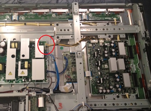

      Re: Repairing a Hitachi 55HDS69 plasma - no picture, or sound
      Some more detail, when I unplugged the connector circled in red in the attached image, there was no voltage (0.2V or less) on any of the pins of the connector on the power supply board. This was measured after the power-up routine was completed (no error LEDs lit on the control board, and solid Blue status LED on the front of the TV).
        I would suspect the buffer boards and possibly the ysus also, try unpluging the buffer boards from the ysus and see if the vs stays on.
        I have worked on a 55hdt79 with the same symtom, the upper buffer and the ysus were bad.
                So, as was pointed out here, the new power supply board did not resolve the issue with this TV.
                So, on to the buffer boards, as was suggested.
                I removed the lower one, first, and powered the TV on - the upper 1/2 of the screen lit up!
                So, the next step will be to find a buffer board (or a repair service) and install that and see if I can get this all fixed
