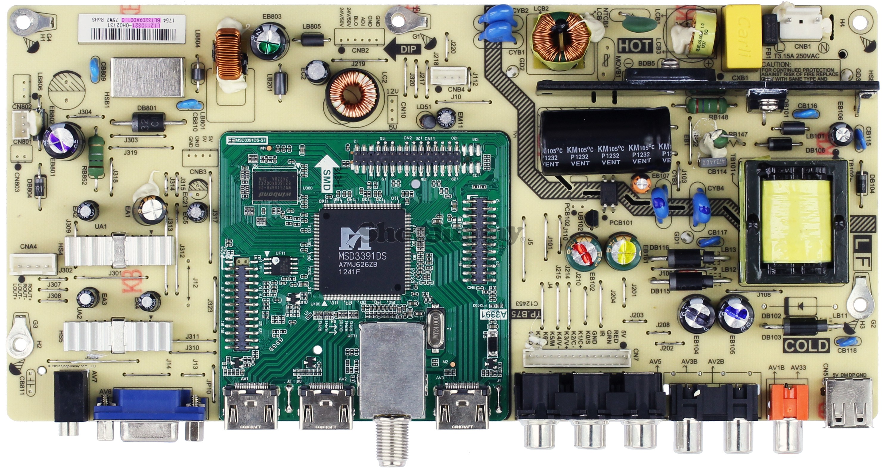

    i have another small project tv....tv was made in 2012
    its real cheap and cheap made led lcd tv so so investing more than a few bucks wont be economically smart
    anyways....its so cheap it has 4 boards built into 1
    power supply...inverter ....main and tcon all on one board
    all caps look fine...
    i have seen on shop jimmy something about eeprom ..that repairs a list of common issues with this tv....including backlight not on issue
    anyone have any experience ...it seems to be a very common issue with this model tv
