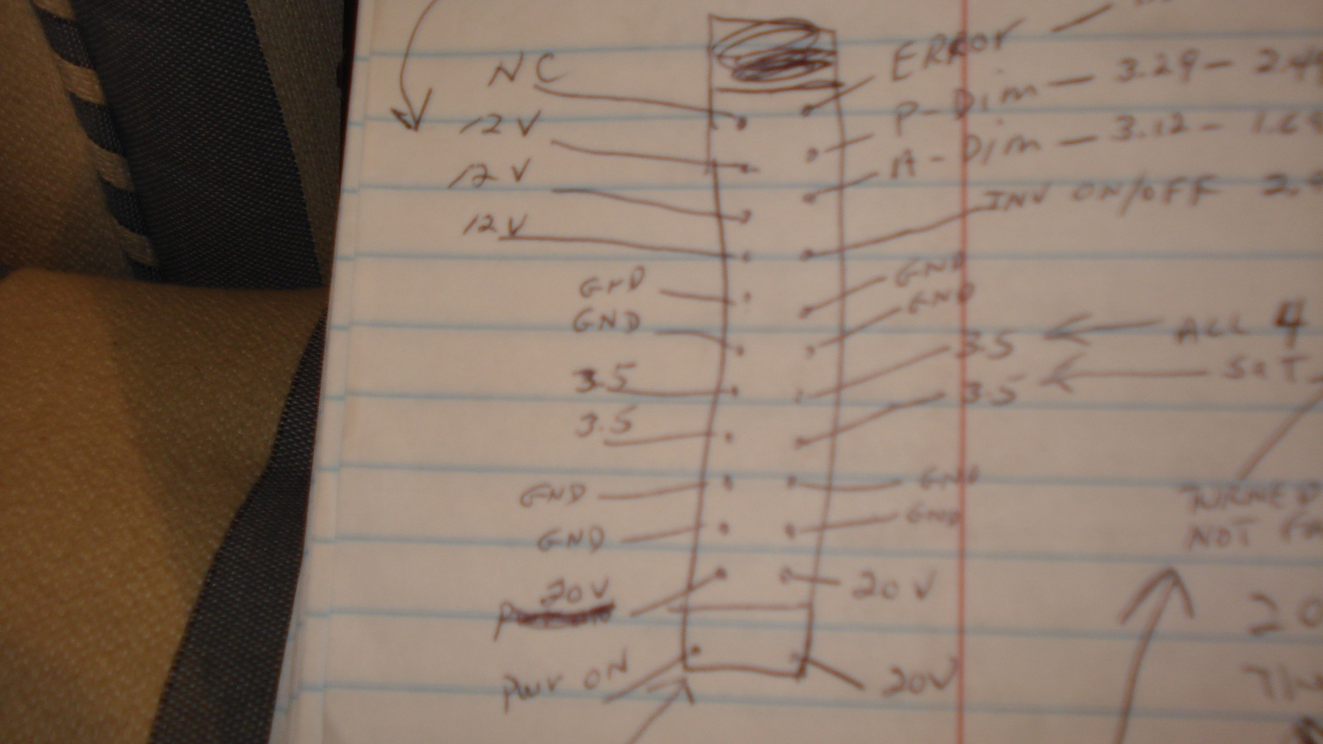

      The mainboard rail connector is Not labeled PSON but is actually labeled as power on, all voltages on the ps rail connector are normal As far as i know and all voltages drop to zero when the set shuts down, Except there are 4 pins with 3.4 volts and this voltage remains the same even when it shuts down.
      Backlights either flicker or flash off then back on 3 to 4 times right before it shuts down.

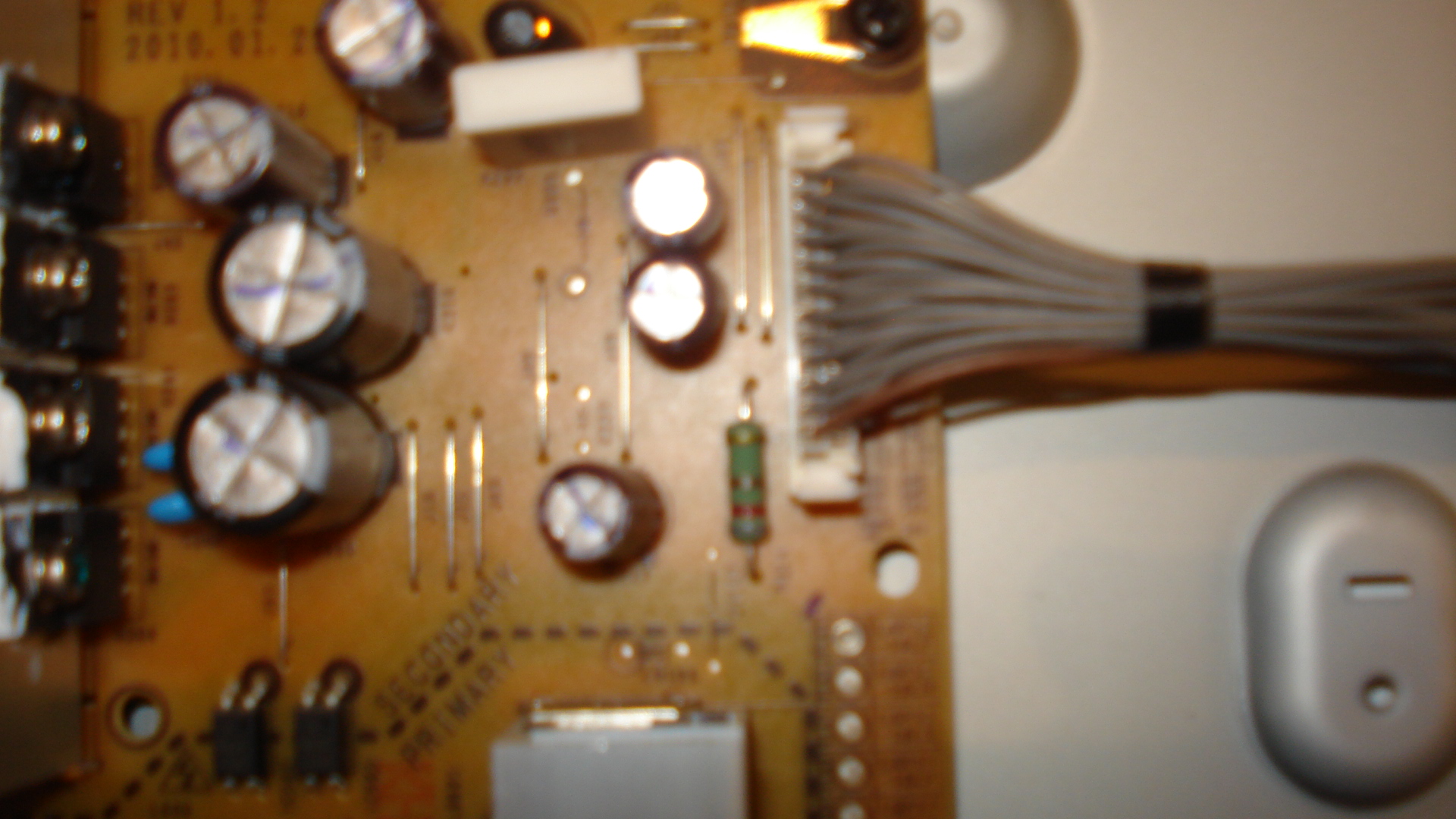

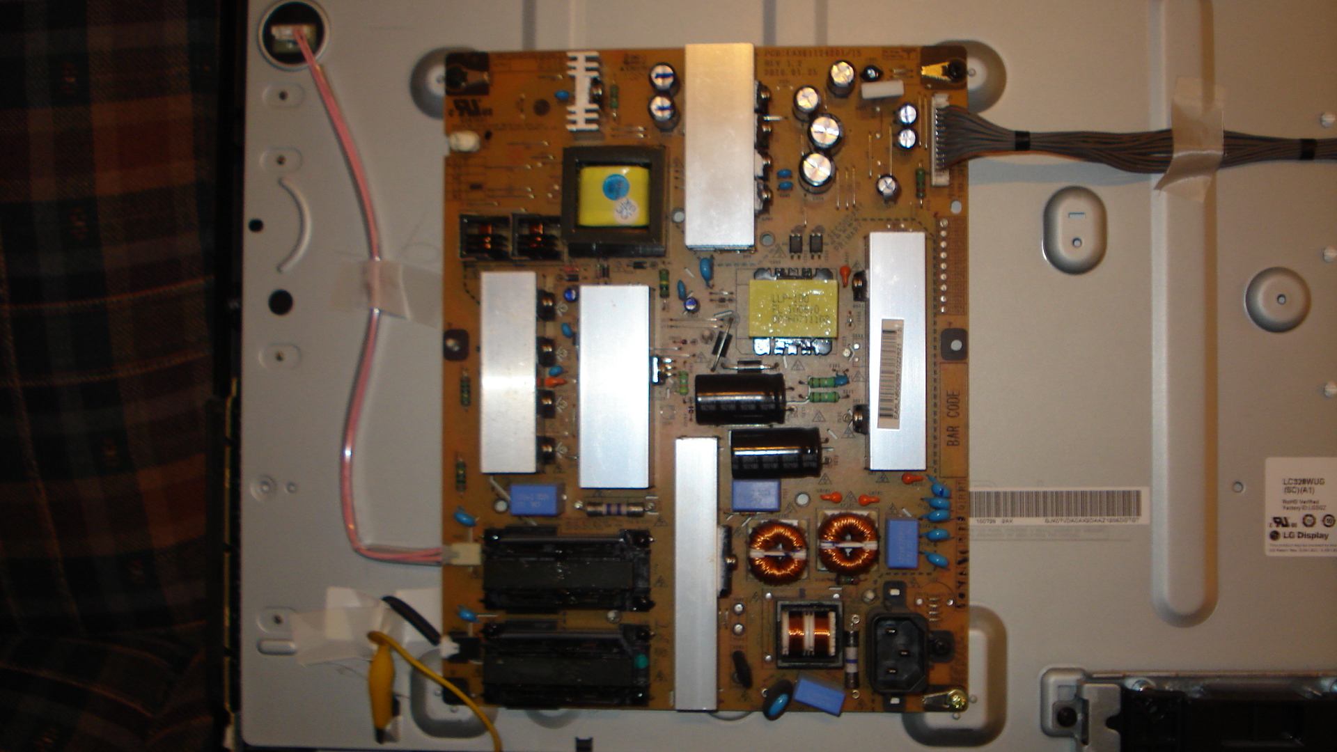

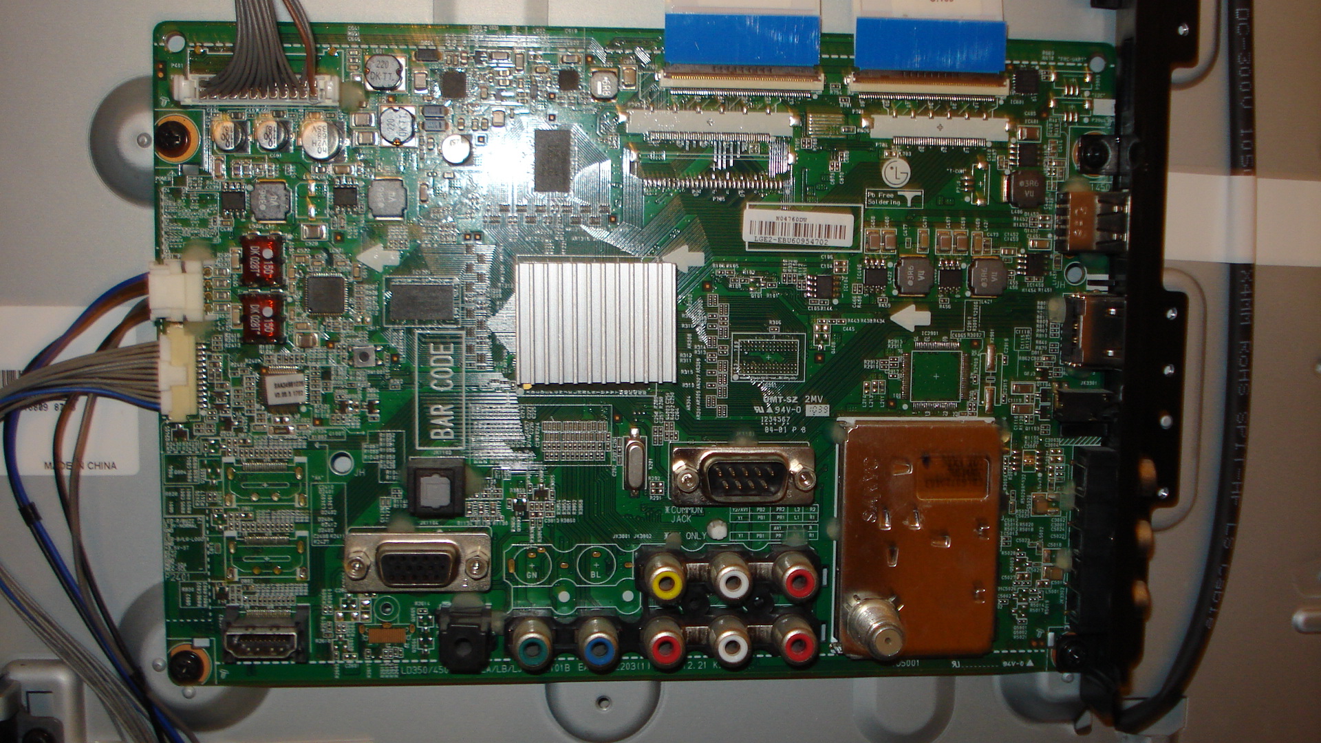

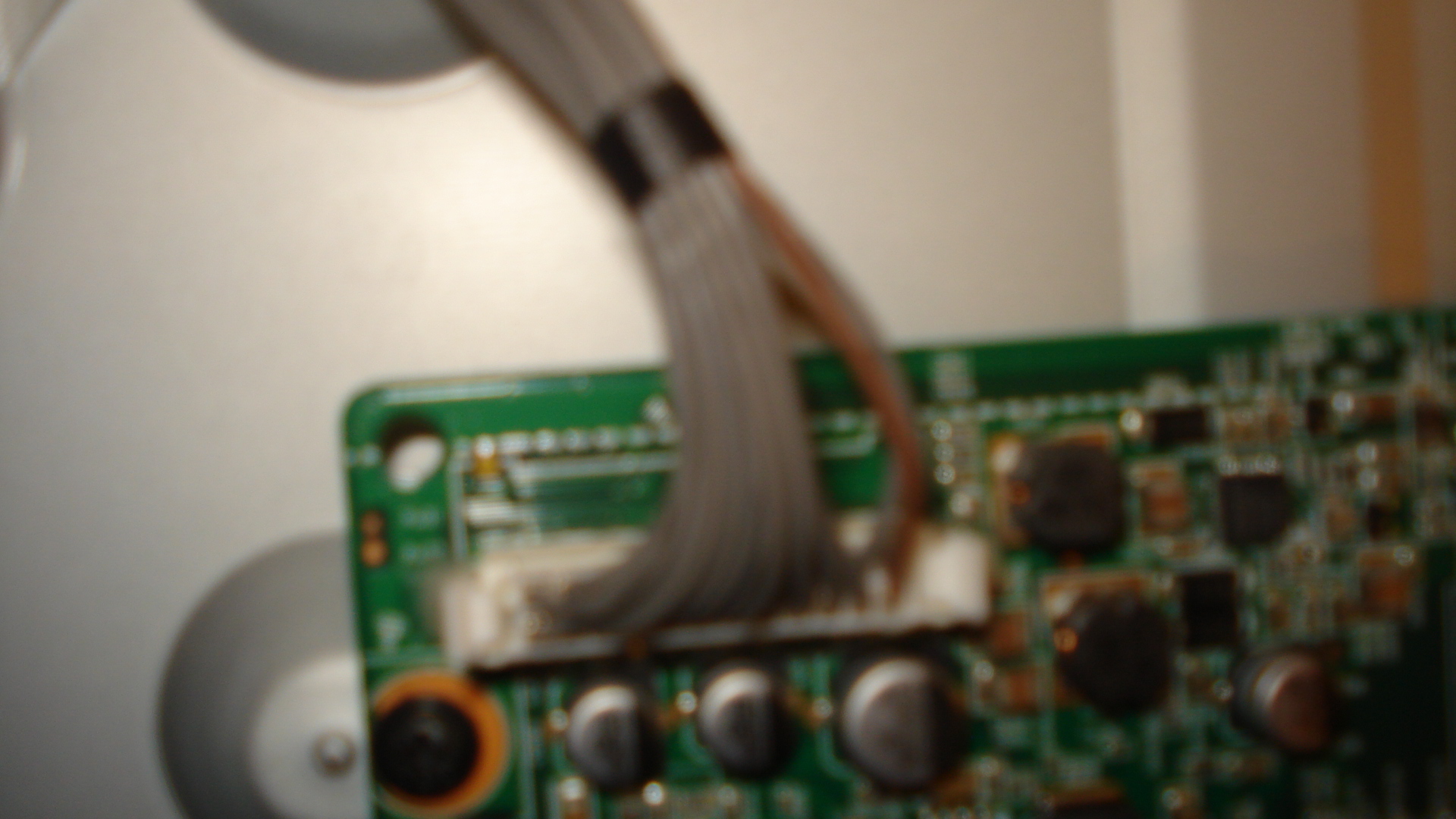

        Here are some pictures of the boards and a drawing of the main rail connector on the power supply with voltages I read with volt meter, sorry but my camera will not take good close ups. The Brown colored wire is the power on 3.3VDC
        Thanks in advance, your help is apprecitated

                      On the power supply rail connector I jumped through a 1k resistor from 3.5 to inv on/off, used 3v battery connected to power on, voltages remain on power supply rail but backlights are going off after about 15 seconds just like it did when tv was shutting down, now I wonder if the PS board is the problem, shouldn't the backlights stay on as long as I have the necessary voltage to inv on/off?
                      Also if I unhook power and let it cool down the backlights stay on longer the first time then the cycle gets shorter after it warms up.
                      I have the connector from the PS board to main board unplugged at the main board during this test. I don't see any bulging caps on the PS board. Need Help to diagnose the problem.

                              Bud, I have not changed any capacitors on the power supply board none of them are bulged out, could they be bad anyway?
                              They are Su'scon brand caps, main filter caps (there are two) both are marked sk 105 degree C 1021M all others are marked SG 105 degree C, the pair of main caps are stuck down on the board with the value and voltage facing into the glue. What should I do now? Order and change caps anyway? Do you think the main board is ok?

                                I had the 1k resistor leads shoved into the rail connector where the wire leads go in, and must not have been making a good connection because now that I have shoved them in more, the backlight has NOT gone off at all with the PS forced on and running about 45-50 minutes.
                                So now I'm thinking the PS is good and the main board is the issue after all.
