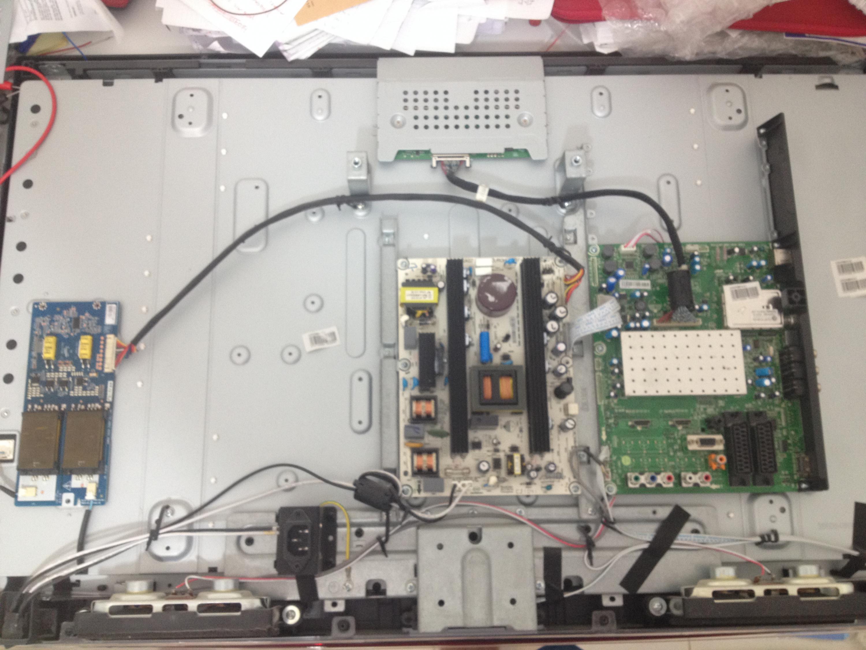

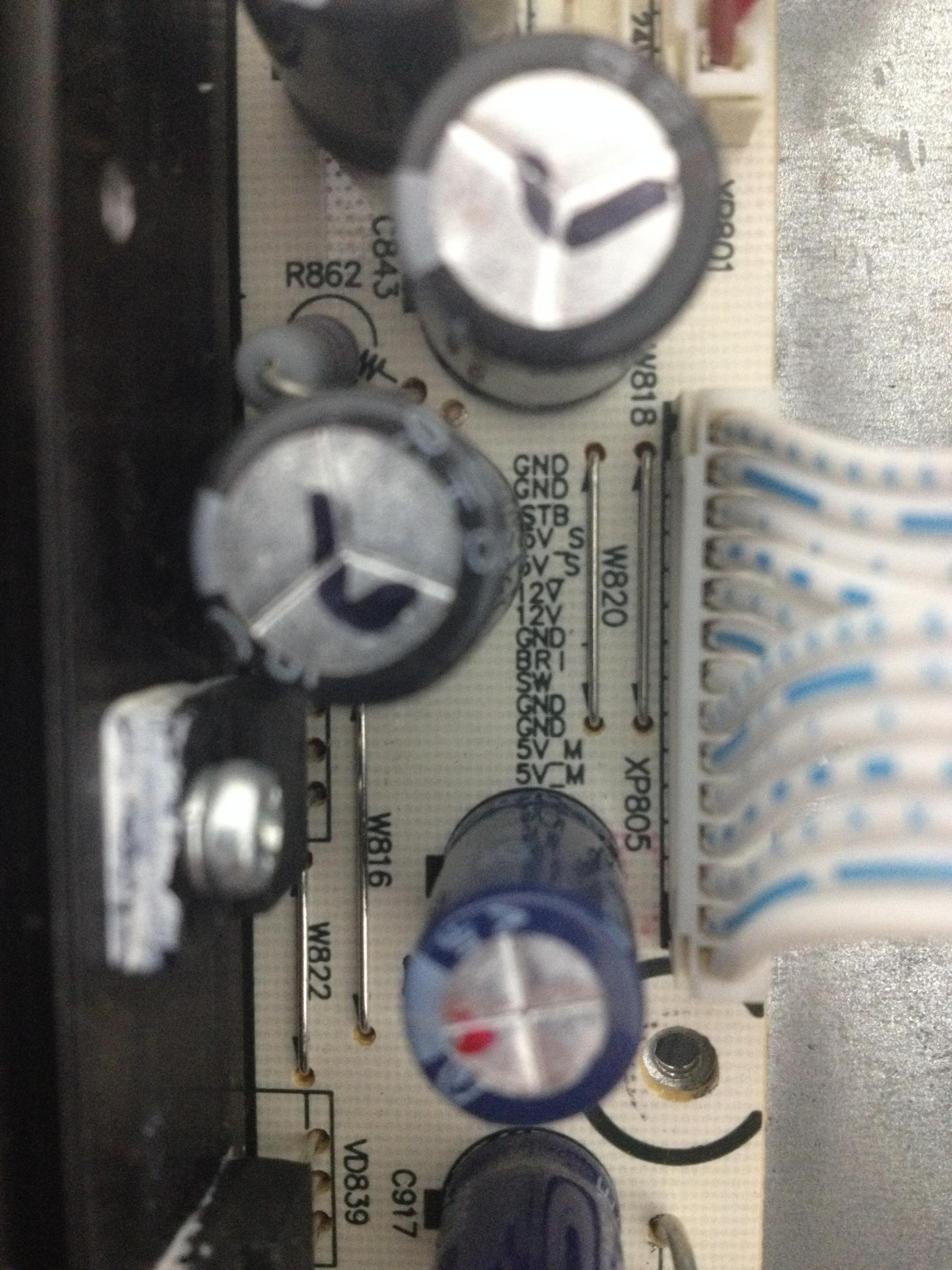

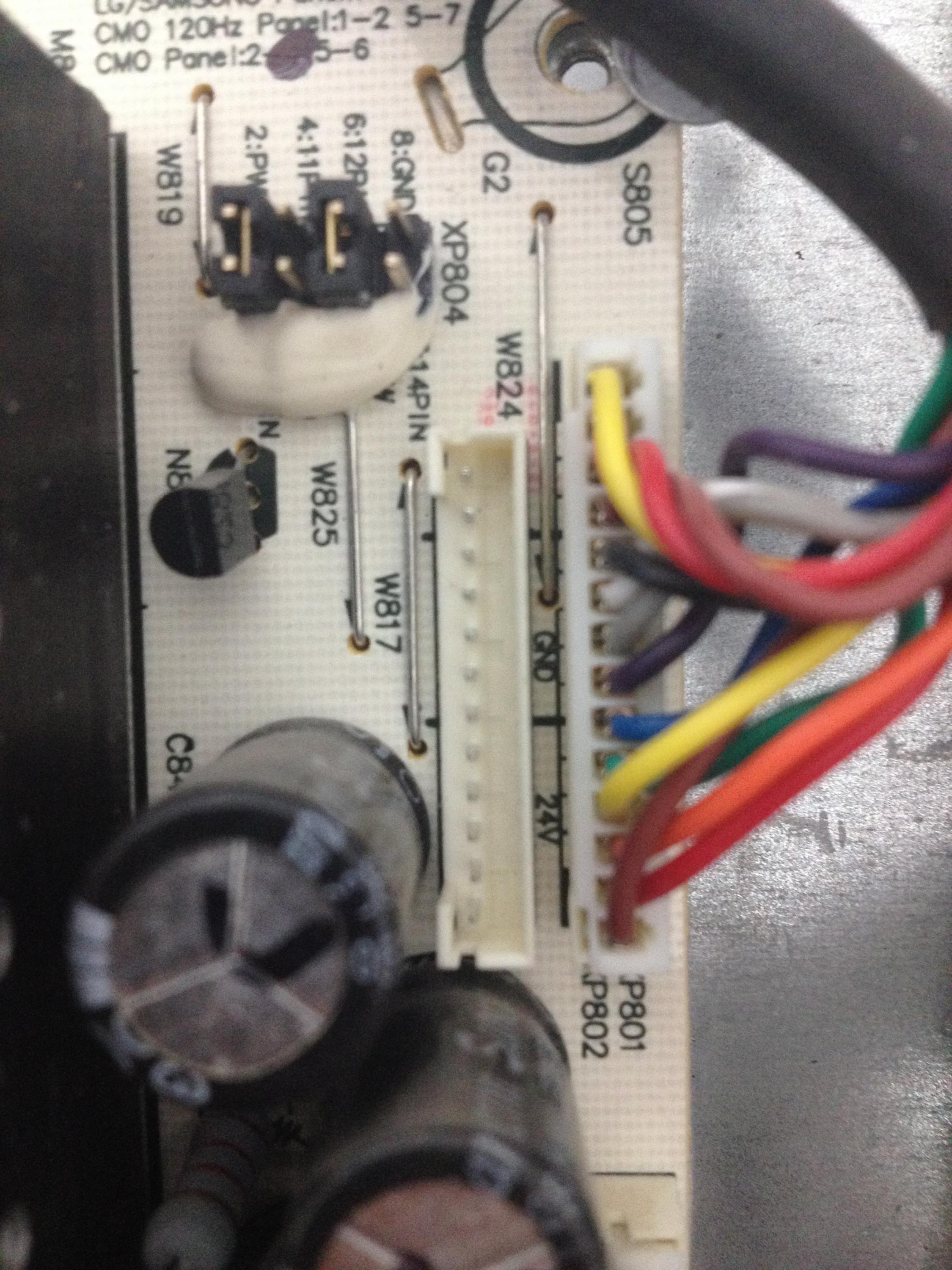

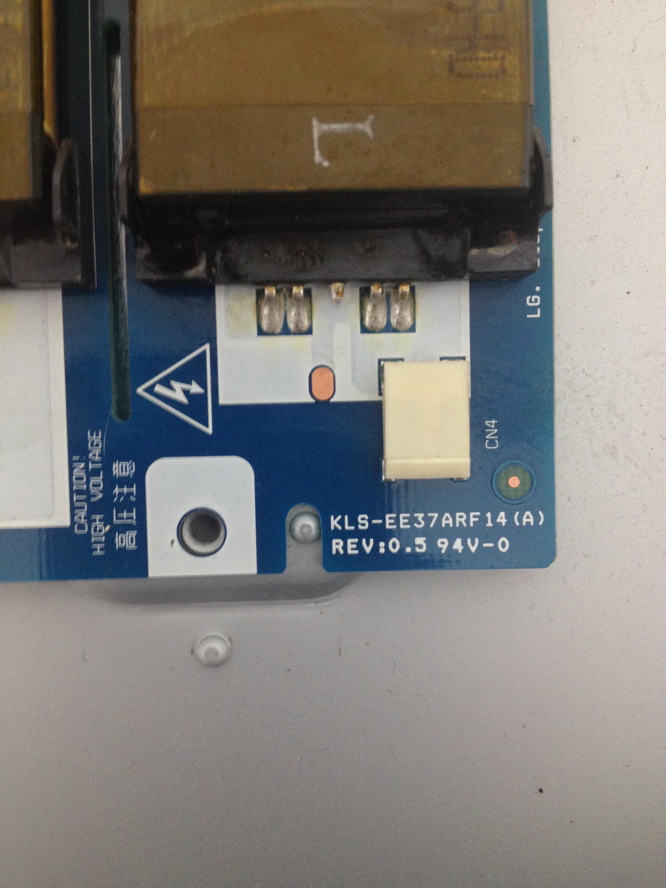

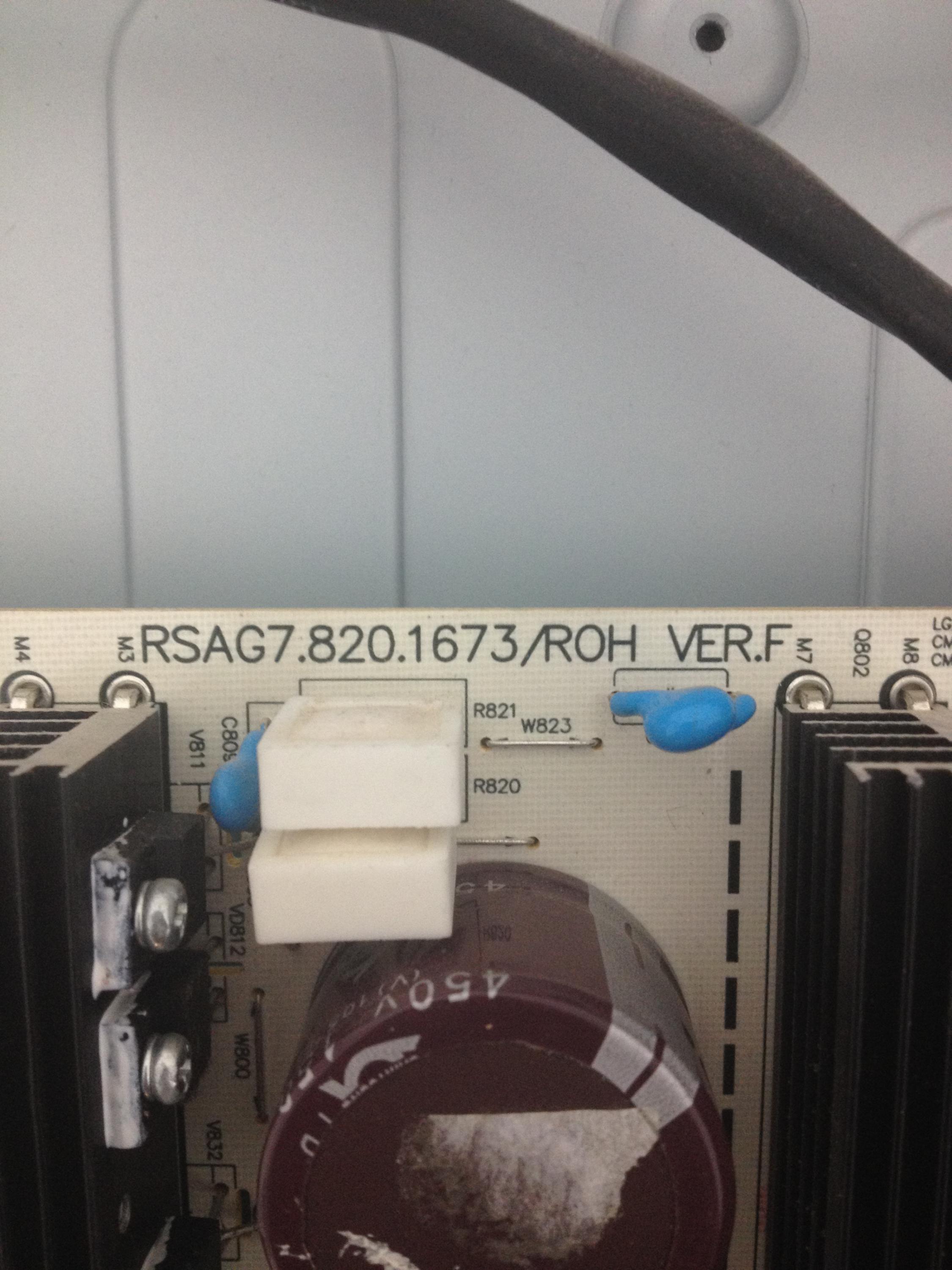

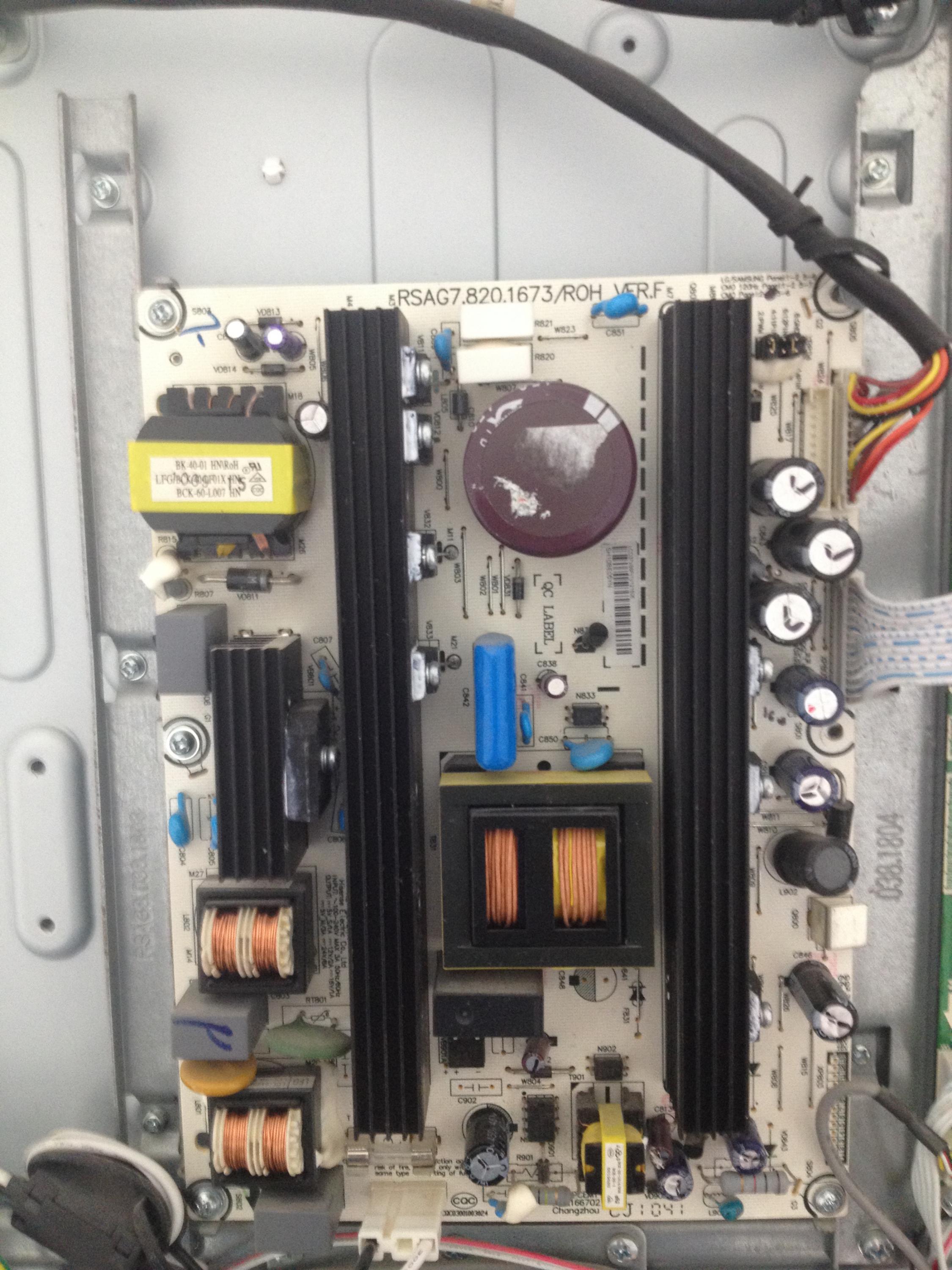

    Hi guys,
    Got this set, with not powering issue.
    I have a red light on the front panel (maybe standby) on and on the touch buttons.
    I have 24vdc on the inverter - but with no backlight.
    on touching the touch buttons i can hear beeps.
    i got 409vdc on main filter cap.
    on touching the power button i can't seem to power it off/ on i have steady 24vdc on the inverter.
    tried the flashlight trick but got nothing.
    i want to force start the psu and the inverter alone to isolate logic card fault.
    need your help with this one, the connector legend isn't clear.

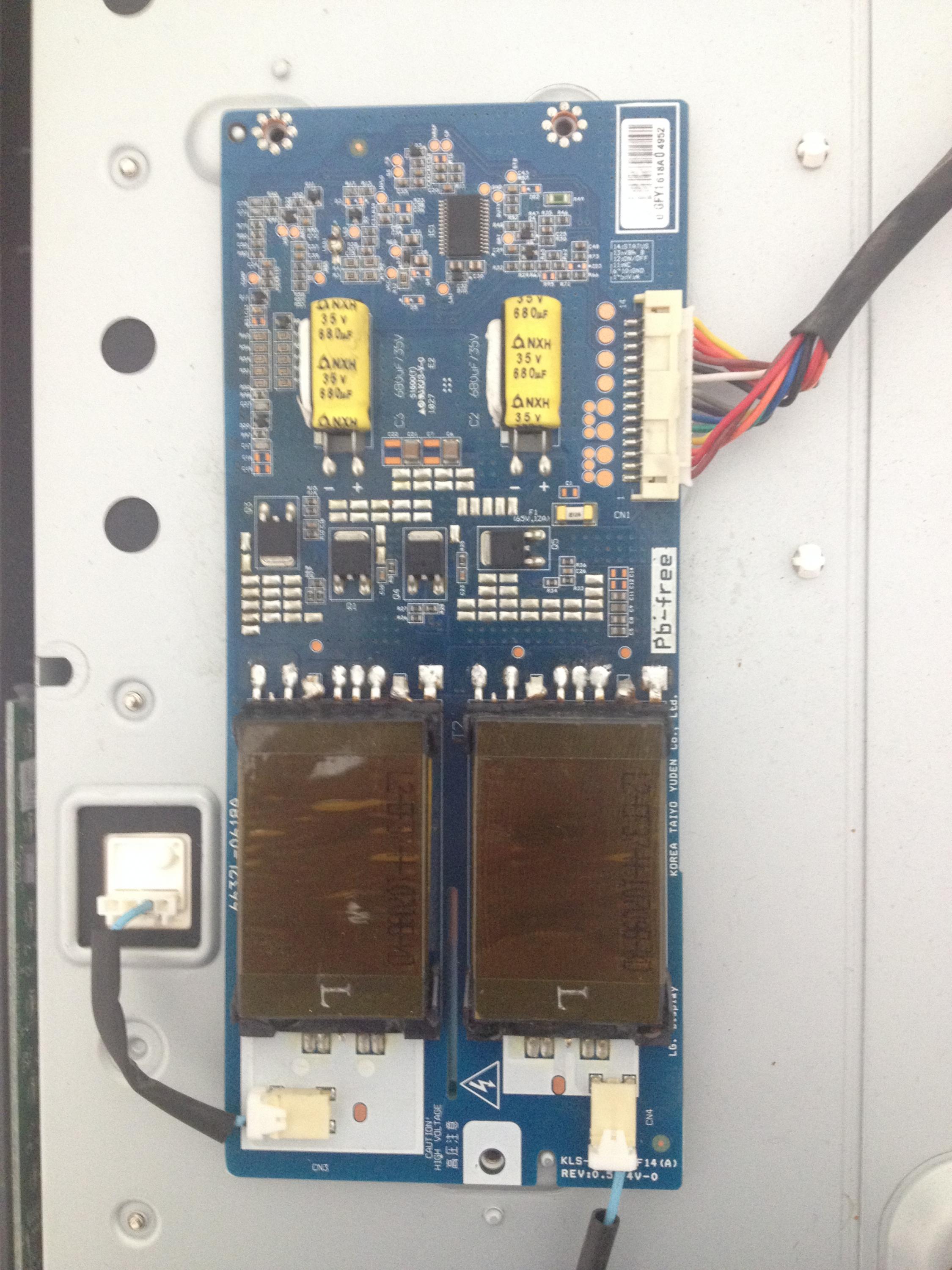

    Re: Hisense LCD37V88P not powering
    The power supply is woprking and it is getting the PS-ON to turn on the PFC Voltage booster circuit to produce the 409VDC on the main cap and the 24VDC for the Inverter board.
    For the backlights to be on you have to have the BL-ON (>2.5VDC = ON, >1VDC = OFF), and the DIM control signal.
    If you do have the control signals but still no backlights then you have ineverter board problem. So look at the labels on the inverter board connector to find those required signals.
    I can see the ON/OFF (BL-ON) pin 12 but I cannot read the rest of the labels, pictures are way too out of focus.
    The fuse on the inverter board is OK, right?
        "and what in your opinion the reason for not being able to turning the tv on/off?" That is the indcation of the main board problem and may be that is why it is not sending the ON/OF signal to the inverter board ON/OFF pin that you need to check.
        "what voltages should i get on the connector on the inverter from the psu?"
        Reply on post #2 "If you do have the control signals but still no backlights then you have ineverter board problem. So look at the labels on the inverter board connector to find those required signals.
        So check the DCV on that ON/OFF pin when TV is turned on.
        Your TV uses CCFL not LEDs for backlights. the LCD panle lookS to be made by LG, you can see LG printed on the inverter board.

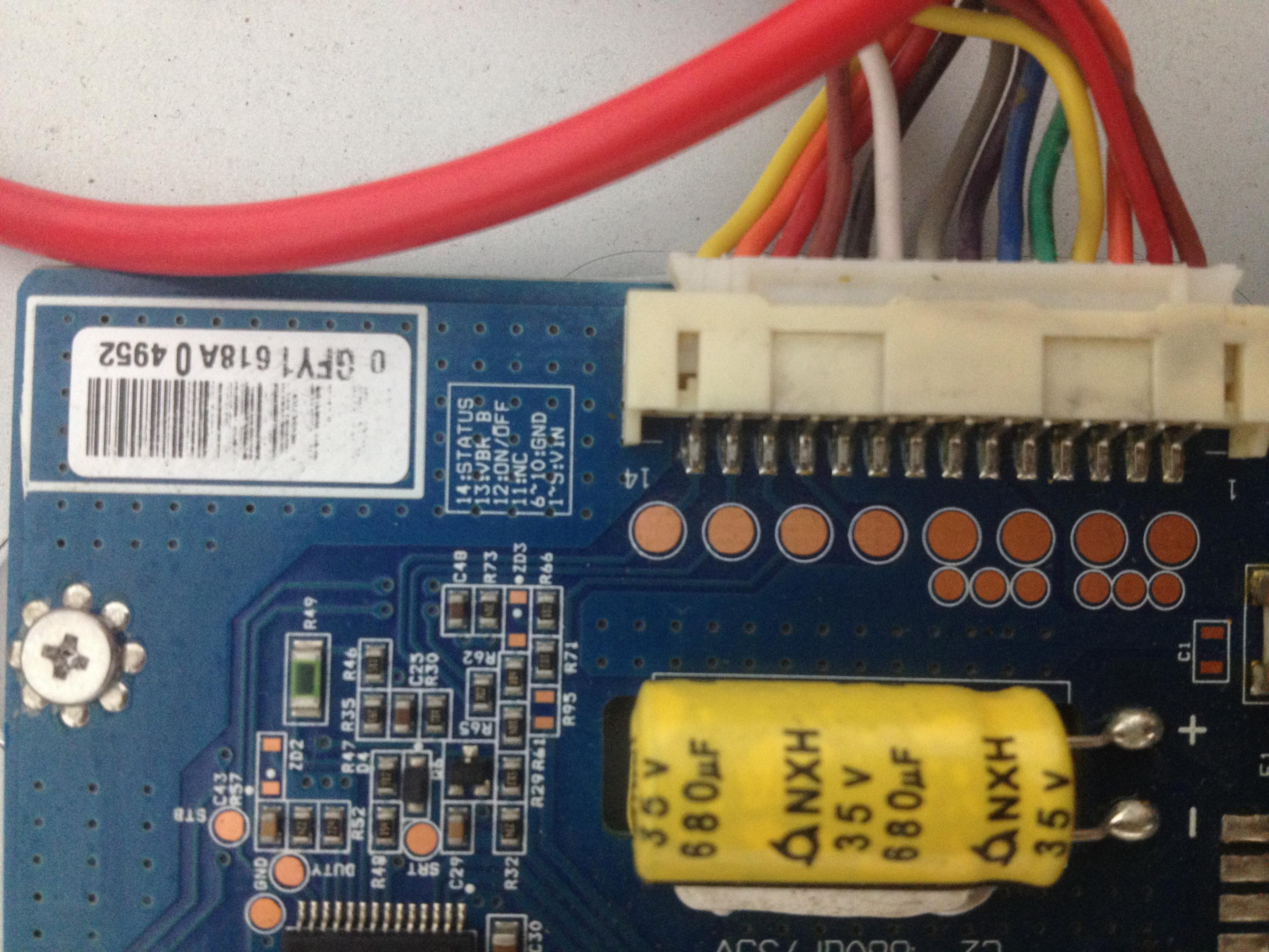

          ON CN1 (inverter board):
          PINS 1-5 : 24.79VDC (VIN)
          PINS 6-10: 0VDC (GND)
          PI 11: 0VDC (NC)
          PIN 12: 0.07VDC (ON/OFF)
          PIN 13: 0.037VDC (VBR_B) (maybe brightness?)
          PIN 14: 0.004VDC (STATUS)
          this means that the logic board isn't sending the on signal to the inverter right?
          could i simulate this signal by 1k resistor to GND OR 5V?
          i don't know if its active on LOW or HIGH.
              Your BLon signal isn't there.

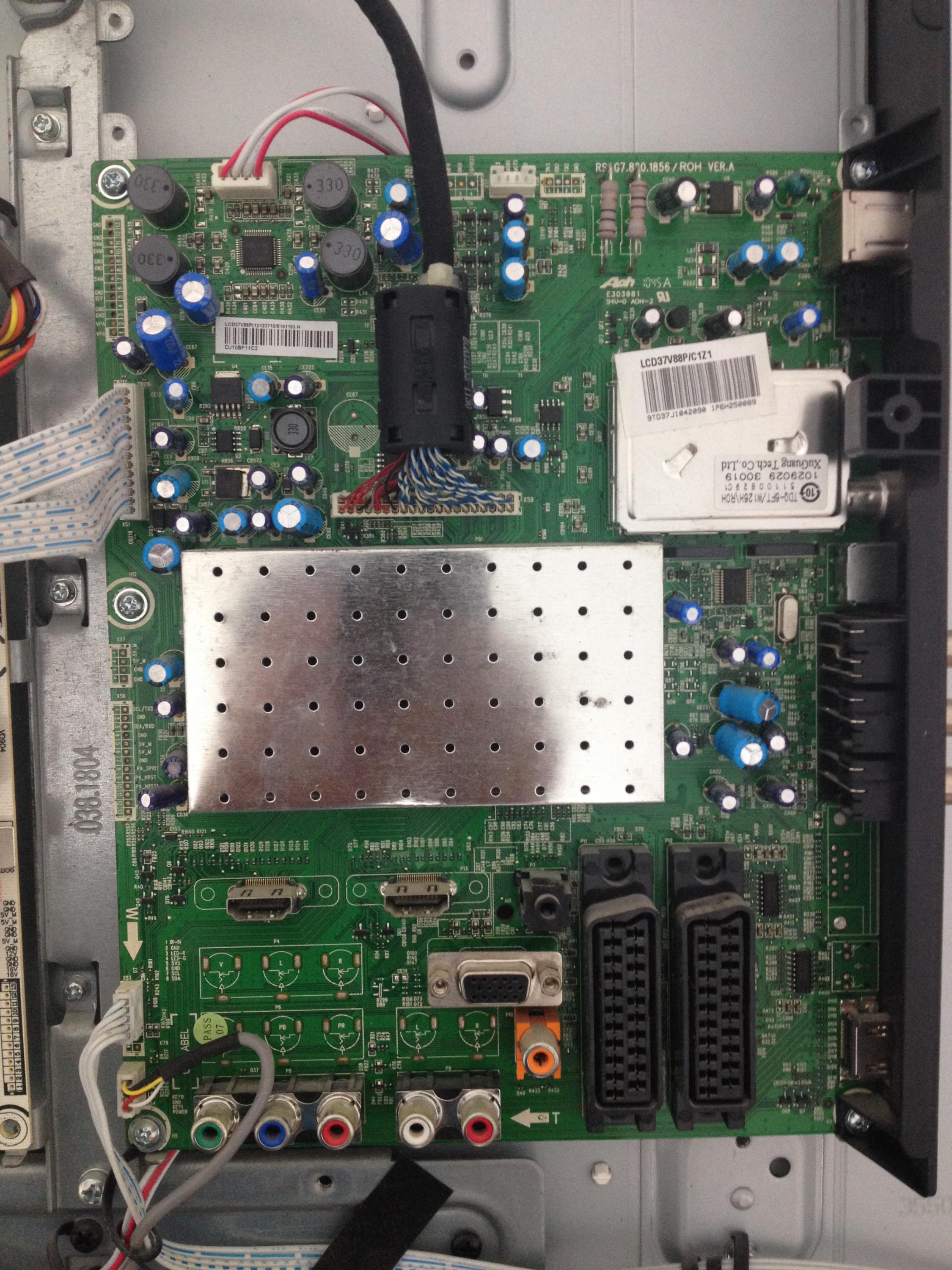

                so this means i have a bad mainboard?
                what do think, this one might suit? RSAG7.820.1621 (the original was RSAG7.820.1856)
                      Some progress:
                      I got the mainboard from china, got a little mad for being fooled by the Taobao agent:
                      'Taobeo Focus'- don't buy from him. he overweight your package so the shipping fee would be much higher.
                      this mainboard weighs 350grams. and the whole package weighs 1.15kg.
                      800gr of cardbox in cardbox in cardbox. instead of 5-10$ for delivery i payed 35$ for delivery only!

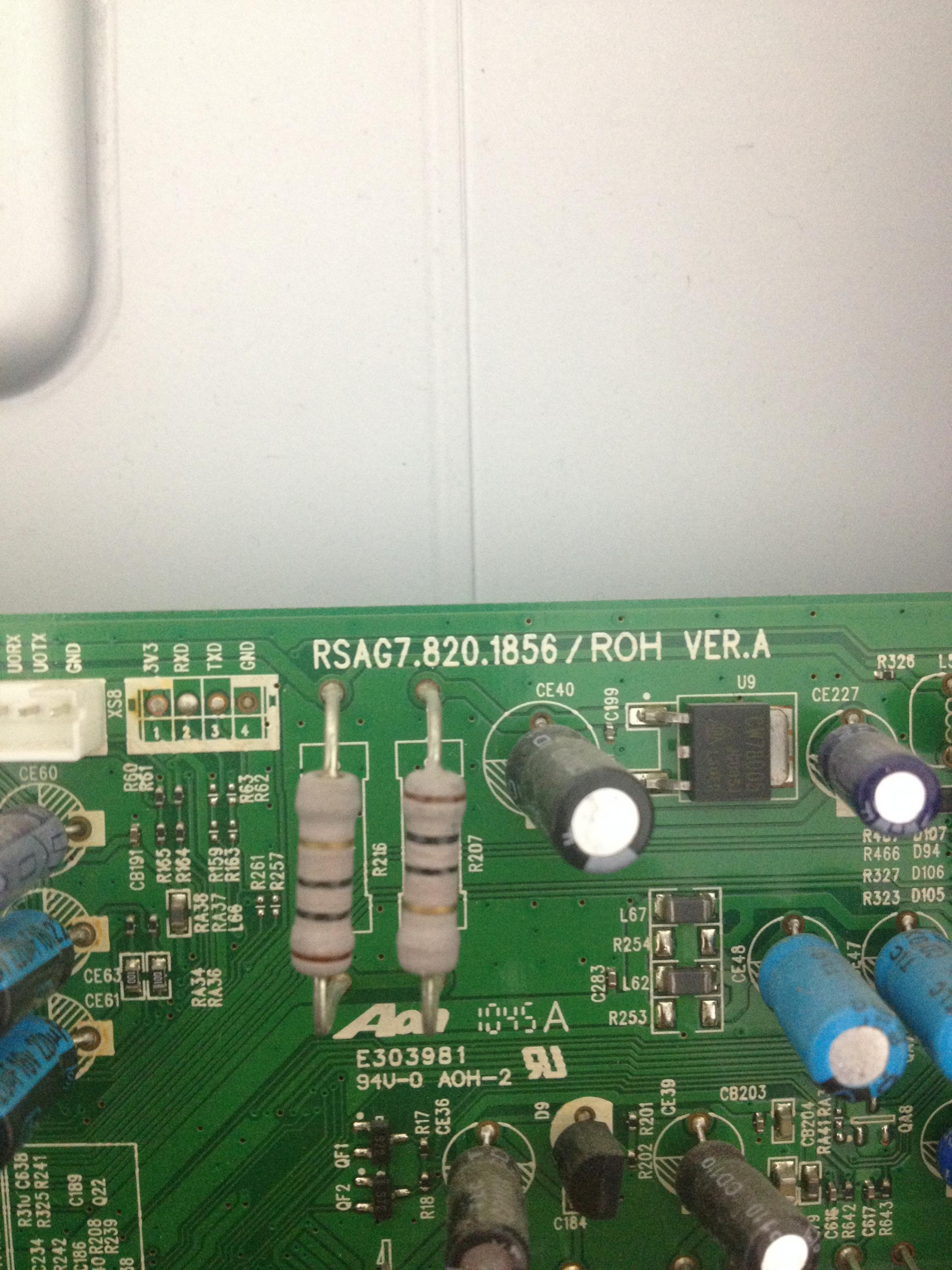

                      Back to the Tv:
                      now i can get it to power. the thing is that this mainboard was designed to work on a 42" instaed of 37". the control panel (touch buttons connector is 3 pins instead of 4)
                      i replaced the connector but still no luck. i can see that in my failed board i have an extra resistor which doesn't exist on my new board. i will try to transfer it carefully as it is very small.
                      i dont have the original remote. so maybe buying a universal remote would do.
                      any help on that too would be great!
                        Some main boards allow you change the screen size (37 vs 42") but that has to be done in service mode of the main board.
                          I took the resistor from the failed board, showed almost 0 ohms.
                          So i just replaced it with a short. i have lights on the touch buttons and i can hear beeps upon touching. but only the power button gives something->opens the menu. :-(
