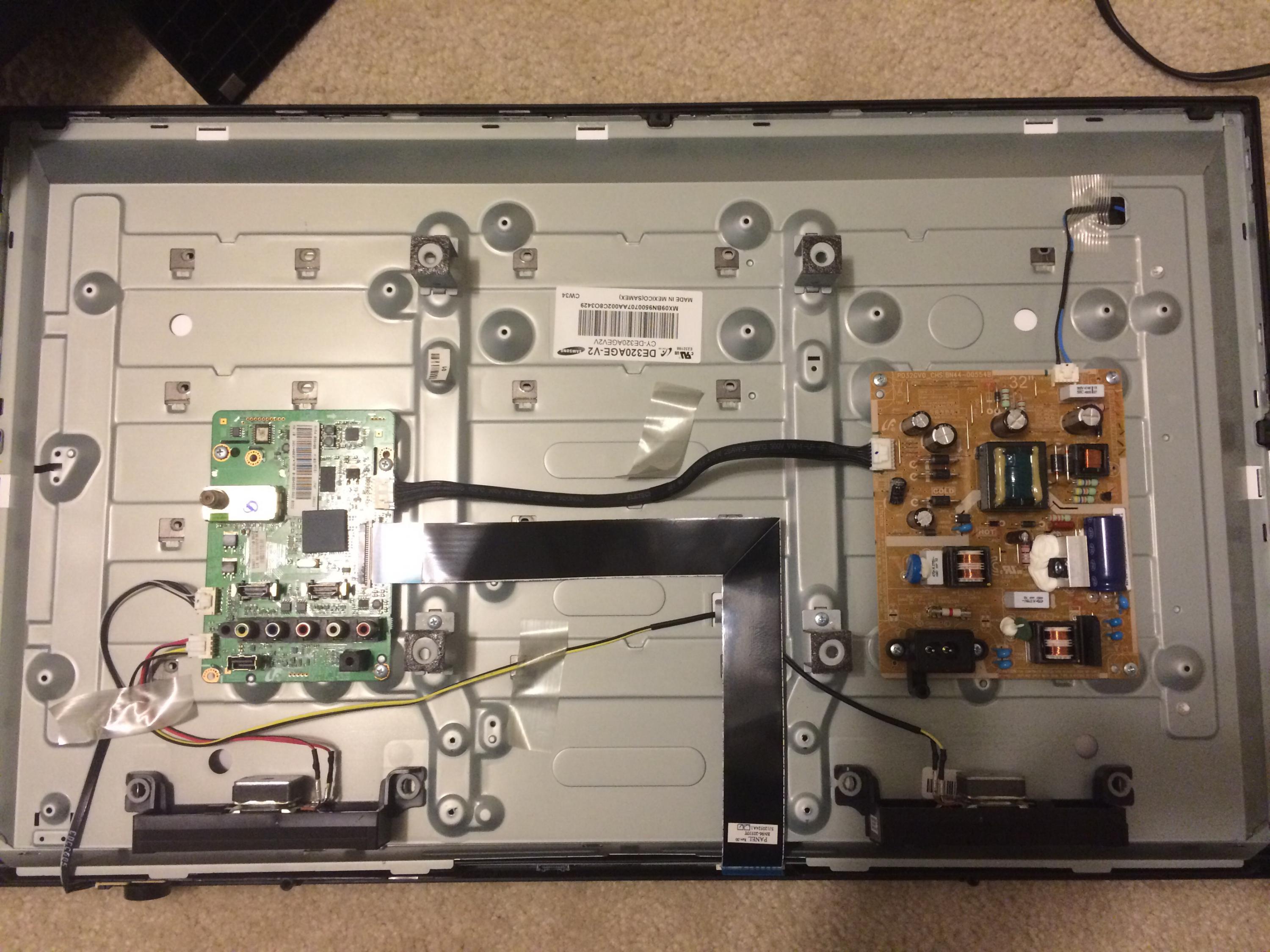

    Re: Samsung UN32EH4003FXZA, backlight on, sound but no picture
    Pictures, pictures, and pictures of the whole backside of the TV and the boards.
    More likely the T-CON is not getting the Voltage from the main board for the T-CON to run, but we really do not know for sure of what you have in your TV since we do not have the TV in front of us to see.
      Here's the pics I took. Thoughts? Thanks.

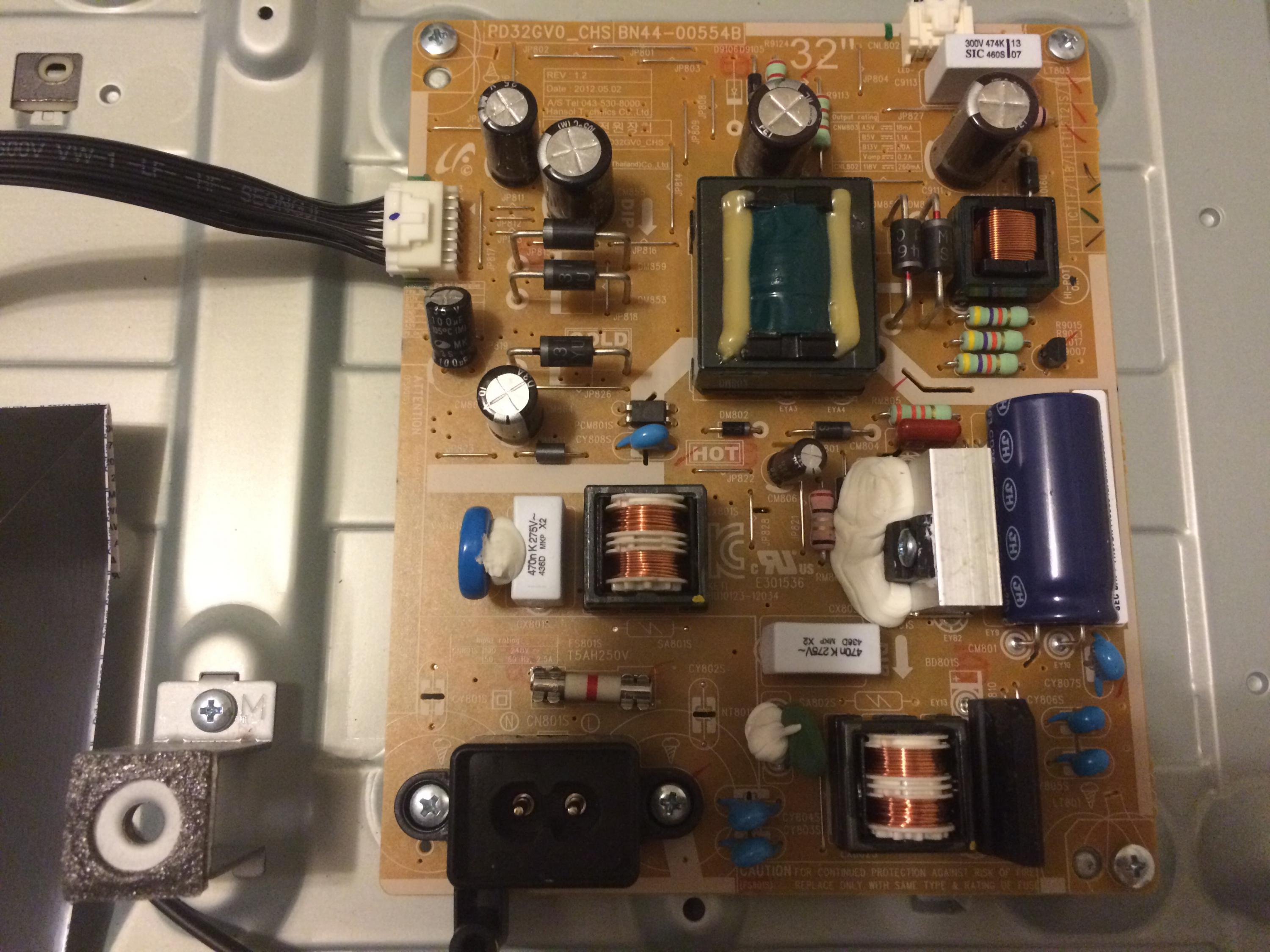

        Here's another one.

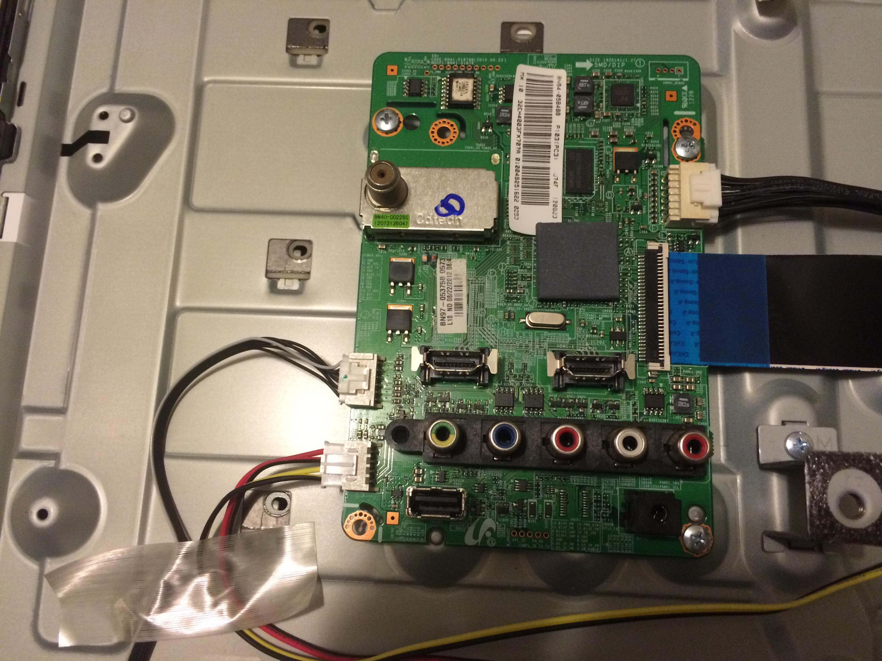

          And here's the main board
              This TV has integrated T-CON into the panel, so the only that you can do is to check the connector with that big black that goes to the panel and see if you do have 5V (or 12V) for the T-CON to run. This is not going to be easy because there is no label for the pins of the connector, you just have to trace out the connection to see which one is/are the power pin/pins.
