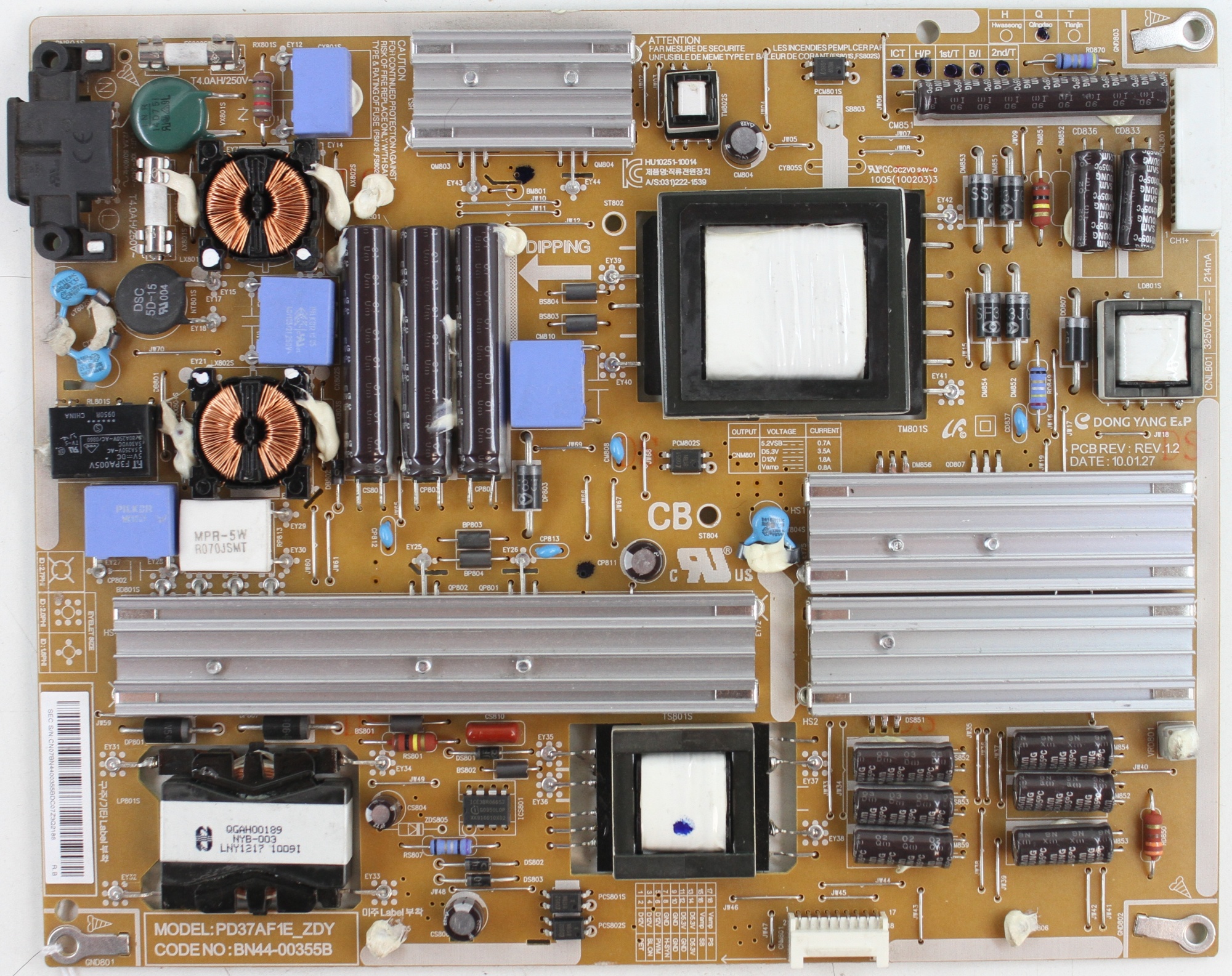

    Hi everyone.
    I have a Samsung UA32C6900 with a BN44-00355B power supply and BN94-03562J main board. The tv powers up, runs it's jingle through the speakers then turns the back lights on with an image on the screen (faulty colours but that's probably another issue). After a further 2 seconds the unit shuts off and then goes through the same cycle as if powered up again.
    I've measured the 5 volts and 12 volts from the P/S and they seem ok. It just gives up the ghost after two seconds of running the led back lights.
    Some web hunt about this problem has come up with similar stories that make me think either the eeprom on the main board may be corrupt or the power supply may have an issue. It's just two seconds is an awfully long time if feeding into a fault before deciding to give up, so I am going to try and discount it by disconnecting the main board and jumper the supply to on.
    I was just wondering before jumping right in if anyone has seen this type of sequence before with a UA or UE 32C series Samsung and what it might be.
    Thanks.

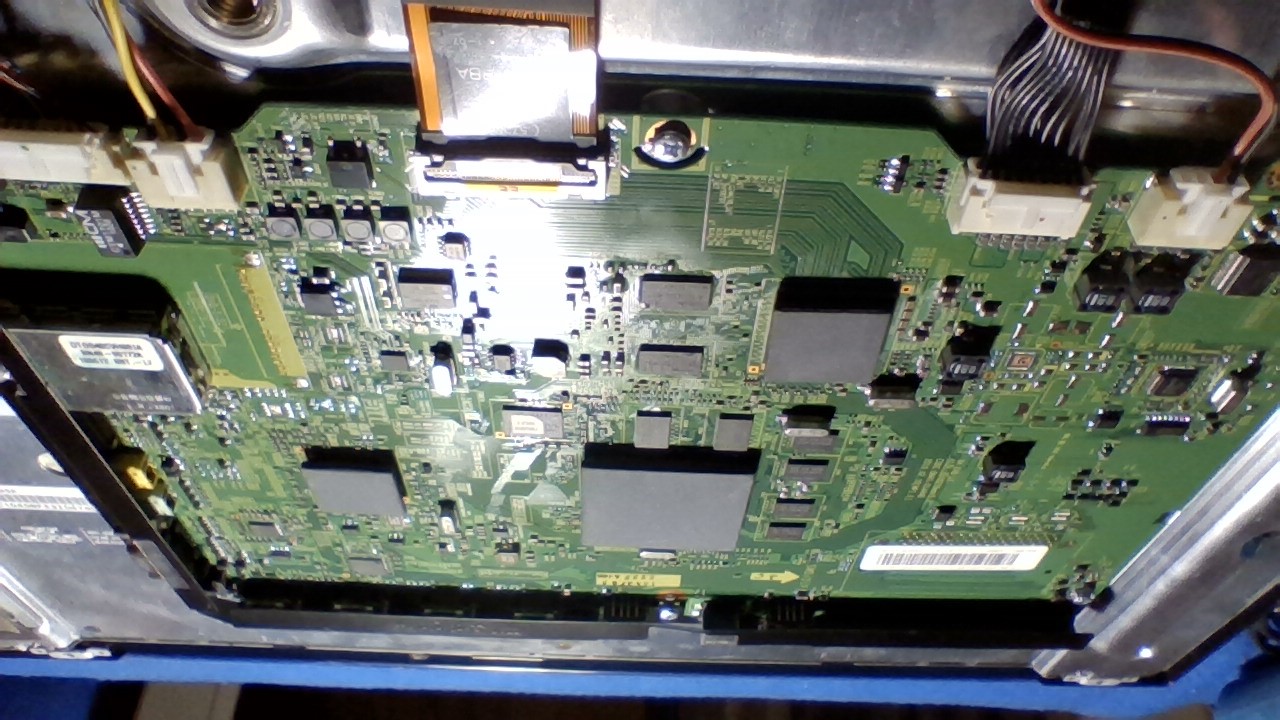

        just had same thing . was a cap under the metal shield on the main board . found it with heating and cooling .

            Could you try to find the fault just as Petehall347 did with heating and cooling areas of the board.
            • tiny68
              • Aug 2013
              • 33
              Re: UA32C6900 continuous restaring
              I can do the heating bit, but not sure about the cooling. any suggestions?

                was a metal shield with holes in if i remember rightly . try warming areas up anyway .
                • dick_barton
                  • Aug 2015
                  • 6643
                  • Wales
                  For cooling you can use a can of freezer spray or turn a can of compressed air (for dusting keyboards) upside down and spray.

                          Theese recent boards has no shields on them, Petehall is having mistake i guess. The problem is much probably software and has no other solution than MB change, anyway there's a little chance that that BGA chip that has lines that feed the LVDS cable (FRC chip) has soldering problems. Another little chance of any other thing connected to this chip like ram or V reg. is half short circ.
                            Budm - yes sounds very similar to OP, with constant reboots and the voltages seeming ok, although I can't be certain that the image issues I see are the same as OP. I will try to upload a photo later in the week (I've put it aside to work on a different TV for the moment.
                            Davi.p - you could be right about needing a board replacement, but I don't like to give up without a bit of a fight!
                            I'll get the heat gun out and also find some freeze air to see if I can induce any change in behaviour.

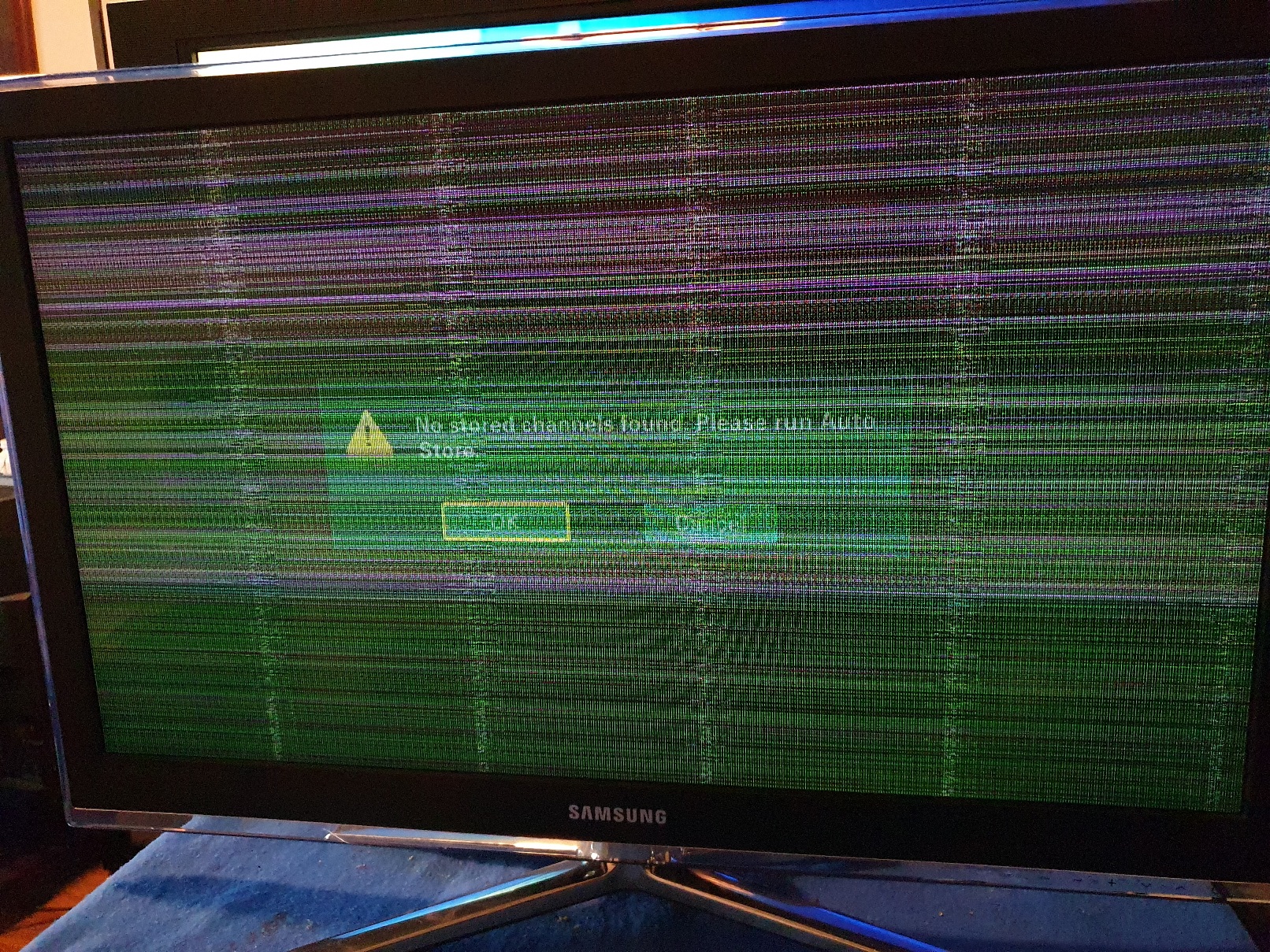

                              Which image shows? Is it the Logo and stop? This almost always is software conflict. Is it yours? Which is the story? it was connected to the net before the fault? Have you a new if settings has been reset? This can explain why colors are not ok..
                              • tiny68
                                • Aug 2013
                                • 33
                                Ive attached a still image from the restarting TV. This is what I see after the start up chine and before it reboots. I haven't taken the back off again yet, but will do so to try applying some heat and cooling of the main board.
                                  I've just tried the heat gun pointed at the bottom of the mainboard and initially I had just the vertical lines shown on the previous image I attached (with regular reboots still) but then the image no longer came up at all and there is no chime between the reboots (relay clicks every 7secs). I tried to let it cool down a bit and tried a little bit of butane (carefully) to try to cool the area but it remains in the 7sec boot state, without any image or chime.
                                  Ill try it again after it fully cools down.
                                  Any further thoughts?
