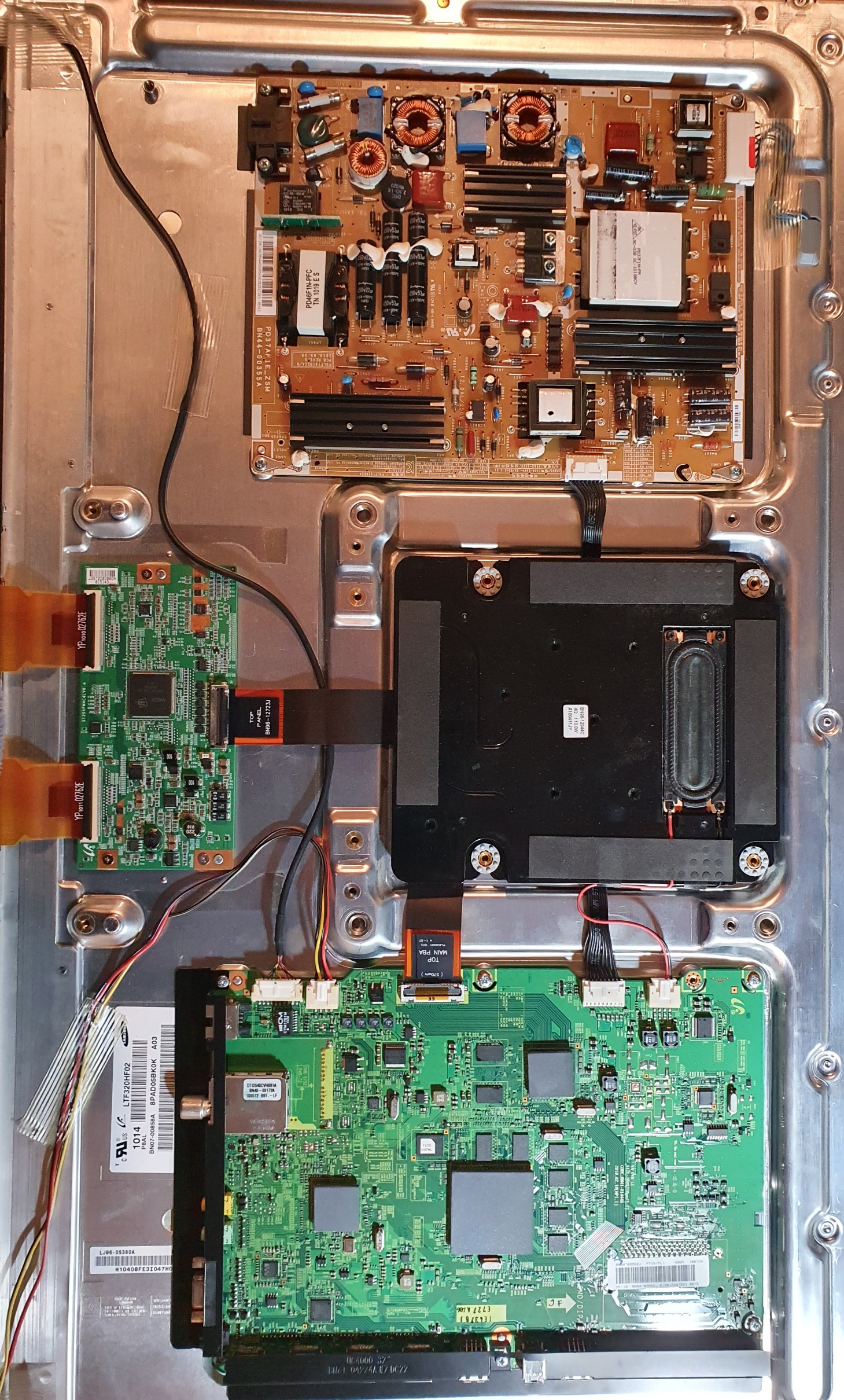

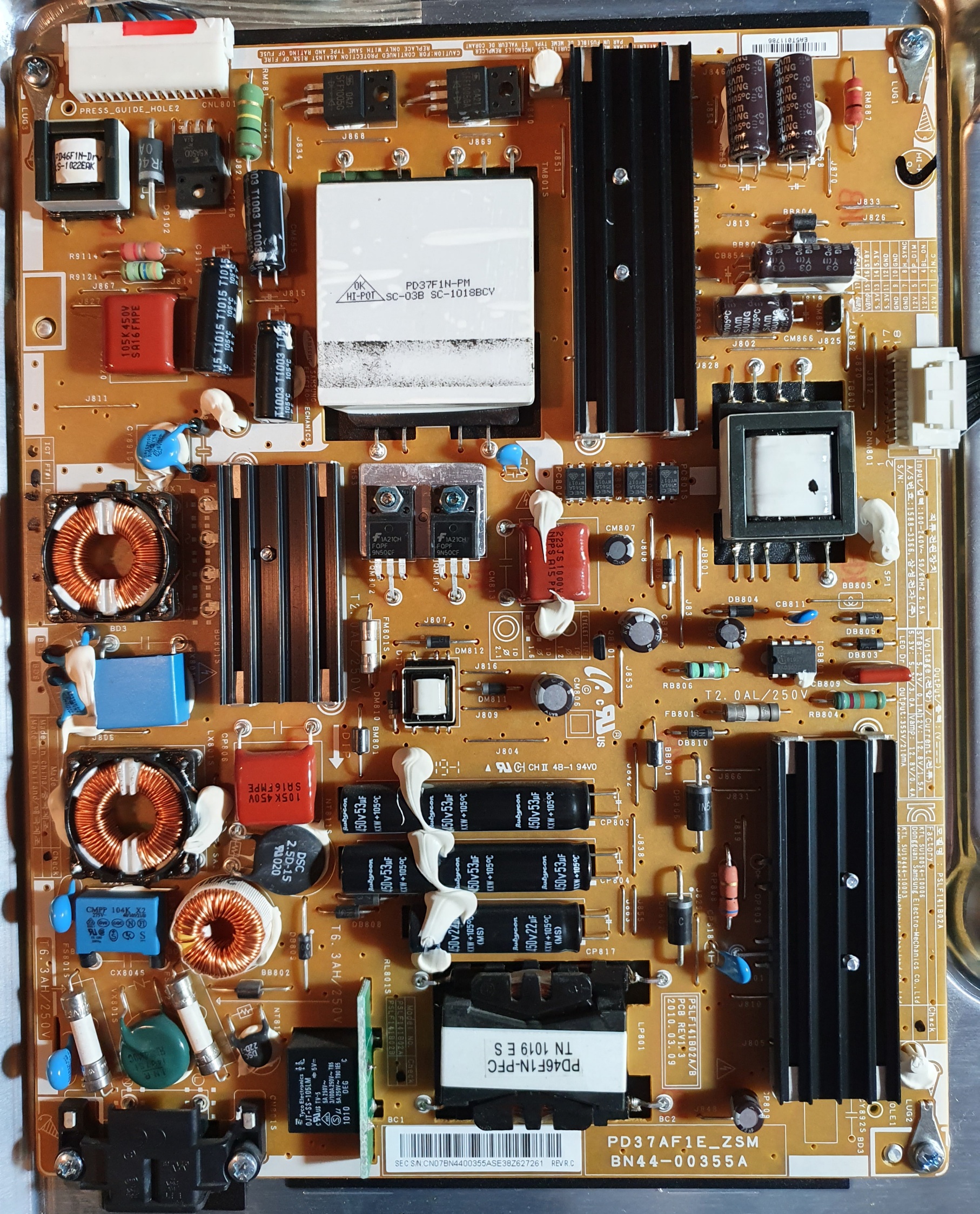

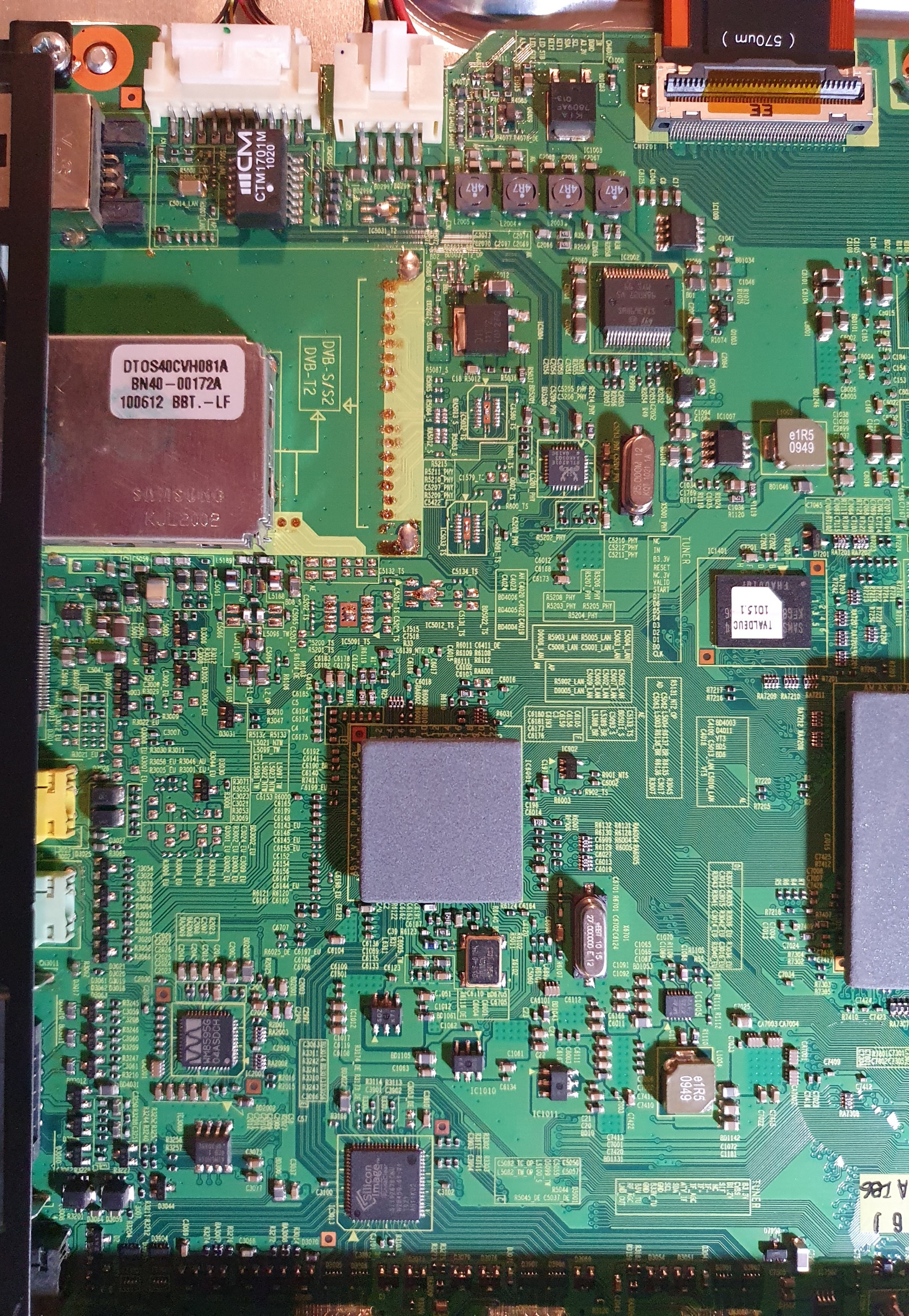

    For future reference for others, here are the photos of the full layout of the boards in this TV.
    The area I heated on the main board to initiate the change in display response (post#17) was near the antenna input at the bottom and the generally within about 60mm of this. Unfortunately I was unable to work out any more precisely the location that made the difference as the display never reverted to the previous fault image and now I dont have any image at all.

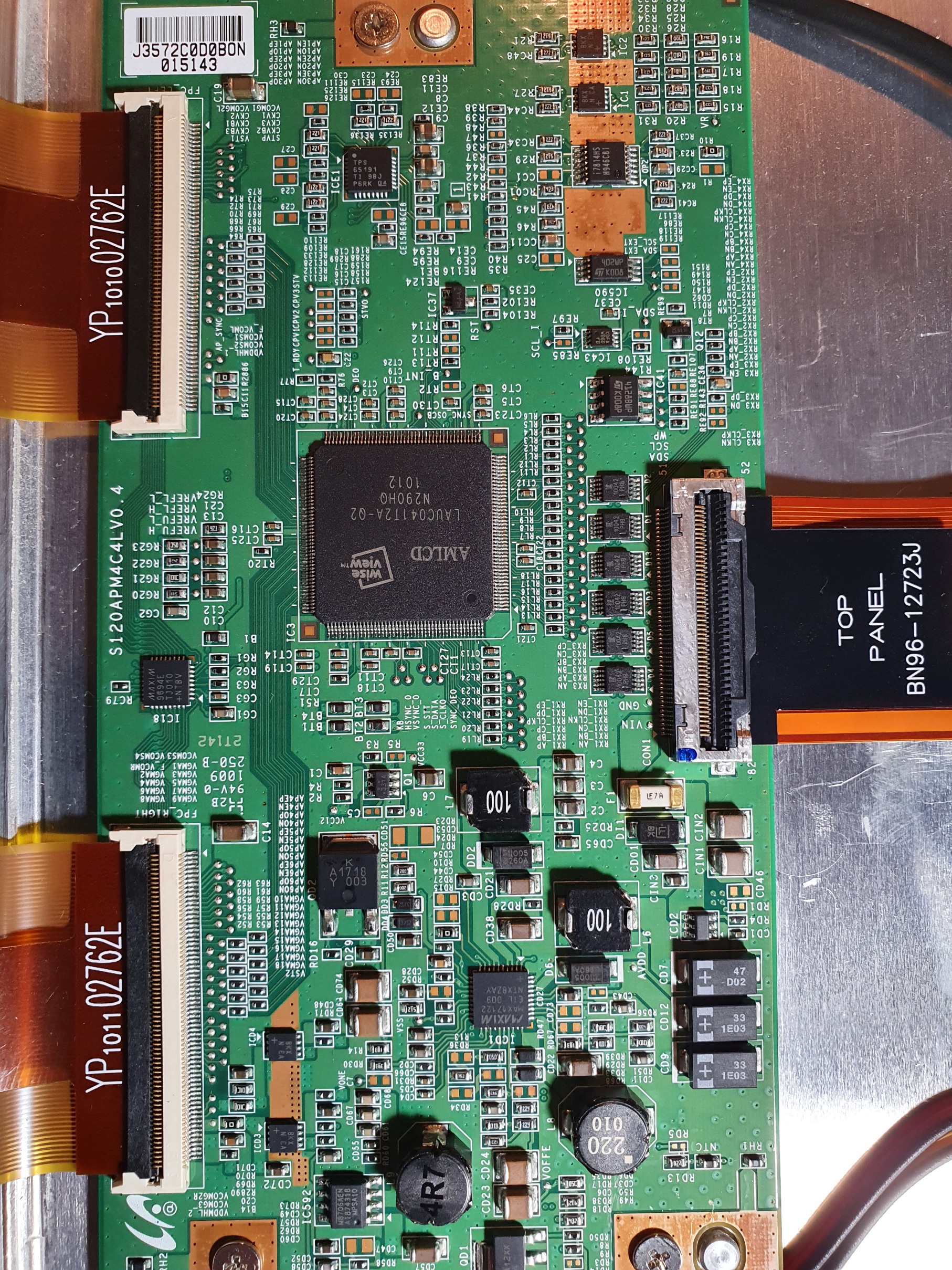

        Re: UA32C6900 continuous restaring
        I tested the tcon on the bench (nothing else connected to it). I supplied 12VDC to the input fuse.
        The current draw cycled from about 40mA to about 65mA every second (or less). I assumed this should have been relatively stable (I checked a tcon from a similar model which was steady on 70mA).
        The test-point measurements were a mixture of stable voltages for some test points and cyclic variation for other test points.

        I assume that this tcon is bad based on the above measurements?
        • Davi.p
          Hobbist Tech
          • Sep 2009
          • 4543
          • Italy - Milan
          Tcon not good or in protection because of panel problem, difficult to say , models behave differently, unless you find smps chip datasheet you can't manage to discover this.

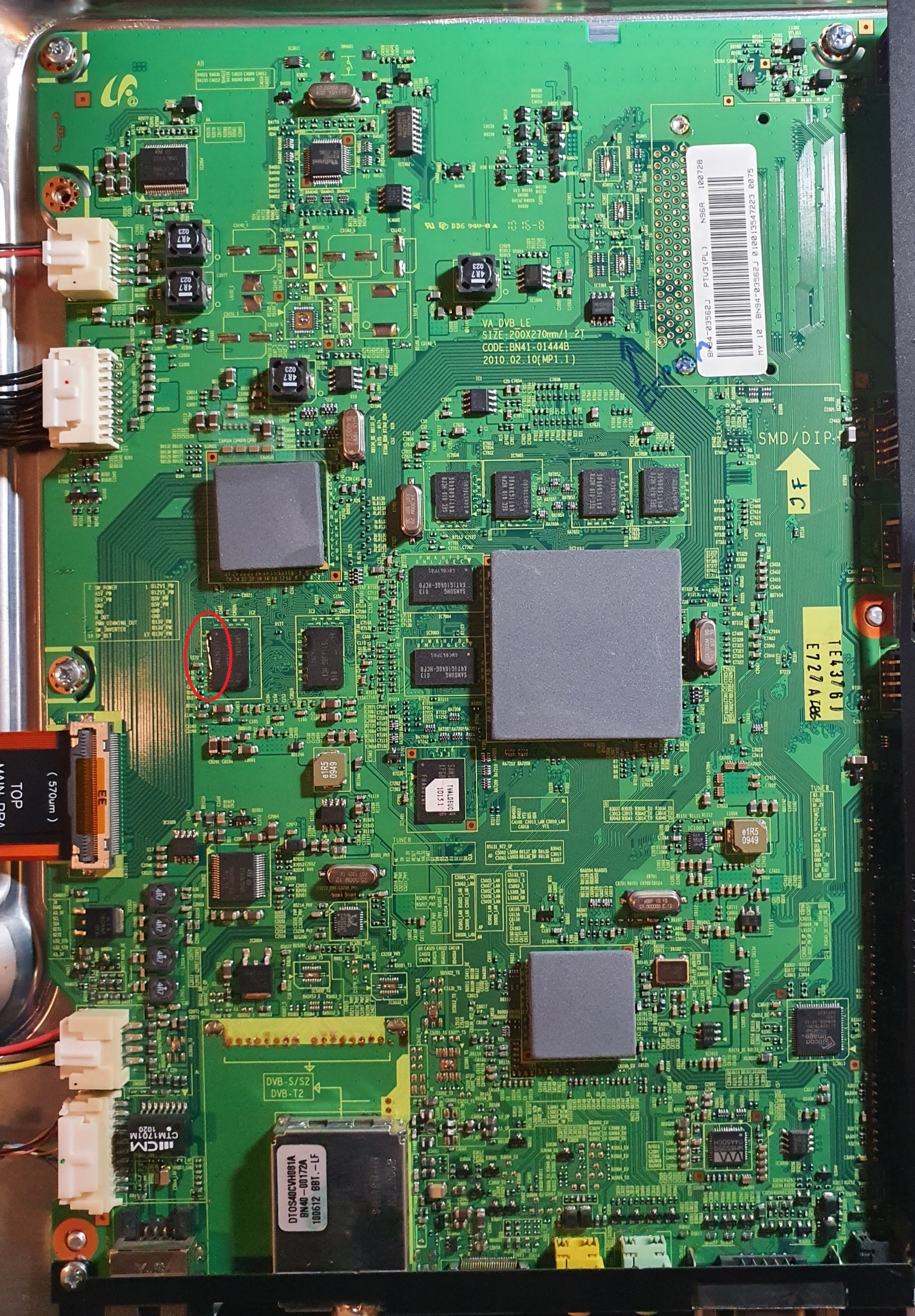

            Judging by your photo 3, it appears someone has already tried to fix the mainboard. It looks like the left side of IC 2 contains a large blob of solder, where IC 1 does not. See the attached photo, the area in question is encircled in red.
            I don't know if this is how it's supposed to be, have no experience with fixing Samsung TV's.
              Thank for your comment re-atari. After a long delay due to other distractions, I just got around to checking the main board and what looks like solder blob in the photo is a reflection for some flux on the board.
