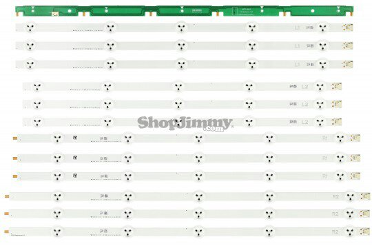

        I'll get a picture up tomorrow. Each led strip is made up of 2 strips. They are in 6 rows top to bottom. No matter what set of LEDs I swap in. Only the same 3 rows light up then shut off. If I swap the lighting 3 with the non lighting 3 the same three rows continue to light . At first I believed 3 rows of LEDs were bad and needed replaced. I swapped those rows with the working LEDs and they would not light. The LEDs open or shorted does not seem to be the issue. The issue is what would make 3 entire middle rows not light up if the LEDs on those rows are all in working order?

            This is the direct replacement parts for it.. Each LED string is 2 pieces that attach to one another forming 6 long strings that connect to that board by the same plug in.

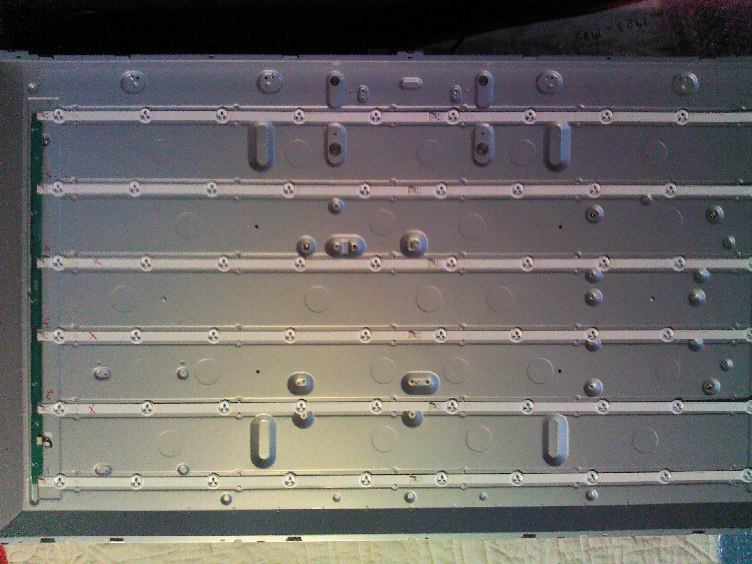

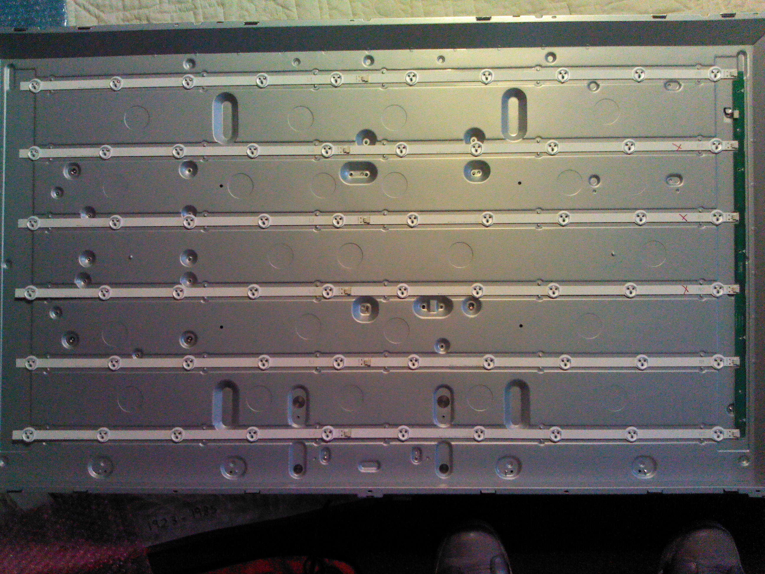

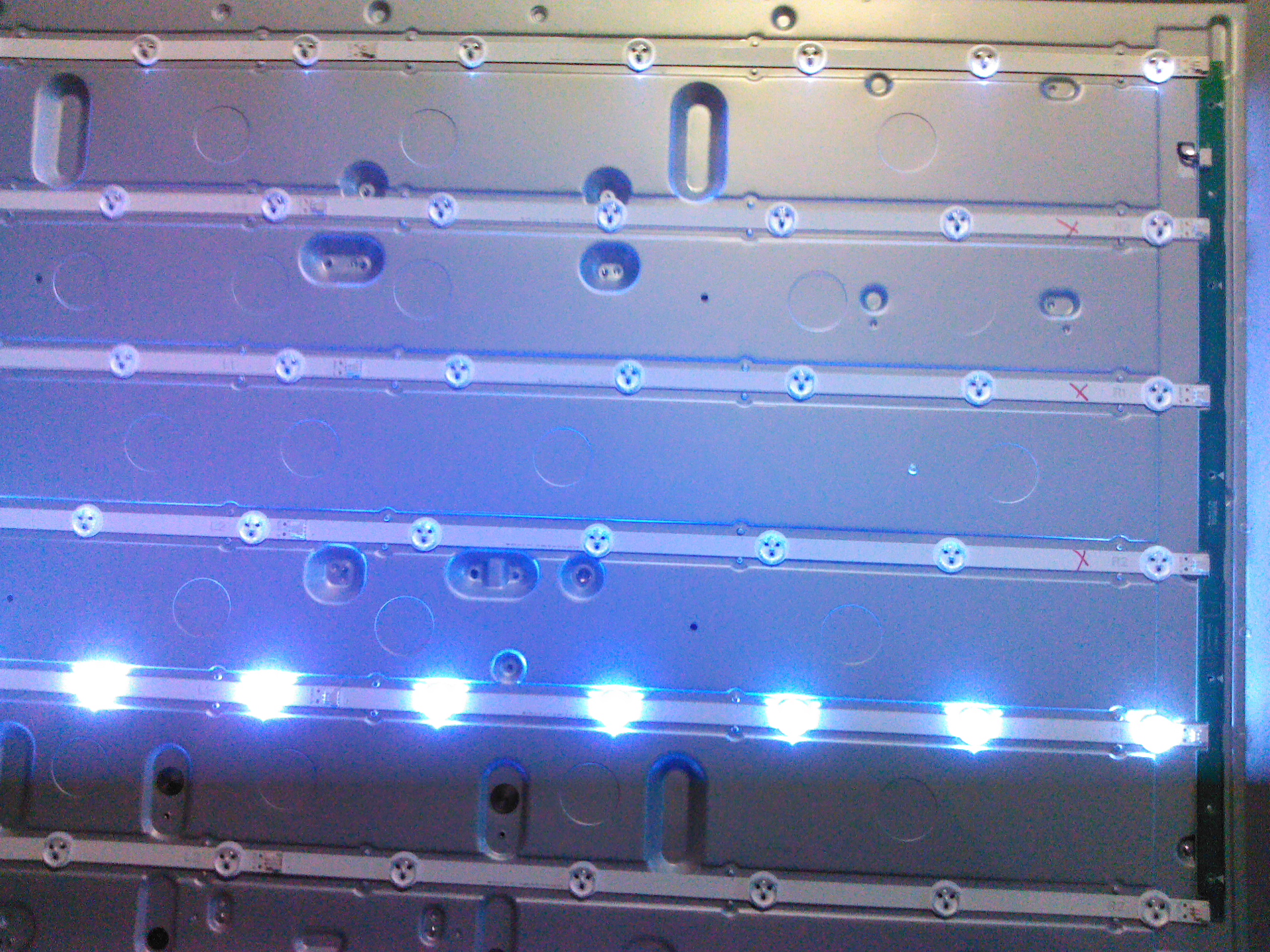

                  Pictures of LED setup.
                  Second picture shows one set lit 3 sets light up and then go out fast . I have swapped out all LED strips and no LEDs are out.
                  In the last picture I labeled them 1-6 to show voltage (red x indicates does not light up on start up) the red x LED strips do work though if I swap them.
                  1) 63v
                  2) 170-78v
                  3) 146-55v
                  4) 50-0v
                  5) 110v-78v
                  6) 86v-55v
                  The first voltage is power on voltage.
                  The second voltage is the constant it ticks down to and stops at.

                    Re: Backlight issue LG 50ln5600
                    3rd pic upside down not sure why sorry.
