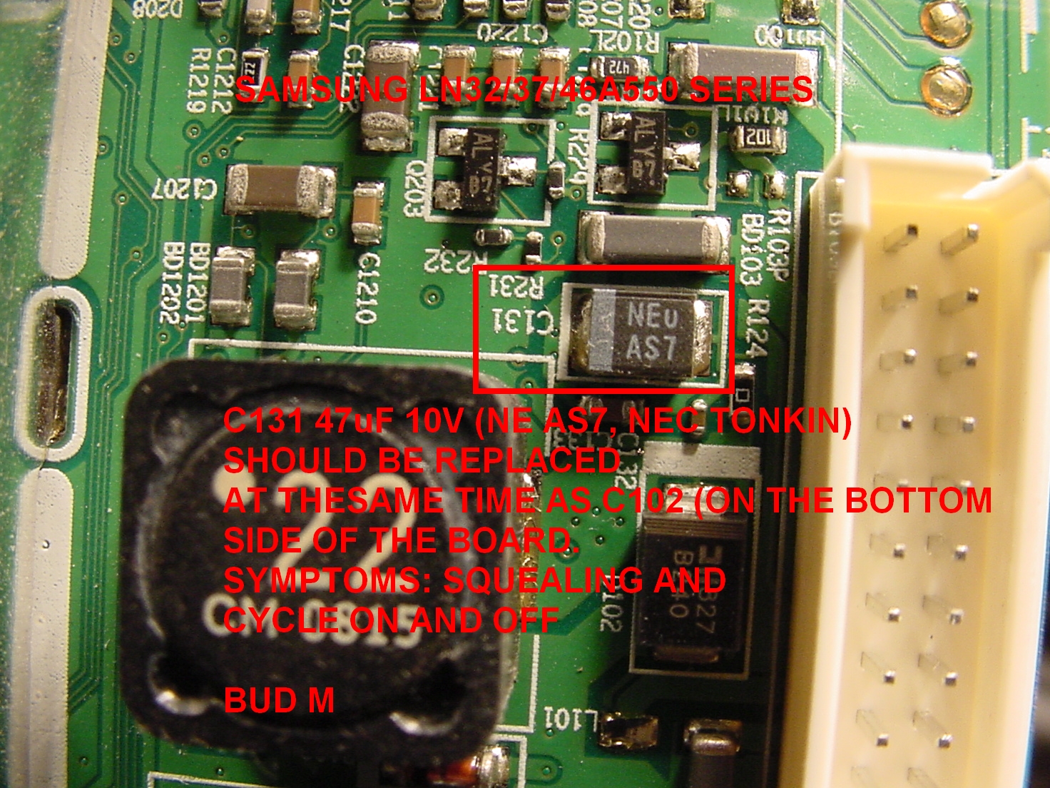

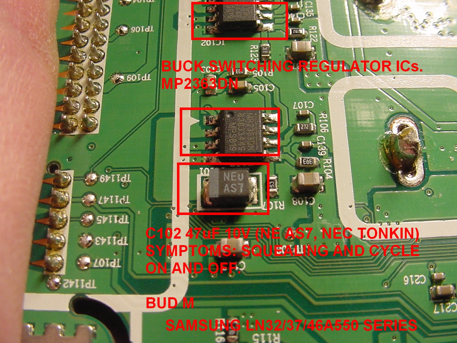

          Thanks to everyone in this thread but especially budm and Terryfictv! I was able to fix my LN46A550 that had reached the point of not staying on at all through hours of power cycles. I soldered 100uf caps in parallel with C102 and C131 and all seems fine now; it powers on just like it used to many, many months ago.
          budm, first of all thanks for the extremely well documented pictures. Also, it seems that you've done a number of these repairs, have any failed that you've done the parallel fix on?

            I hate to bring up an old post, but I feel it's ultimately fitting rather than start a new one. This is my 3rd project Samsung; I replaced 102 and 131 with 16v 100uf caps and get a steady 5v at c131; Haven't flipped and reconnected cables to read 102 yet; but would believe to be working just fine. I still have the 8 second cycle click. Thinking about going and replacing cap by cap in the power supply just to be sure, even though I don't believe it to be a problem. Any suggestions whilst I go have a smoke?
            img free
              #106
              Re: Samsung LN46A550 Power Cycling

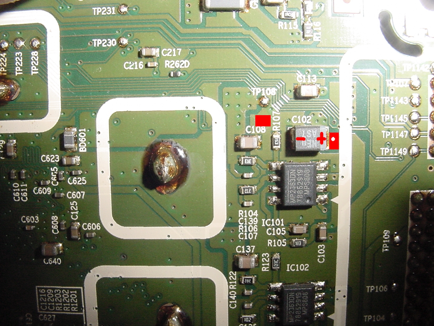

              How did you install the cap positive and the negative leg?
              The original TANTALUM cap has white bar which is POSITIVE, it is opposite from lytic cap which the white stripe is negative. Look at your pictures it looks like you have the polarity backward.
              Look at my pictures.

                        Had a LN46A530 that wouldn't turn on. Relay clicking every 30 seconds. Replaced C102 on the main board and TV turned on. Symptoms when I replaced this capacitor before were green screen and squealing. IC101 is also suspect if replacing C102 doesn't fix it.

                          Picked up a LN40A550 that had bad Power supply caps, replaced them been using the TV for probably over a year. Started to do the start up cycling. checked power supply and replaced any other caps that might be bad. Didnt help, still starts up displays channel and station identity then after a minute or so it restarts.
                          I think I have tried every suggestion in this thread.
                          Purchased new Tantalum caps Kemet brand low esr and the IC's MP2368DN replaced all four items. Still cycles.
                          Tested off board the original tantalum caps and they tested good.
                          Not sure how to test the MP2368DN.
                          Added 100uf electrolytic in parallel with the tantalum. (correct polarity double checked) Still cycles
