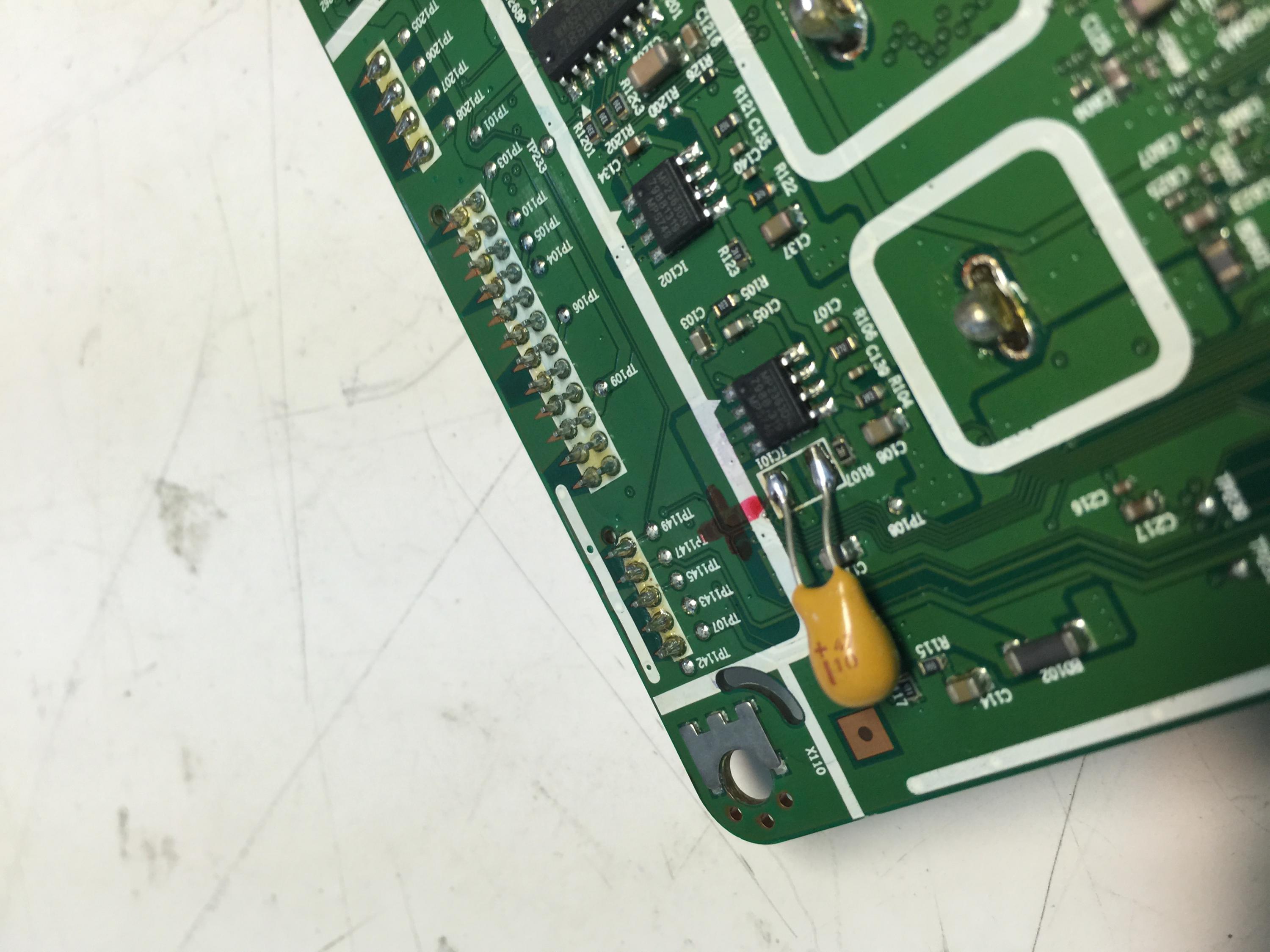

    Samsung UN55F7050AFXZA ver. TD01 power cycling
    by high-tech
    Hello everybody, I could use some help on this one... It's got me guessing...
    I took pictures of all the boards and the pin out of the connector on the power supply that goes to the main board... I measured all the pins in relation to chassis ground, here are the result.
    (B13v)1. 12.7 volts cycling (Vamp) 2. 12.7 volts cycling
    (B13v)3. 12.7 volts cycling (PWM5) 4. 1.0 volts cycling
    (OD_LE)5. 2.8 volts cycling (PWM4) 6. 0.9 volts cycling
    (OD_ON)7. 2.8 volts cycling (PWM3) 8. 0.9 volts cycling
    9. ground (PWM2) 10. 0.9 volts cycling...
