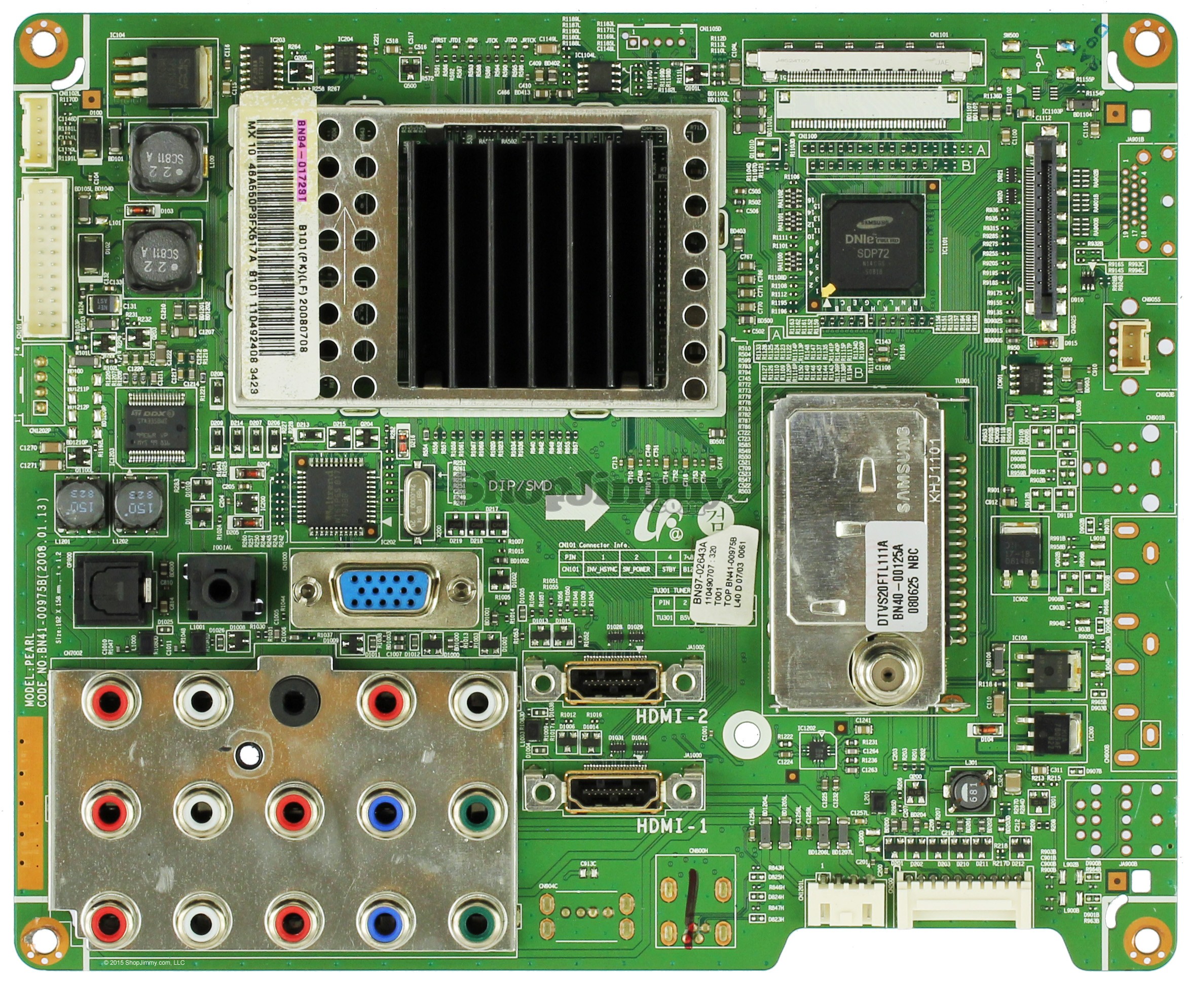

                      #90
                      Re: Samsung LN46A550 Power Cycling
                      Here is a picture in case anybody needs one.
                        #91
                        Is the Voltage across C102 steady? I never run into problem where C102 replacement does not fix the recycling problem.

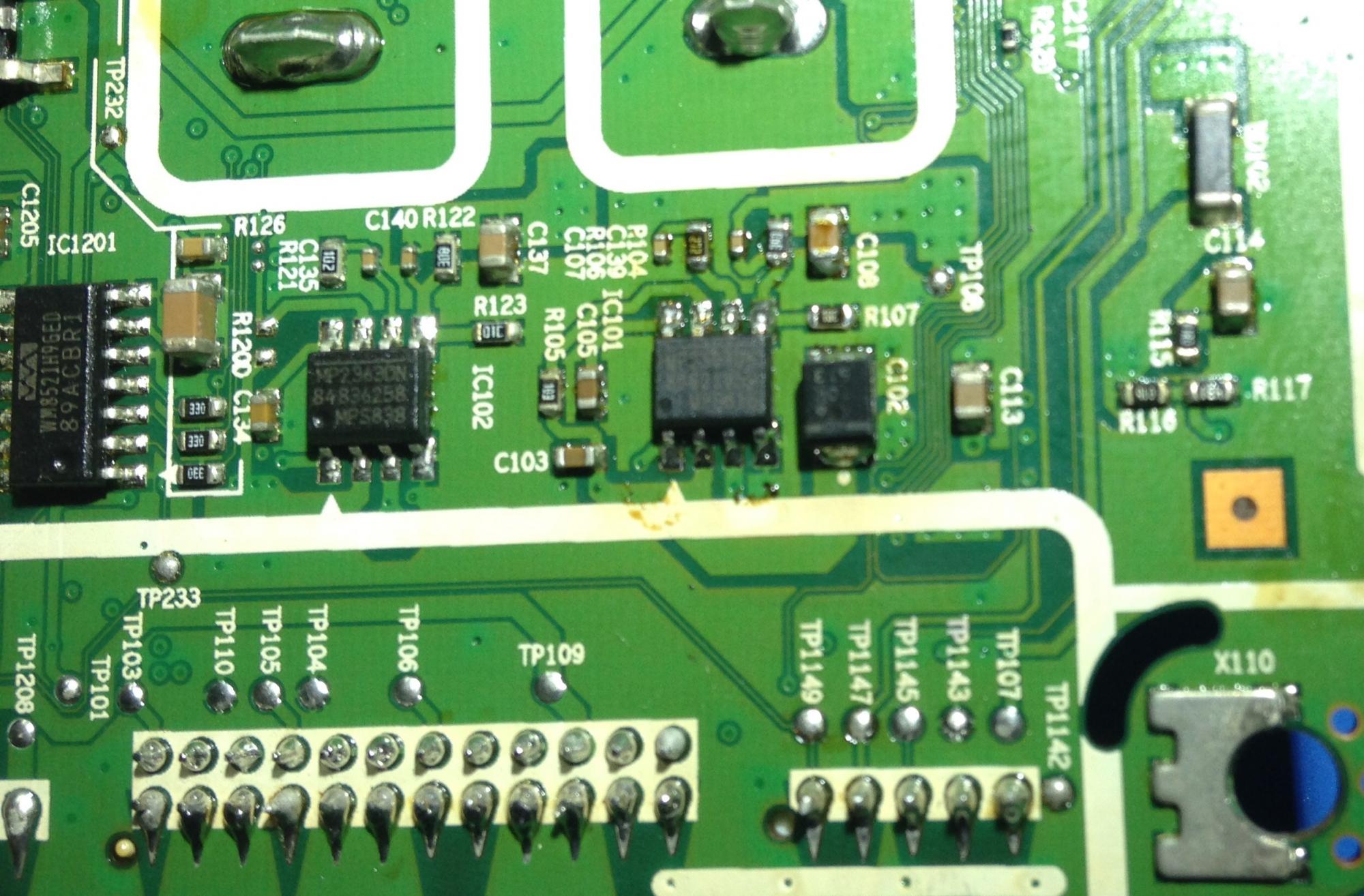

                                    #97
                                    I do have experience replacing eeproms. I have looked for the 8 pin ic but can't identify which one is. Here is a pic of board.
                                    • Agent24
                                      I see dead caps
                                      • Oct 2007
                                      • 5035
                                      • New Zealand
                                      #98
                                      Can you post up all the part numbers for all the 8-pin chips? I can't read any of them in that picture. Are there any on the other side?
                                      If it's none of those, it may be under the RF shield next to the processor, or might even be embedded into the CPU.
                                      -David VanHorn
                                      • Louis82
                                        • Feb 2012
                                        • 240
                                        #99
                                        ATMLH844
                                        AP358
                                        BOTTOM:
                                        ATMLH834 (QTY: 3)
                                        4435B
                                        On the top of the board I see a IC that after checking specs it says that is a flash memory. Not sure if that might be the eeprom. Part number is WT61P6S
                                        Thank you
                                        • Agent24
                                          I see dead caps
                                          • Oct 2007
                                          • 5035
                                          • New Zealand
                                          #100
                                          WT61P6S is another microcontroller. It probably has an internal flash memory, rather than being one.
                                          AP358 is an opamp, 4435B a MOSFET.
                                          ATMLH844 and ATMLH834 are likely to be EEPROMs, but you need to write the other text on the chip, not just the first line. That first line is just part of Atmel's datecode, the 2nd (and maybe 3rd) lines tell the actual part number (in cryptic SMD code)
