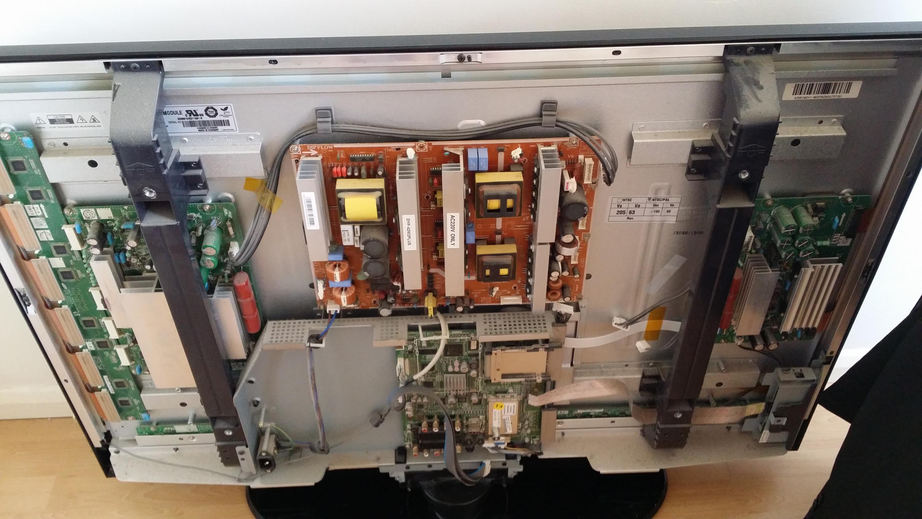

    Samsung BN44-00194A power supply dead
    helping a friend with a dead Samsung PS42Q96HDX/XEU plasma tv
    Dead no sign of life at all
    Apparently just went off whilst watching tv
    Power board is BN44-00194A
    checked 4 fuses on power board all ok
    no voltages on any of the boards outputs
    Anyone had dealings with these power boards, or where do I start checking
    I know I can get a used board off ebay however I would like to have a go at fixing this board myself, with your help of course

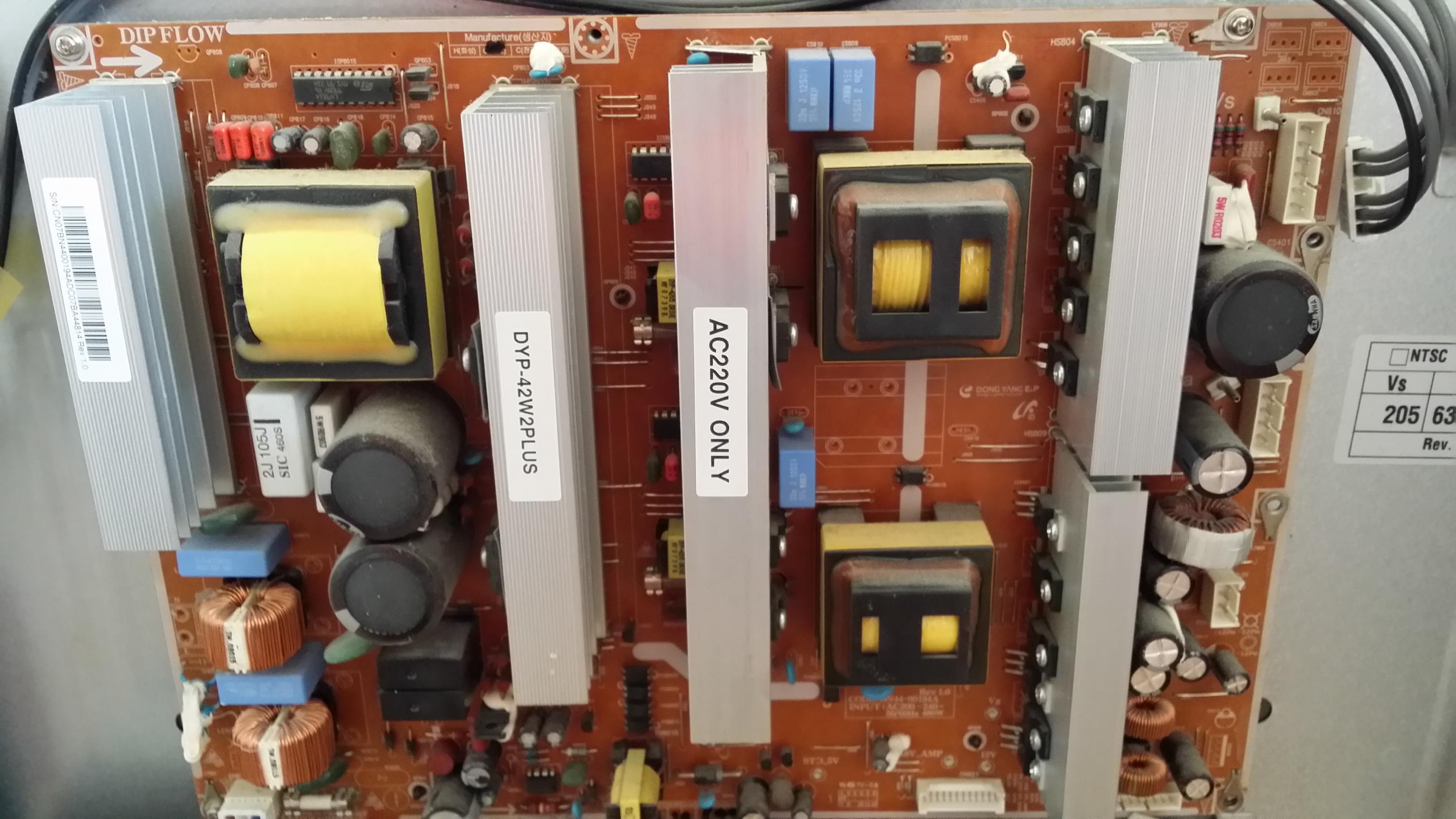

    Re: Samsung BN44-00194A power supply dead
    first you have to check STD_5V delivred by VIPER22A
    ICB801S and component around
    • ammarben
      • May 2013
      • 63
      • algeria
      check for short diode DB401 SB560 and dont forget caps
      • london-freddie
        • May 2015
        • 472
        DB401 seems to be ok no short, what where is SB560 can not find it
        • ammarben
          • May 2013
          • 63
          • algeria
          DB401 is SB560
          • london-freddie
            • May 2015
            • 472
            got that db401 is ok all caps look ok, 2 glass fuses in centre of board are good but no power at those fuses when power applied to board
            • ammarben
              • May 2013
              • 63
              • algeria
              • sordids999
                • May 2013
                • 2161
                • uk
                https://www.badcaps.net/forum/showthread.php?t=46606
                might help you along the way
                • london-freddie
                  • May 2015
                  • 472
                  no 5v
                  • sordids999
                    • May 2013
                    • 2161
                    • uk
                    checked for cold solder joints ?
                      What DCV do you get between the cap CB801?
                      Notes: the SCHEMATIC may not be 100% correct.
                      • victor_cj
                        • May 2015
                        • 90
                        • Romania
                        Check or replace RB806, ZDB803. I had this zener diode faulty.
