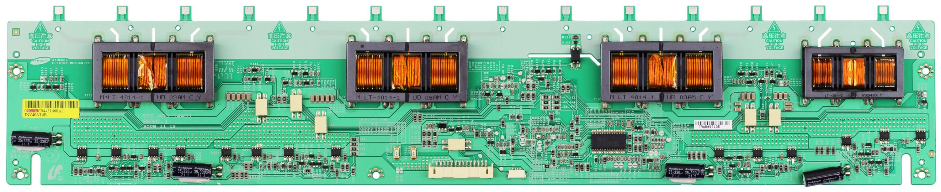

    Originally posted by ReeceyBurger123 View Post
    You get the bulb connectors back in ok ?
    The Ics that tend to blow according to my notes are part number 4614 bv9x15 those tend to short and blow up all the zero ohm jumpers at the top of the boards which is where all the blackening is.
    So if I were to make a serious attempt at repairing this board, I'd probably have to replace all the ICs and quite a few tiny jumpers? That doesn't sound like fun. I'm glad I made the decision to just get another board.

      Its not fun to repair these you will also need to replace alot of tiny resistors which requires good soldering skills and equpitment and finding the parts is hard and tbh not worth it if you value your time like me.

            The brown spots on the board are due to the power MOSFETs over heated.
                Pictures provided by SJ.
                The power MOSFETs? Are those the ICs we were discussing earlier?
                  Re: Here's Something Different: I Know It's Broke So Please Help Me Learn Why!
                  Yes.

                      Alrighty, so here's what I've learned so far in reference to the close up pic:
                      1) Opto-coupler
                      2) Power MOSFET or IC - Replace it if you suspect it's bad.
                      3) Oscillator circuit? Inverter IC PWM? Any help with this one?

                        The white device with 4 legs is not opto-couple, it is a dual high current jumpers to cary large current between the traces.

                          Originally posted by JDC View Post
                          So ICs don't follow a standard pinout?
                          Every IC package type has a standard pin numbering scheme, but as to what the pins actually do, that depends on what the IC does.
                          Looks like it's going to be the inverter controller IC to me. Read the numbers off it and look them up, you can probably find a datasheet which will explain.

                            An update for anyone interested: Replacing the inverter got the TV working again. Not a bad save for around 30 bucks. Thanks again for all who helped.
