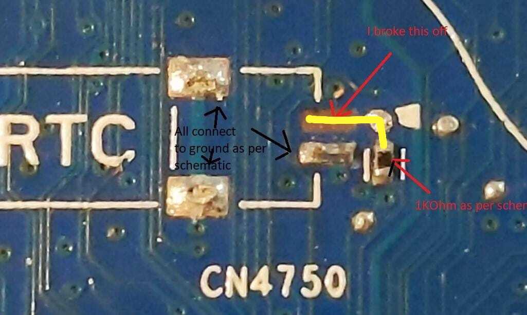

    I have an HP EliteBook 840 G1 non touchscreen. The symptoms are that: Repairing or reinstalling windows freezes no matter how i try it. Live Ubuntu that works on any other computer also freezes while trying to load it. The RAM sticks and the harddrive work fine in other computers. I broke off the connector by accident, CN4750 and was using the laptop for a while with no coin battery. According to this schematic I found on here, which I THINK is the correct schematic, pins 2, 3, and 4 should short to ground, and they do. However since the pad is totally torn off from pin 1, which would be the positive terminal of the coin battery, aka P3V3AL_RTC_BAT, I'm not sure where to solder a new connection to. Here's the strange part: with the laptop battery(not coin battery), I read ~0.3V to ground on the little pad next to the broken pad that looks like maybe a test point. With the laptop battery out and the AC Power in, it reads 0.4V, however all other 3.3V circuits read as normal, the laptop starts into the bios, fine, passes MemTest, etc. I have attached pics of the area in question and of the circuit from the schematic.

    Hi, it's visible if you zoom in the picture you posted
    Here, I marked it with a yellow line

    The other end of the resistor goes to D4750, it may be located on the other side of the board

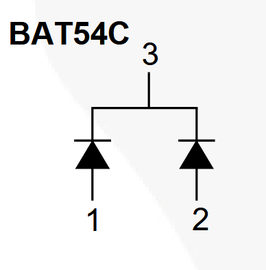

    Measure the voltage at pin 3 of D4750, you should get close to 3v with the RTC battery connected and no power to the board, after you fix the trace
    Click image for larger version  Name:	bat54c.png Views:	0 Size:	10.2 KB ID:	3642577
    3v should also be also present at pin 3 of the diode when the board is connected to power even if the RTC battery is disconnected

      Thank you very much for taking the time to respond and provide lines/files! Maybe I'm just being paranoid, but are you 100% sure that everything in your yellow line should be one trace? And why am I reading 0.4 V at that undamaged part of the trace, that I previously assumed was a test point?
        99% looks like it is, the test point is part of the trace
        The 0.4v you get at the test point may be that D4750 is faulty/leaky, or your multimeter is picking up noise
        Check the voltage at P3V3_RTC (after D4750), should be around 3v
        With all power unplugged measure D4750 according to the drawing above, multimeter on diode mode
        red probe on pin 1, black probe on pin 3
        red probe on pin 2, black probe on pin 3
        Black probe on pin 1, red probe on pin 3
        Black probe on pin 2, red probe on pin 3

        That circuit is powered either from the always on +3.3v, or the RTC battery, that's what the diode does
        So if you keep the main battery installed it won't lose the BIOS settings and date/time, of course it will reset the BIOS settings when you remove the main battery
