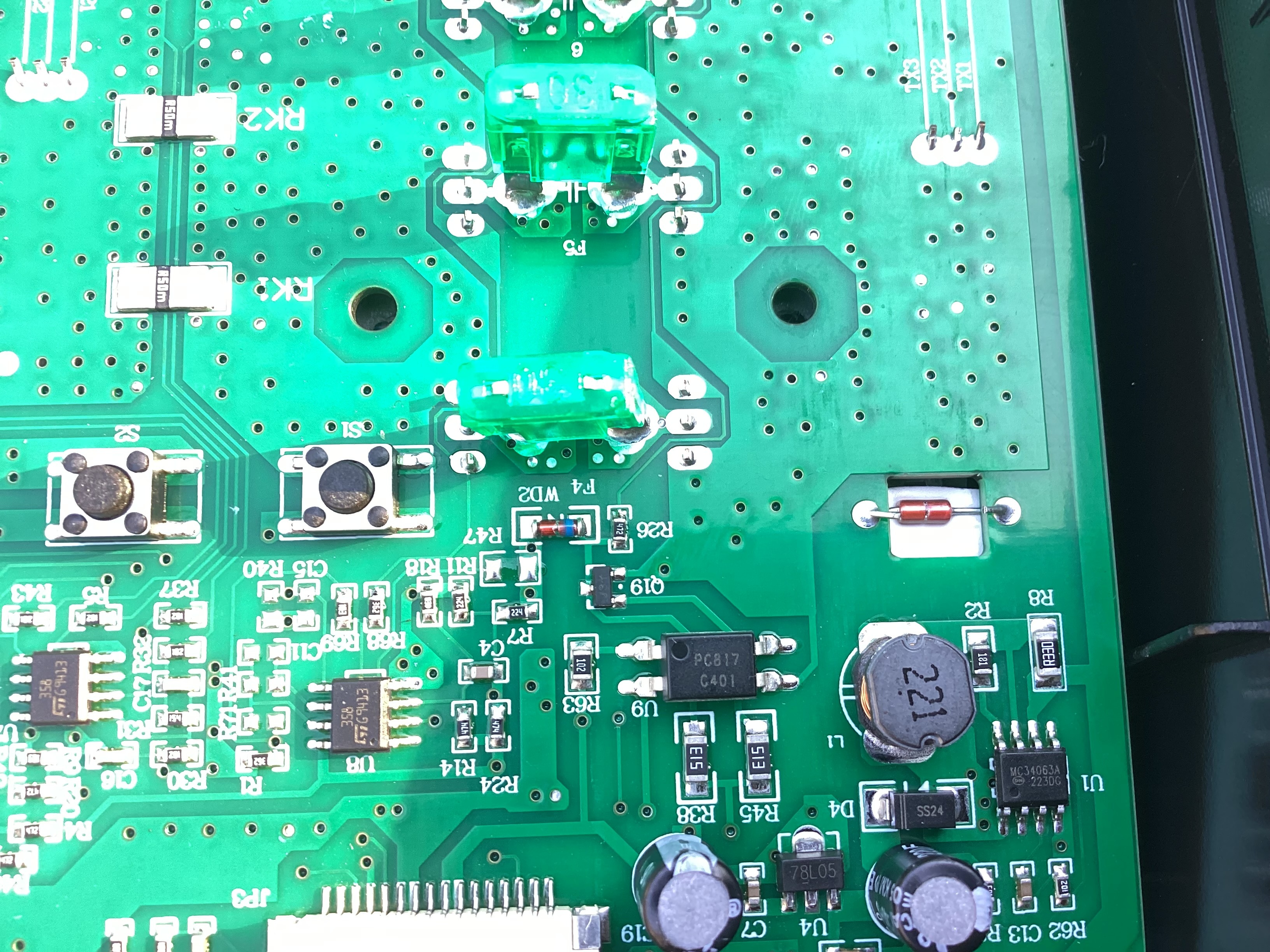

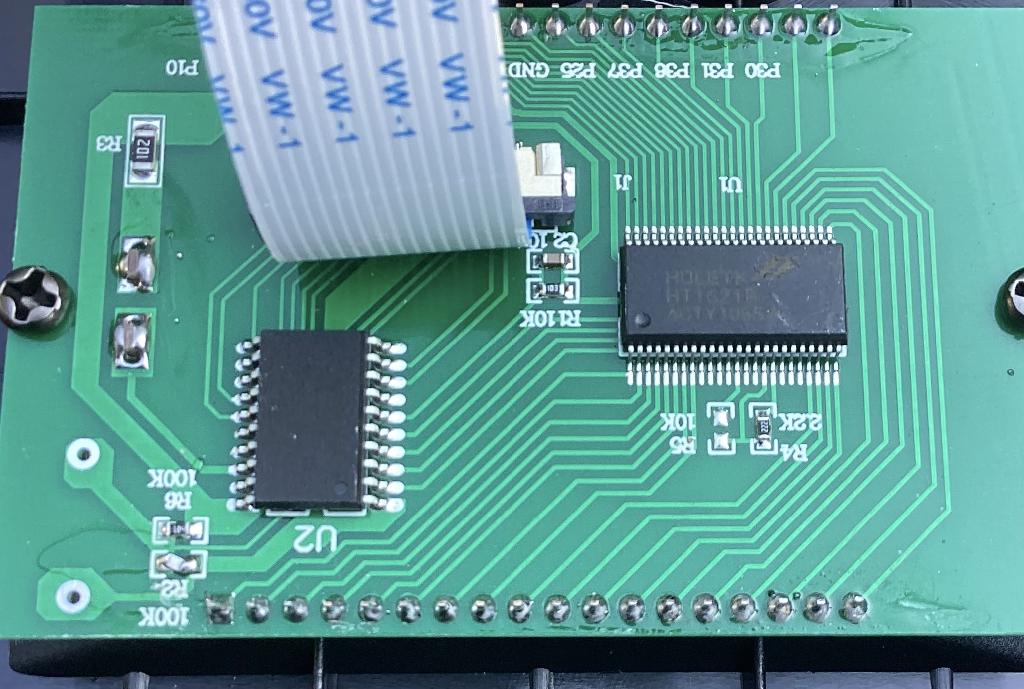

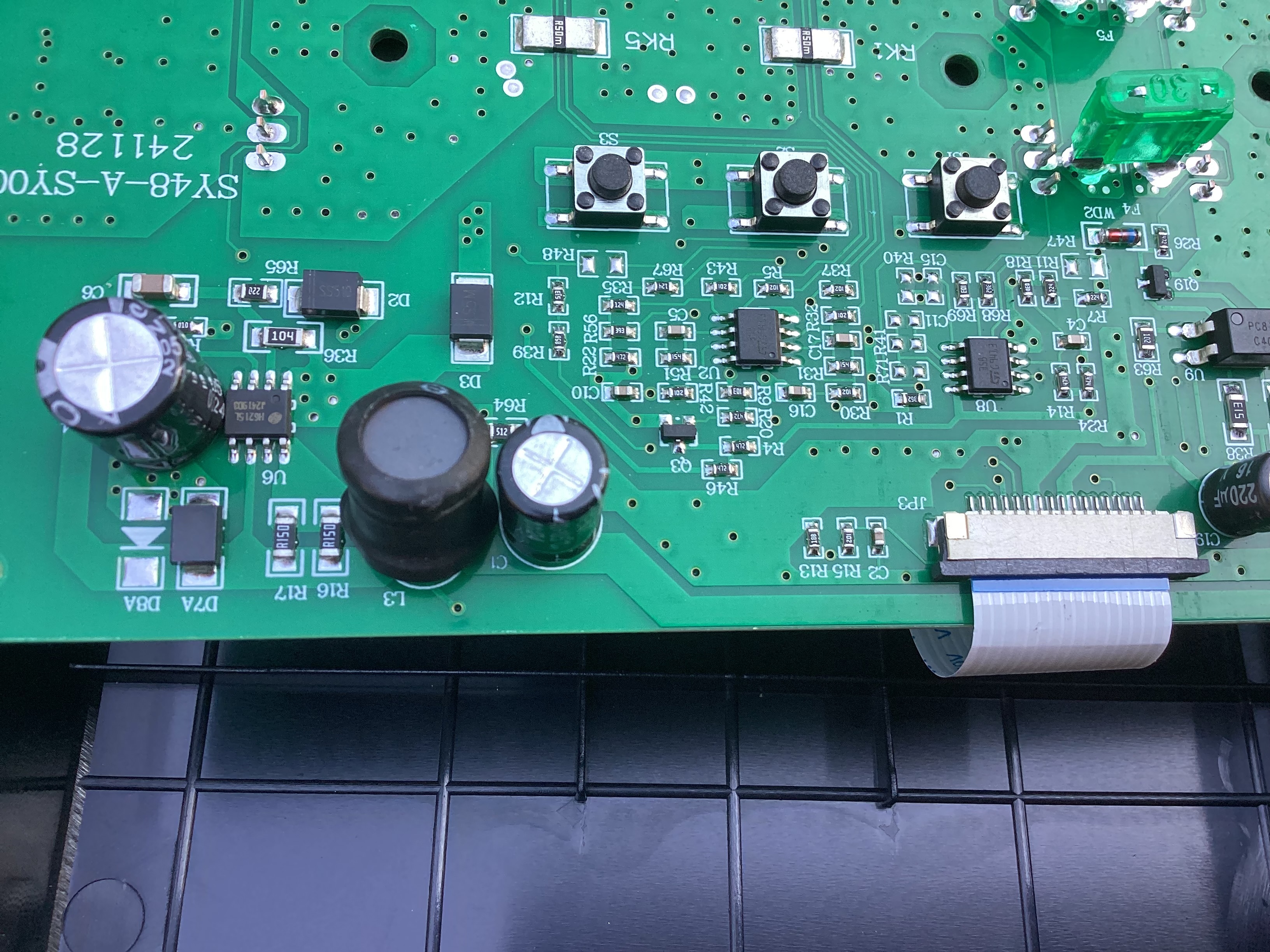

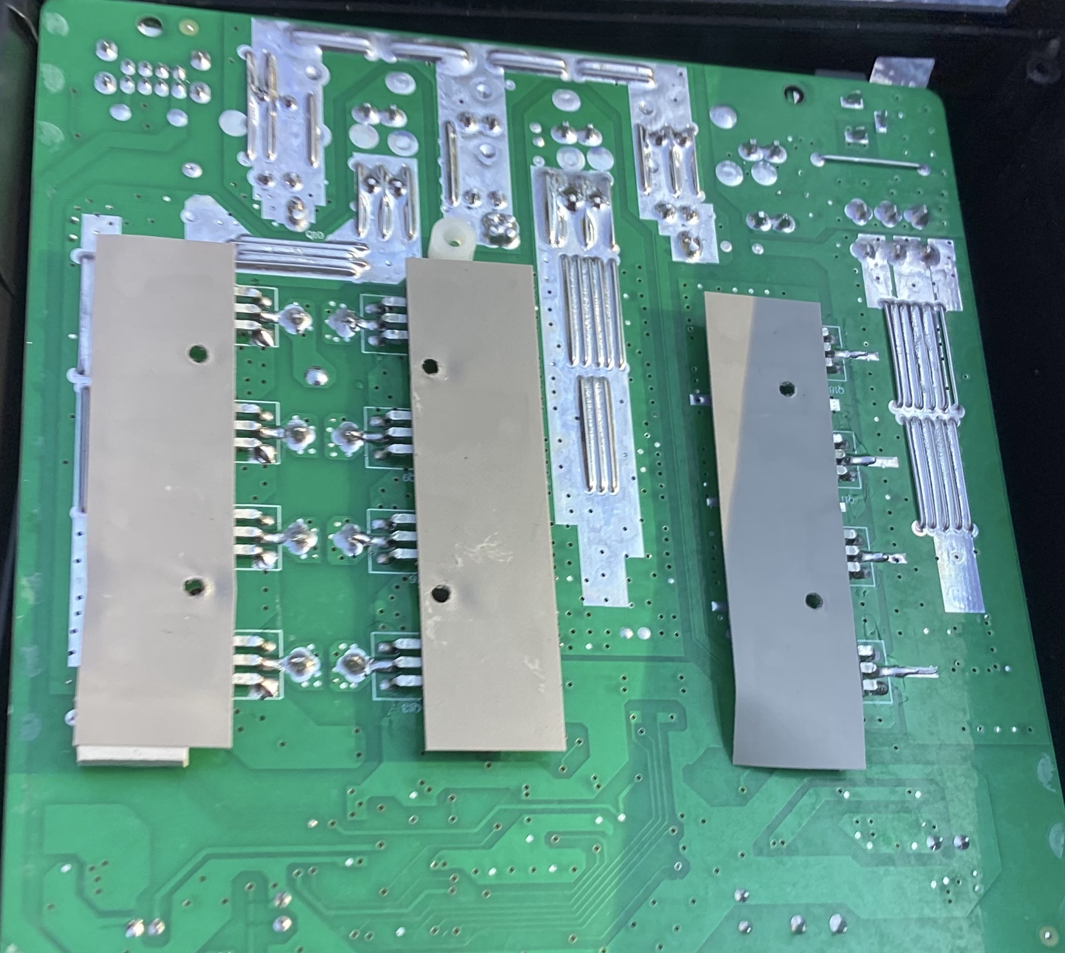

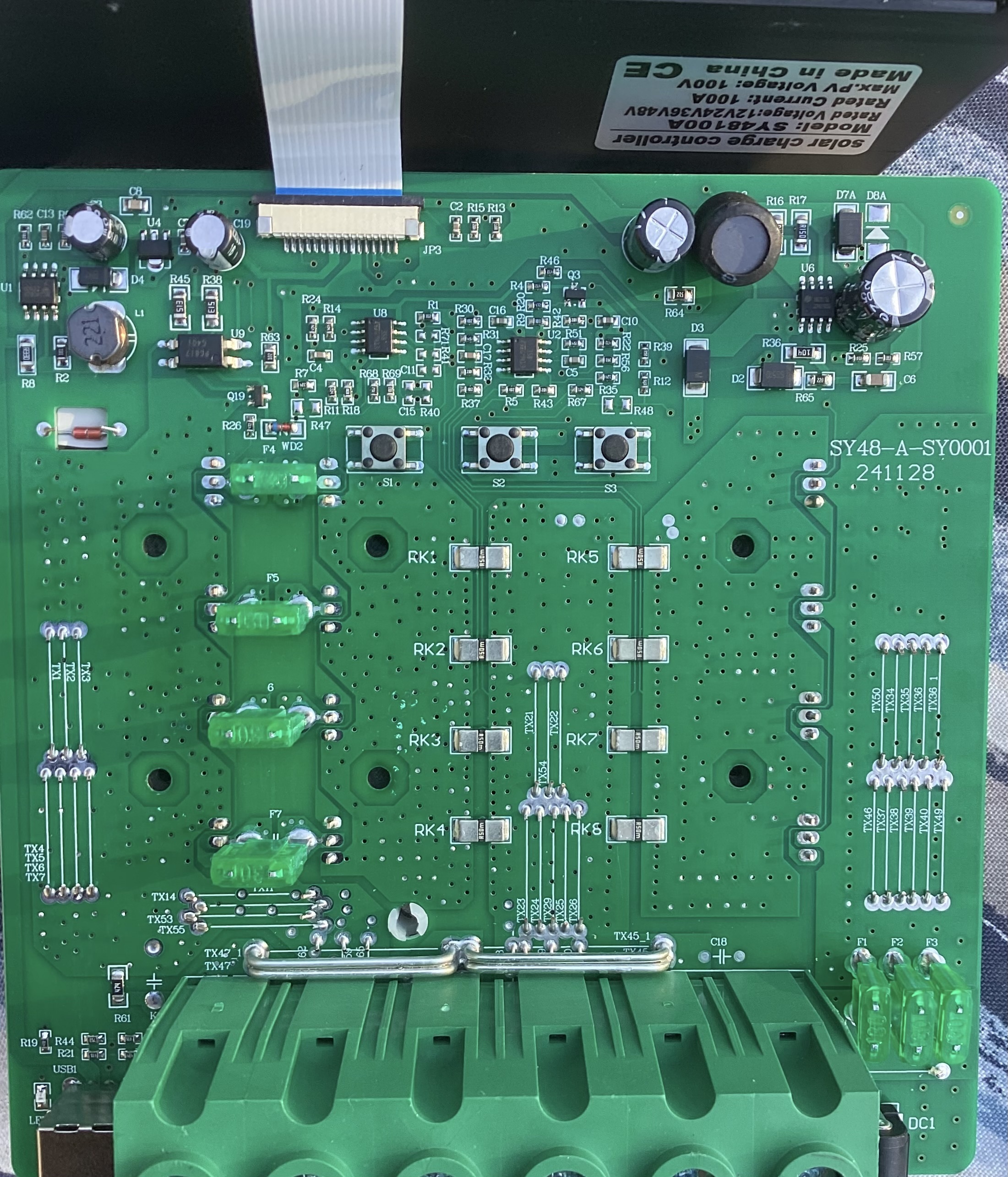

                                    Here are some pictures of the controller board and the display board
                                    • truclacicr
                                      • Apr 2019
                                      • 356
                                      • australia
                                      It looks like an ordinary PWM controller to me.
                                      U6 and L3 appear to be associated with the USB ports.
                                      U1, L1 and U4 appear to power the ICs on the PCB.
                                      This appears to be the user guide:
                                      https://ia804609.us.archive.org/2/it...8100A_text.pdf
                                      I see nothing that would be consistent with an MPPT controller.
                                      This appears to be the design registration for the box (SY48100A):
                                      https://qxb-img-osscache.qixin.com/p...194f0dbe56.pdf
                                      I don't know how to search for the patent(s) here:
                                      https://english.cnipa.gov.cn/
                                      Display controller (HT1621A):
                                      https://www.holtek.com/webapi/116711/HT1621_21Gv340.pdf
                                      The chip is marked "HOLETK" (sic), so it looks like a fake.
                                      H6215L is a "12-200V input, 2A, buck constant voltage chip (high power - line loss compensation)".
                                      https://taoic.oss-cn-hangzhou.aliyuncs.com/6511/product/HHBDT_1663134630000.pdf
                                      https://www.hxc-power.com/h-col-113.html
