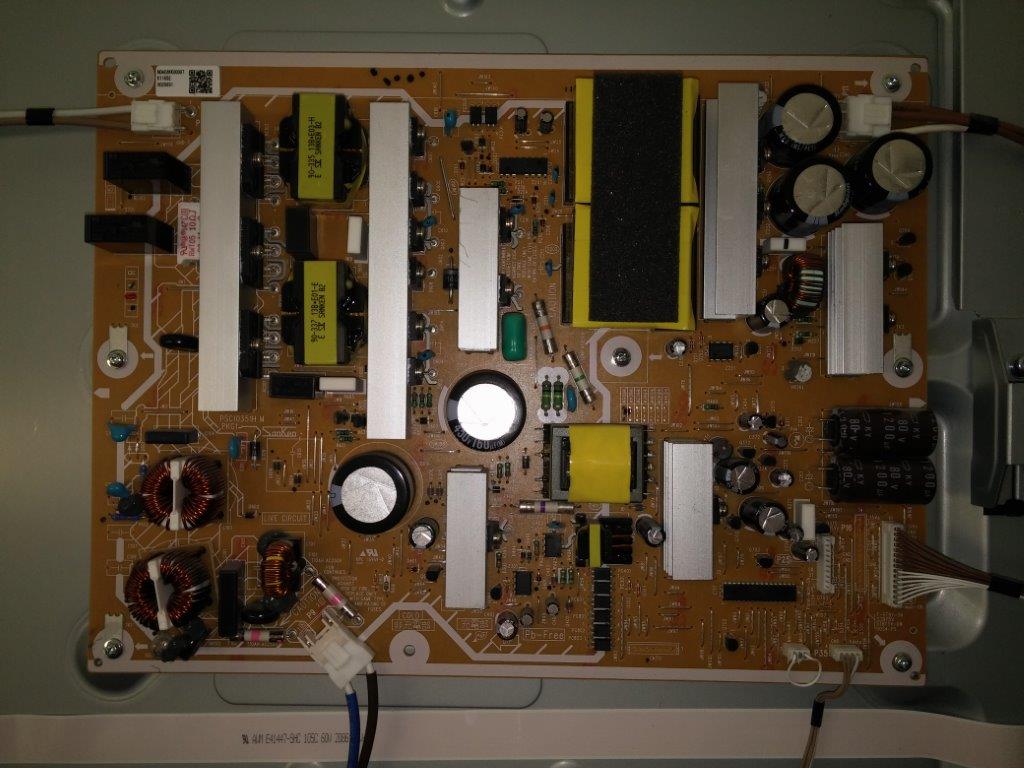

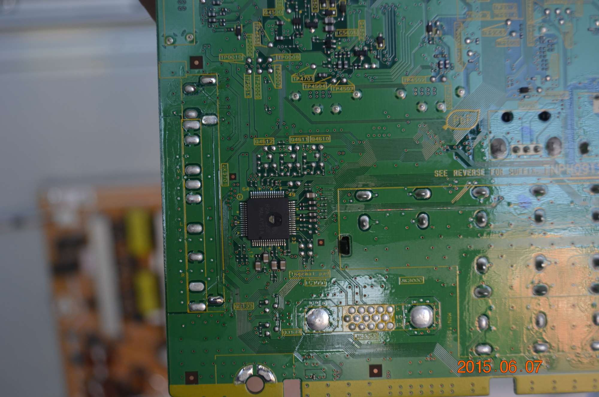

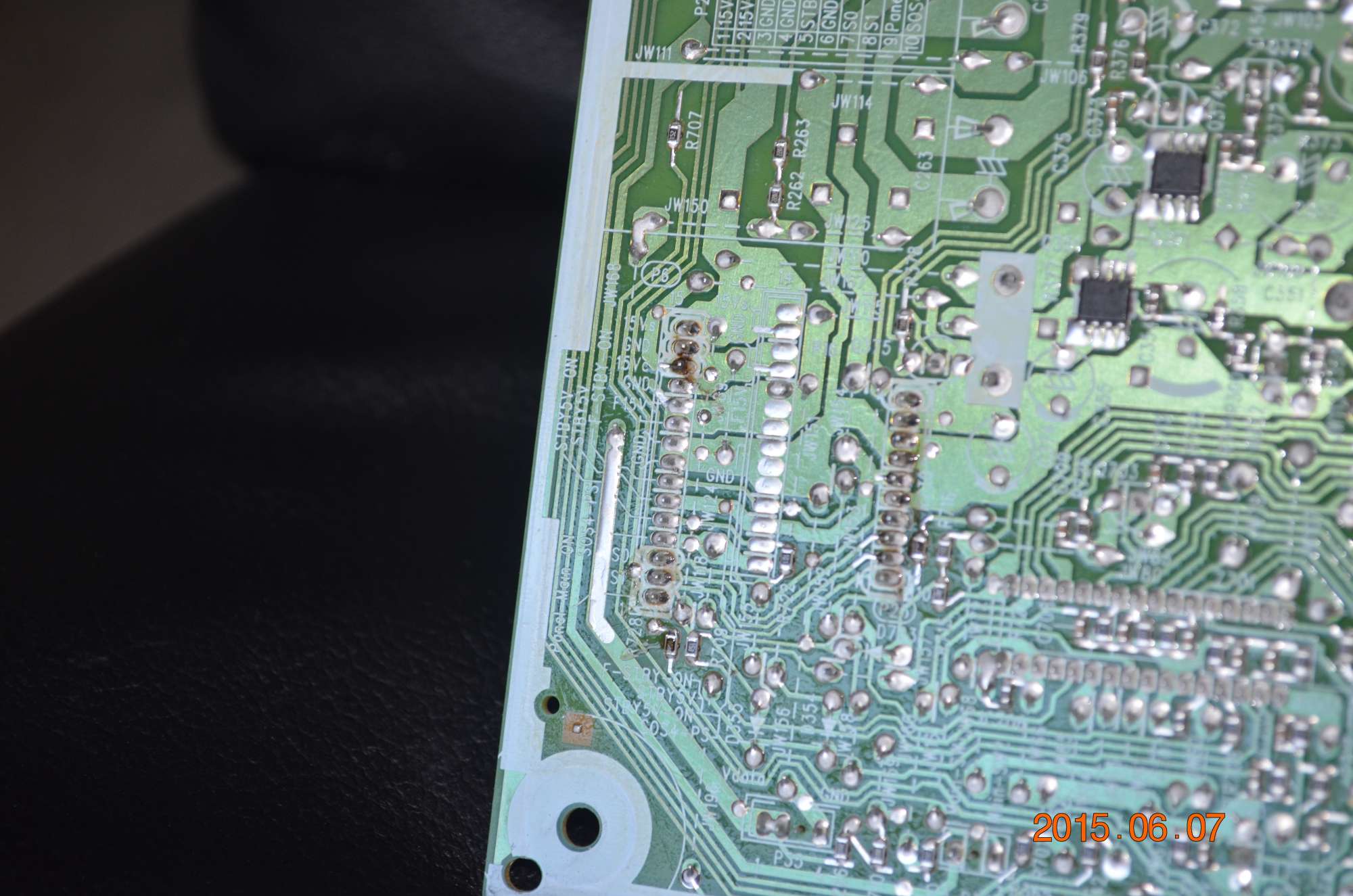

                Not sure what the lightning hit but it fried the receiver's HDMI ports so it likely came through the HDMI to the TV. I lost a number of other items such as my range so I can't pinpoint how it entered the equipment.
                I pulled the P board and I don't see anything that really stands out on the back. There appears to be a dark discoloration around one of the pins that go from the P board to the A board but I don't see any issues with the solder at this pin. I then pulled the A board and may have found the culprit. There is a square chip just below the HDMI ports that has blown. Thanks ljintexas for the post showing a replacement board, I'll swap out the board.
                (I've attached photos of the discoloration at the solder joint on the P board as well as (2) photos of the A board.)
                Any way to know if the swap will work vs. blowing the same chip on the new board?

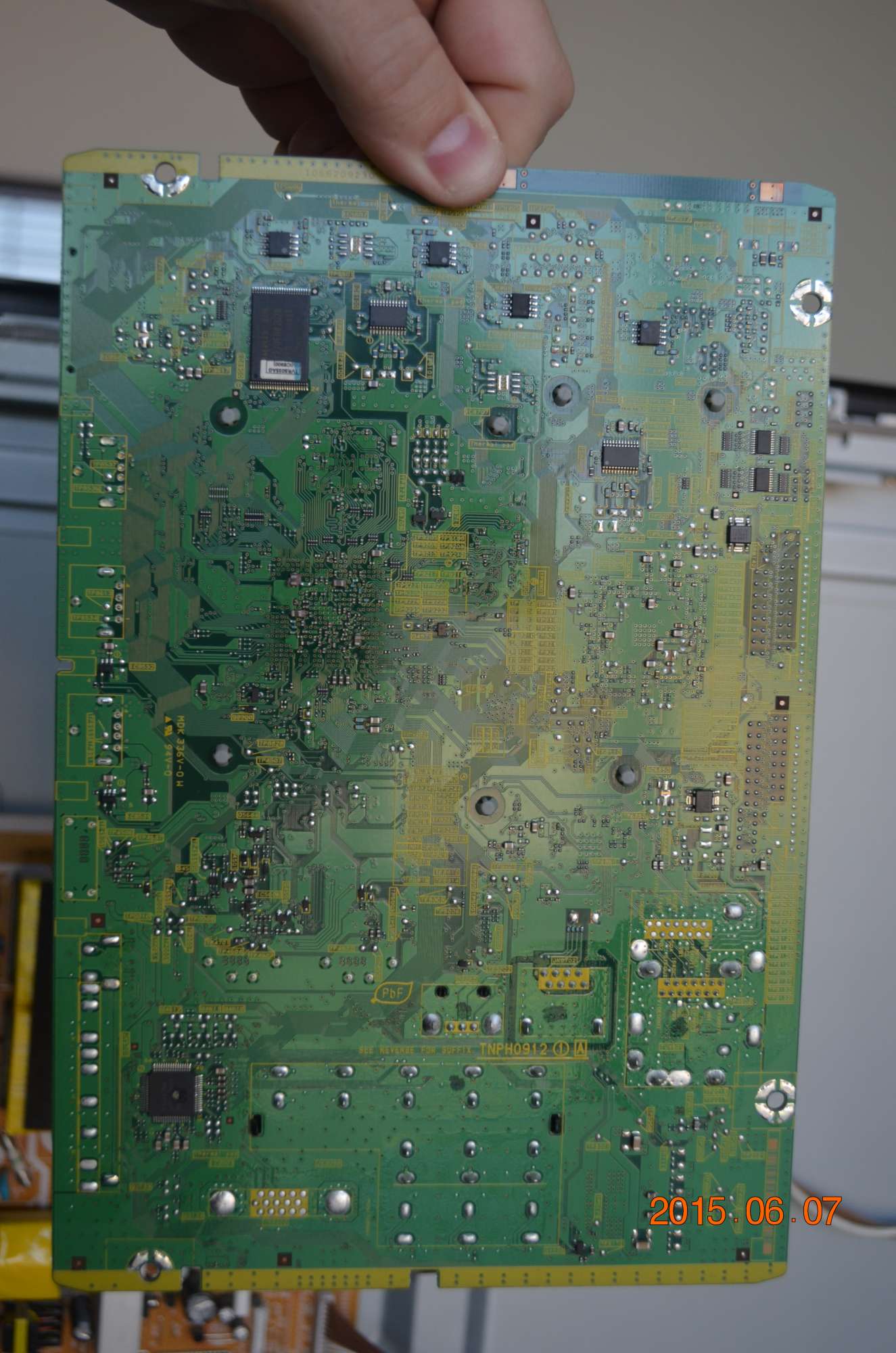

                  I've replaced the A board and found a good news/bad news situation. The good news is the TV boots up, finds my antenna signal and I'm able to watch TV without any issues.
                  The bad news is if I plug anything into the HDMI ports the TV works for about 10-20 minutes (independent of me watching what's on the HDMI or TV) then shuts off and blinks 6 times. I can unplug the TV, unplug the HDMI, and plug the TV back in and it will work fine. Once I plug the HDMI back in it repeats the process.
                  I've tried to plug in different devices and different cords and it's really hit and miss. Some devices make it happen every time while others make it happen sometimes while other times it seems to be fine.
                  Any advice??

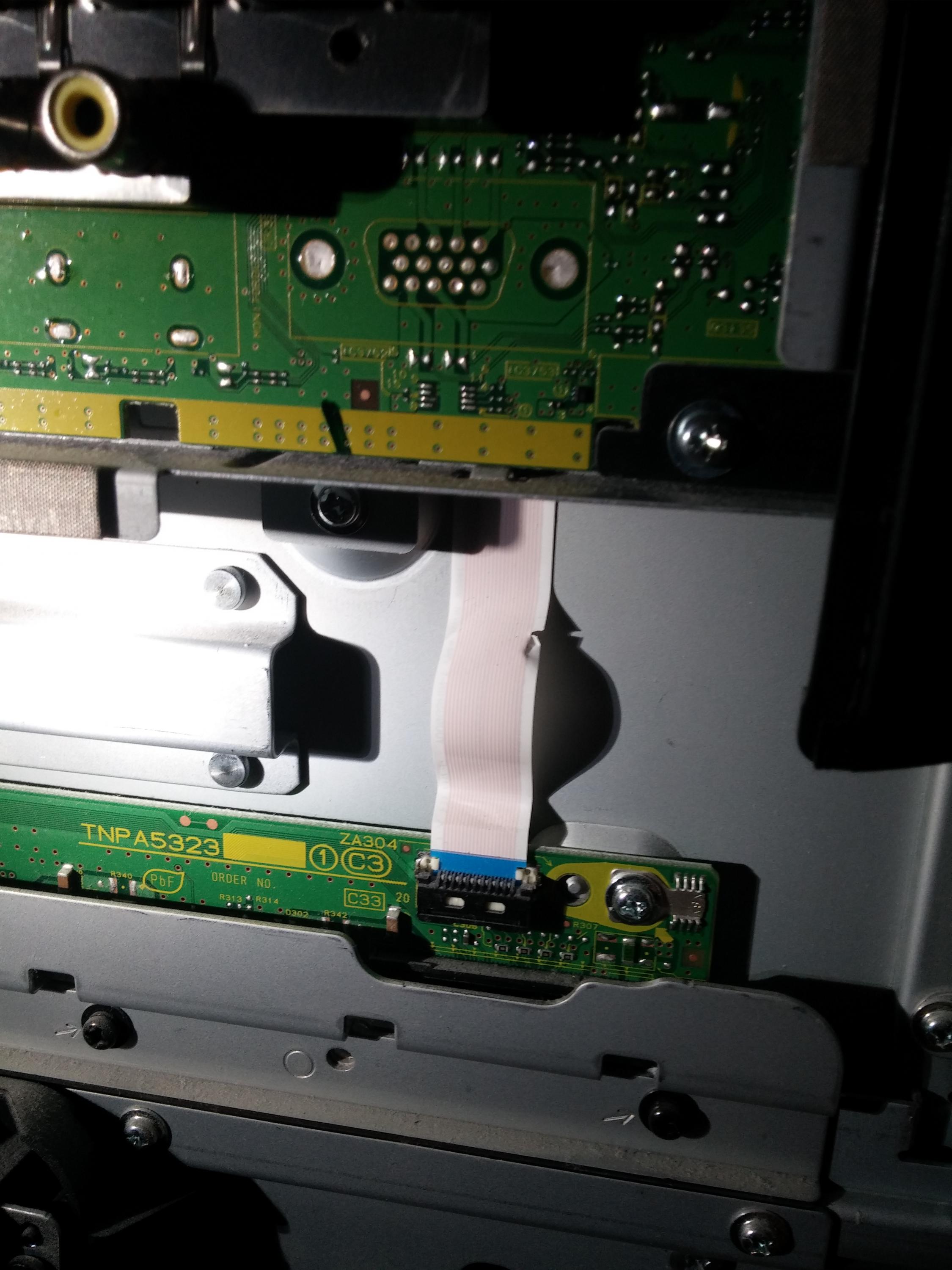

                                  While looking at the A board again, I noticed a tear in the ribbon cable directly below the A board. I've attached a photo of the cable but can't seem to find a replacement online.
                                  Does anyone have a recommendation for a site that I could purchase a replacement cable from? It is the C23 connection that goes up to the SS board.

                                    there is no c23
                                    https://danby.encompass.com/item/955.../TSXM234/Cable
                                    http://www.searspartsdirect.com/pana...9/0333500.html
                                    c33-ss33

                                      That damaged ribbon wouldnt cause the HDMI fault. You would see some stripe or loss of picture in a vertical band down the screen --if the tear had damaged the conductors in the ribbon.
                                      Sounds to me you have bought a dodgy A board.

                                        Ok, the company thinks it was a bad A board as well and have sent another to replace it. I just wanted to be sure I didn't have another issue prior to swapping it out in case that was crashing the A board.
                                        Thanks for the input.
