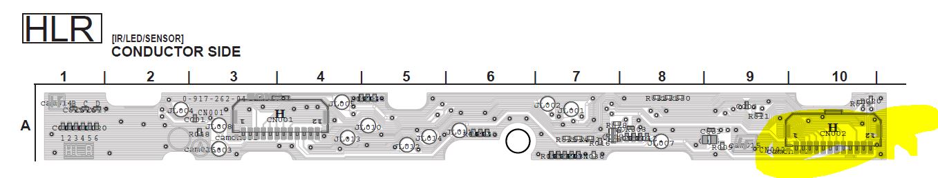

    Ok Guys seriously what goes wrong with a board that has 5 components on it ? to cause a TEMP ERR shutdown making me beleive its a BAL board when its not
    disconeecting the HLR board the tv plays forever there is temp sens on this board there is a remote eye and a few LEDS for indicators and a light sensor ...thats it ....I suspest the remote eye is somehow causing this ?

      Pics of boards and overall layout

        http://www.ebay.com/itm/like/221441034739 thats the board

          Re: Sony HLR board ??
          symptom 7 blinks
          panal temp too high
          shutdown
          Erronius error
          unplug the HLR no more shutdown...
          the prob is on this board
          but what ??
                  This could be big
                  Wish I had a Schematic
                  the connector to the HLR board has 1 white wire and the rest grey
                  the last grey wire showed me a voltage of 2.3 V while connected to the board
                  if this is some sort of data bus this is the issue
                  I removed the wire from the connector the voltage jumped to 3.3V from the BAL
                  the tv is on the board connected the remote works
                  the green led works and the red standby works
                  i dont know about the yellow light light ..
                  and the light sensor is not attached to the pin in question either

                            Sorry to bump the old thread, but I've got the same issue with 60ex700.
                            Based on the responses with the last cable, and this diagram http://www.manualslib.com/manual/901...5.html?page=37,
                            I suspect it has something to do with the RGB sensor. It has both the capacitor and a chip. Either one could have gone wrong.

                              DenisKor, thanks for bumping it again. I may have found something on the HLR board...
                              I've got the same 7-blinks-won't-turn-on issue, but I'm working on a KDL-55EX711.
                              Same symptoms over here, where the TV seems to boot just fine with the HLR board disconnected. With the board plugged in, however, it thermal-faults within a few seconds.
                              After testing whether any of the +3.3V rails may have been shorted to ground through a faulty SMD component (they weren't), I tried daintily removing pins from the HLR board connector one at a time, until the TV stayed powered on with the HLR board plugged in.
                              Pin 11 (DEVICE_SDA) appears to be the I2C data line for the RGB sensor. I think DenisKor called it correctly, since removing pin 11 from the connector allows the TV to boot successfully.
                              I'm gonna try to grab a peek with my USB oscilloscope/data analyzer to see what's going on.

                                  Thanks to all of your posts, I was able to successfully diagnose and fix my Sony TV. Thank you all!
                                  I wrote a play-by-play writeup covering the whole repair process. In hopes of it being found useful to others with this problem, or to those looking for troubleshooting ideas, here it is:
                                  Upon receipt of this KDL-55EX711 Sony TV, the symptoms were:
                                  -Refusing to power on
                                  -Standby light blinked 7 times, repeating every few seconds
                                  -Internal relay clicked on, then off after attempting to power on
                                  First, "Brain Off". I started by taking unit apart, looking for obvious signs of damage (burst caps, charred components, etc.)
                                  Upon finding nothing of merit, I proceeded to scour all PCB surfaces with a toothbrush to clear any potential short-circuits.
                                  After that didn't work, I inspected each PCB with a thermal camera during the system startup sequence. Immediately after attempting start up, multiple hot spots appeared on the main logic board. These disappeared quickly after the relay clicked off and the system refused to start.
                                  I hypothesized the problem may be related to a power supply system, so I set about searching the 'net for a service manual, and people who have had similar problems. Most service manuals cover power supply issues, and forum posts typically abound with successful repairs of this nature.
                                  Okay... "Brain On"
                                  The service manual described the symptoms (red light blinking 7 times after refusing to turn on) as a "temperature error", with the cause residing either in the "BAL" main logic board, or the "HLR" daughter board containing IR receiver and status lights. The service manual for this particular TV did not contain schematics or board layouts, or go into any intimate detail of debugging the symptoms I was experiencing.
                                  One forum post exclaimed that disconnecting the small "HLR" board allowed the system to power on successfully. Success! The TV powered on. But why?...
                                  Continuing with my hypothesis that the problem was related to the power system, I spliced multimeters into both circuits supplying power to the "HLR" board to measure the current and voltage drawn during attempted startup. My theory was that, when connected, the "HLR" board placed an abnormally high current draw on a power supply on the mainboard. In attempting to keep up with the high load, the power supply overheated and caused the hotspots I saw with my thermal camera.
                                  However, testing revealed nothing to indicate abnormally high current draw. In fact, during one test the "HLR" board was left connected, albeit with its power supply lines disconnected. Even when completely unpowered, the board's presence did not allow system to start up.
                                  This indicated to me that the problem did not lie in a power supply, but in one of the data lines. After all, with the voltage supplies removed from the equation, the "HLR" board was still posing an issue for the startup sequence.
                                  Forum posts seemed to indicate that there was a faulty capacitor, not in a power supply circuit as I had originally thought, but on an I2C communication line. Specifically, this I2C line connected to a RGB ambient light sensor on the "HLR" board.
                                  I set about testing the capacitors and resistors adjacent to the RGB sensor for opened and shorted failure modes, but nothing seemed to indicate a problem. That was, until I stumbled upon a schematic for a different TV.
                                  While the service manual for this unit was painfully sparse, I was able to dig up a manual for a different model of Sony TV that was in the same product line. This one had schematics, board layouts, and advanced troubleshooting instructions. The board layout and schematic for the "HLR" board was identical to the one I had, so I went with the assumption that this board was used on multiple models of TV in the same product line.
                                  I lied. The schematic wasn't quite identical. My board had two small capacitors on the SDA and SCL I2C lines that weren't listed in either the board layout or the schematic. Perhaps the forum posts were right, and something was up with these caps.
                                  Armed with this new information, I referred back to the original service manual's system block diagram. Interestingly enough, it showed the RGB ambient light sensor on the same I2C communication bus as... the system temperature sensor! BINGO!
                                  New hypothesis!
                                  A faulty capacitor on the data line containing both RGB light sensor and temperature sensor inhibited communication on the I2C bus. Because the system could not communicate with its temperature sensor, it assumed the worst and forced a shutdown. Every. Single. Time.
                                  To test this new hypothesis, I very carefully removed the two 0201 SMD capacitors (the size of a grain of sand - no joke!) from right next to the RGB sensor. I then plugged the board into the TV... and....
                                  Voilá!
                                  And there you have it- A, $1,800 TV brought to its knees by a single <$0.20 part.

                                      I was glad to find this thread regarding the 7 blinking lights on the Sony KDL-55EX711. I have the same problem. My TV would go into the 7 blinking lights mode quite reliably after 1-5 hours of operation. I did the experiment to remove the HLR board. The TV stayed on overnight without an error. I examined the HLR board and did not find the capacitors on the I2C lines, SDA or SCL. I only saw the serial resistors.
                                      I researched into the need for the RGB ambient light sensor. It appears to be a way to automatically adjust the backlighting for various lighting conditions in order to save power. I believe this feature can be turned off and the backlighting can be set manually and remains that way forever.
                                      The fix that I implemented was to cut the wires (11,12) on the connector to the HLR board. This allows the remote control and LEDs to continue working on the HLR board.
                                      Why does the temp error happen? The temp sensor is on the BAL (Main) board. The I2C bus runs to this temp sensor and the RGB ambient light sensor on the HLR card. Occasionally the temp data readings are corrupted by having these 2 devices in parallel on the bus. The corrupt readings are interpreted as the TV getting too hot and the TV shuts down and the LED flashes 7 times. Removing the RGB sensor from the I2C bus improves the data readings and no more errors occur.
                                      I thought about buying a new HLR board on the internet but it seems the problem might come back, so I will live without the ambient light sensor and auto adjustments.
