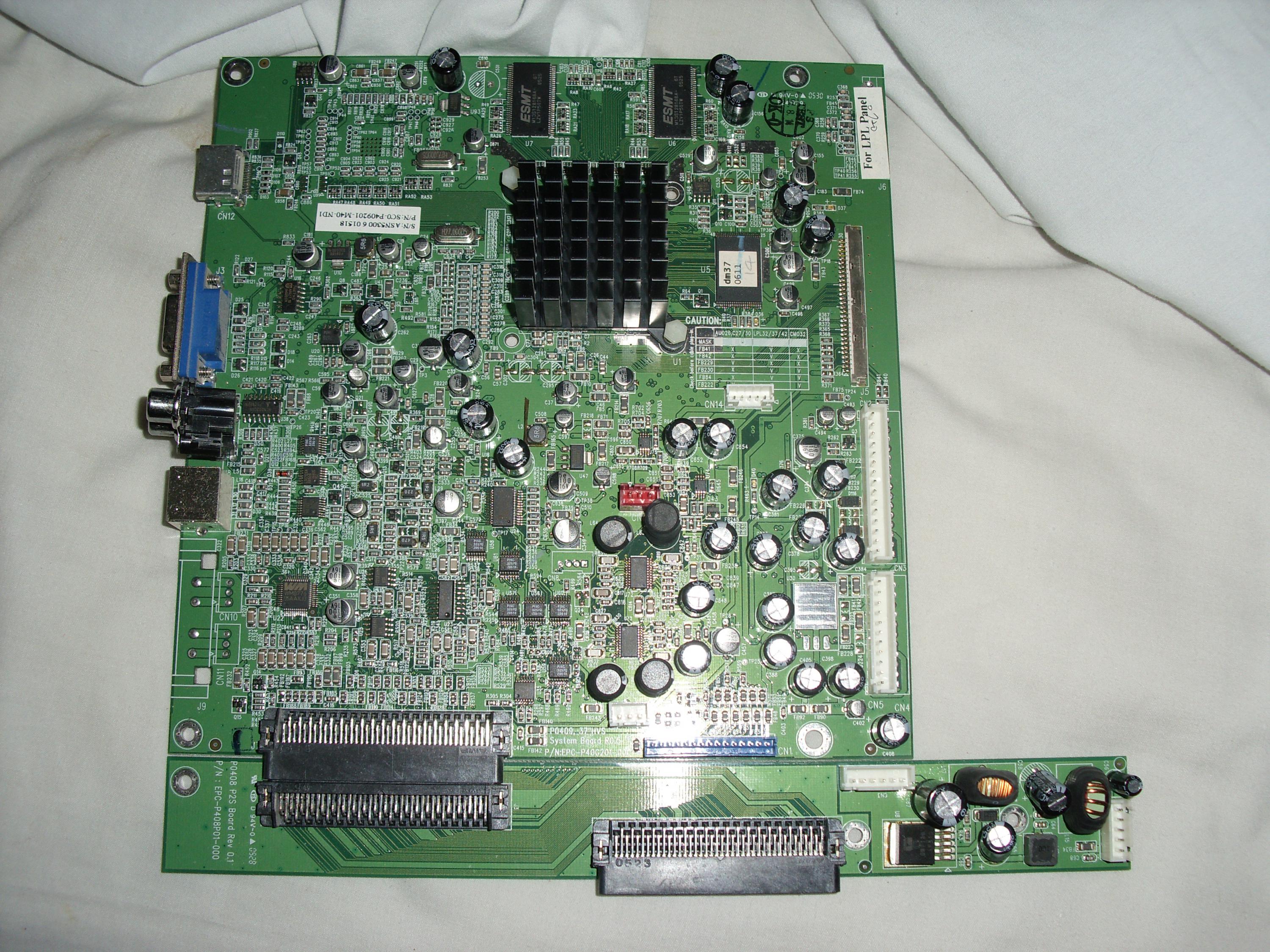

Olevia LT37hvs
    Re: Olevia LT37hvs
    https://www.badcaps.net/forum/attach...7&d=1433356385
    I have no idea, I do not see 'empty push in thingy'. The picture is too out of focus for me to see.

        Re: Olevia LT37hvs
        Attached please find another picture of the board. If you look for the white plug its CN?14. I don't find anything that was plugged into it. I have to borrow a meter again to check the fuses. Will let you know about them then. Do they show up dead if no power has been on them in awhile or are they always working unless dead?
          Re: Olevia LT37hvs
          I see the CN14 WITH 5 pins on it. There is a reason I request to see the hwole back side of the TV.

            Re: Olevia LT37hvs
            I talked to the friend I borrowed the tester from. His ex worked for a company that made computer boards and he said they would put an extra like CN14 with the 5 pins on it and it was either a potential upgrade and they would sometimes use them but it made the boards sort of interchangable with others. Basically a generic board. I don't see a reset button on the T-Con, Power supply or the other board. He's saying there is either a reset button or I would have to just replace the fuses for them to start working again. Any thoughts? And what number etc would I have to buy?

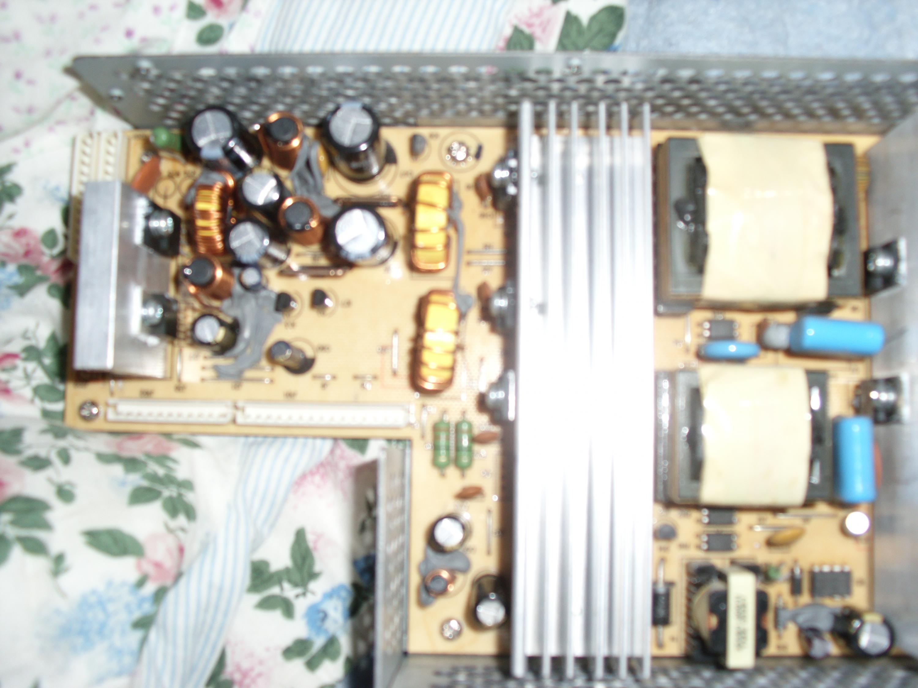

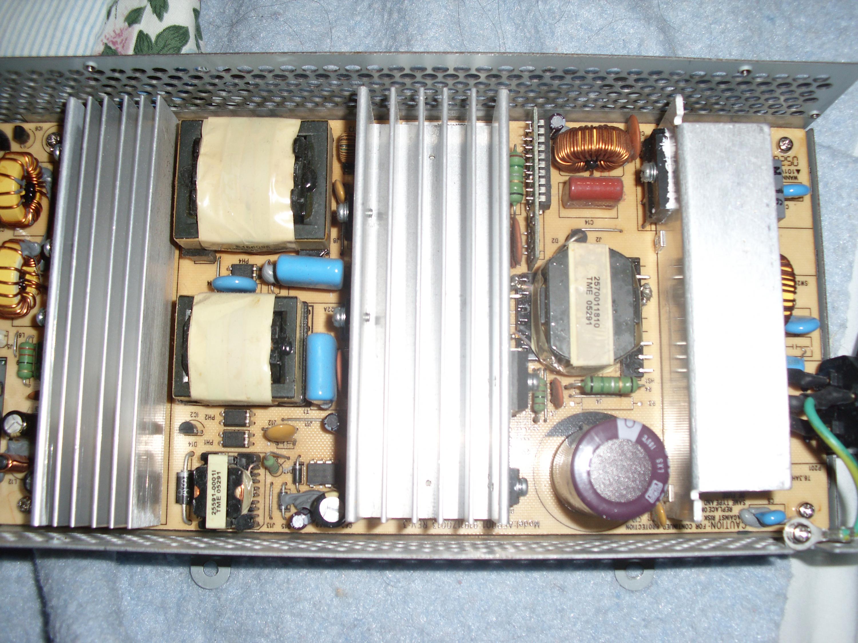

              Re: Olevia LT37hvs
              Attached please find the power supply. I don't seem to be having any problem at all with it since I replaced all the caps. Haven't been able to get my soldering gun to work so I'm a little behind getting anything done. Any thoughts on the fuses and should I replace them?
