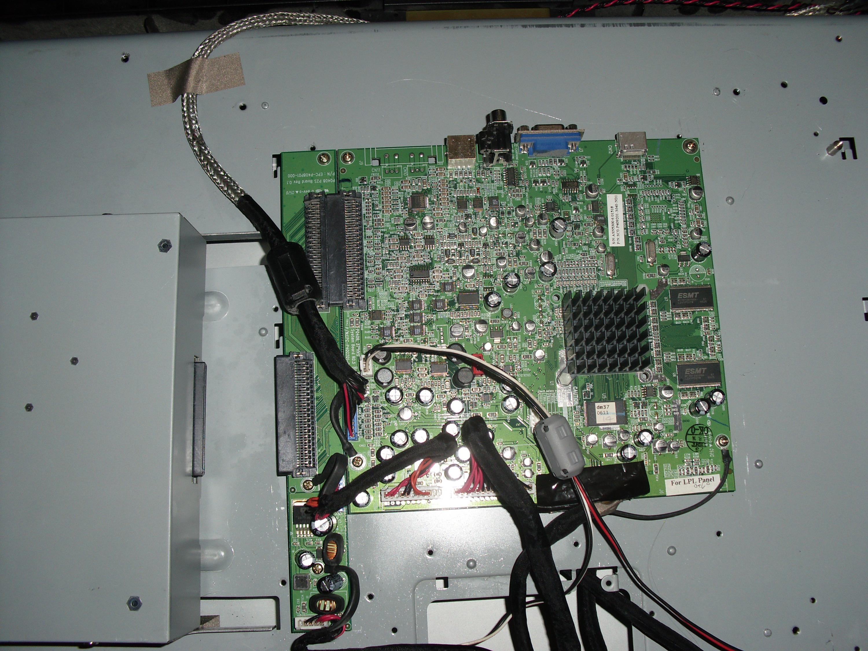

    I've attached some pictures of another board in the hopes someone has some suggestions. I don't think any of the caps are bad thou.

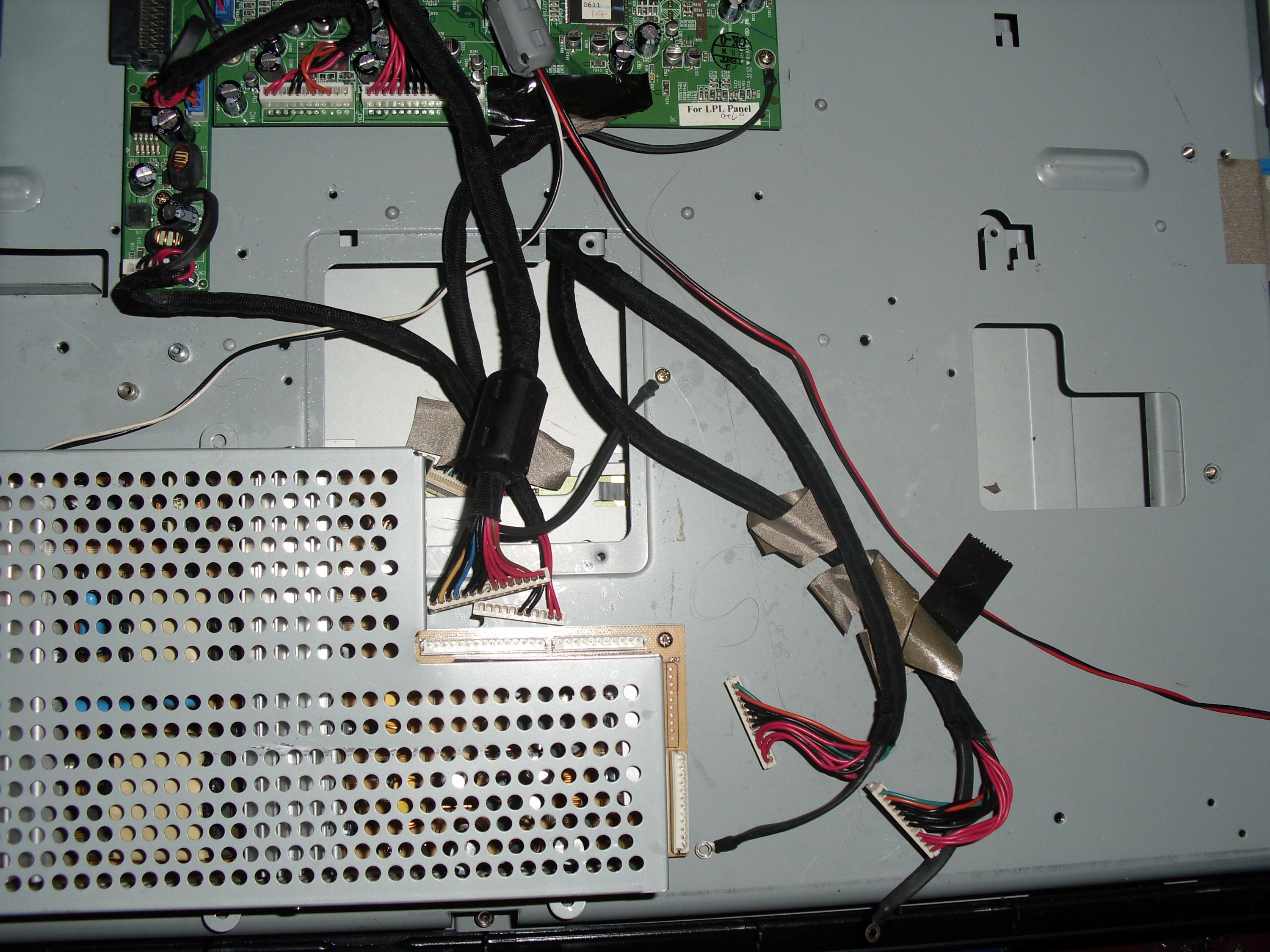

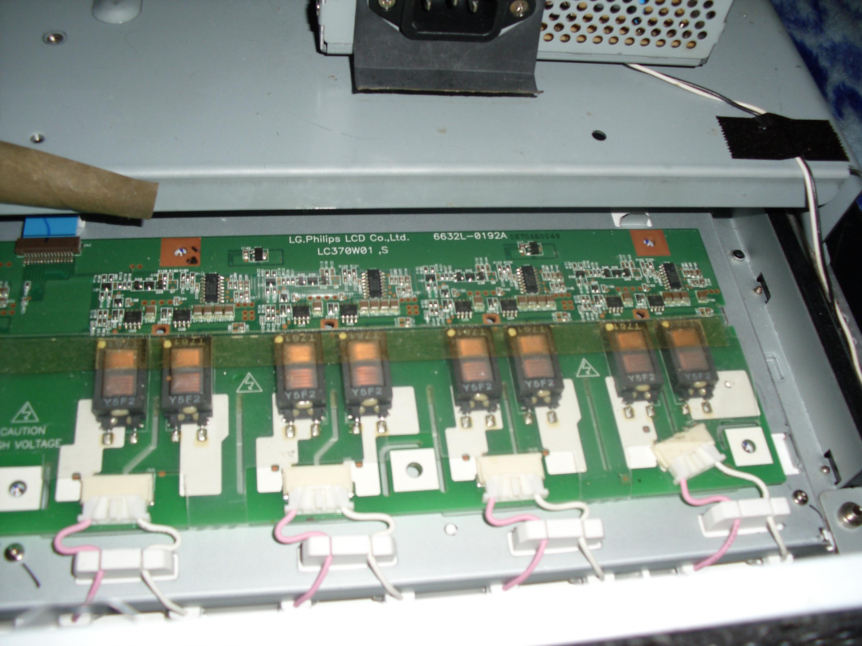

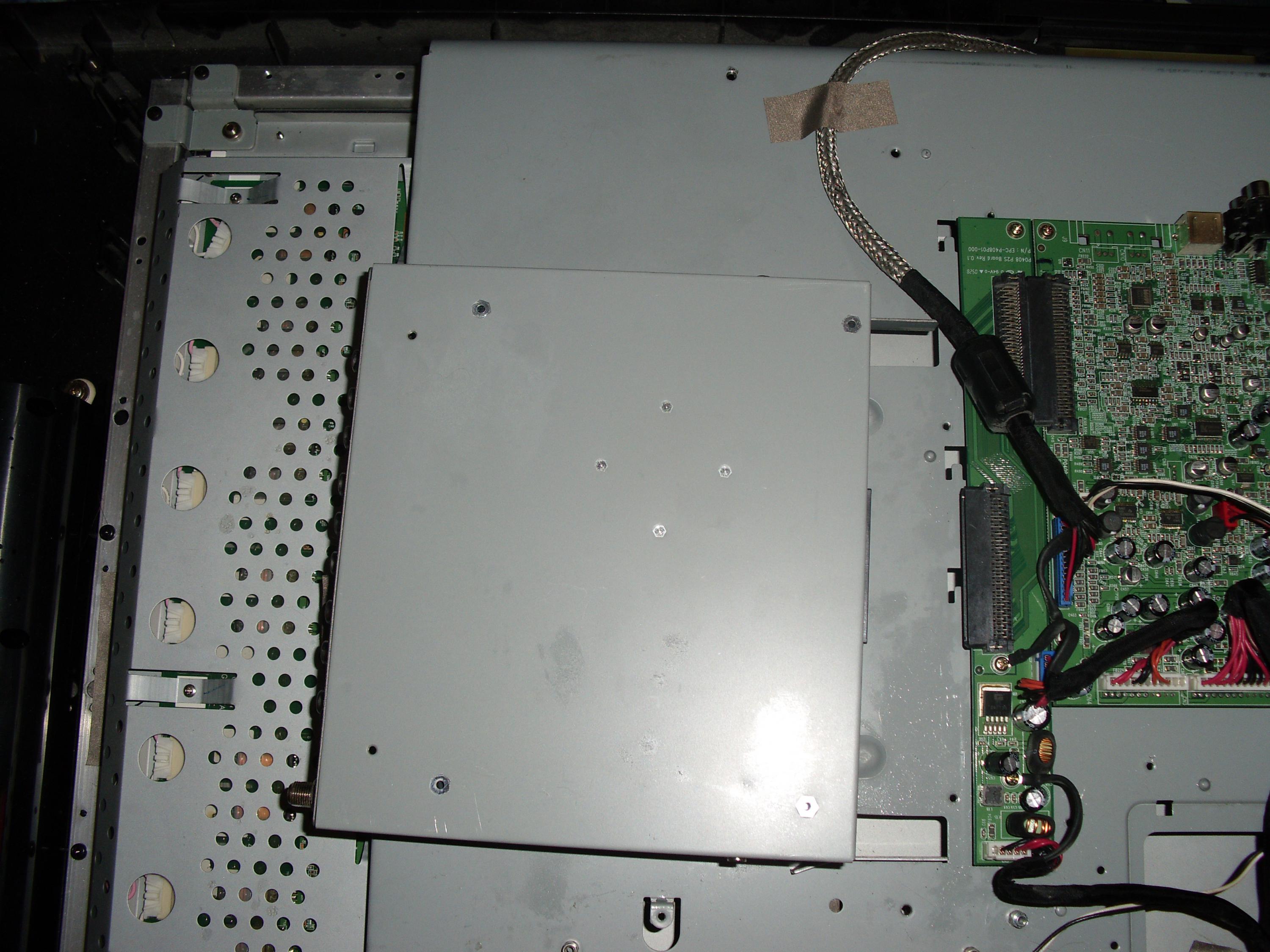

              You need to see if you do have BL-ON signal and the 24VDC feeding the Inverter board.
              Your pictures do not show the Inverter board, it is buried under the metal shield.
              There are more than one version of this model.

                    Re: Olevia LT37hvs

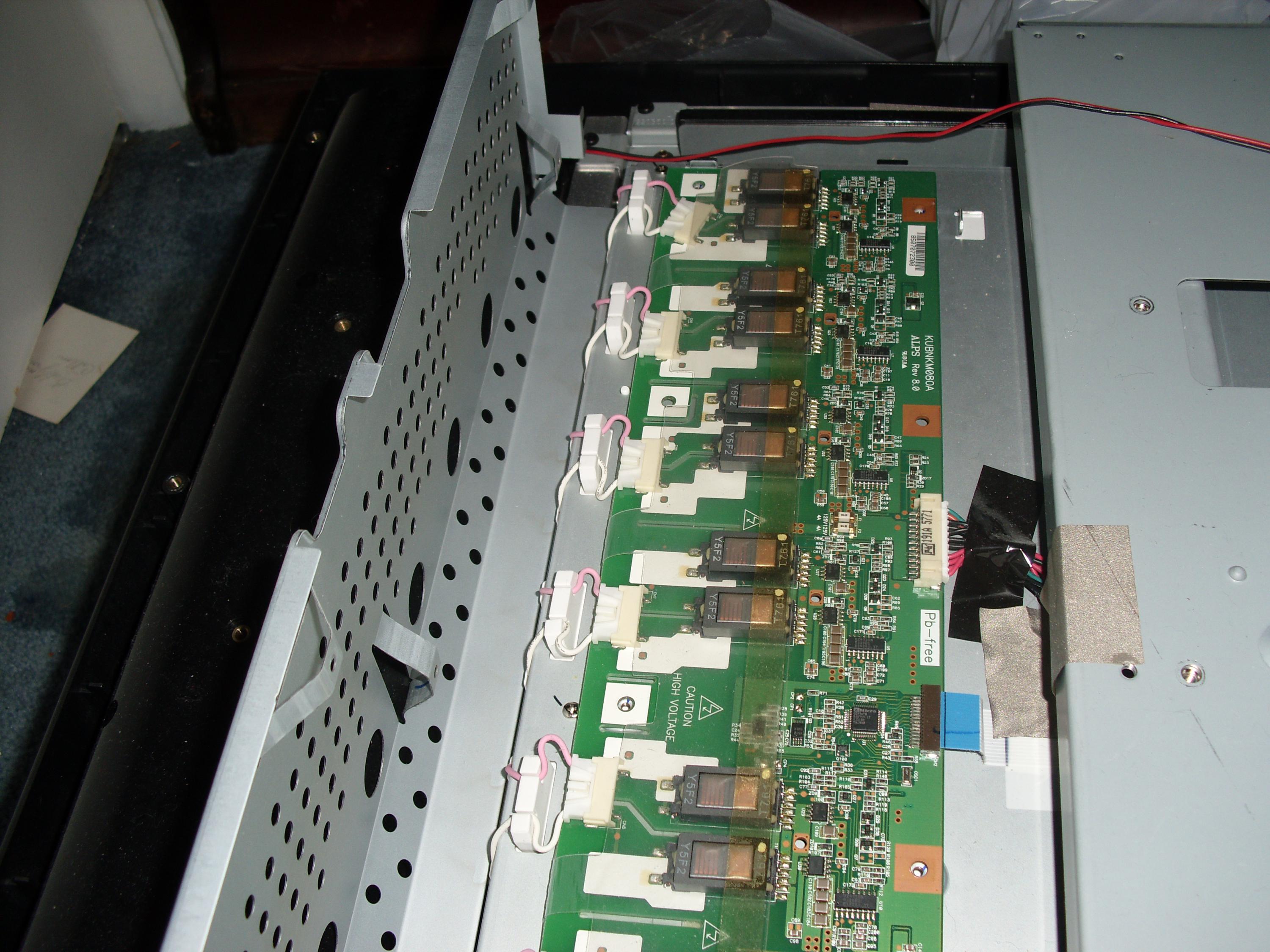

                    The inveter board is under that metal shield with lots of small holes on it, this TV model is not easy to work on.
                    https://www.badcaps.net/forum/attach...3&d=1438529453

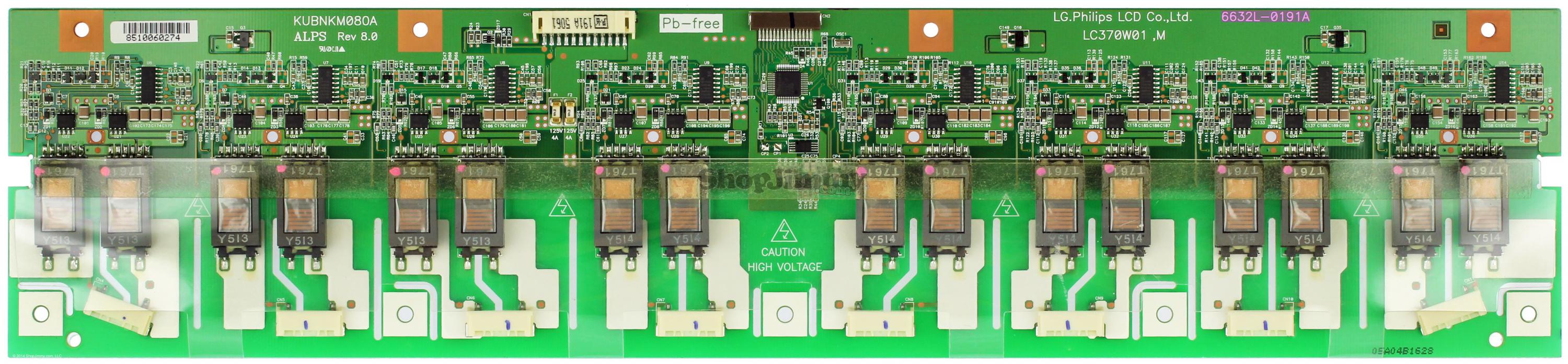

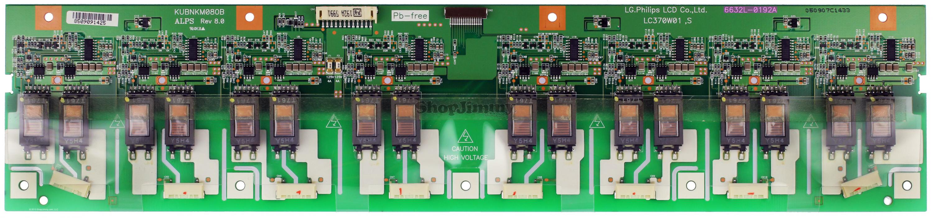

                    i am not sure if this TV has TWO inverter boards (MASTER/SLAVE) or not. That is why we ALWAYS ask people to show pictures of the WHOLE back side of the TV.
                    See the pictures of that BACKLIGHTS inverter boards.
                    http://www.shopjimmy.com/catalogsear...Olevia+LT37hvs

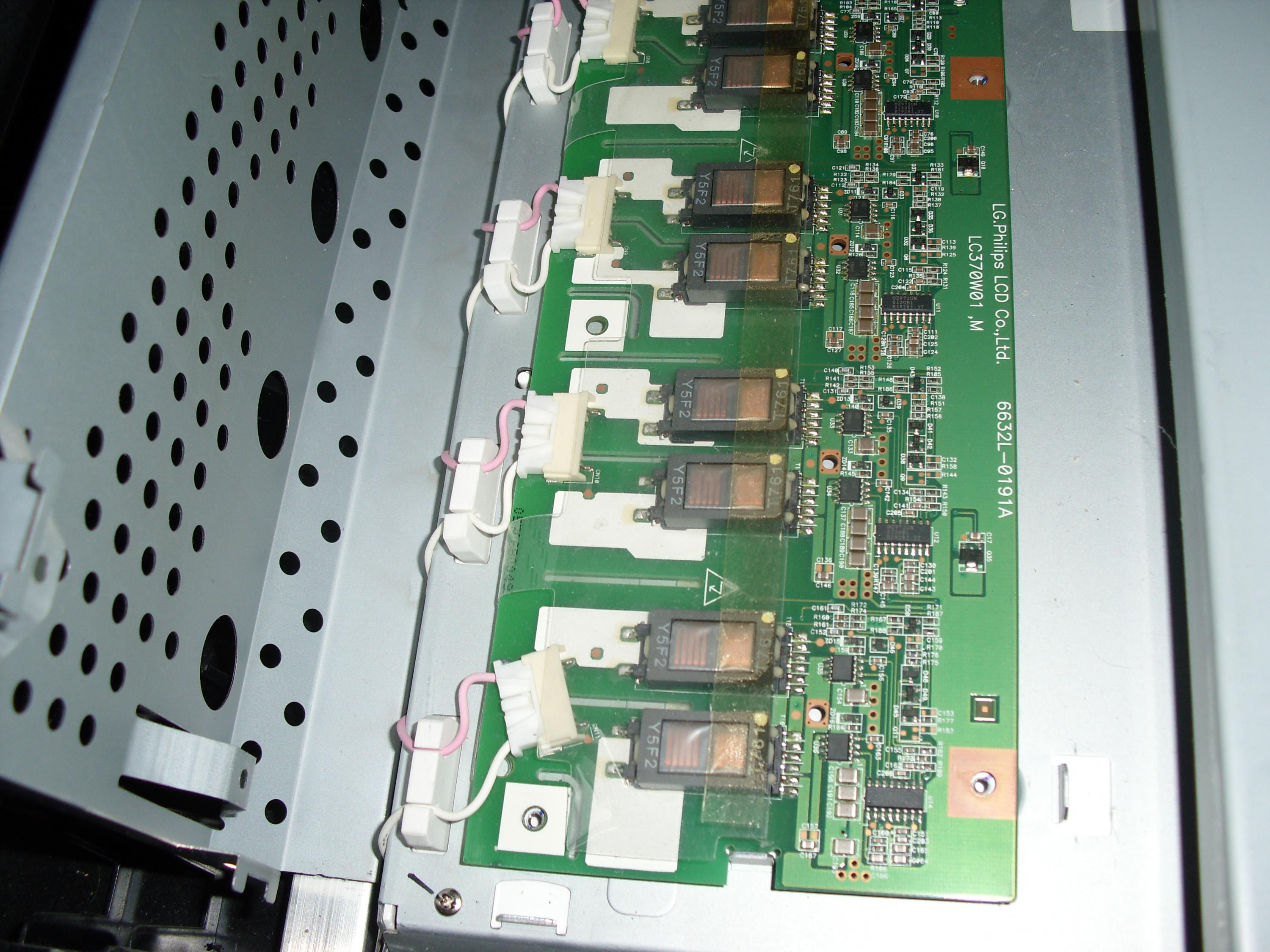

                      Re: Olevia LT37hvs
                      There are two of them. One on either side of the tv. I was thinking they were something like sound boards or the like. As you can guess I know nothing about tv's and I'm winging it. It's fun learning new things and thanks for all the help. I'll have to see if I can get someone to hold up part of the tv so I can take pictures of it. Your right about it being a pain.
                        Re: Olevia LT37hvs
                        Watch out for the cable with shielded braid between the T-CON board on the LCD panel and the main board, you will easily rip that cable when you try to lift the main metal chassis, you need to disconnect form the main board, make sure to remove the screw for the shield ring terminal, pulling that connector off the board is not easy either, you must grip the body of the connector not the wire.

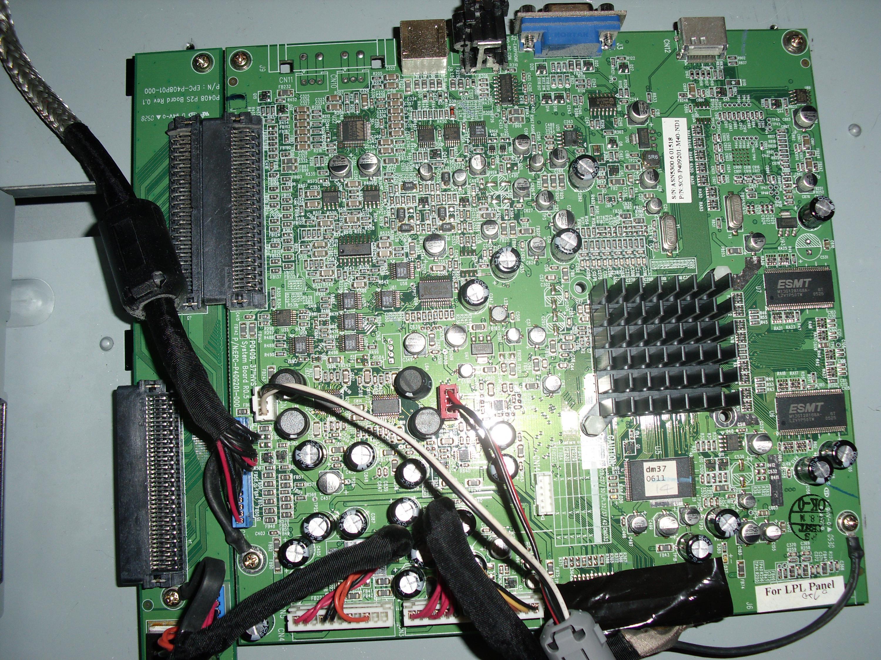

                          Re: Olevia LT37hvs

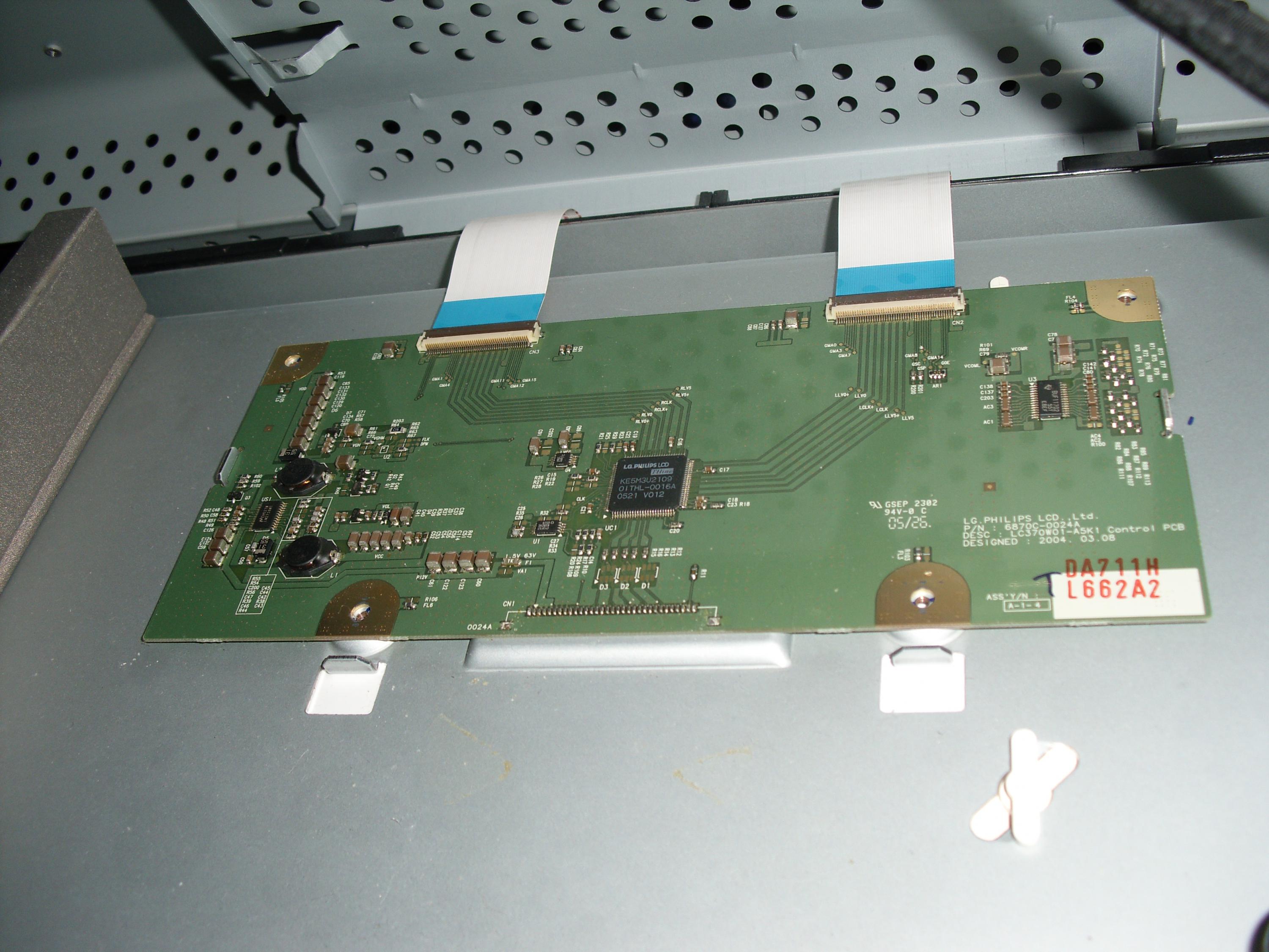

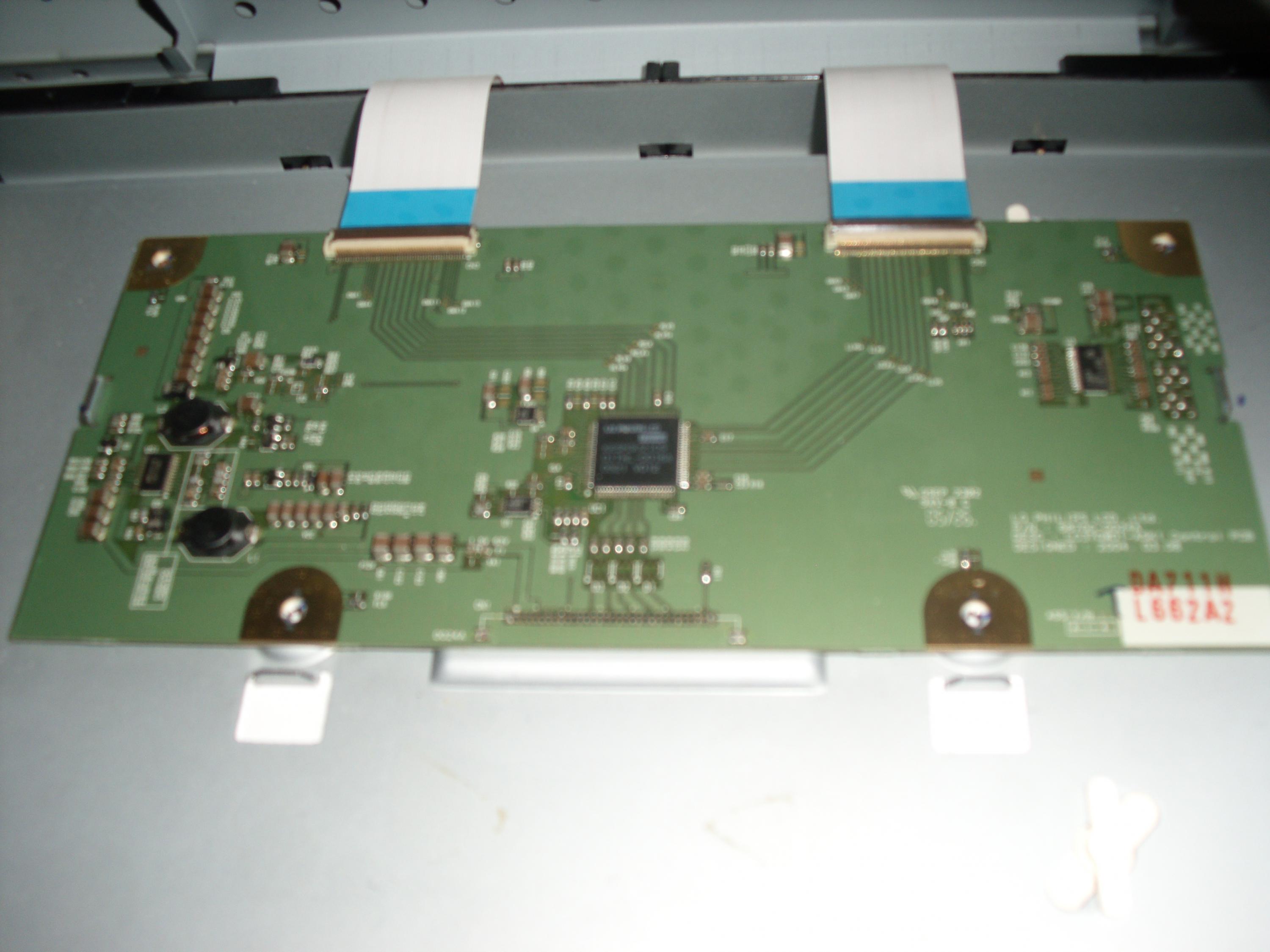

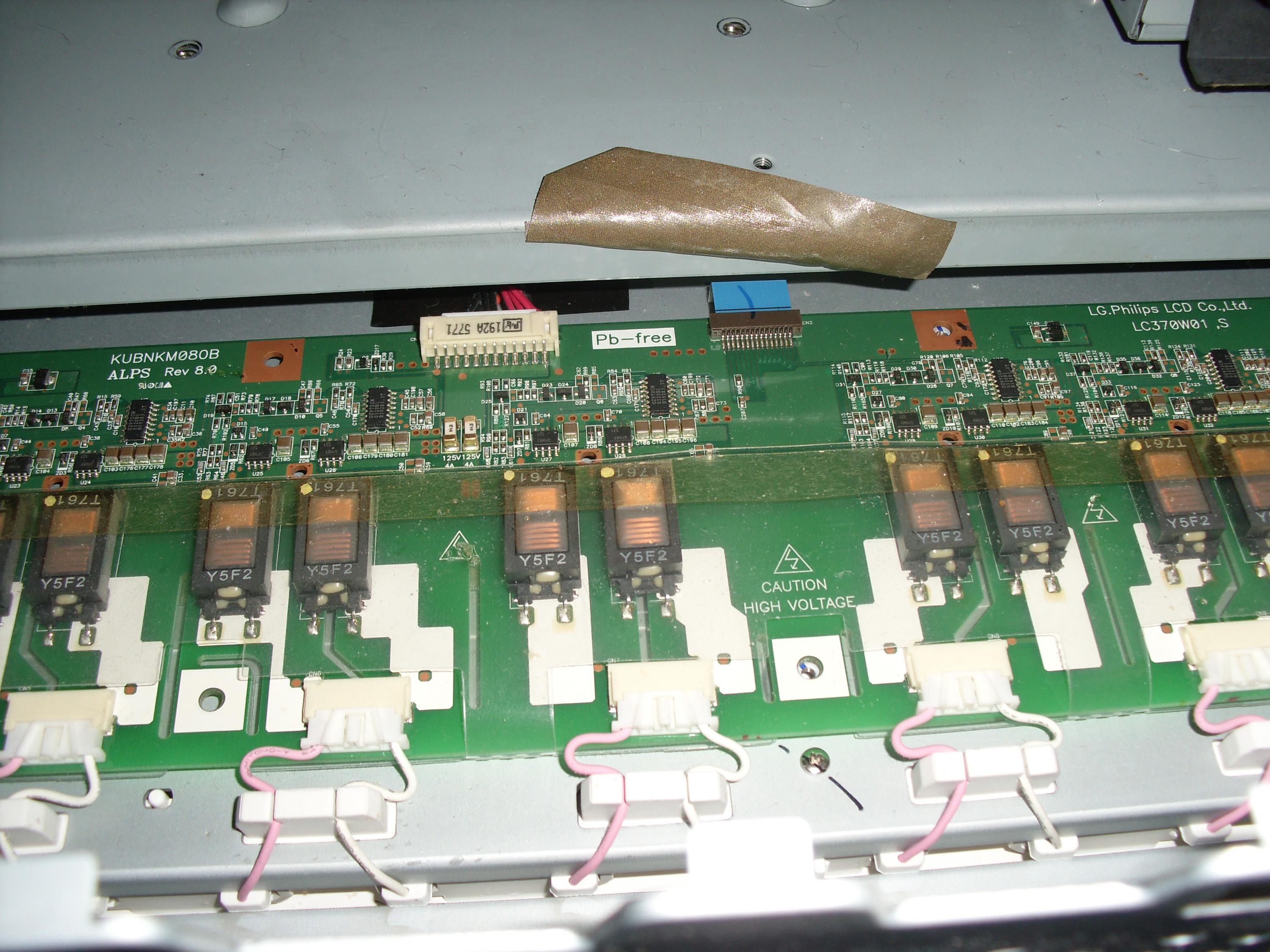

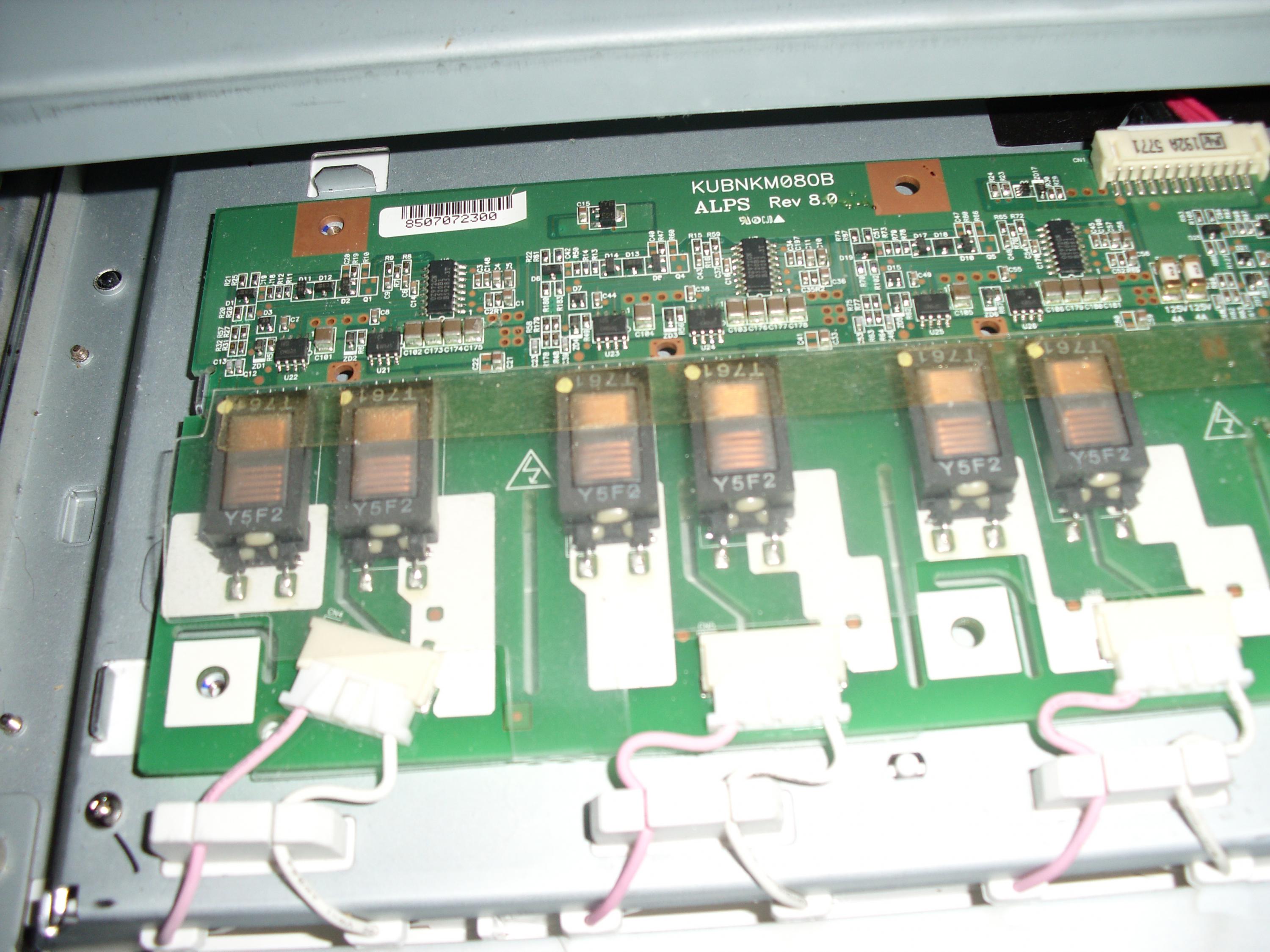

                          Attached is one side of the main something. The next one is the 2nd side and the third one is that thing underneath everything. Sorry I don't know what the names are.
                            Re: Olevia LT37hvs
                            2nd batch of photos.
                              Re: Olevia LT37hvs
                              The first two are the backlights inverter boards, the third one is the T-CON board.
                              You should have 24VDC on those read power wires. Those reed wires go back to the power supply board which is under the metal shield.
                              There are fuses on those boards that you need to check, they have white body with gold terminal on each end.
                              Pictures provided by SHOPJIMMY.

                                  That is T-CON board.

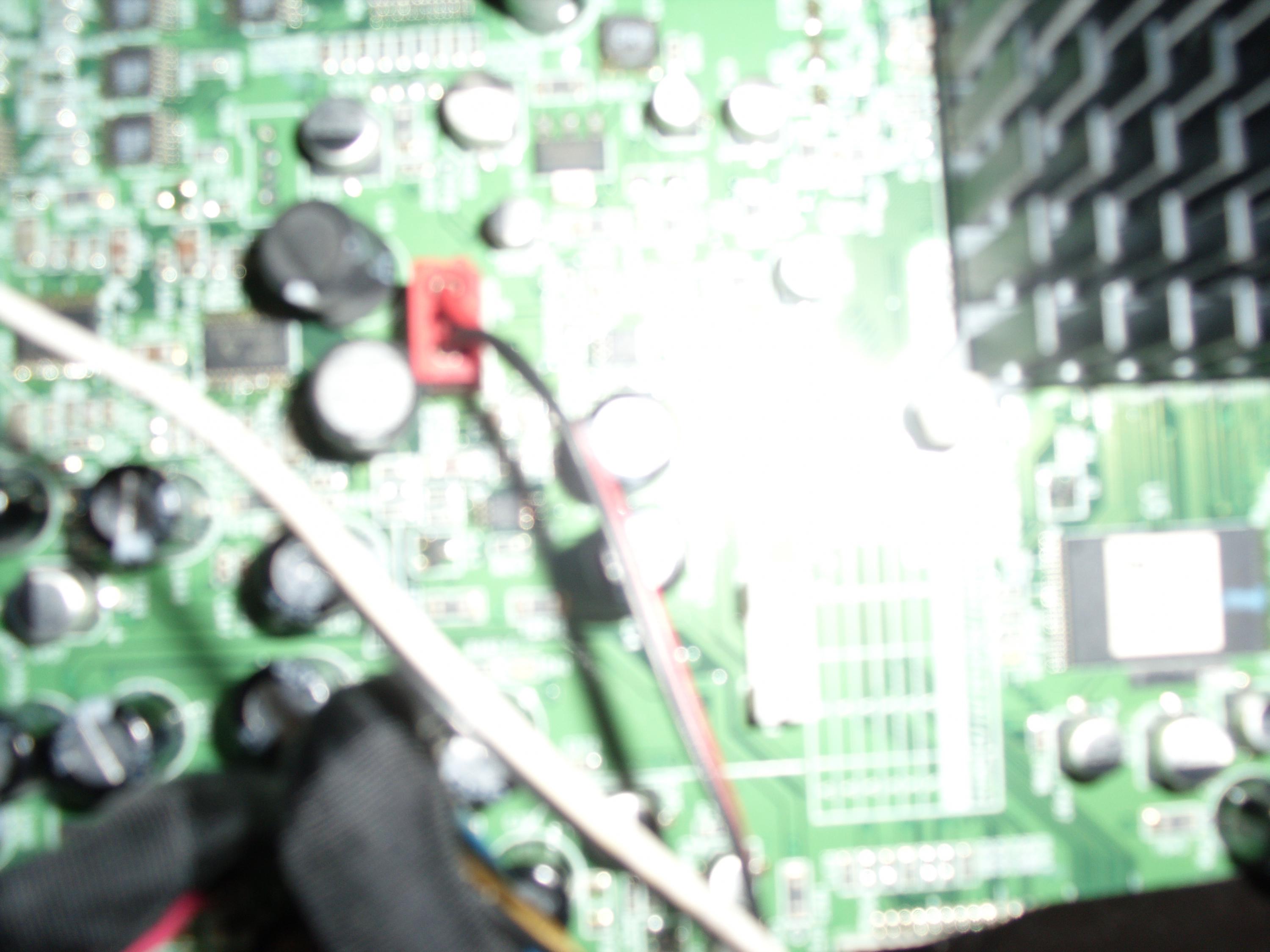

                                        https://www.badcaps.net/forum/showth...ghlight=olevia
                                        If you look at the first picture in this thread you will see about an inch and a half down and empty push in thingy. It's between the tape and the wires. I don't have anything that is attached to it and it makes no sense to me. All the other ones have something to attach to it.
