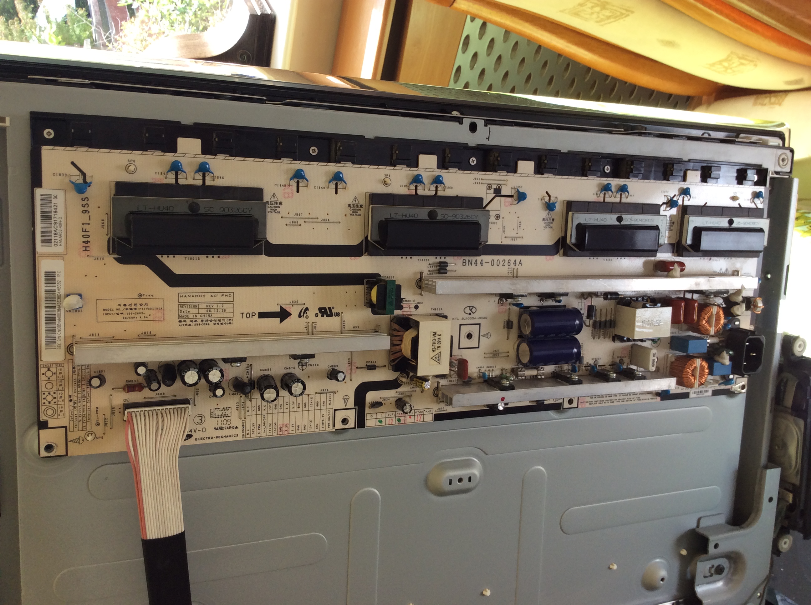

    Hi All
    new to this site asking for help or advice
    got a Samsung LE40B652T4WXXU HD TV
    power board fitted is BN44-00264A
    TV worked fine, however was suffering from very bad screen flickering
    If backlight was set high ie 10 screen would flicker bad until backlight/ picture would go off after a while, sound was still ok
    If backlight was set low ie 1 to 5 screen was fine however dark tv would stay on all day
    Last night whilst watching tv screen went black, backlights off, sound working ok, all other functions seem to work.
    when switching tv on now screen sometimes lights for maybe 1 second then goes off
    I am convinced this is a power board/inverter problem, and have replaced all caps on the power board, result still the same.
    need help now anyone any ideas what to look for and check now
    have googled this seems to be a common fault on this set but found nothing as to what is the problem with it
    thanks in anticipation

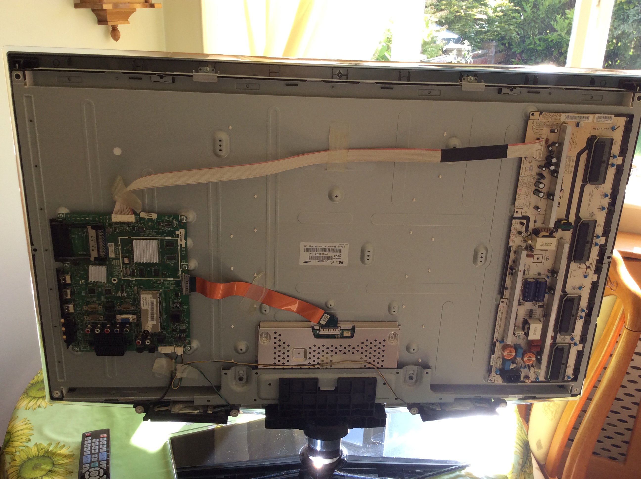

    Pictures of boards and chassis.
    I am going to take a guess at the LED's being bad, We see it all to often these days

      Re: Samsung LE40B652T4WXXU Screnn flicker now black screen
      Trying to upload some pictures now
      However prior to black screen picture was very good with no shadows suggesting to me one or more of the backlight tubes was not working, I may be wrong though
        These are LED and not FL Tubes.
        We see so often that an LED on the strips goes bad and causes this fault
          These power board do suffer with bad inverter transformers resistance check each one and compare? Flocko
