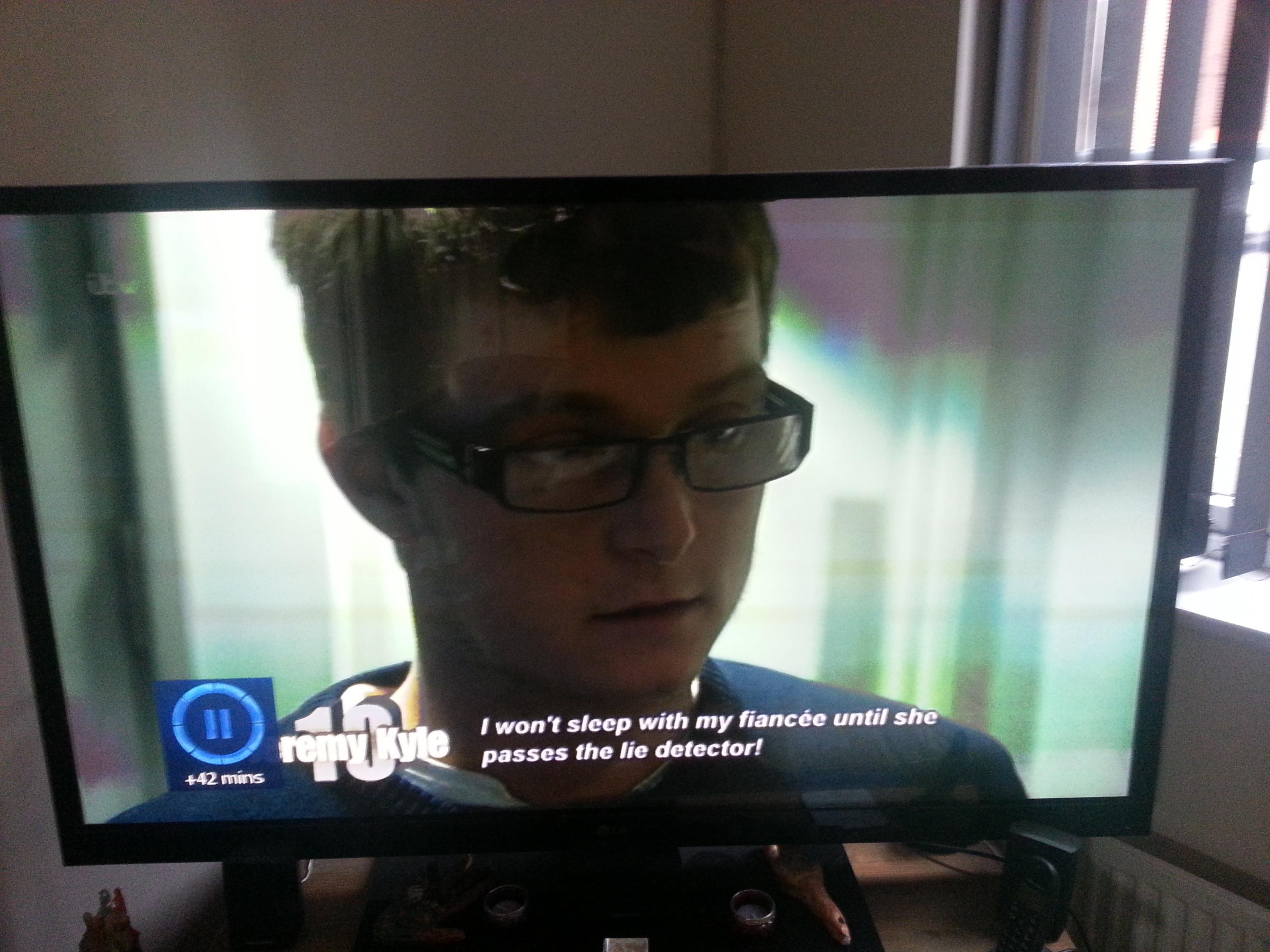

    Hi I have an LG 60PZ570T-ZB its around 5 years old and the colour has started to distort.
    for some reason it don't seem so bad if at all if I play a DVD but did see a slight problem when using DVD
    can anyone help please?
    Re: LG 60PZ570T-ZB distortion
    This is a well known issue.
    TURN OFF your TV before the damage becomes worse and do not use it or you will have to replace a £150 board.
    If you turn it off now and begin the repair, it will only require a little solder rework on the bottom of the Y- and Z-sustain boards.
    Post a picture of the TV with the boards removed.
    You will need a soldering iron, solder and wick, the soldering is easy as the devices are large.

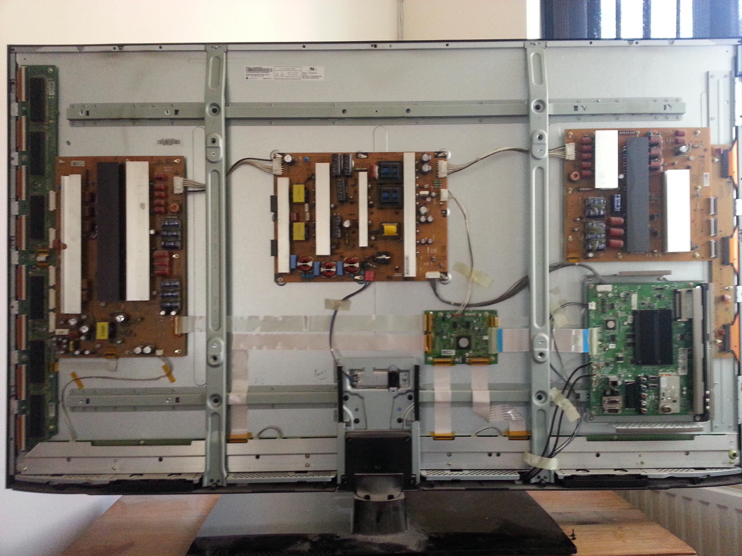

        Hi Tom66 heres the back of the TV with all the boards showing. can you tll me which are the Y- and Z-sustain boards I need to remove and take a photo of please?
        many thanks for your help
        • Alastair E
          Chief Womble
          • Mar 2013
          • 1963
          • U.K.
          Y-SUS and Z-SUS will need removing and the ERC Coils re-soldered.....
          Z-SUS on the right, Y-SUS on the left. ERC Coils are the heavy thick wire coils on both boards....

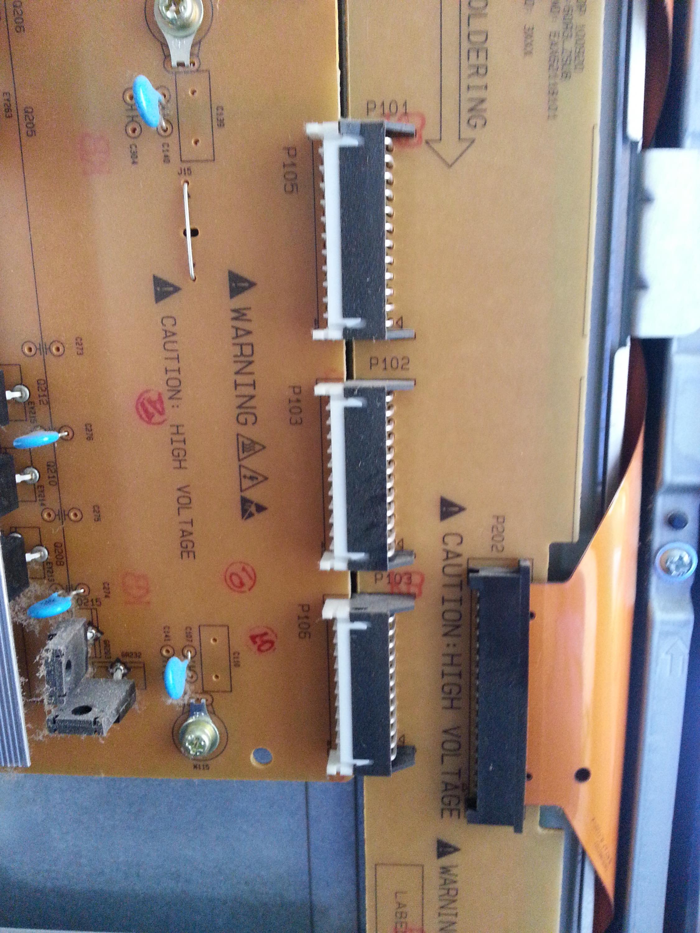

            Hi Alastair Thanks for helping.
            so the large brown board on the left and the large brown board on the right/top have to come off.
            I see the 10 or so screws holding the board on there and see how the leads come off but can you tell me how the white ports come out do they slide out once the screws are undone?
            I take it these are the thick brown coils that will need re-soldered?

                and the white ports they slide out once the screws are undone do they tom66?
                not done much soldering but do have a good one is this something a beginner could do? will look up some soldering techniques on youtube and watch 1st I think
                  This is something a beginner could do but if you have some scrap electronics spare I would recommend practicing first on other parts.
                  The white connectors will be a little tight - just gently wiggle the board gently from side to side to disconnect them. Leave the other boards screwed in or it will be much more difficult.

                      cant seem to get the white connectors to come out do they clip in as tried to gently wiggle them but there not coming loose
                      • newtothis
                        • Mar 2013
                        • 1556
                        • england
                        They are just stubborn. Just keep at it
                        • sealover1
                          • May 2015
                          • 18
                          • uk
                          lol your right I got the 1st right hand board out now was just worried about pulling on them to hard
                          • newtothis
                            • Mar 2013
                            • 1556
                            • england
                            At the end of the day connectors can be replaced if broken (not that you want to do that) so don't worry so much about the pressure.. They do take a lot to get apart

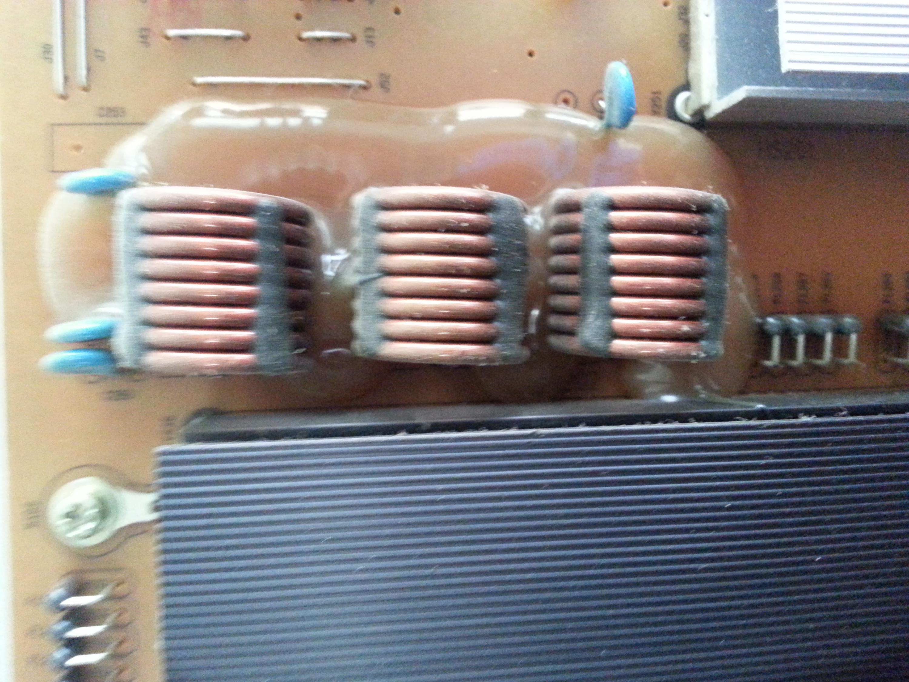

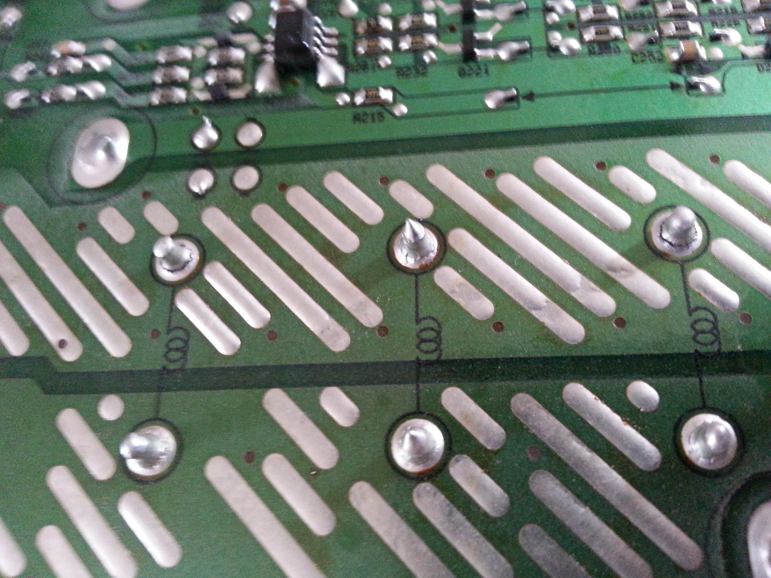

                              see what you mean now the solder is cracked on the coils
                              soldering lol I better practice that's a tiny place to solder only ever soldered twice and that was wires to wires

                                What you are going to want to do is remove the old solder using solder wick/braid and the re-solder with new solder. Reason for this is that industry standard due to laws is to use non leaded solder which becomes brittle and cracks after expansion and contraction caused by heating and cooling... As leaded solder is more malleable this won't happen as easily.

                                    Simple case of melting the solder and flowing some extra leaded solder to area to soften the solder and bring the melting point down (Unleaded solder melts at ~217c and leaded around ~183) then placing some solder wick against the solder for the coils and placing the soldering iron on top of the wick pushing it against the solder... The wick will soak the solder up... Move to a clean bit of wick... rinse and repeat until the solder lets go of the legs of the coils. Remove the coil then use wick again to clean the pads. Replace the coil and place the iron against the pad and coil leg and melt solder to it.
                                    Honestly its not that hard to do

                                      Soldering is easy--But doing those coils with a cheapo 15-20W iron--bloody difficult!
                                      You'll need a good temp regulated 50W iron to do them properly, because the board tracks and the thick wire of the coils will suck away heat very quickly, leading to poor joints....
                                      I use a 60W iron wound up to 450 degrees C when doing that type of work, using the extra temp gives a good shiny joint in a short time, rather than trying to do with lower heat that tends to scorch the board--as you need to heat for so much longer....
                                      BTW--Give all the heatsinks and boards a damned good clean with a paintbrush to remove all the dust--this will help with airflow and cooling.....
