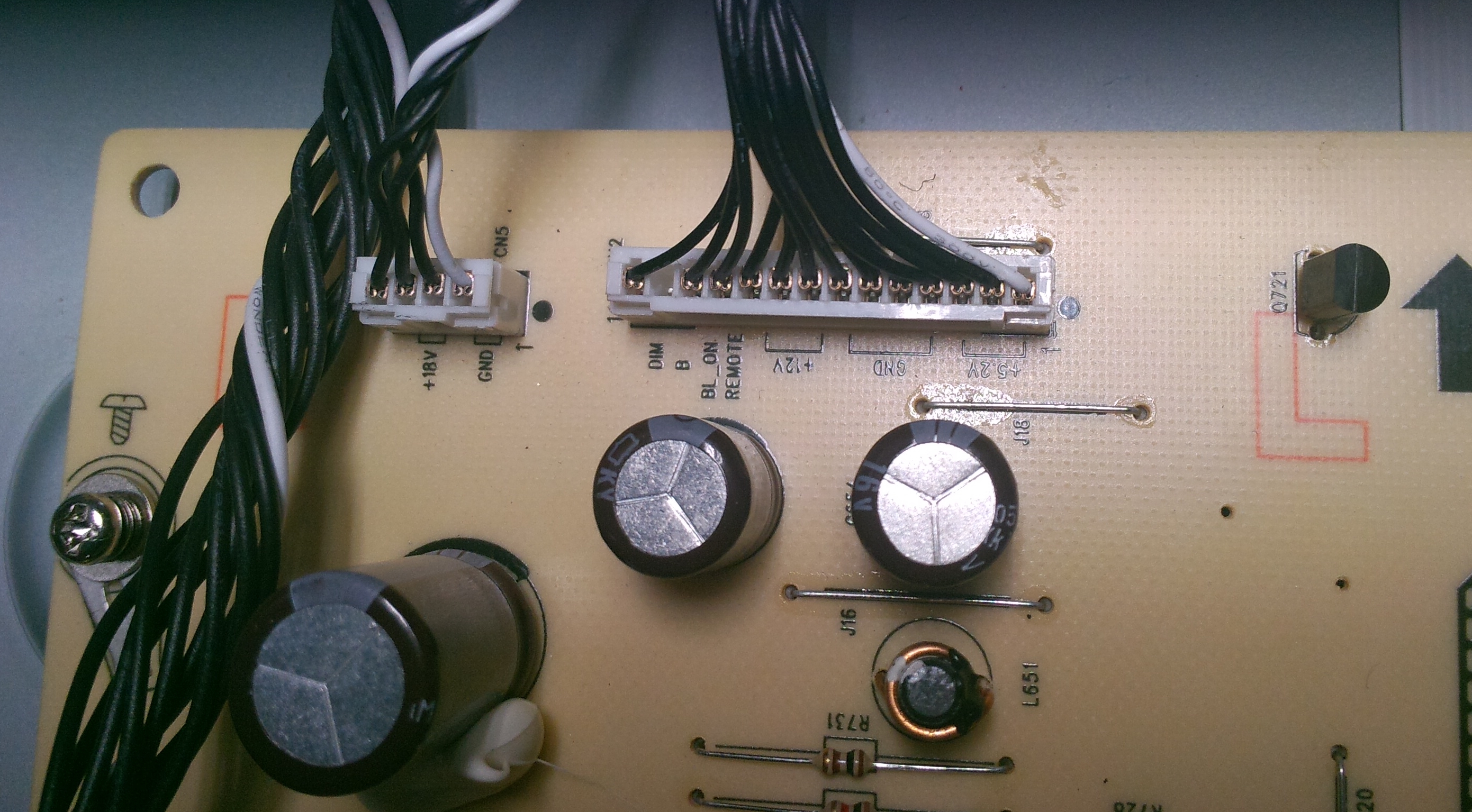

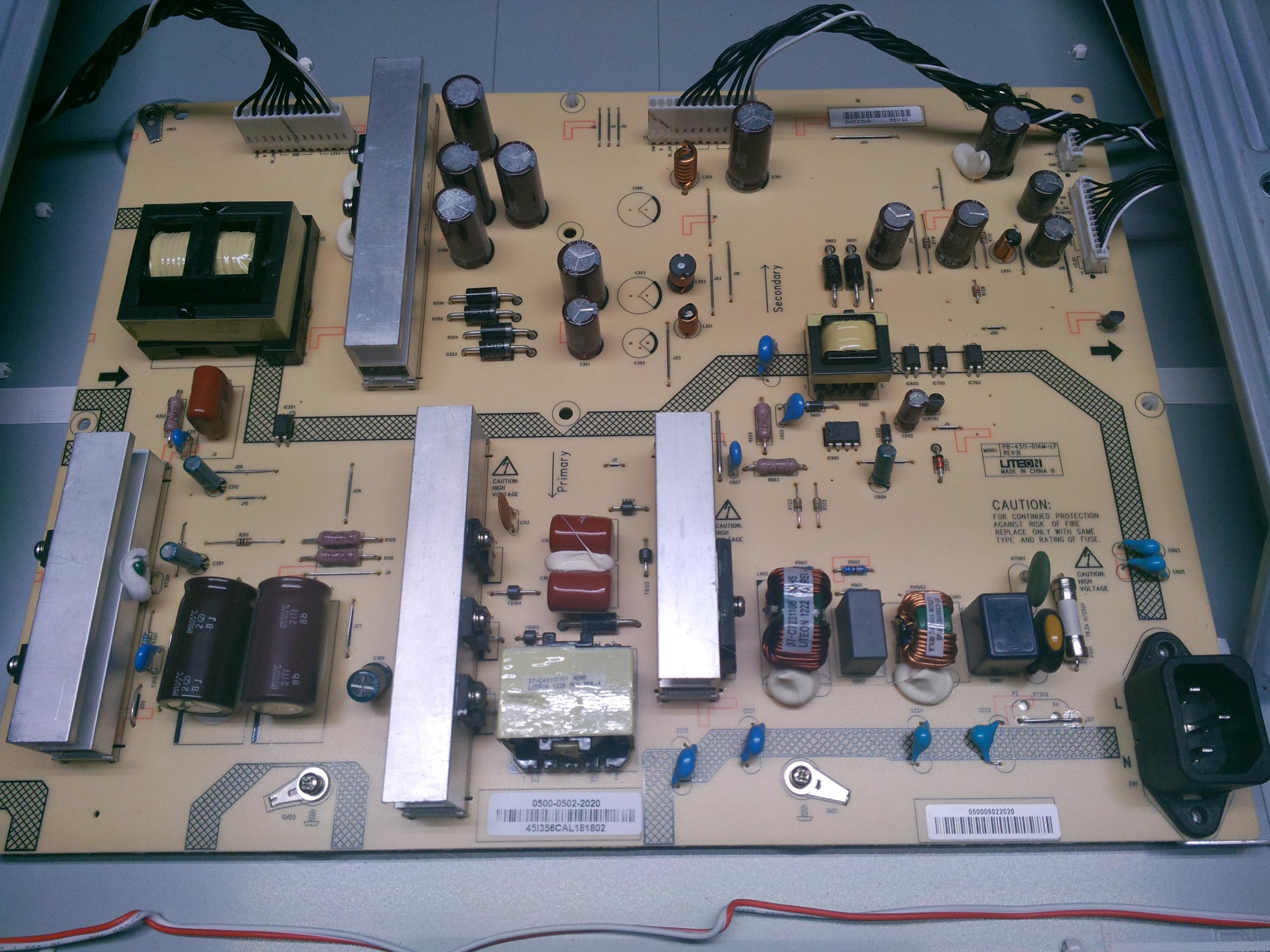

    Power Board 0500-0502-2020
    Main Board 3655-0552-0150

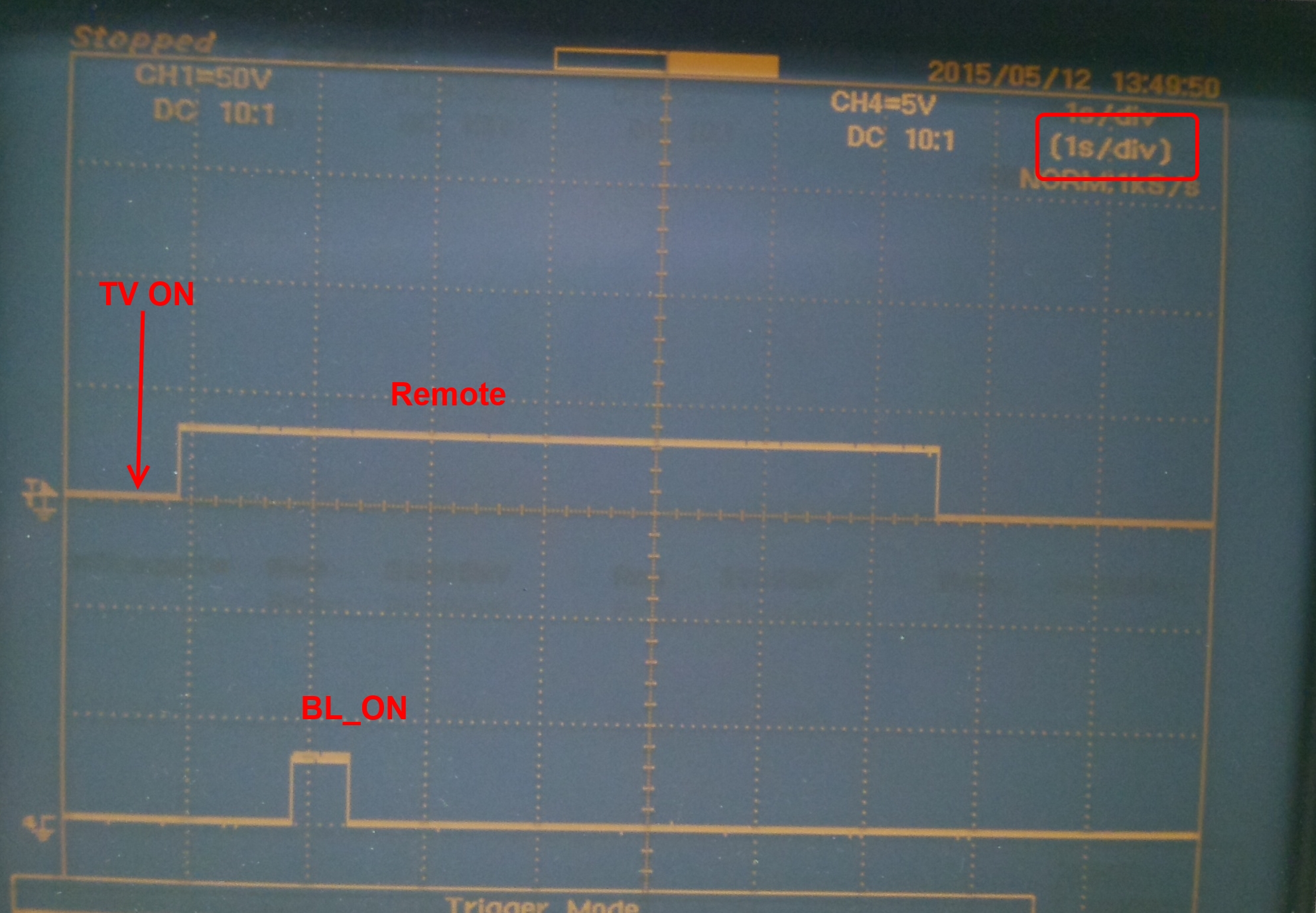

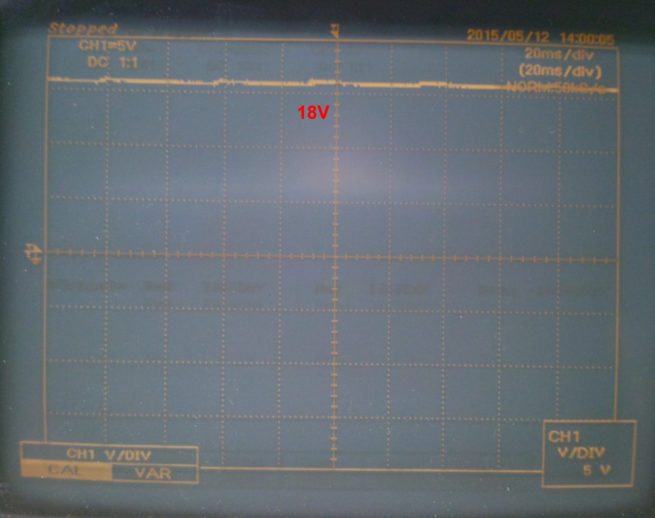

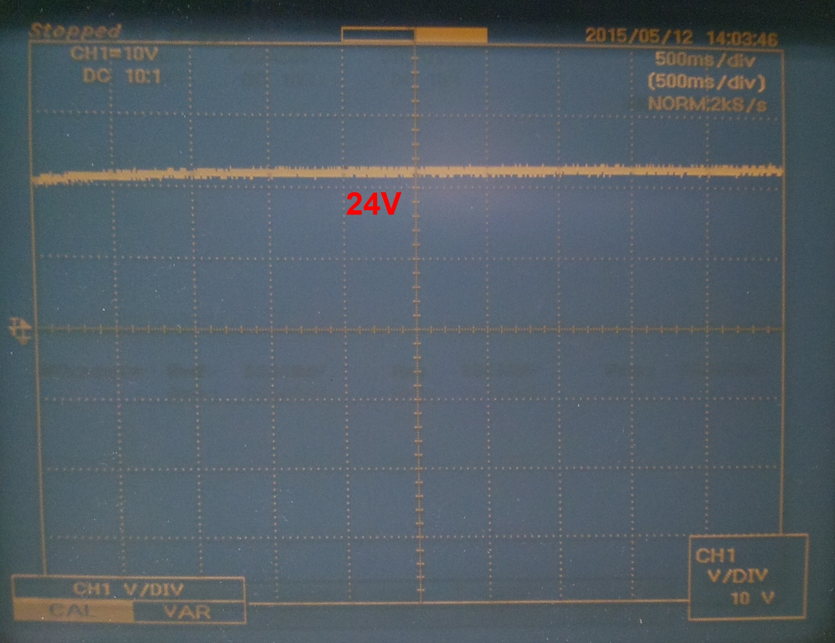

    Power Board Power-Up-Sequence (see attached scope screenshot)
    Power Button -> REMOTE pin goes high for 6secs,
    Power Button -> after 1 sec, BL_ON pin goes high for 1 sec

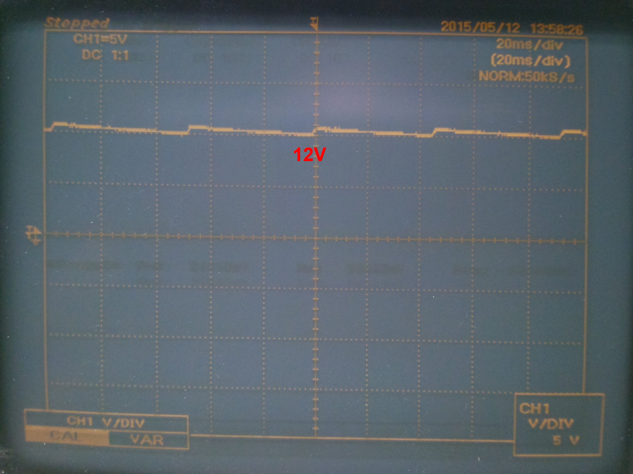

    Power Board Voltages (see attached scope screenshots )
    5v = 5.2v clean
    12v = 10.44v dirty
    18v = 15.90v dirty
    24v = 22.40v dirty

    1. Are the power board voltages supposed to be this dirty ? I know these are not the best of components nor circuits, but the sawtooth V riding on the voltage rails are of a concern
    2. What generates the BL_ON signal ? PSU or Main
    3. Same for the REMOTE signal ?

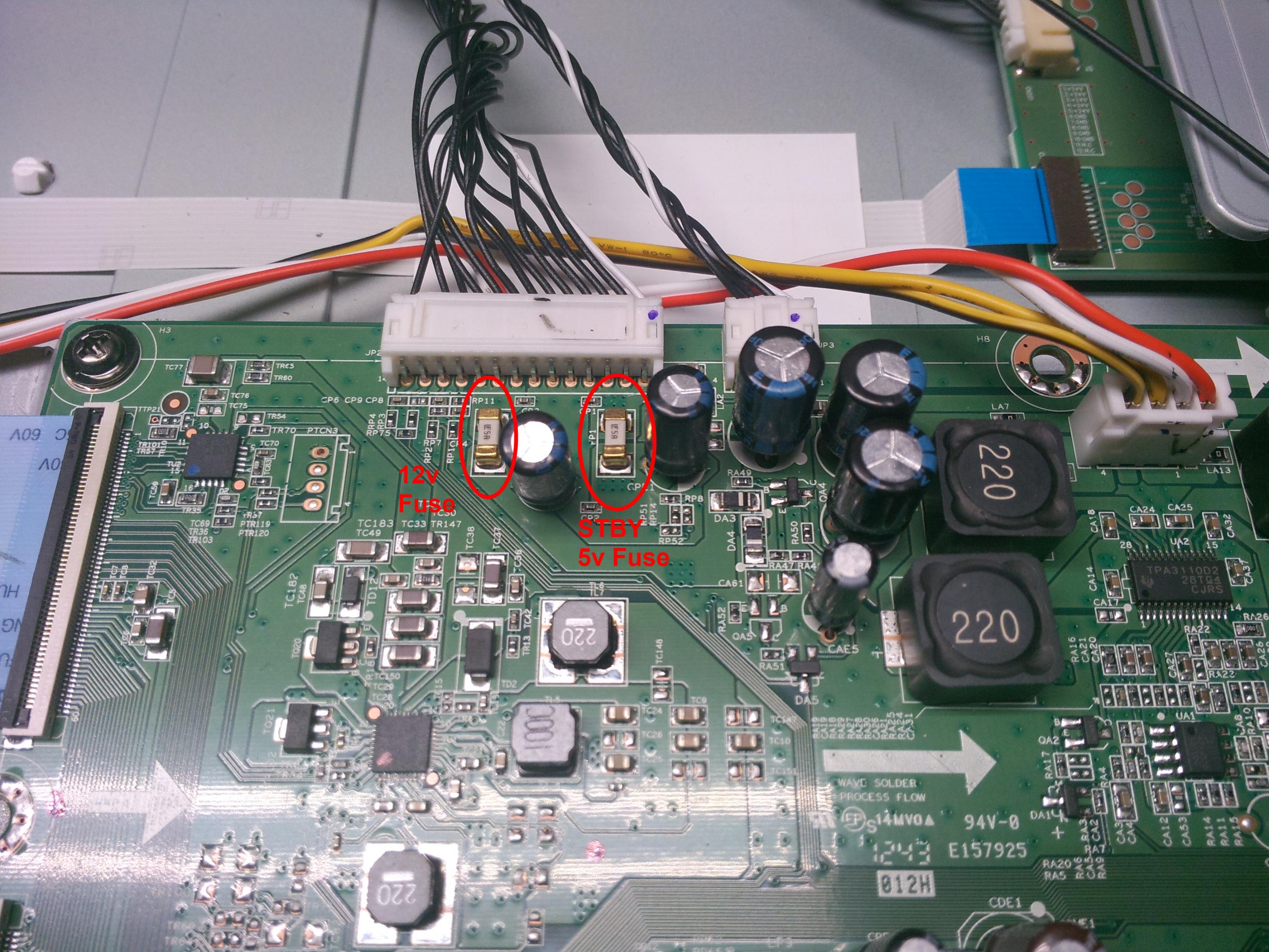

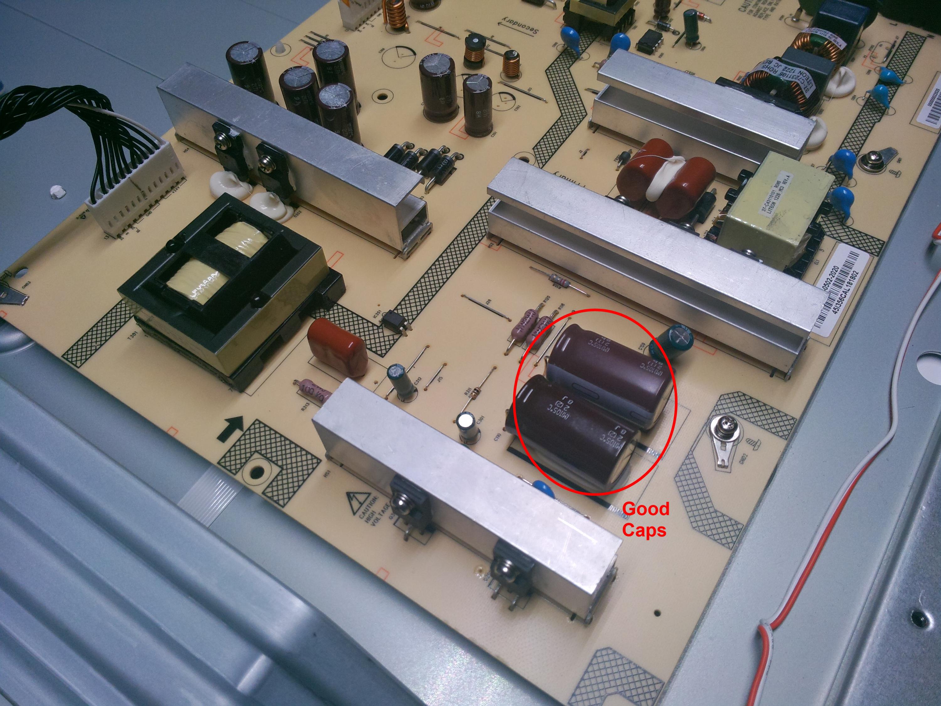

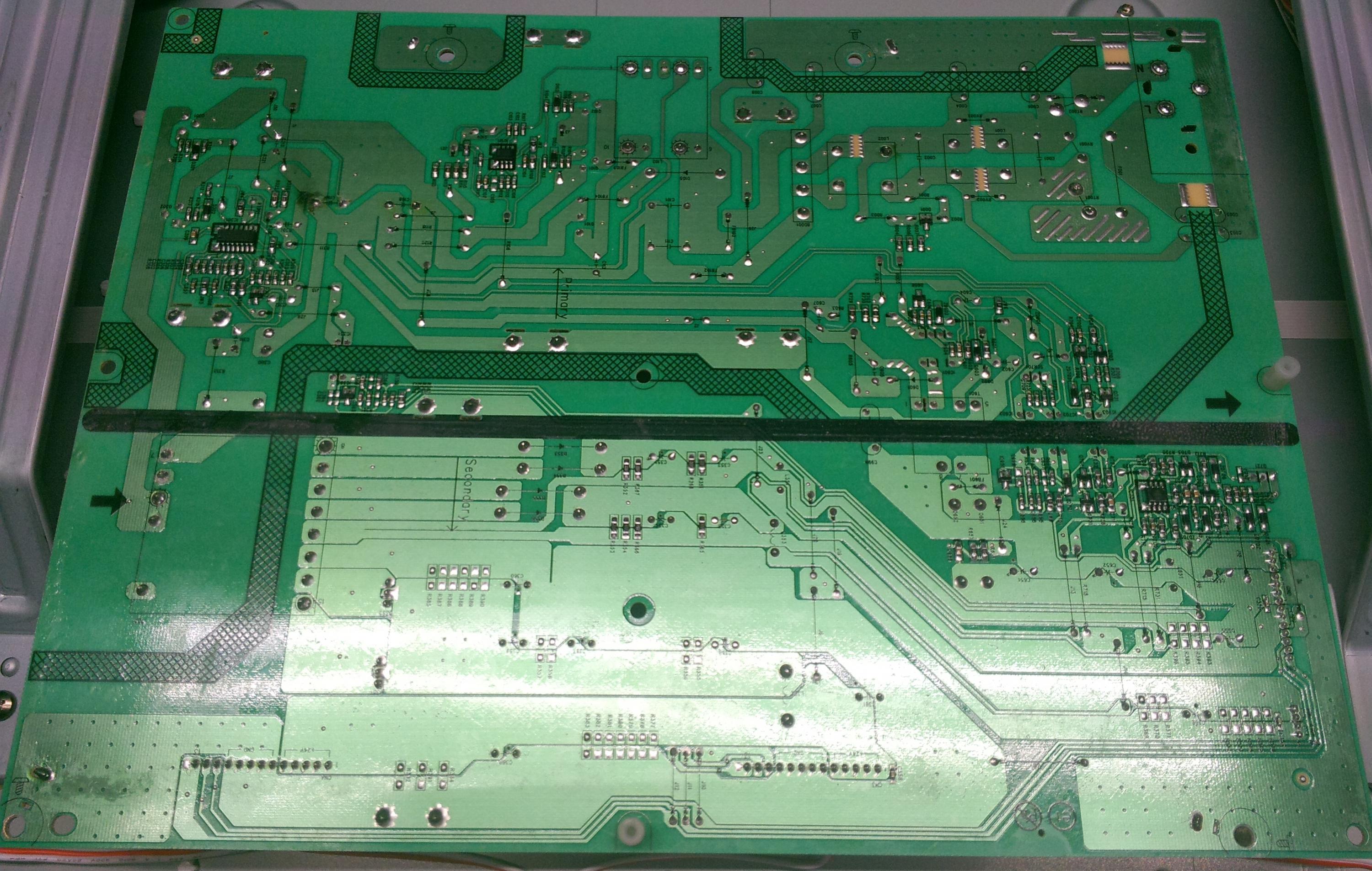

    Checked many of the Power board components, many I have pulled from the board to verify ( especially the large Vcaps ). I have yet to find any issue with any of the components.
    I have connected a 3.3v signal to the REMOTE pin to keep the Power Supply running so that I could check the Main board voltage regulators, so far no issues.
    I am still unsure as to which of the 2 boards is the issue.

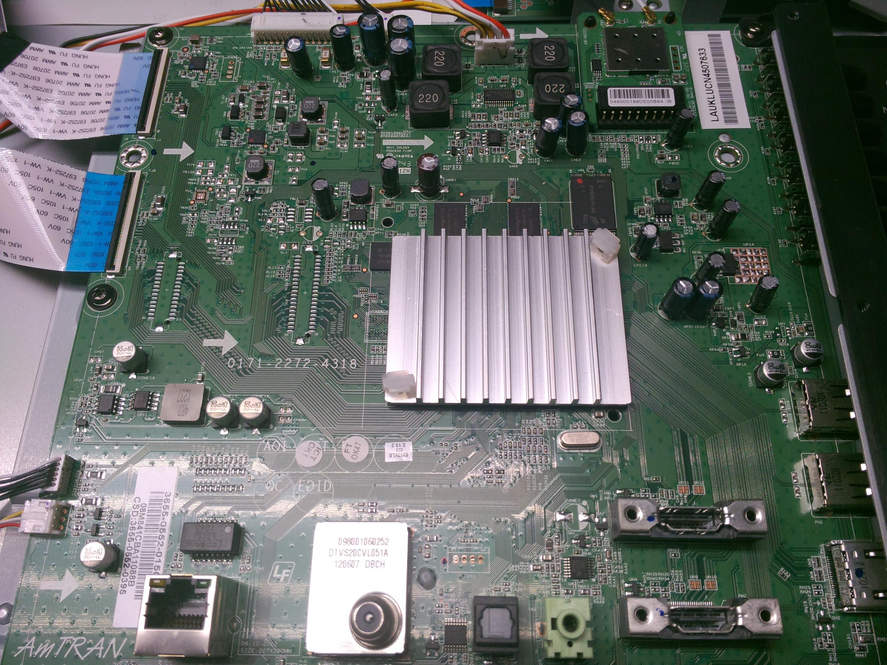

    Re: Vizio E552VLE / Does Not Power On
    PS-ON (REMOTE), BL-ON, and DIM are generated by the main board.

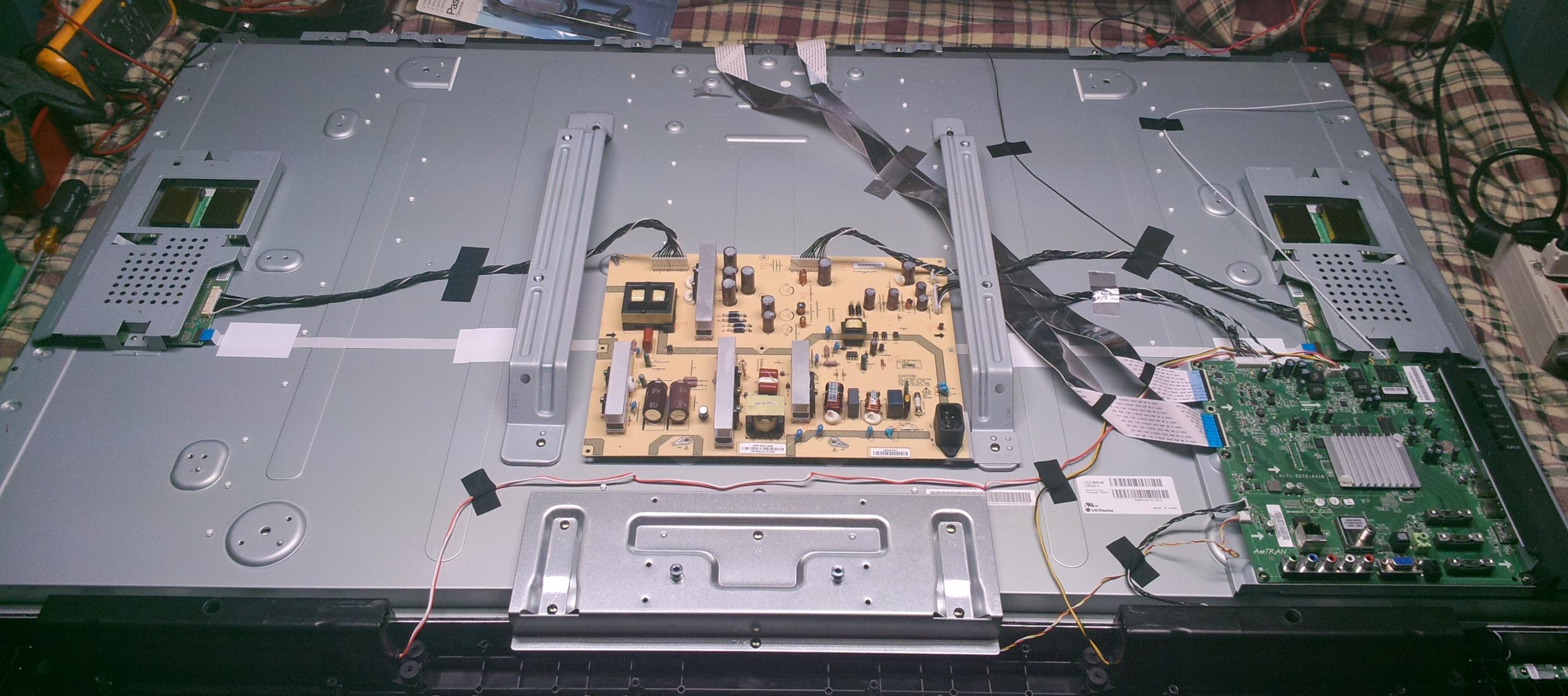

    Pictures of the whole backside of the TV so I can see all the board.
    So the PS-ON goes high for 6 seconds and then drops down to <1VDC? It should stay high until the TV is turned off.
    If that is the case, the 24VDC power supply should also drops out.
    Disconnect the power cable to the inverter and see what happen.
    Check the DCV between the two legs of the main filter caps, it should jump up from 160VDC to >360VDC when PS-ON is present.
      I was not aware that REMOTE is PS-ON, that explains quite a bit.
      Attached
      Correct, PS-ON stays high for 6secs until the TV turns off.
      Correct, the 12, 18 and 24 supplies drop out. Original post updated.
      Tried this, same sequence.
      Correct. Original post updated.
      I am still curious, are those dirty voltages acceptable for a TV power supply ?
        Ripples are not that bad for raw Voltage outputs for 12V for audio power amp and 24V for inverter circuits.
        To me you have main board problem because the PS-ON should not drop out.
        Try disconnecting the Cable the T-CON board next, then the cable to the IR sensing board for the remote.
          I tried both, same results.
          I will now concentrate on the Main board.
                  Yes they are expensive.. I would buy one, but not unless I knew it was %100 fix.
                  Since I have nothing to loose, I am going to try reflowing main board components. So far I cannot find the eerprom, it is not one of the 8pins, I looked all those up. So I am going to try to reflow the big FLash IC.
                      I have access to a reflow station, so I plan to reflow all the major main components.
                        Finally got back to this project.
                        Had board reflowed using a reflow station. Unfortunately, I believe that made it worse. Regardless, still not working.
