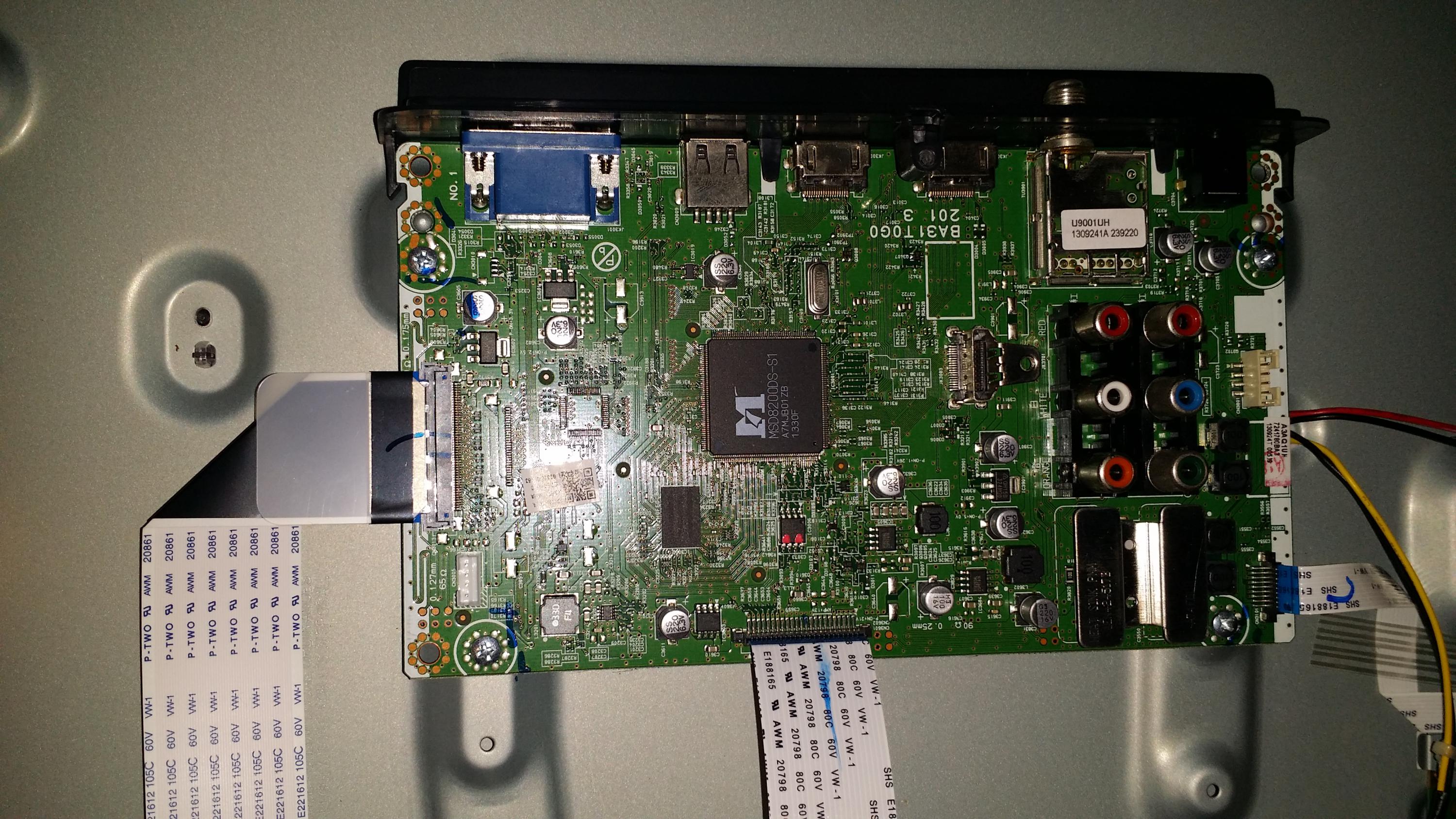

                  Re: Magnovox 46ME313V/F7 plug in turns on but will not turn on after you turn it off
                  [IMG]

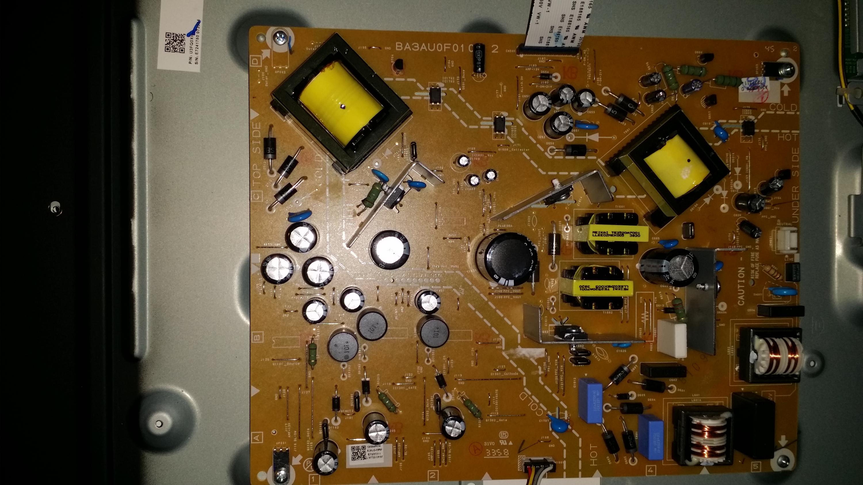

                    • bluedawg
                      Bluedawg
                      • Mar 2015
                      • 60
                      • united states
                      I have not repaired this one . I had replaced mother boards and power boards in about 25 tvs over the last year but was always able to test voltage at pins that where marked with voltage to first determine if I had the 5 volt stand by voltage but this tv does not have the pins with wires it has a ribbon from power board to mother board. I do know that if I unhook the ribbon from the power board to the motherboard and then reinsert it tv will turn on but as soon as you turn it off it will not turn back on unless you unhook the ribbon again or unplug tv for 30 mins.

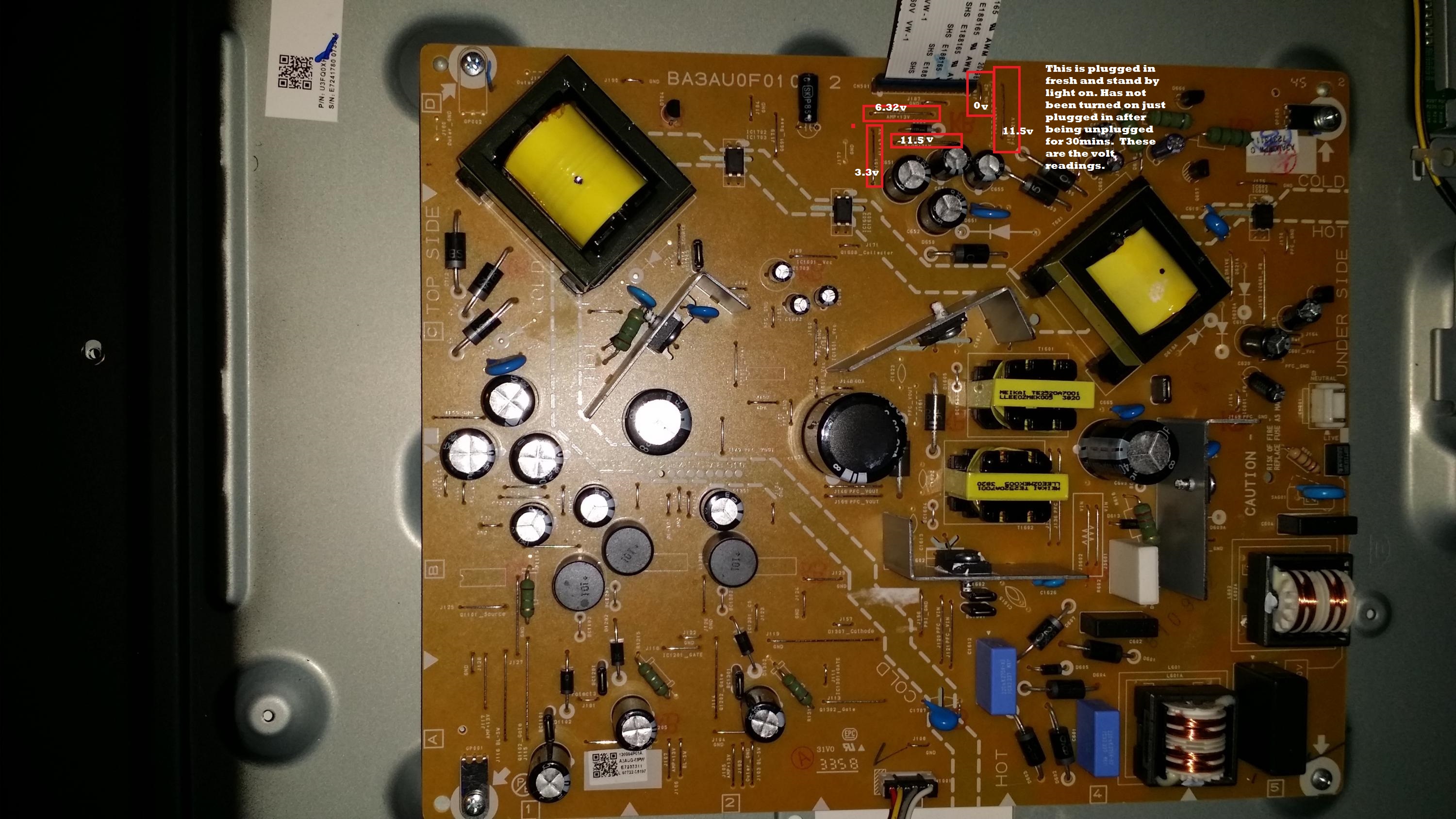

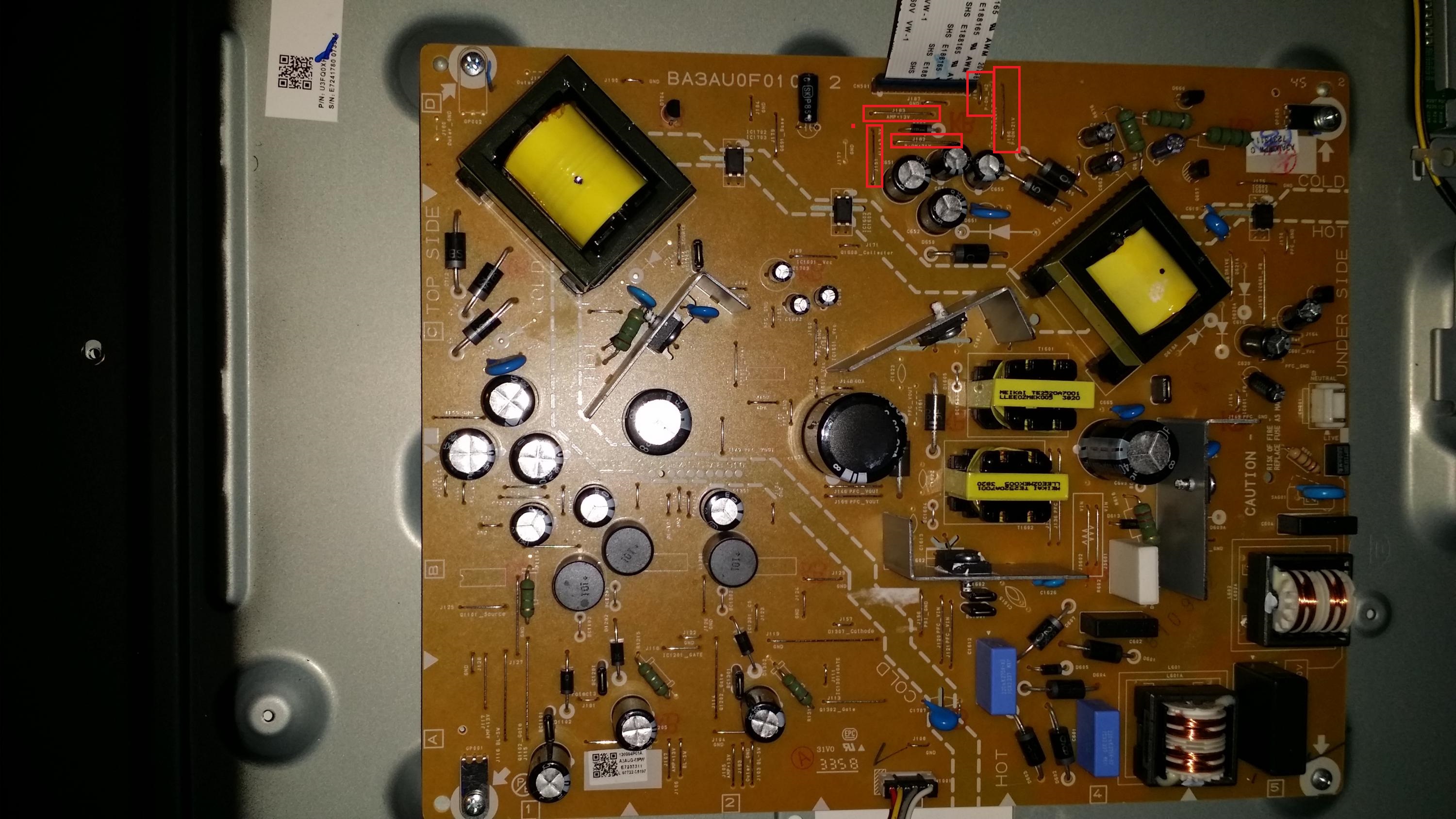

                        Black probe to chassis the red to each of the jumpers highlighted in the picture.
                        Type out the labels next to them and the reading when the set is on and off.

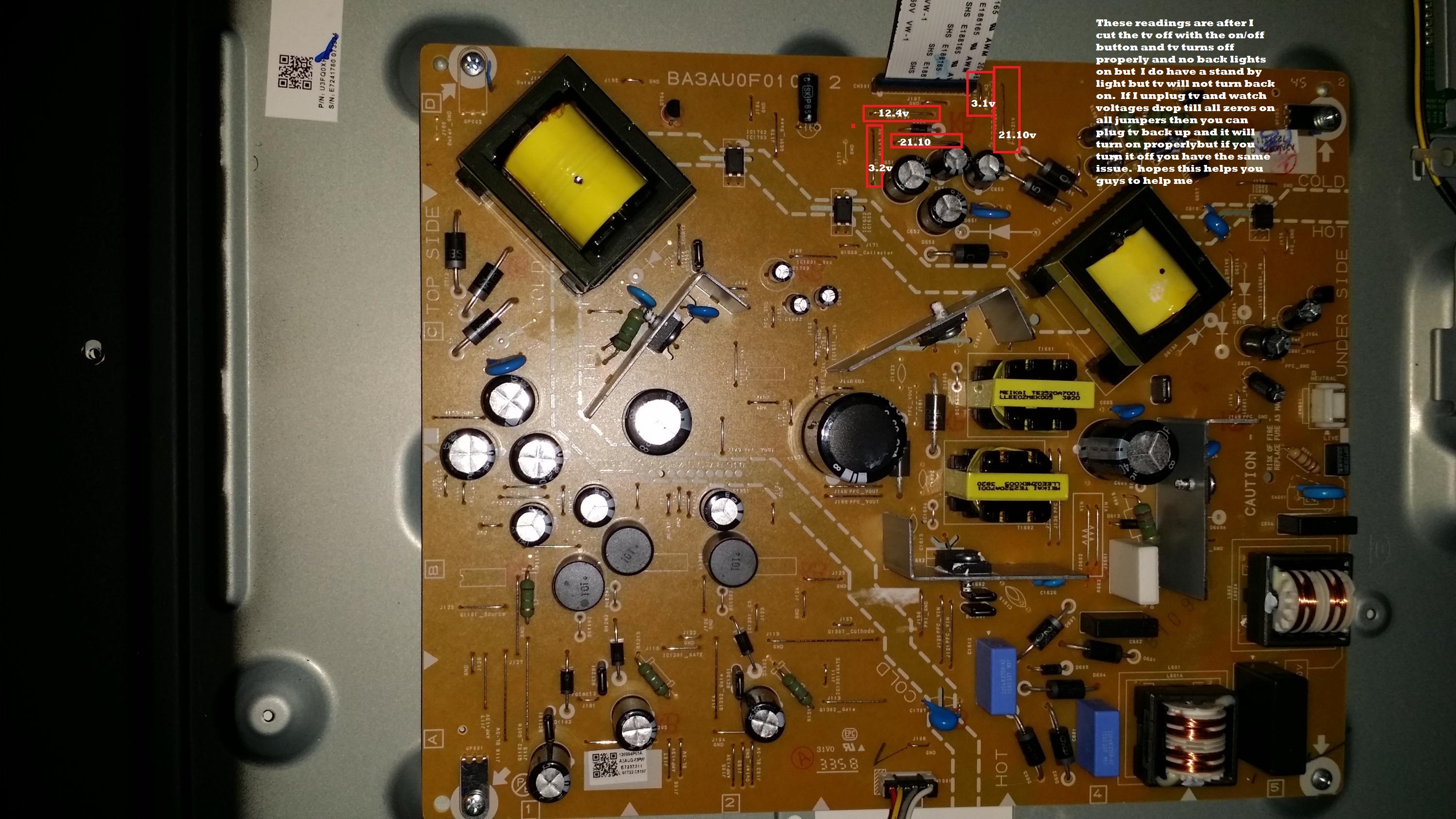

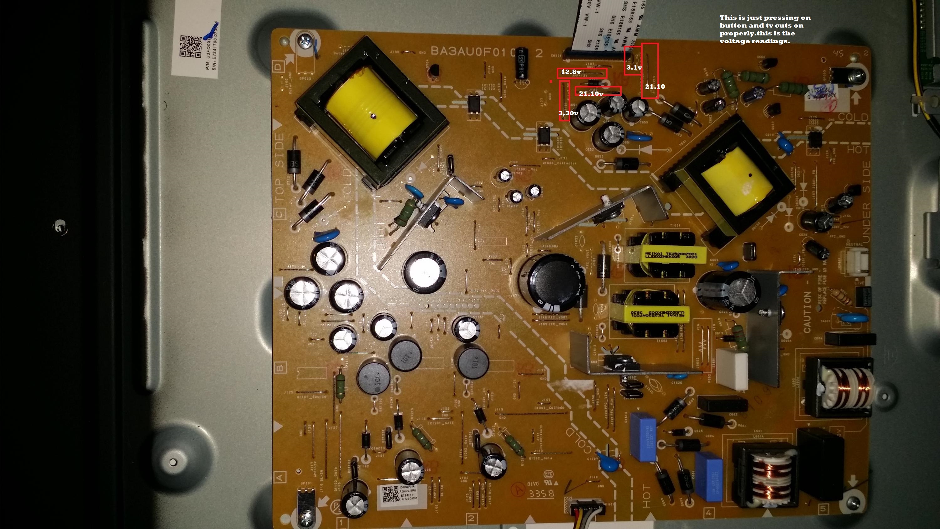

                            The next 3 pictures will hopefully help you guys help me figure out what is wrong with tv. thank you in advance
                            • bluedawg
                              Bluedawg
                              • Mar 2015
                              • 60
                              • united states
                              https://www.badcaps.net/forum/attach...1&d=1431561306 THIS SHUD HELP EXPLAIN THE POWER VOLTAGES AND WHATS GOING ON . THANK YOU FOR YOUR HELP
                                      Ok what I need you to do is disconnect the cable from PSU to Mainboard.
                                      You will need to use a ~500ohm resistor to jump the 3.3v jumper to the PSON jumper next to the ribbon. Retest voltages.... The PSU should now be on with all voltages as normal, Then remove the resistor and see if the PSU shuts back down and give me the voltages again.
                                      If the PSU shuts down your Mainboard is at fault, If it doesn't its the PSU at fault
