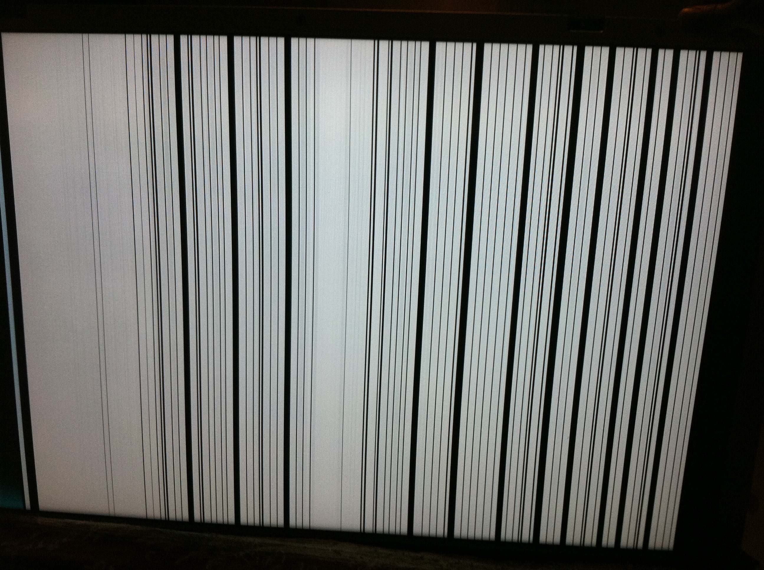

    Samsung LN40B500P3 White lines
    I have this TV which I picked up, shut off immediately. Found someone had got in there and broke a lamp, so replaced the lamp. Now the TV comes on and stays on, but the panel looks like it has white lines. The lines shift around as I press the menu/input buttons, but no visible intelligence on the screen. Is this a bad panel? The Tcon looks visibly in good condition and I measured the voltages as asymptotically rising /falling from Vgamma1->Vgamma18.

    Re: Samsung LN40B500P3 White lines
    If you unplug half the tcon do you get an image and vice versa.
    It's probably a bad panel, but you could check the AVDD, VONE, VGL, VOFFE voltages.
      I would agree, the panel is bad. Sorry.
      If they broke a lamp maybe they tore a tab bond or chipped the glass.
        I agree too Bad Panel

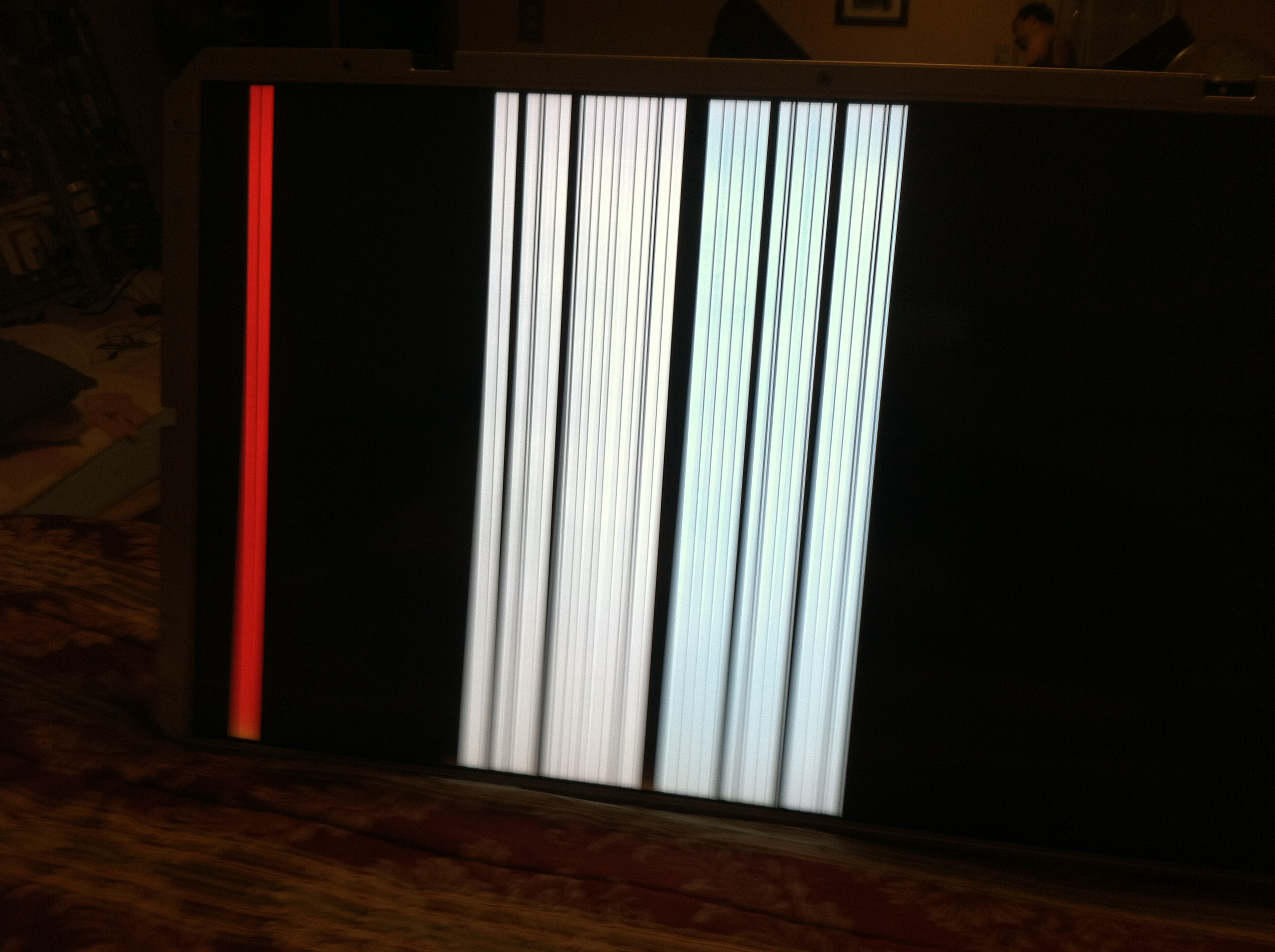

          I was ready to junk the tv, but noticed there was one red vertical line to the extreme right of the screen. Pressing the tab bond just at that location in a certain way caused the image to come on. I fixed it by seating a small piece of nylon pipe. It must have broken loose during the lamp change. Anyway mystery solved and tv saved.
