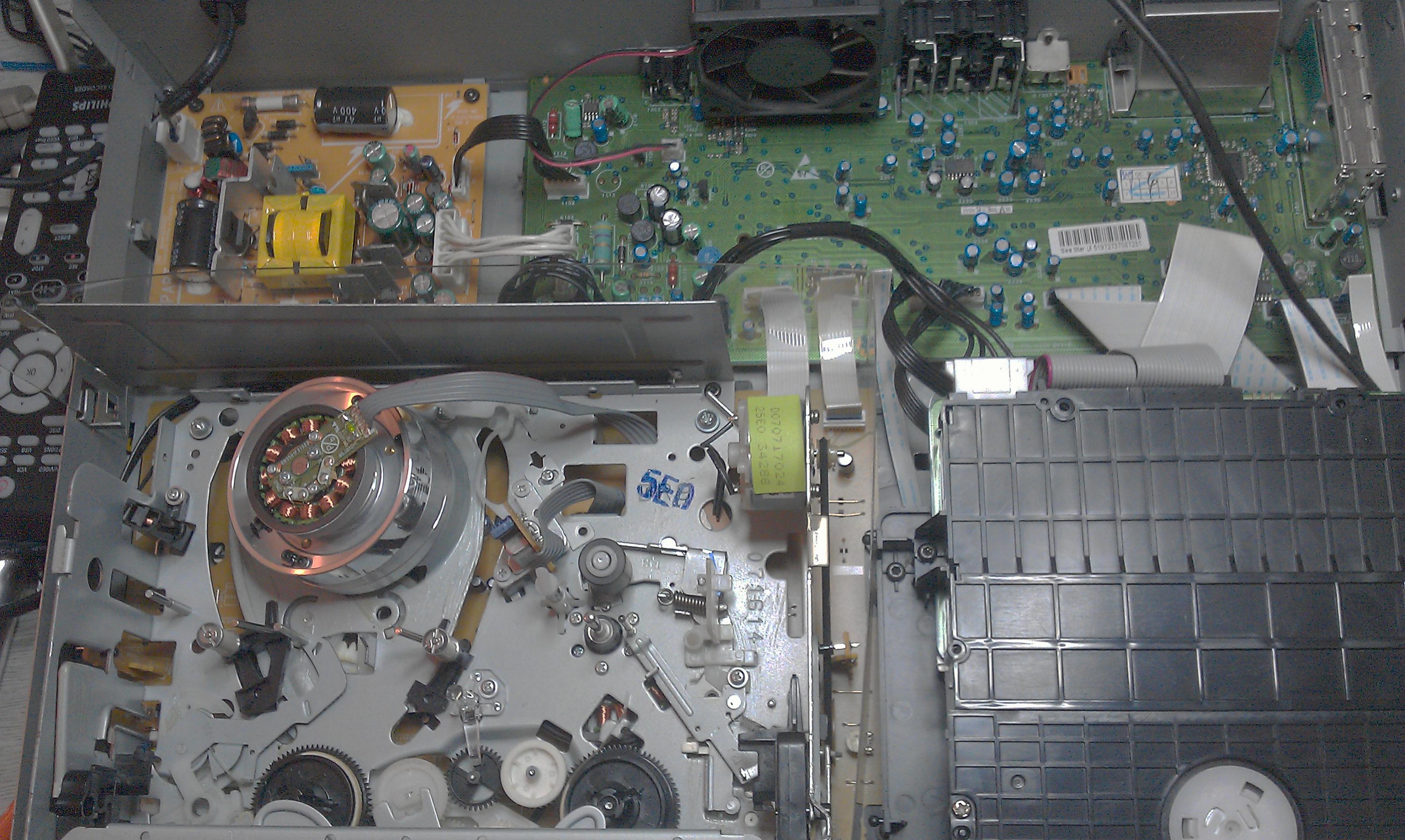

        Thanks guys I have got the service manual downloaded. I have no display lit on the VCR , also the standby LED on the on off button is not lit. All that is lit is 2 leds (vcr&dvd led) Power supply board seems to be kicking the correct voltages out. I noticed the 12 volt rail measured on the analogue board is showing 11.3 volts . I am guessing this may just be in tolerance but it seems a bit low. Could i ask any good electronics techs on here to help me work through this one. I suspect a fault on the digital board or maybe even the front panel display / button panel. I have not done vcr repair work in years but i would love to get this baby running even if it means buying a secondhand board off a scrapper from some where.

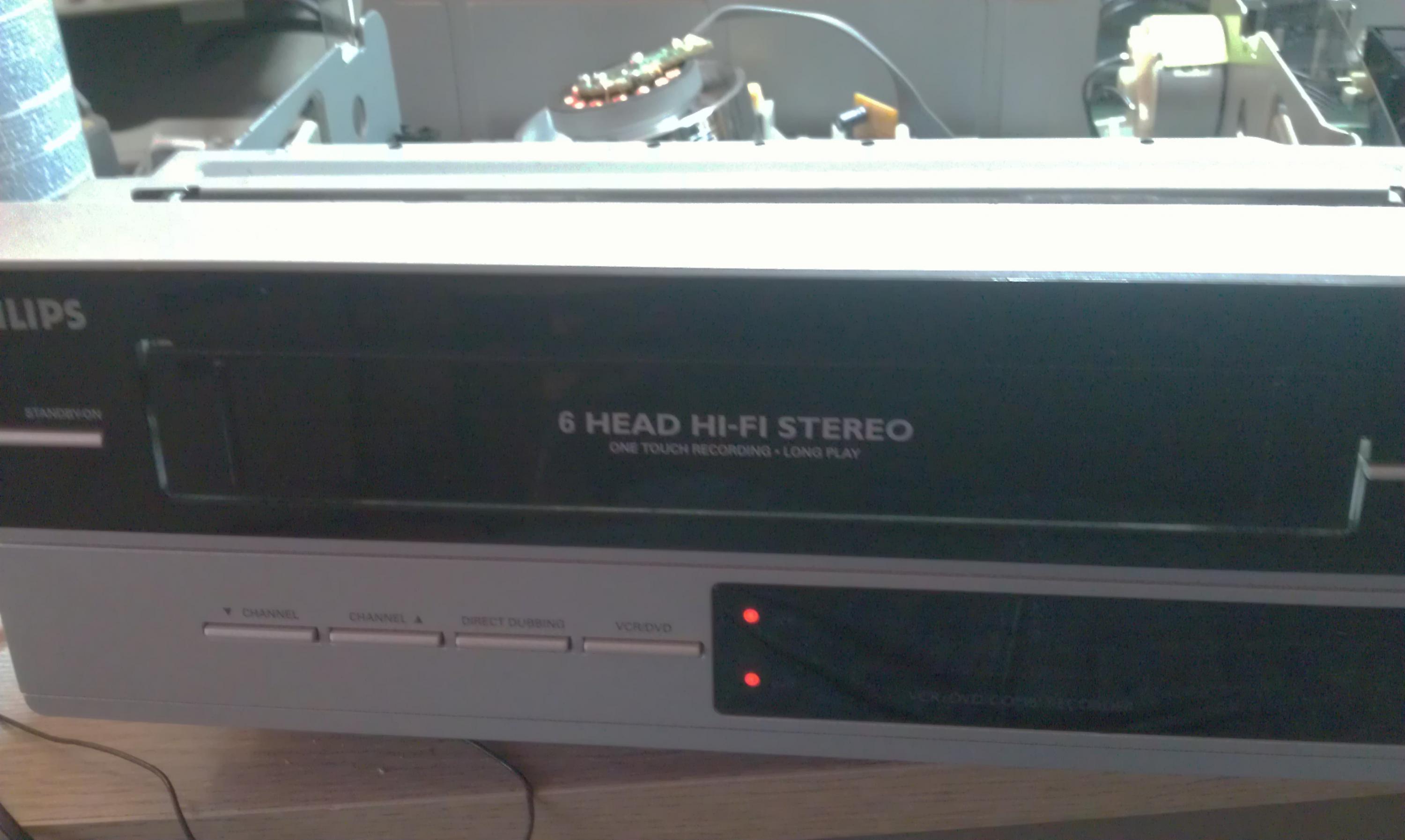

          This is a picture of the VCR , with just the 2 LEDS on.

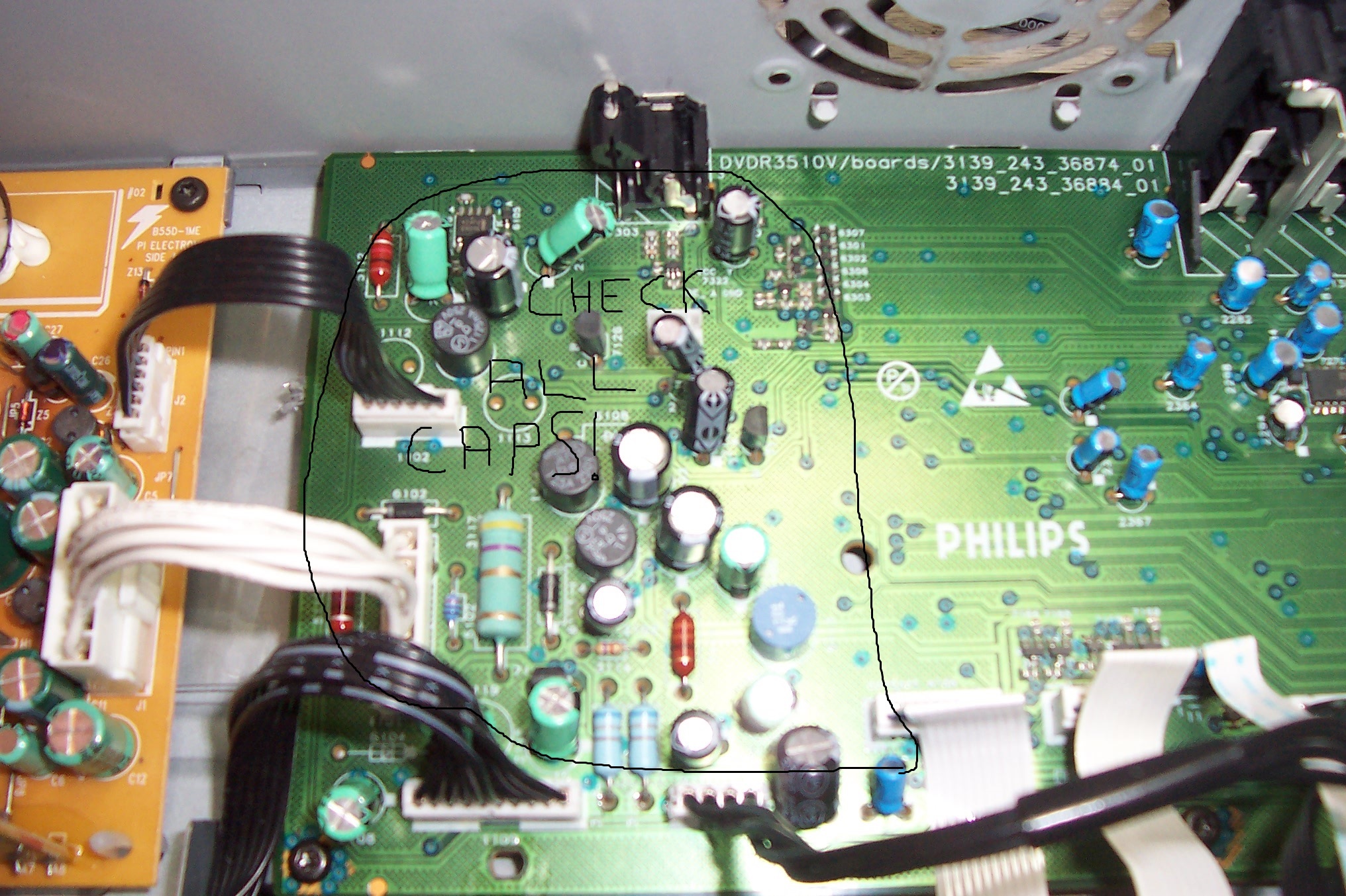

              Hi Techstar.
              Thanks for your answer. From my side, after some hours spent in vane in analyzing the boards, I decided to pass through the assistance. They give me back the combo repaired in 24 hours. You know the repairers: they just give me generic infos regarding some components replaced on the analog board. Damn ! Although I thought to make pics of boards inside, I forgot to do it and now I can just have the impression that they replaced a pair of caps on the analog board.
              Anyway, now it's OK.
              For your info, my wiring analysis made me determine that the problem is on the analog board that switches normally all the supplies to the rest of boards. Forget the power supply: also mine gives 11,3 V instead of 12, it's normal. The problem is related probably to the standby reset signal.
              Hope above will be of some help for you. Good luck!

                Re: Philips DVDR 3510V / 05
                The ringed area is where I found some bad caps , C2131 (22uf 16v)
                C2102 (22uf 25v)
                C2125 (10 uf 35v)
                C2104 (22uf 50 v)
                C2210 (22uf 16 v)
                2110 (100uf 6.3v)
                One of the caps (I forgot which one) had gone very low capacitance the others showed a higher ESR than they should have. I have managed to lift the print
                in places and to be honest I have made a pigs ear of this job! it lifts soo easy so you have to be very very careful. .. Good luck should you be doing this job.

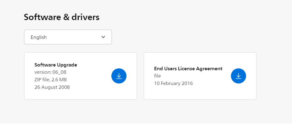

                  Hi, sorry to capture this thread, but I believe the people with knowledge of this recorder is very sparse.
                  I have this very same recorder (Philips DVR3510) and fail to finalize the recorded disks (DVD-R). Direct Dubbing or manual recording will start and stop at the end of the VCR, but then the disk is read as Blank (direct dubbing) or read blank after trying to finalize (which hangs at 99%). Manual recorded from the vcr can be played back as long as the disc is not ejected or the recorder is not turned of. After that the disc is blank again.
                  I previously repaired the tape deck and dvd drive and changed some defective caps on the power supply board.
                  Does anyone have a firmware update? Do you think this would be a caps problem - maybe a brown out of the microcontroller due to low voltage?
                      https://www.philips.co.uk/c-p/DVDR3510V_05/-/support
