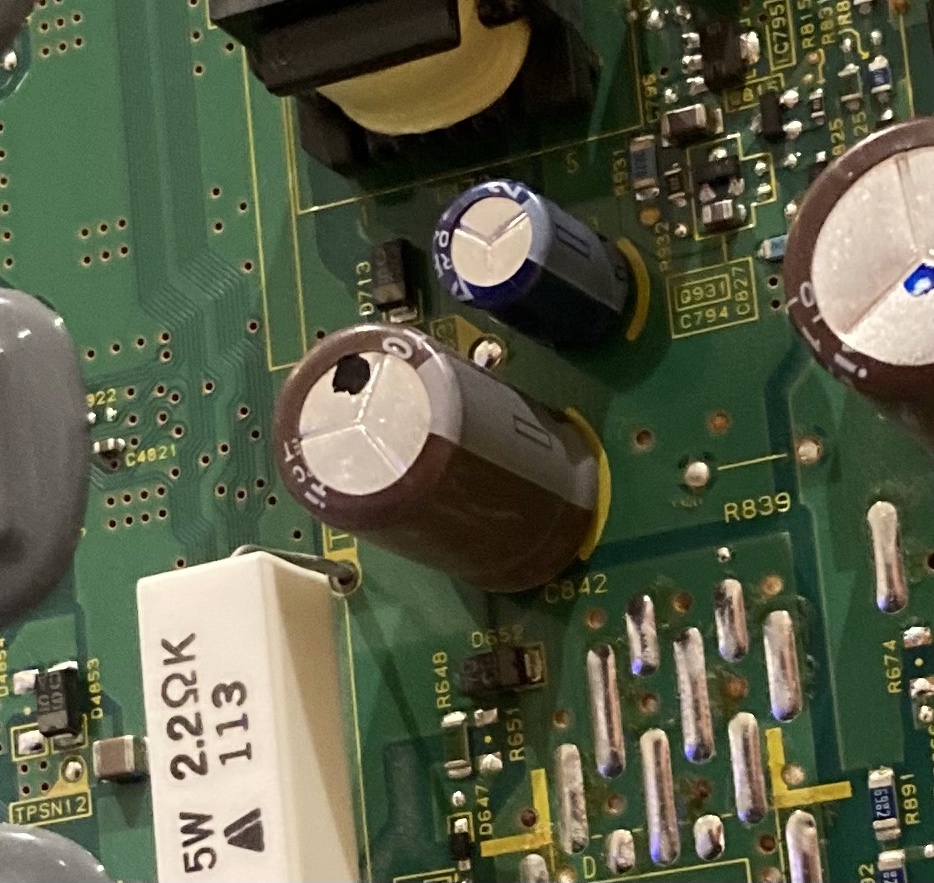

      Re: Panasonic TX-P42S30B - 6 blinks
      Good morning,
      Many thanks for replying and the useful links. The one is Caerphilly is not too far away however no distant cousin , theres a few of us here in Wales.
      I will give them a call later.
      As mentioned in my ealier post I dont think I have the dexterity to make the repair/replacement myself but probably OK to remove the board and send off.
        were you able to test C842 as indicated in the red warning print: QUOTE "Please do check resistance across C842 (it's visible on second picture), if resistance is zero or close to zero your board have got faulty at least one buffer chip and then I will not issue full refund" It is not clear what the repair is he's talking about, if its just 8 washers you can get those for a buck or so at the hardware, He might be saying if you have a bad buffer chip then it's no deal, may want to contact them and see exactly what the repair consists of.

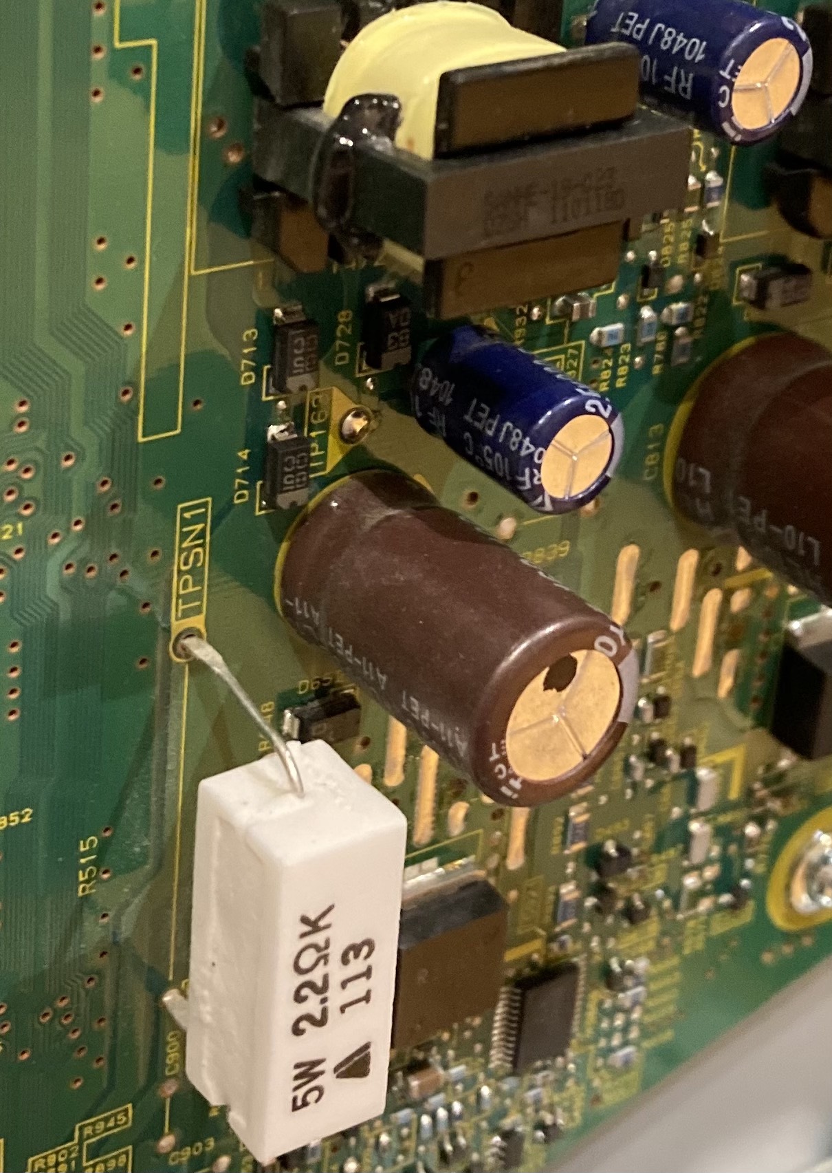

                            Good evening again,
                            Found C842 after 1/2 hour of searching.
                            How do I test this?
                            The most obvious place (to me) is the contact at about 3 oclock on the 'C842 bottom' image as attached. I get about 145K ohms between that and ground/chasis.
                            I did have a look at the Shop Jimmy video but this exact model is not listed.....
                            On going help appreciated.
                            NeilW
                              the only way I know is to remove the board and check across the 2 legs of the capacitor from the soldered side, if you do, ALWAYS put ALL the screws back in securely before turning tv on, they are important to grounding and NONE should be left loose or out, it can short out the board.
                                good policy to leave the tv unplugged for a few hours before removing boards and be careful what you touch, it can hold a charge for quite a while.
