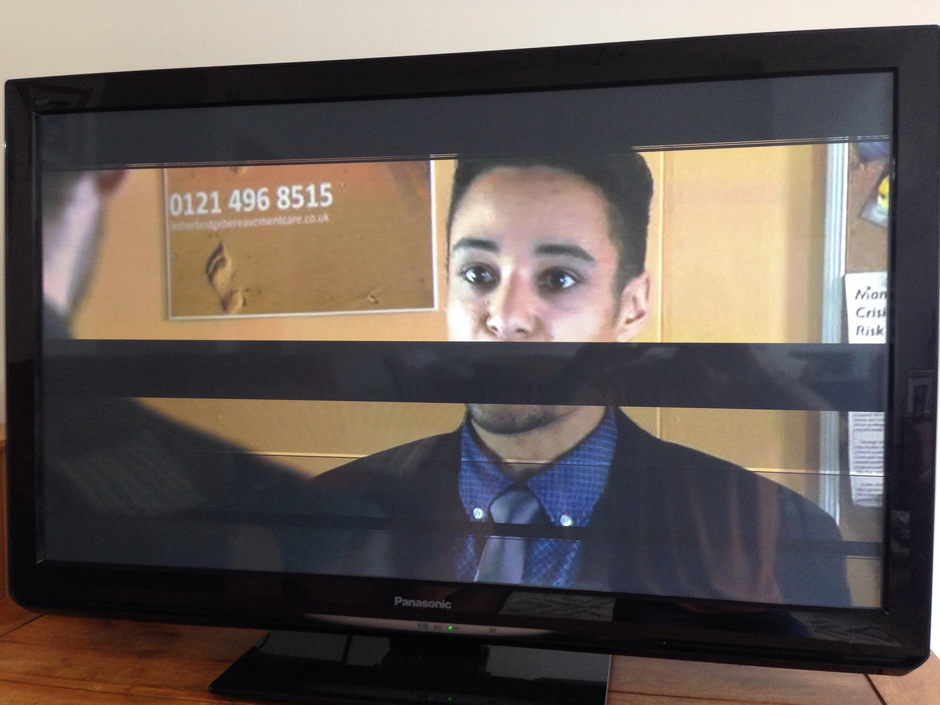

      Ok I've now installed the new SN board.
      I've powered up and get 23 green blinks (with a slight pause on the 20th)
      The power does remain on however and the picture comes on which is great re the SN board.
      Two issues though:
      1. Getting some horizontal lines on the screen - presumably I just need to re-seat the appropriate SN RIBBON connector.
      2. I get a message saying that no signal is detected. I expected this at first but having plugged in my RF, HDMI & SCART I was surprised that it's still not detecting a signal.
      Any ideas?

        turn off and reseat the connectors that line up with the lines.
        Any chance this has been reset back to factory default? either way try a re-tune but it has nothing to do with the SN board fault

          Ok here's a pic when viewing the input from my DVD tuner.

            That a bad connection onto the SN, Make sure they are seated correctly and no kinks are showing. They can be a pain to get in

              Thanks TW, looks like all my channels were erased, I rescanned an now have tv pictures.
              When I re-seat each SN ribbon cable, do I need to allow time after switch off +/or disconnect power to SN board between tries?

                                  Ok, I'm about to reseat the SN ribbon cables to try to get rid of the various horizontal blanks in the display.
                                  However, looking at them, they all seem properly inserted; ie no gold bits showing, no kinks.
                                  Are there any other tips? Should I be cleaning the connector or cable contacts in some way?
                                    #77
                                    Re: Panasonic TX-P42S30B - 6 blinks
                                    They can look perfectly seated and still be off. I guarantee anyone who installs an SN board from a Panasonic set will see these lines. It is difficult to get them right, just remove them and reinsert until it looks good. (Turn power off while reseating. For the SN board outputs you should not need to wait for it to discharge.)

                                        Ok, going fairly well.
                                        I've got rid of all three instances of entire missing horizontal blocks.
                                        What I'm having trouble with is collections of alternating missing lines, ie I get a single row of pixels followed by a single blank row. This continues, row on, row off, row on etc for most of a block or else just for 12 or so rows.
                                        Are the contacts staggered alternately? Maybe I'm just not reaching the deeper 50%?
                                          #80
                                          That's common. The connections are staggered somewhat.
                                          The trick is to remove the dodgy connection completely then line up the connector so both ends are in the same amount. Insert it in gently, until you get a click, then close the connector.
