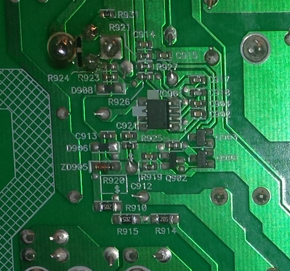

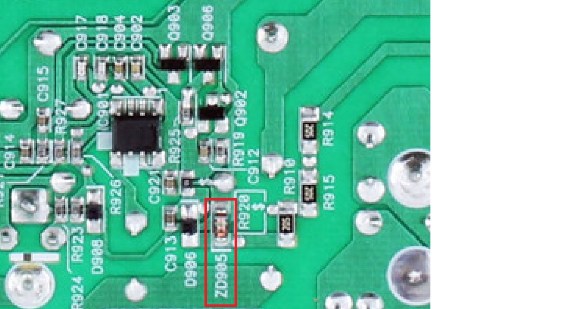

          Ok.. The zener Diode is of smd type and its super miniature. I know its zener, cause its sitting in position referred to as ZD905 (ZD=Zener Diode).
          I took it to a friends microscope (cause I don't currently have one after your suggestion) and there are no tiny letters on it, except from two Grey stripes,
          The Diode either in reverse polarity or FWD biased polarity it reads short-circuit and DMM beeps while testing it in Diode mode. By that I assume its short circuited.
          The FET Q905 (P3NK90ZFP) does not seem to be short circuited although it was mentioned in this thread to give it a measurement test. So by that and the writings in this thread, the IC should be fine.
          All of my component measurements for Zener and FET were carried with components out of PCB.
          My question is whether someone who messed with such a board, actually measured voltages around / across this zener. So from that I will be able to purchase one and solder it back.

            so no identifiers and no schematic, yeah guess you need to trace the zener to the other components, I think alldatasheet usually gives an example circuit like for the IC's and such.

                What is the reading across ZD905 IN DIODE TEST?
                The information I have suggests ZD905 is a 7.5v zener diode, so just check the voltage across it to see if it is zenering at the correct voltage

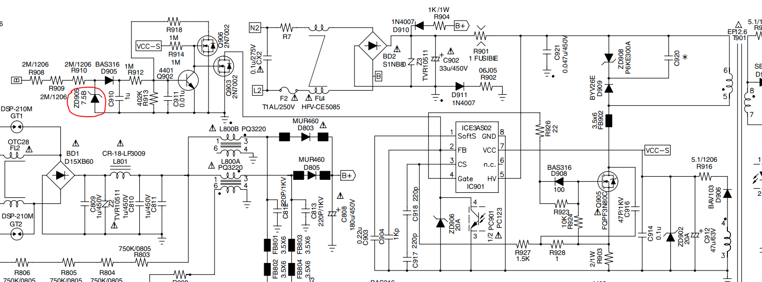

                  Approximate circuit from Philips
                  • lotas

                    Re: Phillips 520FL3603D/F7 Power Supply Dead
                    Here's another

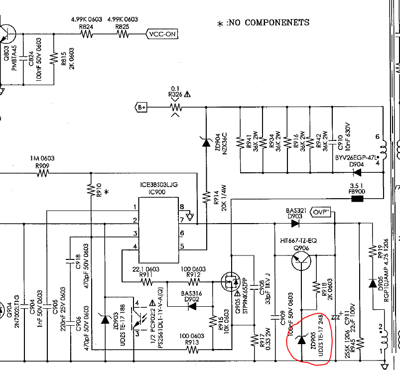

                      Those are both the wrong circuit, on the DPS-411AP-1, ZD905 is located off R910 which is in series with R915,R914 which connect to the neutral of the ac line input

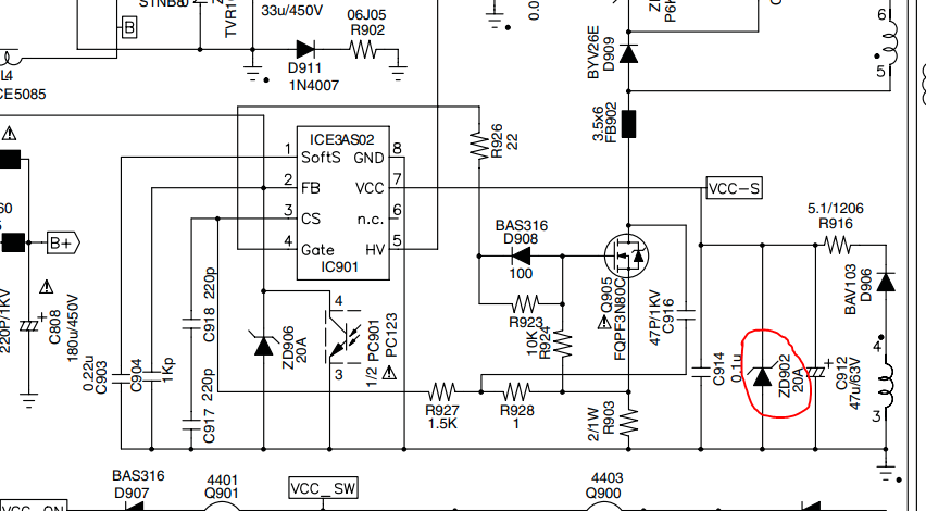

                        Here they write that he (ZD) is in the VCC circuit of this IC.

                          The Zener diode on the VCC line of IC901 is ZD902, across C911. ZD902=20v
                              Correct RJ. However it seems that the 1Ω Resistor in place R929 is a bit deformed and it reads 2.1 Ohms. Brown black Gold Gold ! Surely that will need to be replaced and try a zener 7.5v from info that was given in this thread.

                                  In most cases it is a 15v zenner. It is placed for the protection of the integrated controller. Most of the time, however, when the diode is shorted, the integrated circuit is also compromised.
                                    makes sense to me, think I would replace the integrated circuit too.

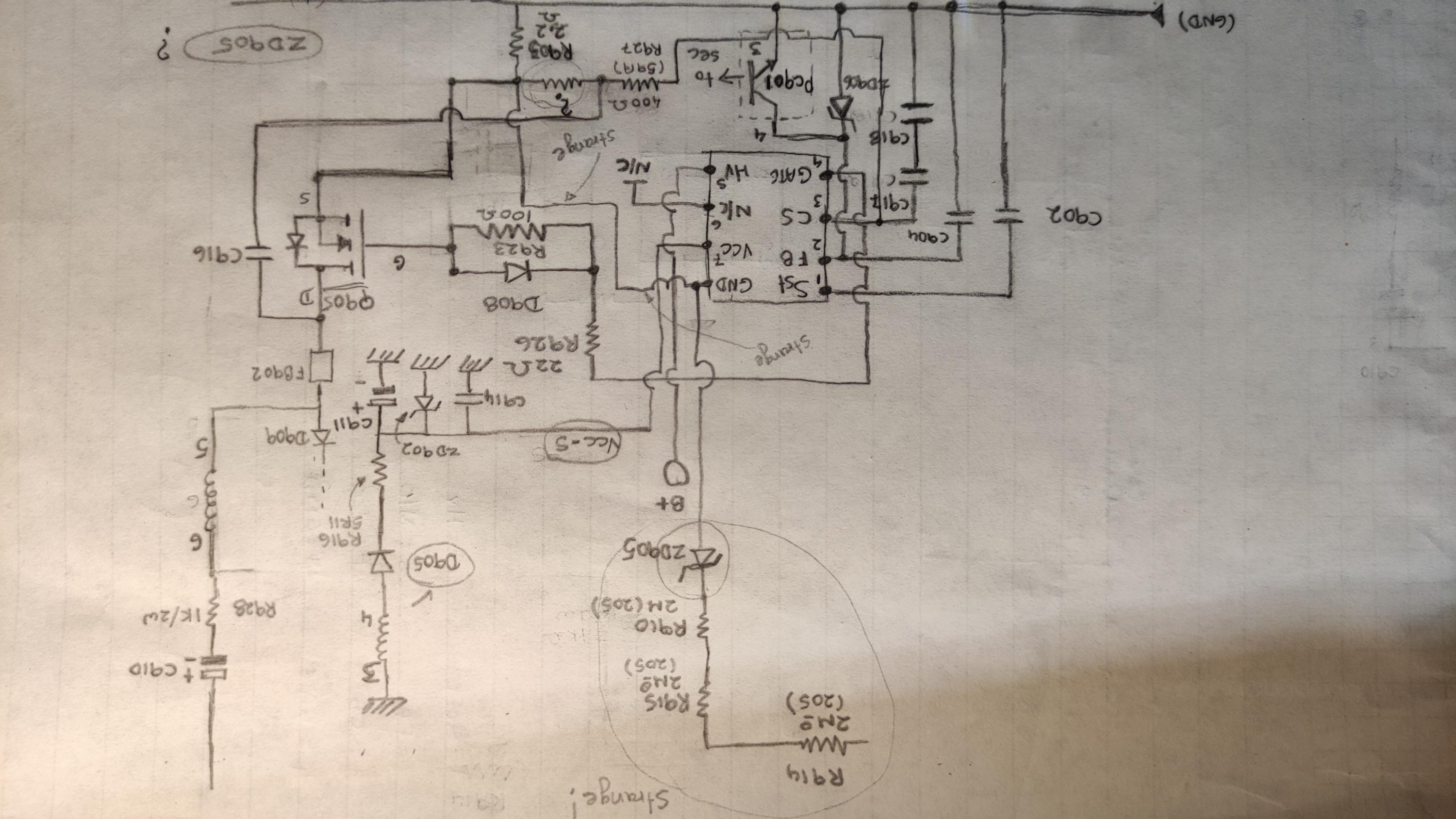

                                      As promised I reversed engineer a bit the circuit around IC901 so as to eliminate the relation of ZD905 to the IC.
                                      The help of the users Iotas and RJ were great. Basically the circuit is the same with a few differences which I post in my own drawing. Look closely so you can see the differences noted with either a (?) or any other notes I left on the paper. Last 2 posts from Yokoono and nomoresonys stated that ZD is usually 15v and is there to protect the IC901. However if the ZD went bad, then the IC is compromised. So I guess I need to wait until 5/23 when Mouser will be stocking this Chip. For those interested I am located in EU, Cyprus. Sorry you will ned to rotate the attachment
                                      Heres my diagram..
                                      Any feedback let me have it

                                        Now it is clear that the positional numbers of the components do not match.
