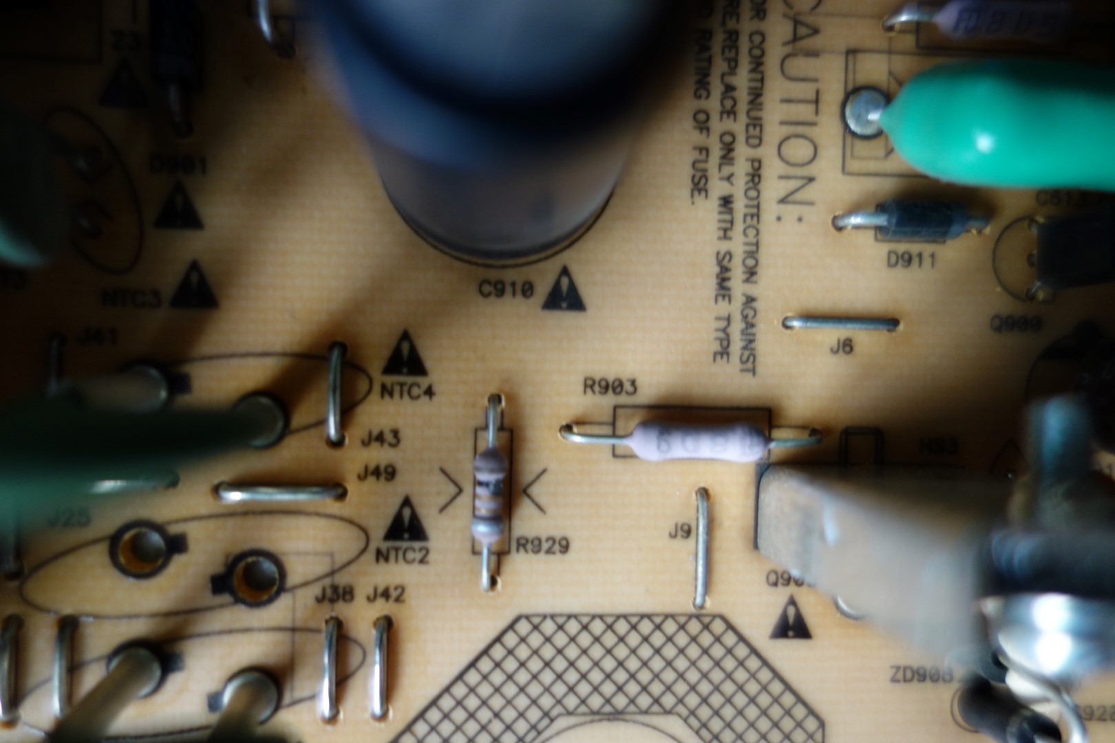

                Voltage across C910 measures 92 VDC (measured at D901 and D902 traced back and climbs slowly). F2 is not blown. R929 read open (in-circuit) and R903 measures 2.4 ohm (in-circuit). Should I check R929 and R903 out of circuit?
                • R_J
                  • Jun 2012
                  • 9553
                  Re: Phillips 520FL3603D/F7 Power Supply Dead
                  It looks like R929 is open, It should read 1Ω if I am correct, one end connects to C910 (+) and the other feeds ic901 and connects to stby transformer T901 pin6, which connects to Q905 fet (D)
                  so check the fet for shorts, you could also check the resistance between C910 (-) and the fet drain (center pin)

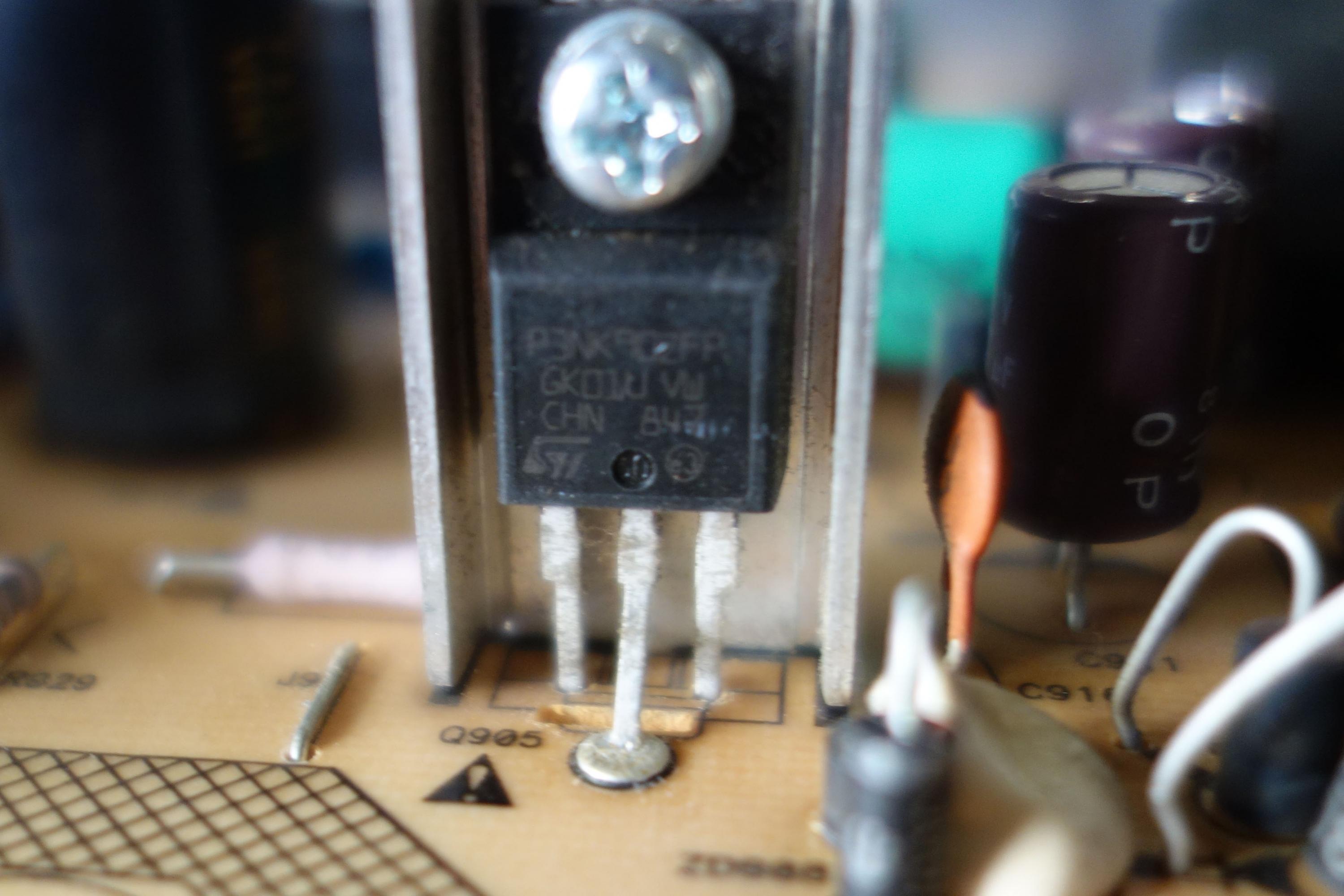

                    Q905 reads 254 ohms gate to drain so not shorted. C910(-) to drain is 136 ohms.
                    Q905 is ST P3NK90ZFP?
                    IC901 is 3BS02G?

                        Pulled up 1 leg of R929 and it is open. Brown Black Gold Gold Silver - The fourth gold band doesn't make sense. 1 ohm??
                        • R_J
                          • Jun 2012
                          • 9553
                          1Ω 5% tolerance, the last silver band could be temperature coefficient (ppm/K) (not important here)

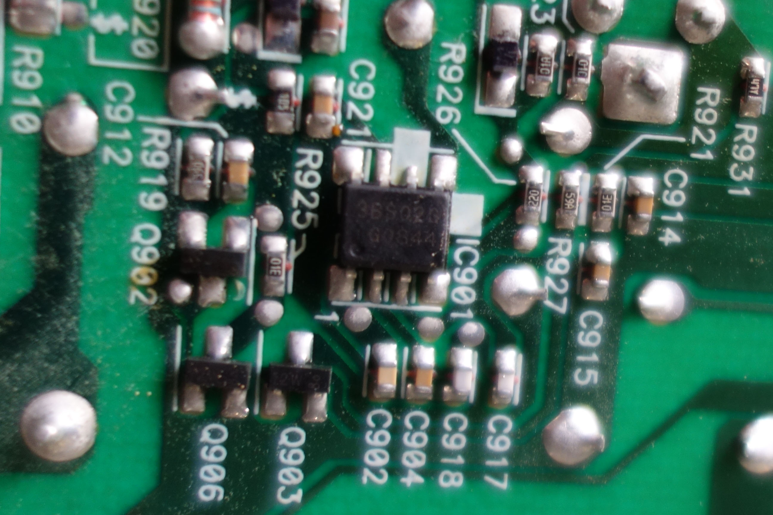

                            I has some fusible 2.2 ohm resistors and put two in parallel. Plugged it in, there was a zap and burning component smell. Checking with a meter they blew again. Main fuse is still good. I will put the FET in my ESR meter but it looks like the IC needs to be replaced as well.
                            • R_J
                              • Jun 2012
                              • 9553
                              I suspect the ic and fet, if the fet shorts or there is leakage drain to gate it can take out the ic as well, If then the ic can turn the fet full on and blow the resistor, You could have just used one of the 2.2Ω resistors, its not that critical.
                              • neilc6
                                • Nov 2015
                                • 1550
                                Pulled the FET and it tests good on my ESR tester. However, the IC show visible damage from when I last plugged in the TV. Need to decide if I want to go with the repair kit or just order the IC (obsolete but available on ebay).
