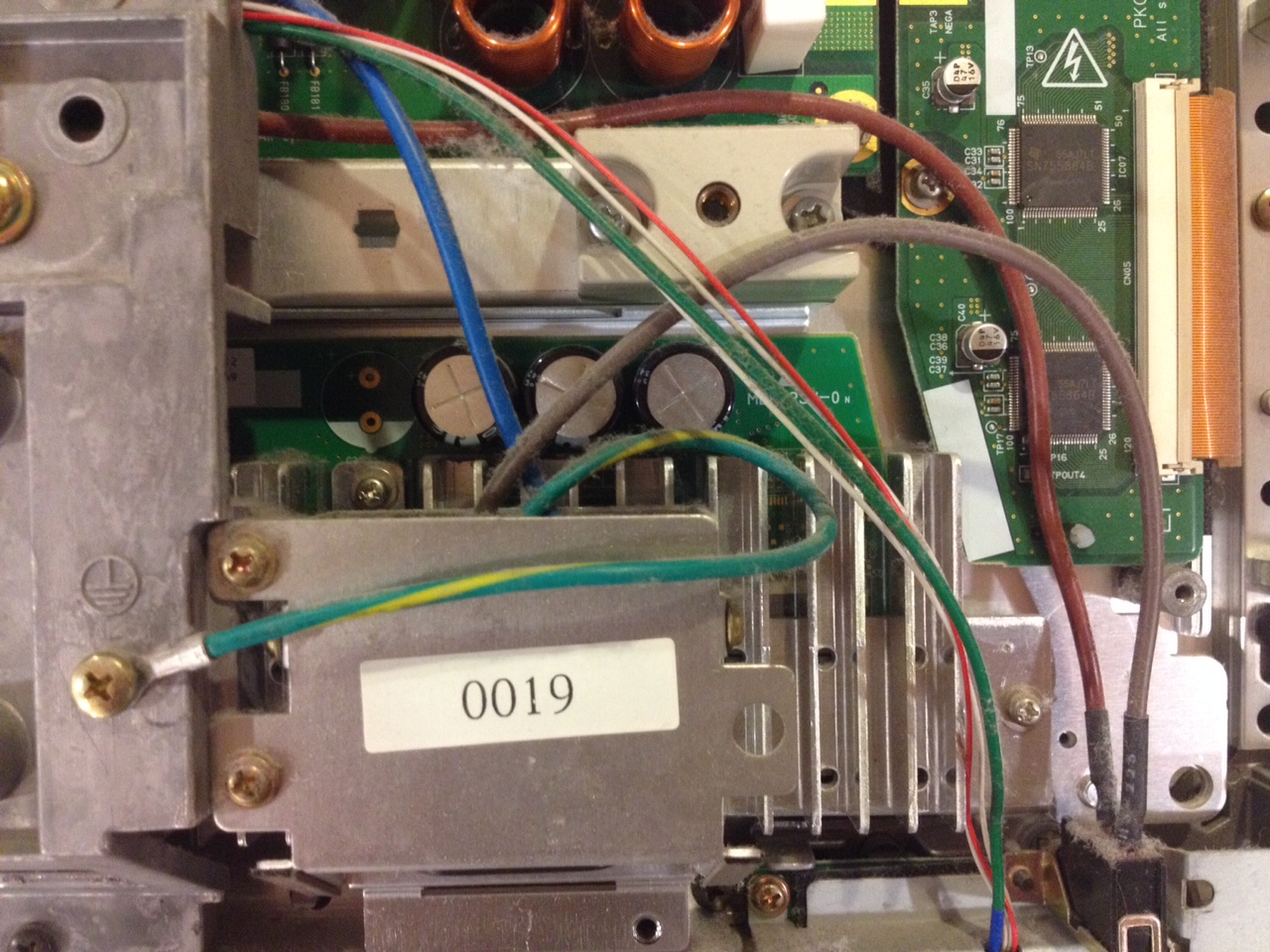

    I found this ancient (2004) Daewoo DTS-42 plasma TV. When I turn the TV on, the status light turns green, the screen is on but black for a few seconds, then it kicks into standby mode and the light turns red.
    Haven't been able to find much info online so I thought I'd try here before I junk it. This TV might be a re-badged NEC and also there is a sticker inside that says Pioneer NP42B3MF01.
    I'm pretty much just looking over the boards for loose solder joints but there is a lot to go over. Any other ideas or pointers?

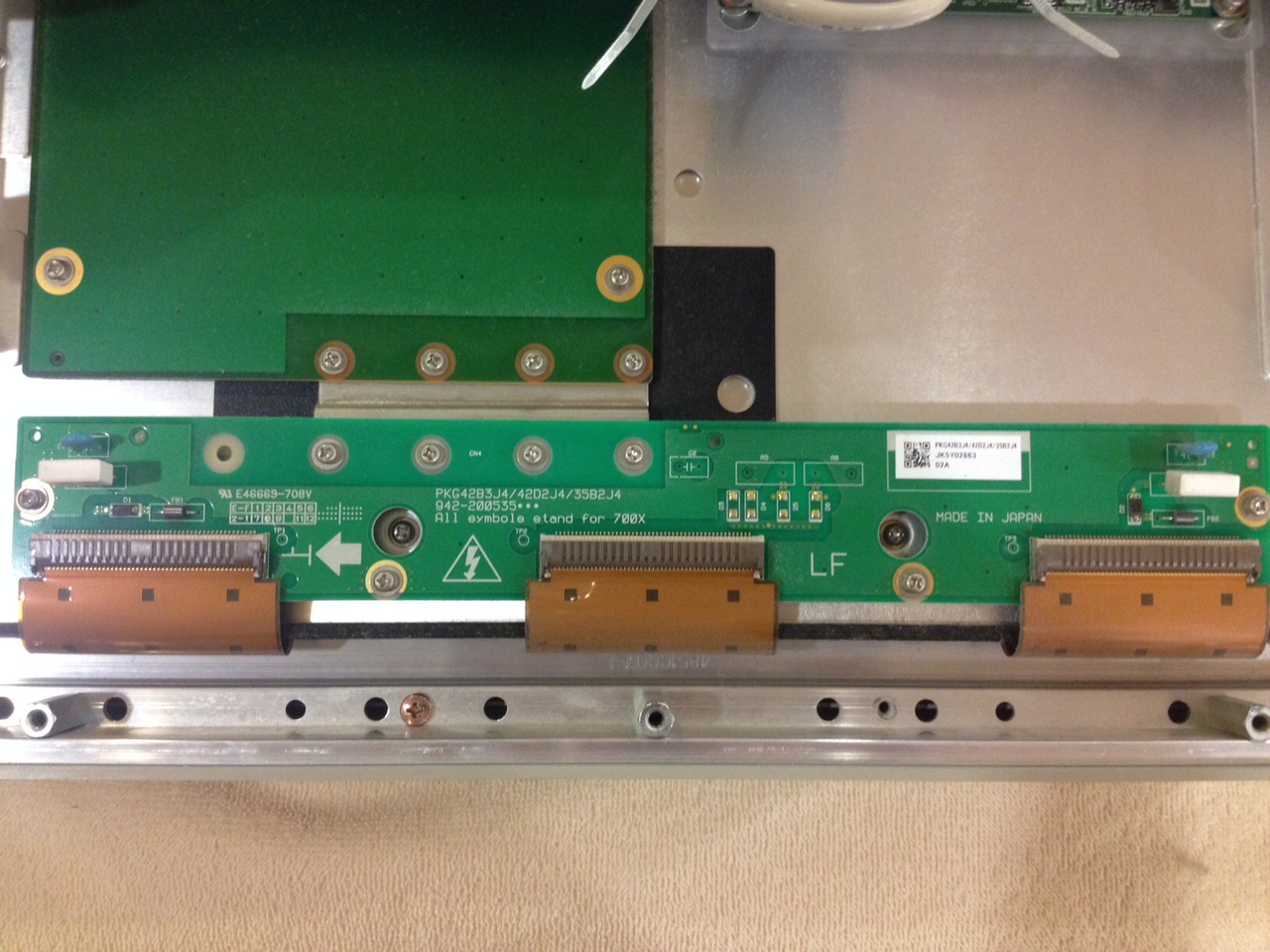

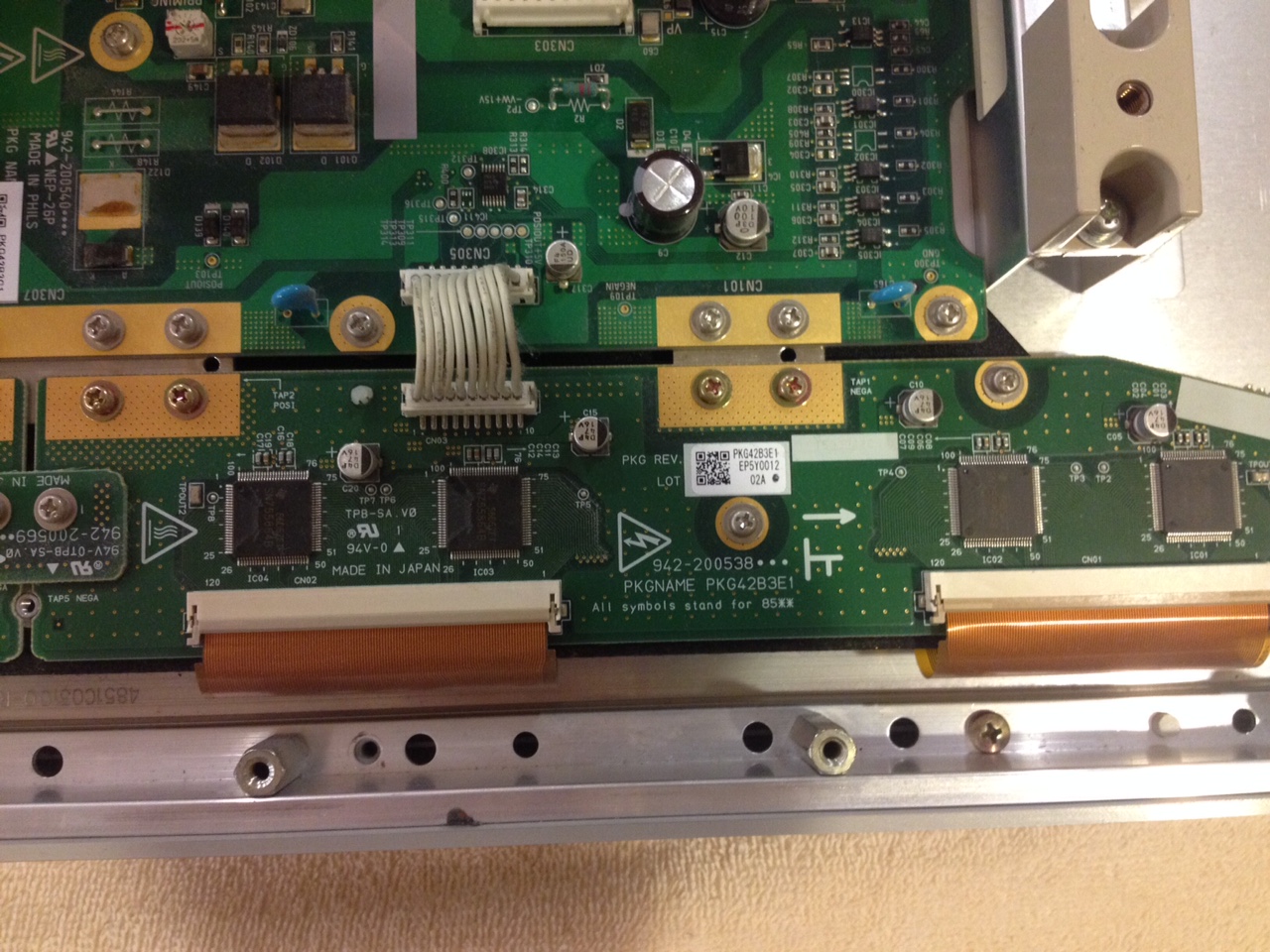

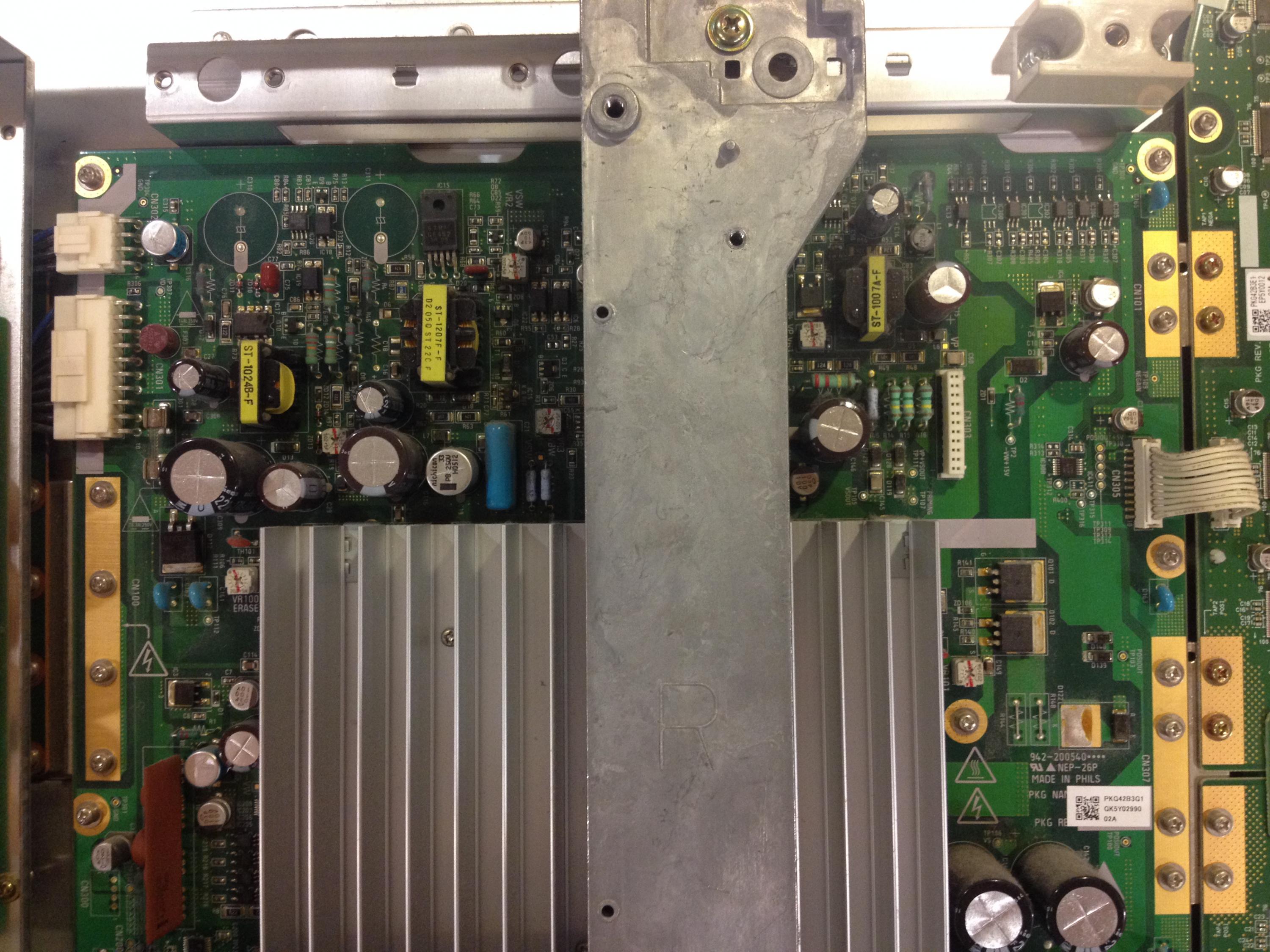

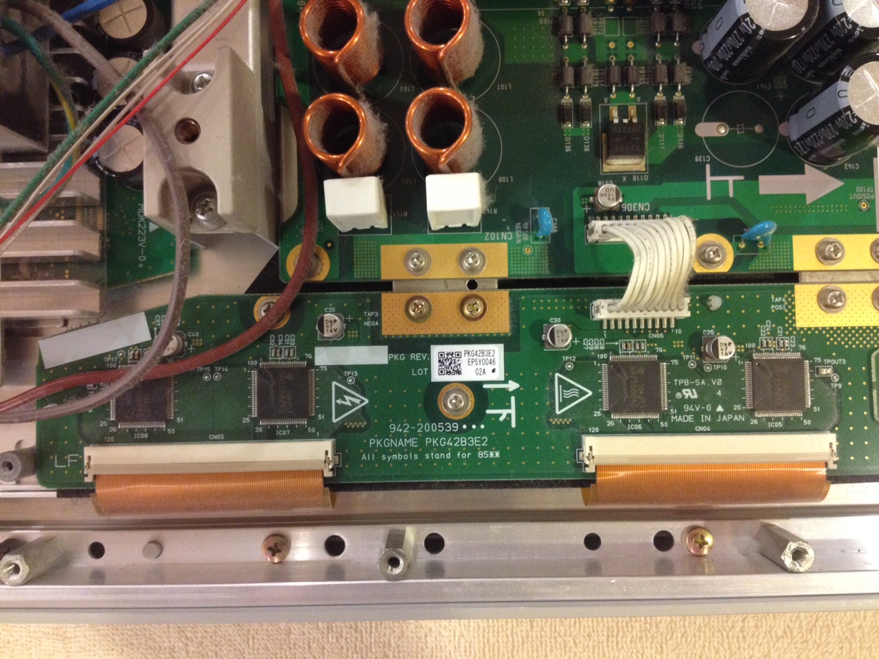

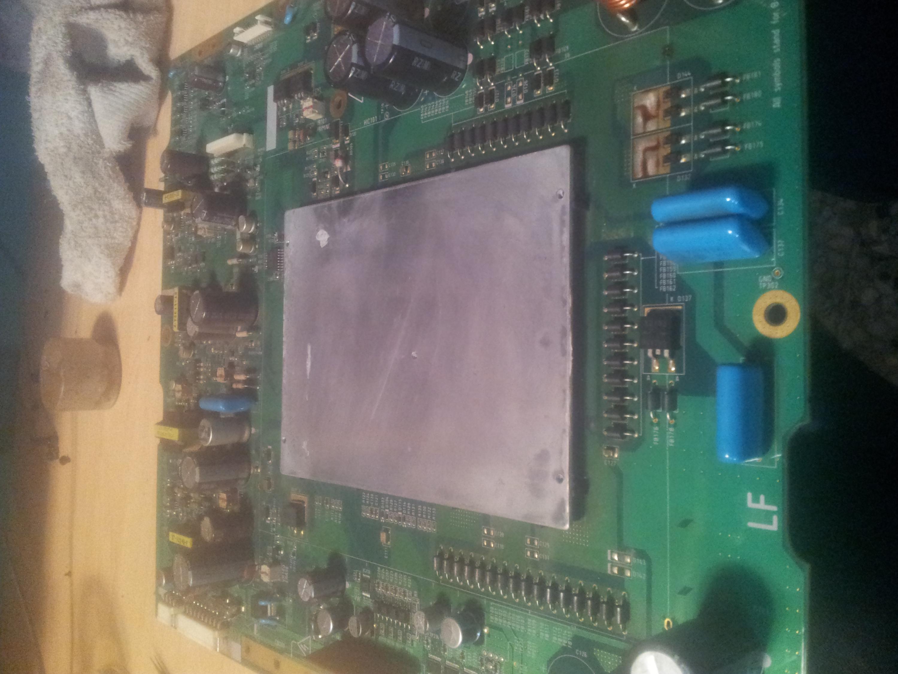

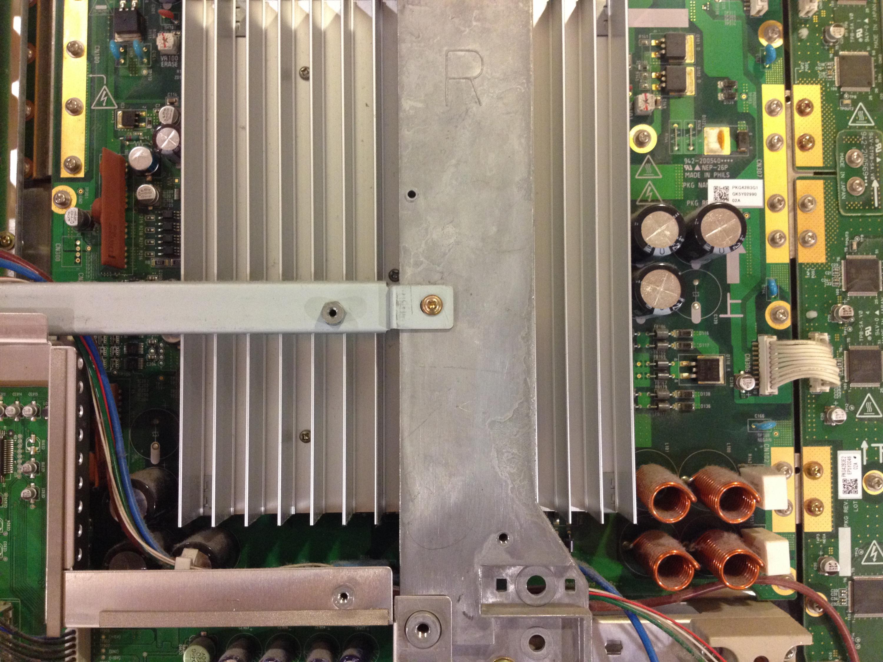

              The sustain boards are the boards that have ribbon cables going to the screen could you take photos of all the boards please.
              • tsm174
                • Apr 2015
                • 23
                Re: Old school Daewoo DTS-42 Plasma clicks to standby after a few seconds

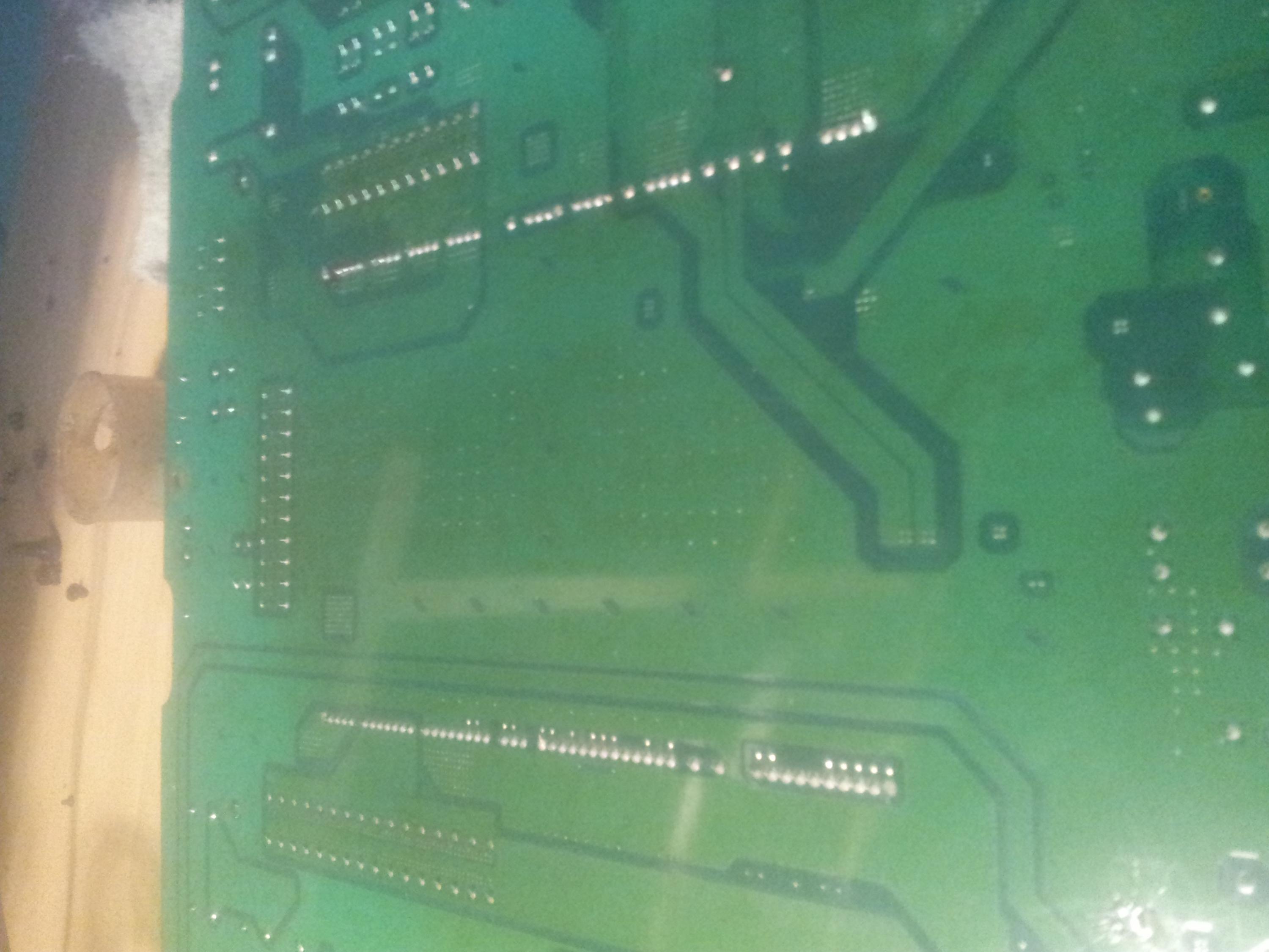

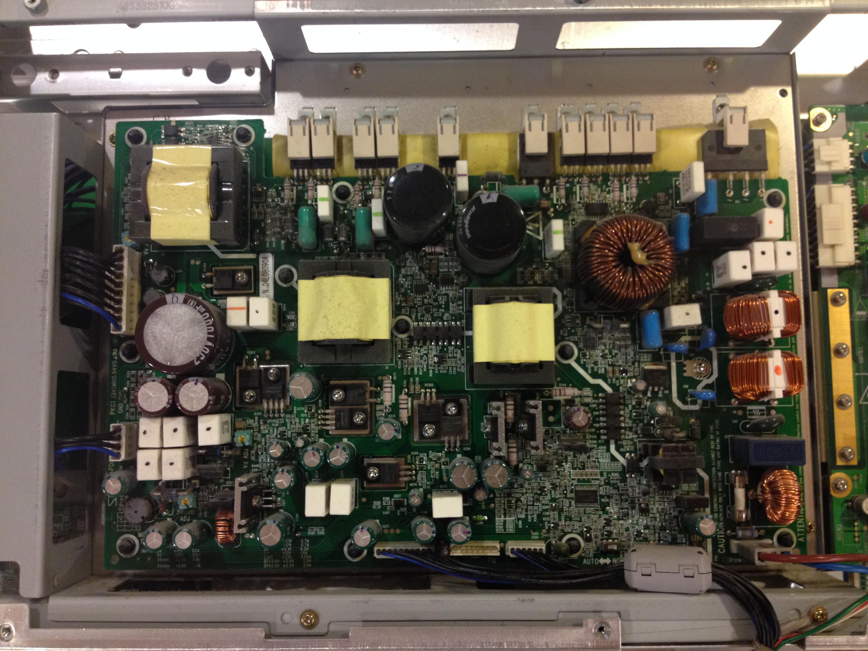

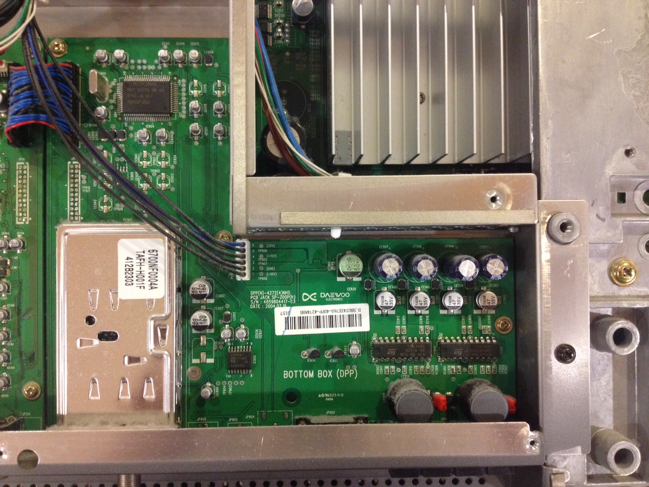

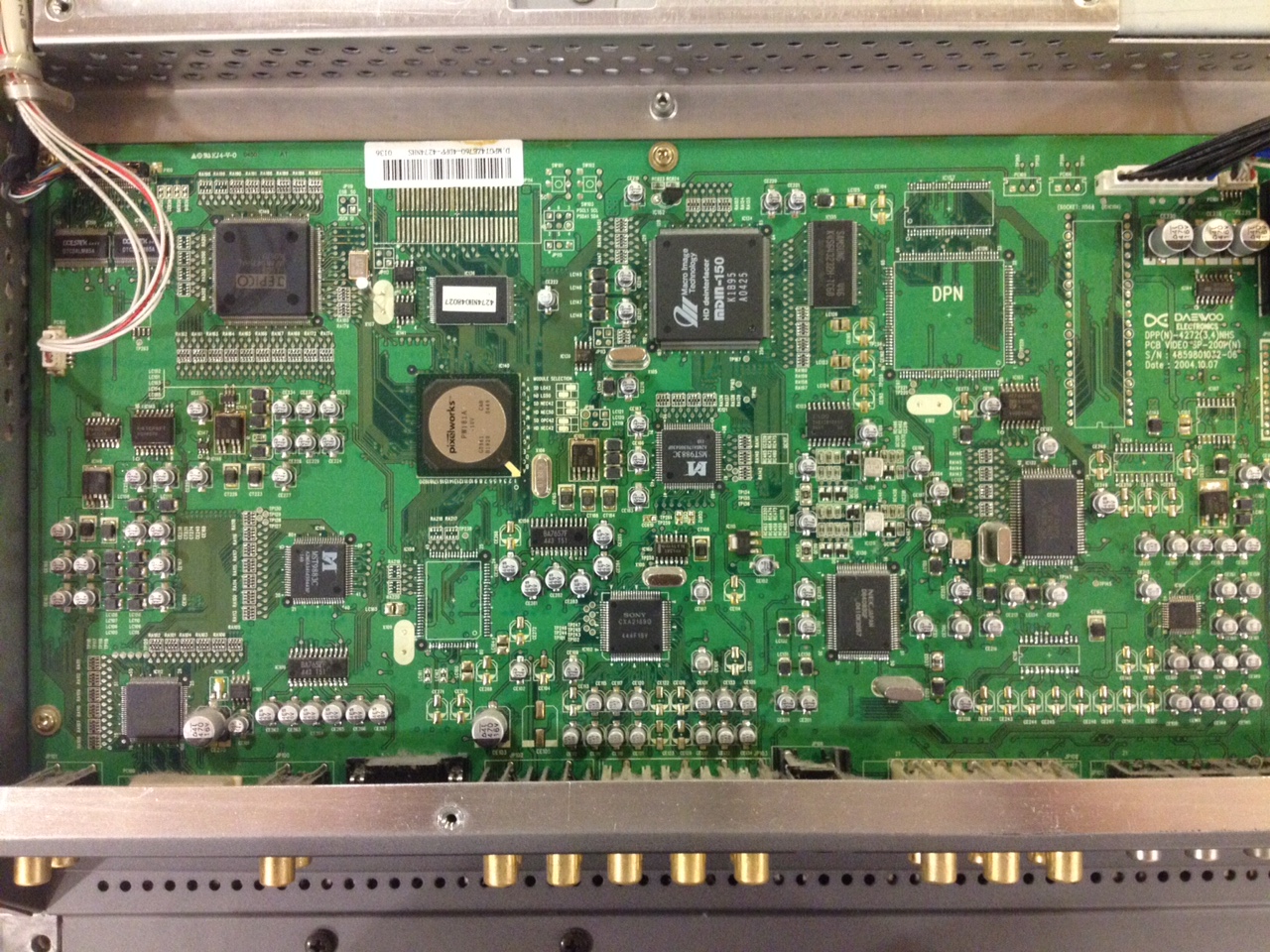

                These boards are huge and some overlap, so here's what I have to start...

                    Checked the Ipm module ? Also have you disconnected one or the other sus board and tested ?
                    • speciess
                      • Aug 2012
                      • 5
                      • spain
                      im on that but they seems the solder used its Sn&Ag so im affraid to desolder that because i can harn some components from igbt.the buffer boards isnt tested because the tv is not in my home...i will do that tommorow
