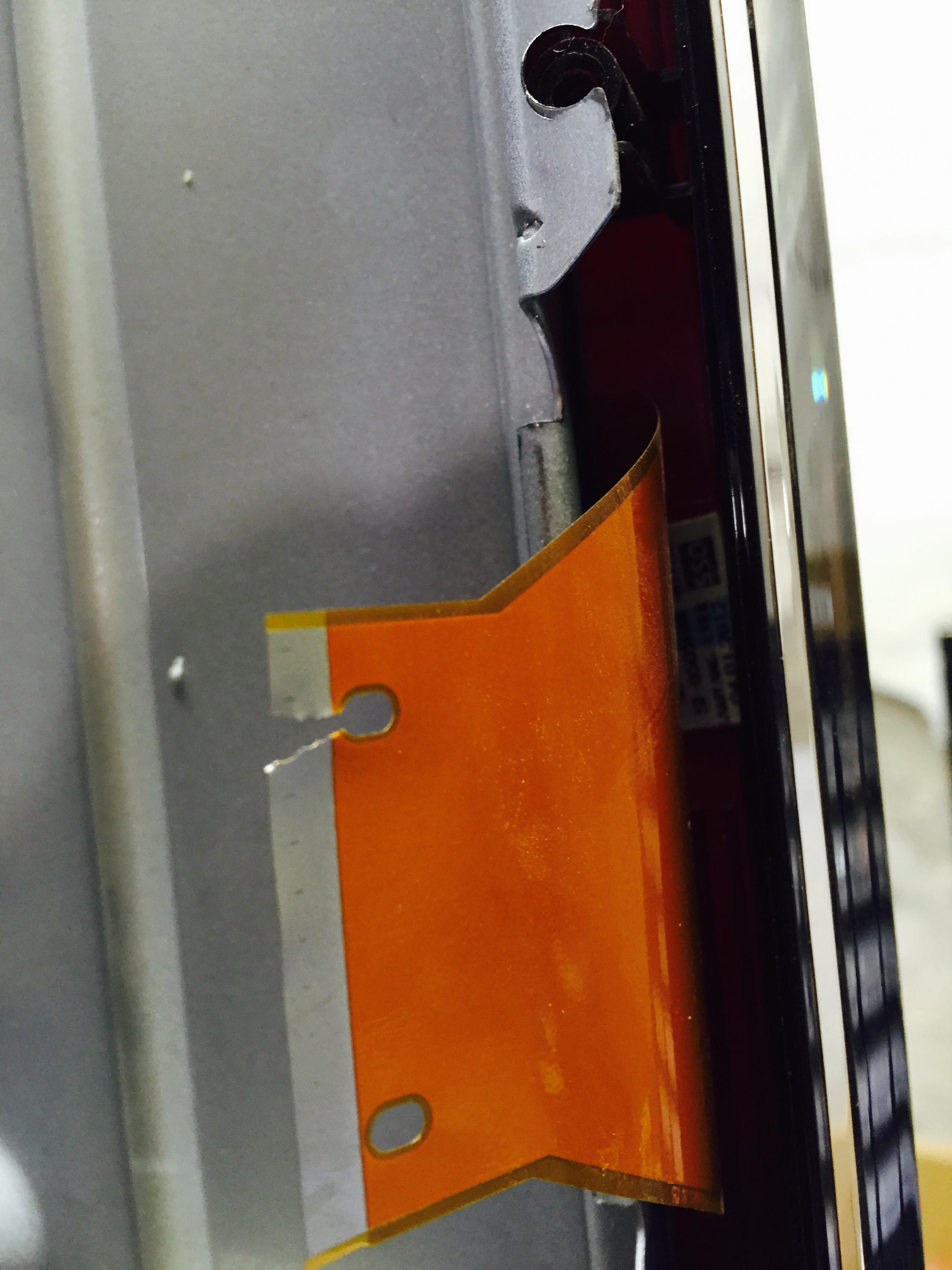

    I found this when removing from a plasma tv. Is this repairable??
    Re: Plasma Ribbon cable damage
    Since it's on the X-main side, probably... all electrodes are connected to one common point, so as long as most of the contact area is intact you should be OK.
      So the cable should be good as is?
        Yes, provided you make sure the cable is seated well.
          Yes, Its a single connection so the split doesn't really matter
