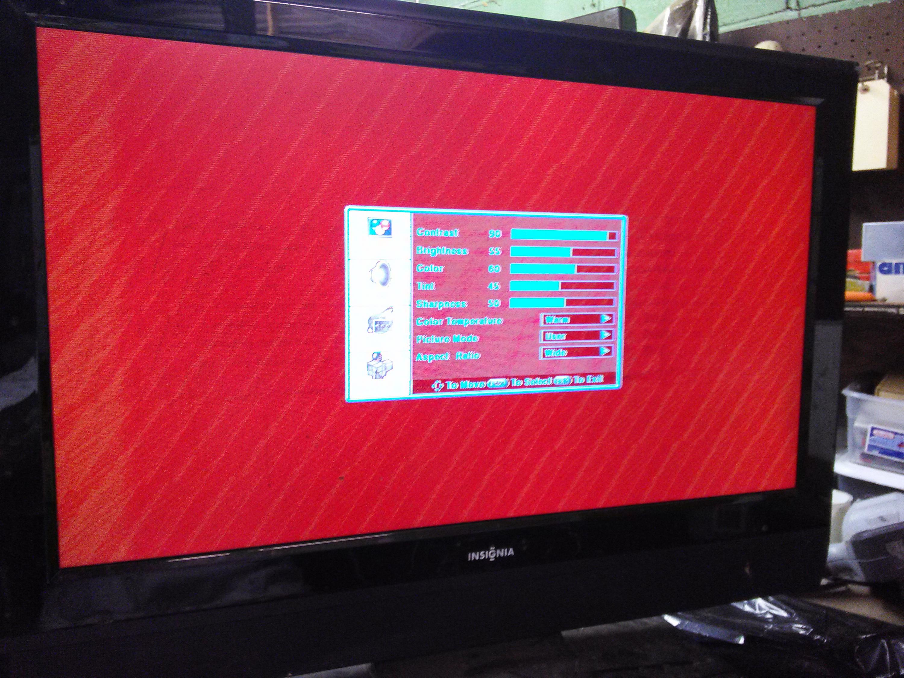

    insignia ns-lcd 32 tcon ?
    just plugged this baby up thinkin proly bad tcon ?

        Re: insignia ns-lcd 32 tcon ?
        Go into the service menu and check if the lvds mode is on if so turn it off, either that or tcon, mobo or lcd screen is bad.
          Recey this is no double post. How do I get into the service menu
            how can I go into the service mode and try this
              try input 2580 (tv is on)
