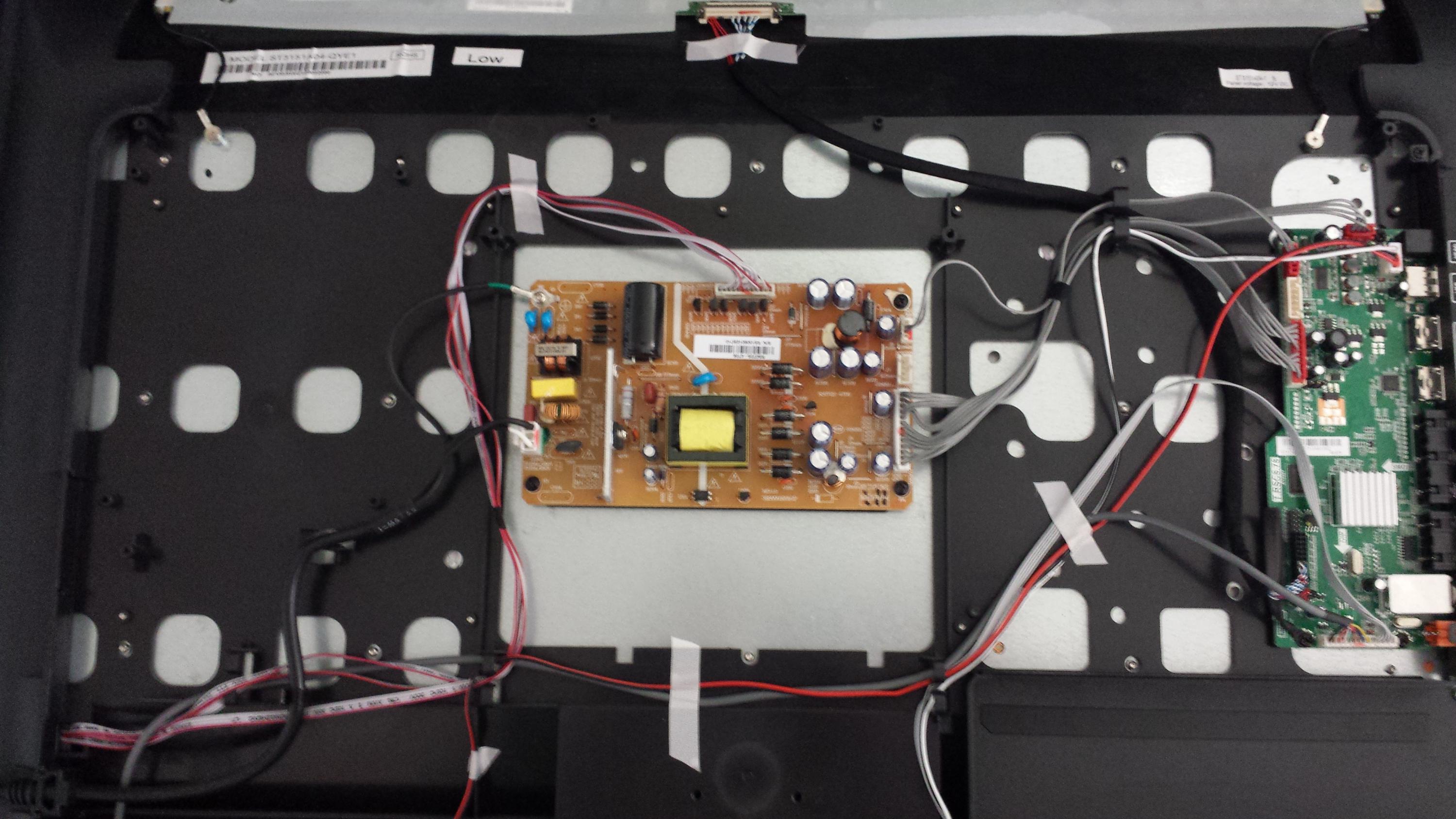

      " just the screen is flashing" Do you mean the backlights are flashing? This TV looks like it has one string LED.
      https://www.badcaps.net/forum/attach...7&d=1430239797
      The connector on the bottom left with two wires are for the backlights LED?
      Pictures of the whole back side of the TV?
      I hope it is not another one with bad LEDs.

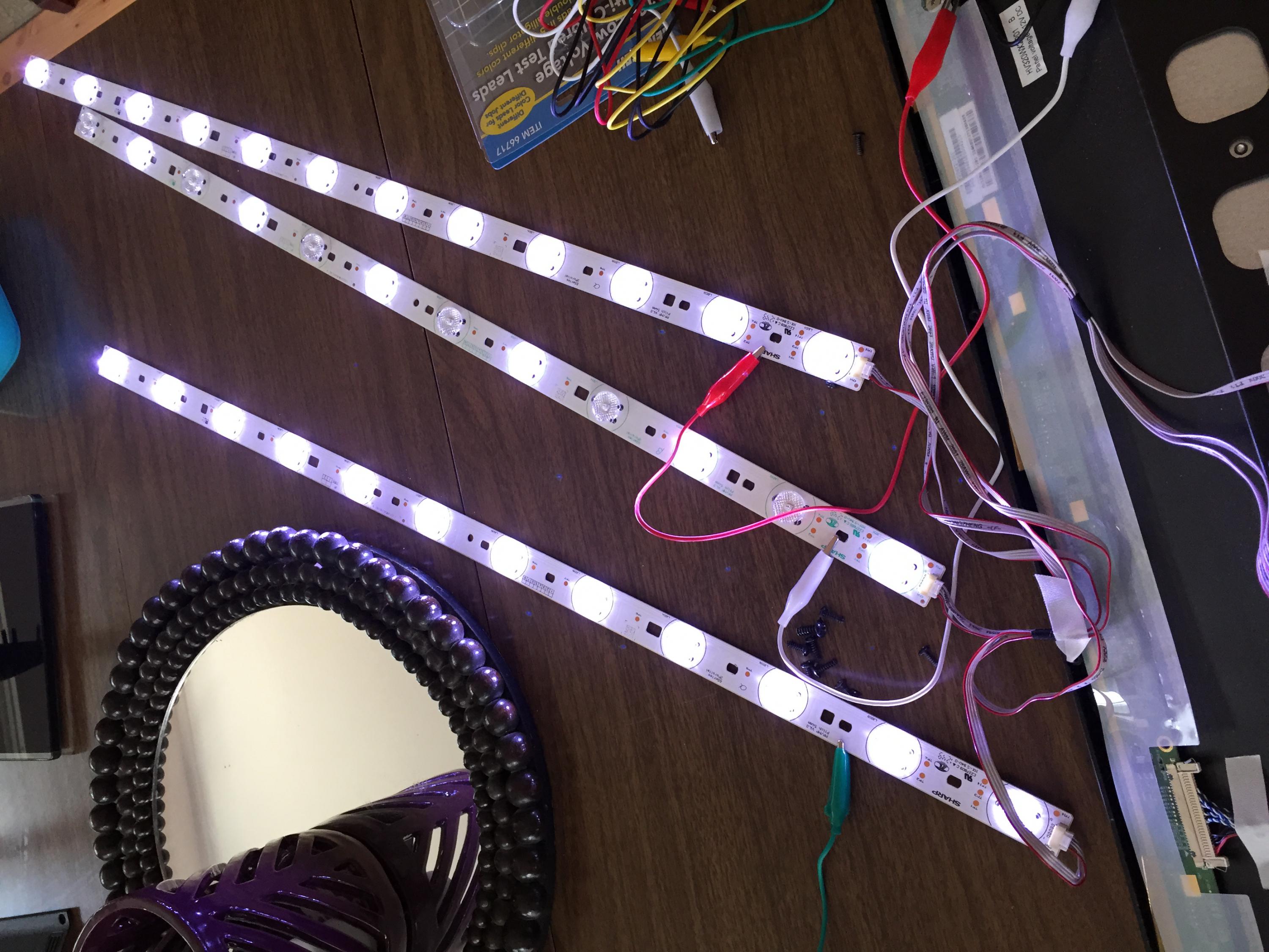

                It's the LED strings inside the panel. One or more of them is faulty. I recently opened a set with a broken screen that had flashing backlights and found one of the three strings had multiple LEDs that weren't lit. It looks like each string of 12 LEDs is actually two parallel strings of six LEDs in series. I have 2 good strings available. PM me if you're interested.

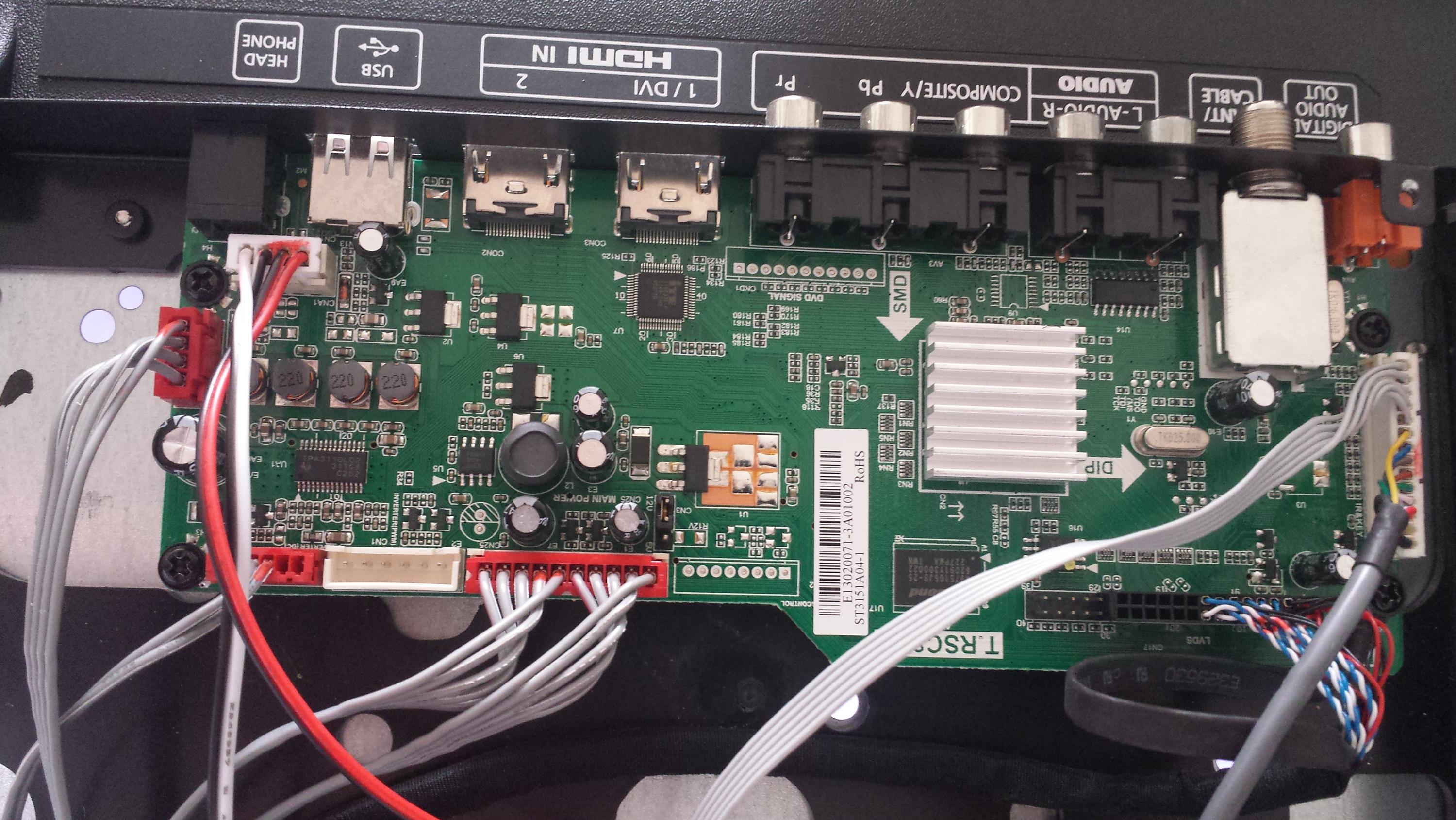

                                    This is the conclusion that I came up with using your (HawwaiianEye & BudM) description. Can you guys verify this please I got 3 of these TV sitting in the closet waiting for repair. Thanks guys.
                                      Re: RCA TV LED32B30RQ Flashing Screen
                                      The one for the ADJ pin is the one that needs to be disconnected, so yes the one you marked in red is the one.
                                      BTW, you need to check those electrolytics caps in that section since the board got very hot as you can see that the board has dark brown around diode D400, they caps may have dried out due to the heat.
