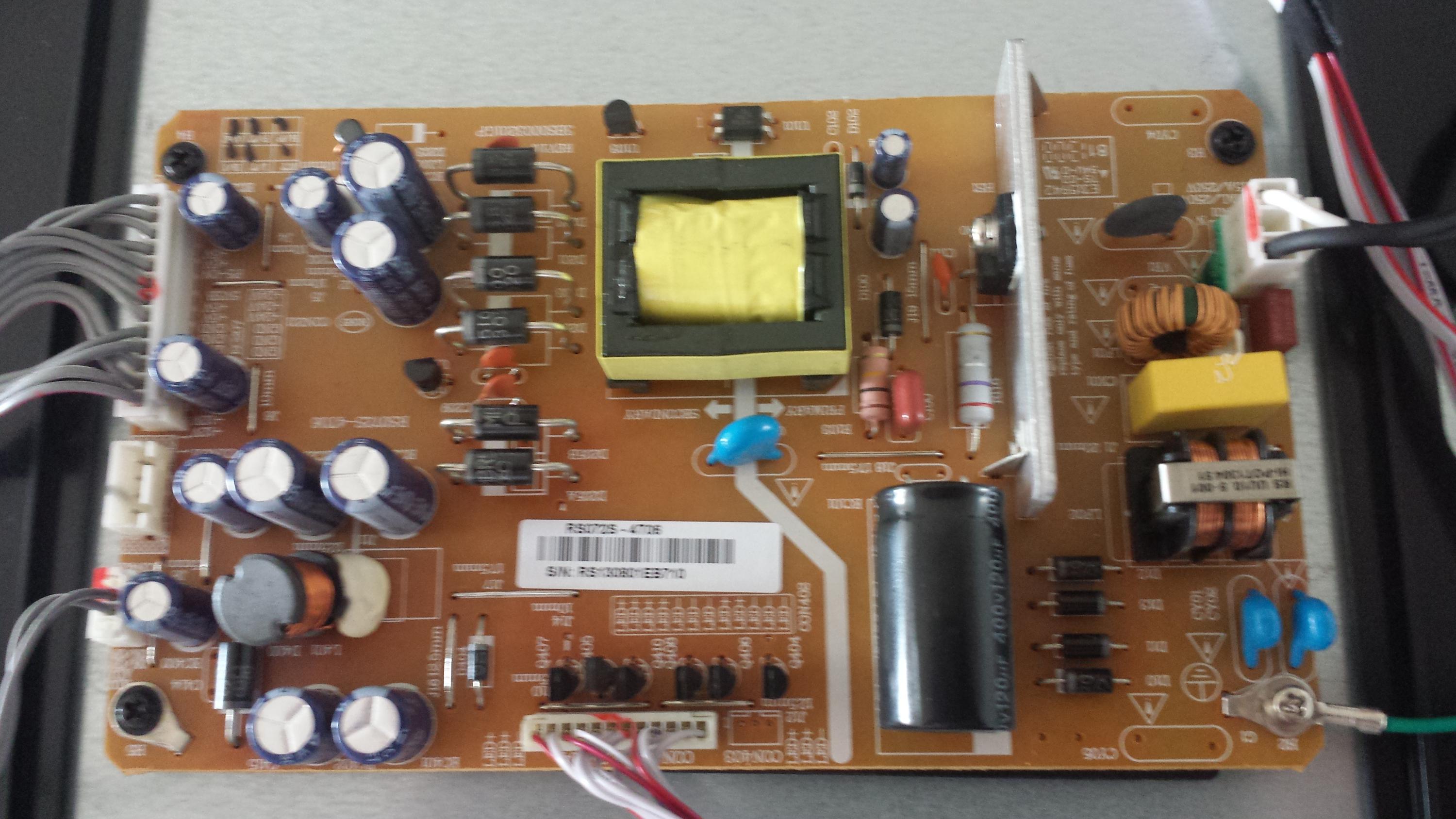

      " just the screen is flashing" Do you mean the backlights are flashing? This TV looks like it has one string LED.
      https://www.badcaps.net/forum/attach...7&d=1430239797
      The connector on the bottom left with two wires are for the backlights LED?
      Pictures of the whole back side of the TV?
      I hope it is not another one with bad LEDs.
      https://www.badcaps.net/forum/showth...042#post557042

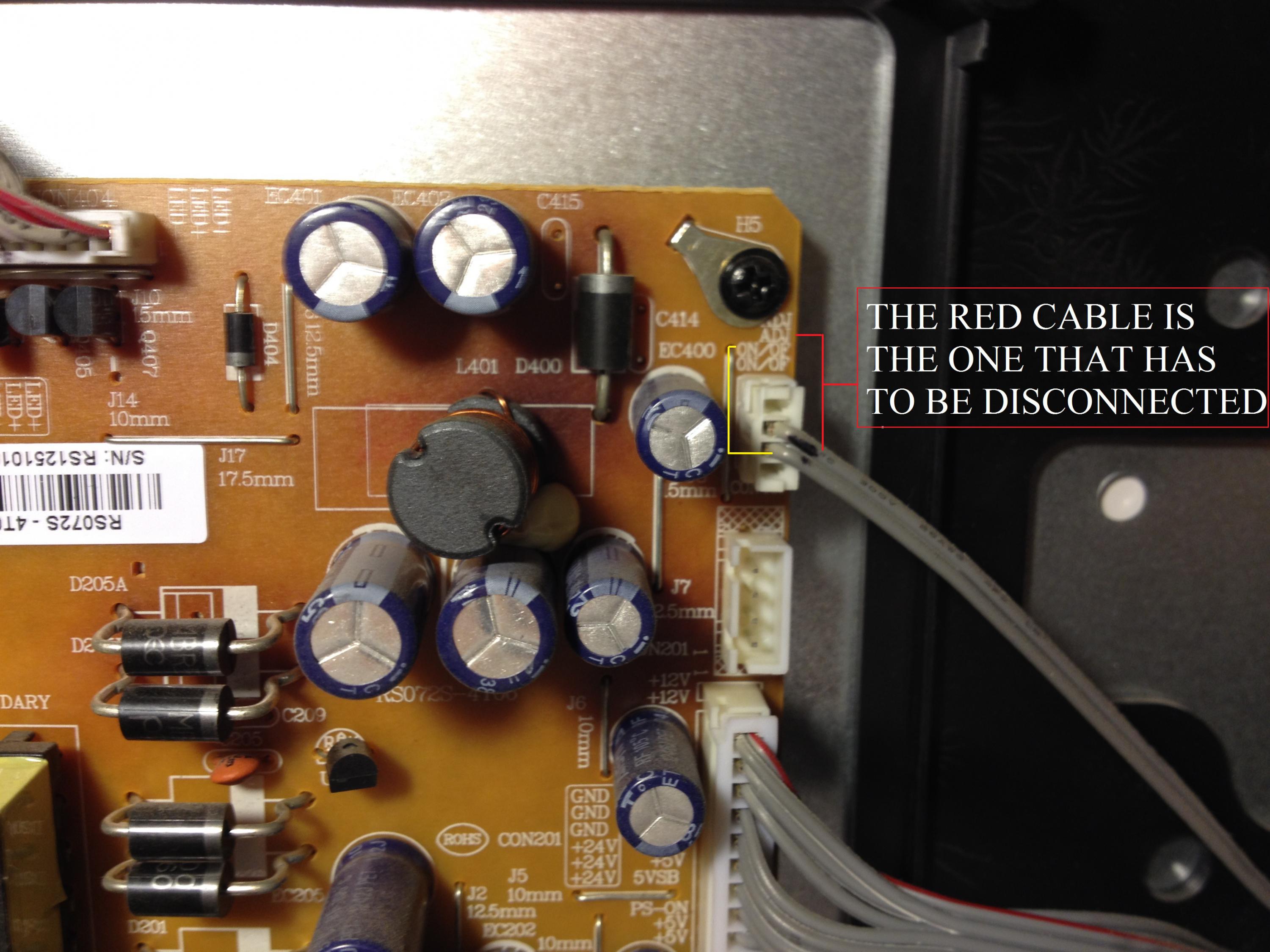

                    Did you look at the dimming control signal? When you do the dummy test, the backlights will be at max output current drive for the LEDs. You can try disconnecting the dimming control line but still have every thing hook back up to see what happen.
                      Re: RCA TV LED32B30RQ Flashing Screen
                      i dont see any pin that says dimm (but i have seen it on other boards)
                      there are only 2 pins that seem to control the backlight. on/off and something called adj.
                      on/off is 0 when off and ~5v when on
                      adj is 1.41v when everything is connected normally and the backlight flickers
                      adj is .59v when under dummy test and backlight is stable.
                      is adj the same as dimm or am i looking at the wrong thing?
                        holy cow, budm... youre a genius! again!
                        i guess adj is the same as dimm cause i pulled that one wire and now the backlight is stable and picture looks great.
                        what is that thing even doing? does this mean i wont be able to change brightness settings in the menu?
                        what if any are the consequences of running a tv like this for long term?
                        thanks for the tip!
                          The DIM/ADJ signal is from the main board, I do not know if it uses PWM or Analog dimming, What you can do is to hook it back up and adjust the backlights level to see if you can set it to 0.59V. I expect the higher the Voltage = the higher backlights level, it seems to me the LEDs are failing so at high backlights level (more current flowing through the LEDs, more heat generated) they start flickering.
                          Most TV these days have Backlights level setting and the Brightness setting which are not the same. You always want to run the backlights level as low as you can to extend the LEDs life. So if 0.59V is for less backlight level then it will be OK to leave that wire off.

                                    This is the conclusion that I came up with using your (HawwaiianEye & BudM) description. Can you guys verify this please I got 3 of these TV sitting in the closet waiting for repair. Thanks guys.
                                      The one for the ADJ pin is the one that needs to be disconnected, so yes the one you marked in red is the one.
                                      BTW, you need to check those electrolytics caps in that section since the board got very hot as you can see that the board has dark brown around diode D400, they caps may have dried out due to the heat.
                                        I will get those checked but, holy crap all my three of my tvs are up and running!!!! Millions of thanks I was about to replace them now that they put them on sale this time of the year.
