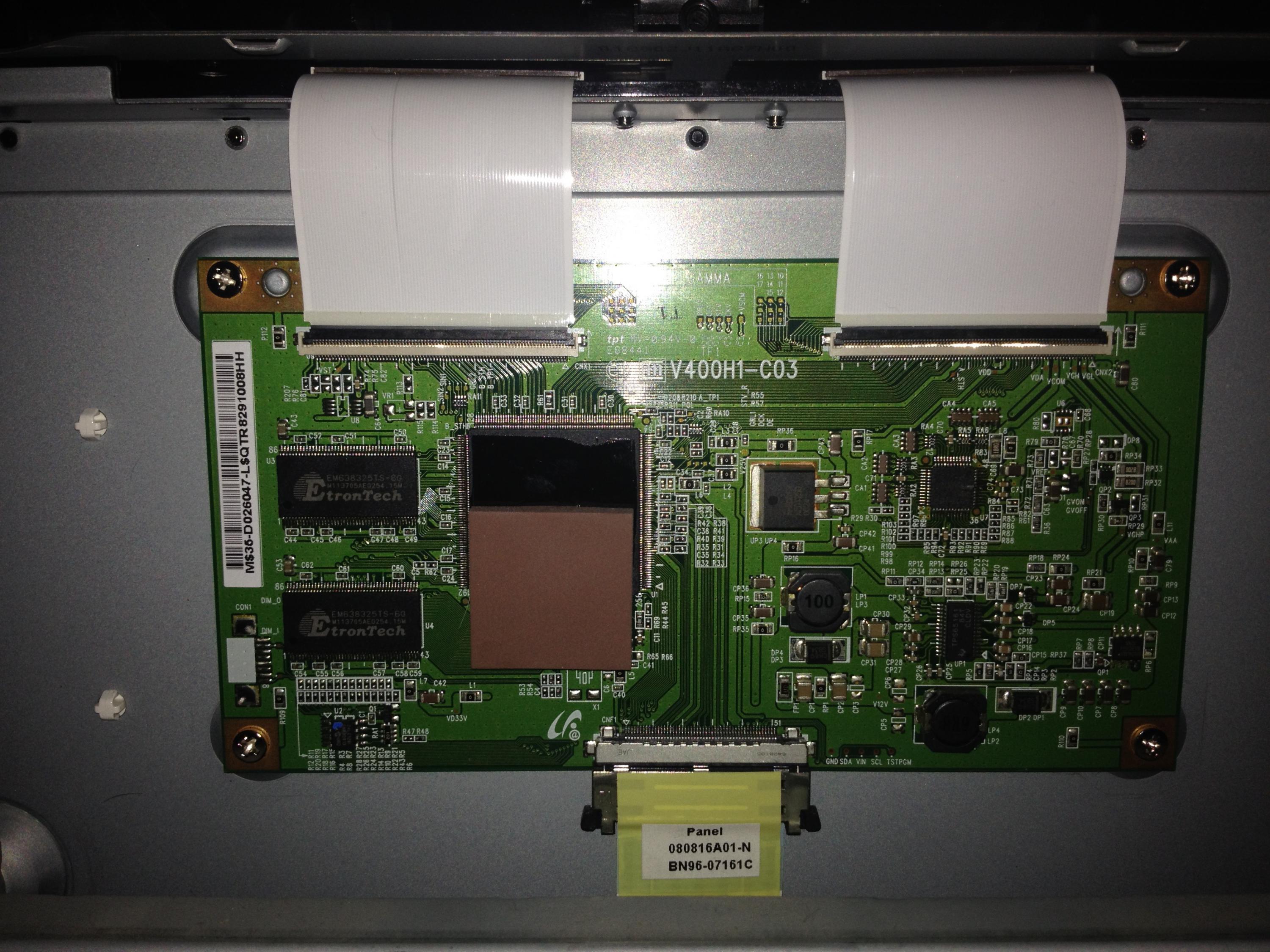

    My TV is a solid black (but lit) screen, all inputs, all the time.
    I picked up this TV yesterday from someone that said "the colors are all messed up". The picture was really badly solarized. I found a youtube video which referenced a service menu option called DDR but I never found that option in the service menu. Tried a factory reset and no change (still solarized). Then, I unplugged the cables connecting to the tcon board and cleaned them with contact cleaner and replaced them. When I replaced the two cables at the top of the board, I didn't have one in quite all the way. The screen started turning completely white, then I got some smoke from the card, and I think the foam pad on the back of the biggest chip slid down (like the adhesive melted or something). I think I unplugged and re-plugged those two cables again, and now the display is completely black.
    So, my best guess is that I've fried something on the tcon board but I don't want to throw $50 at it without knowing if there's any hope for the success. Can anyone help me do a bit more diagnostics?
    I'll try to add a pic here in a minute.

      Solarized... Bet its an AS15 tcon.
      Can you give us a really detailed picture of the tcon please?
      If it is indeed an AS15 tcon then that would of been the cause of the initial fault. You could replace the tcon which would of sorted out the initial problem but you will be hoping you didn't cause any further damage. I have misaligned ribbons before and smoked an AS15 as you probably have and did not damage anything else.

      • tsm174
        • Apr 2015
        • 23
        Re: Samsung LCD LN40A500T1F solarized then black screen
        Here's the best pic I have at the moment.

          That's good enough for me to tell you the Gamma IC was faulty on your tcon which led to the solarized colours.
          Could of changed the Gamma IC on its own (Little fiddly especially if not got a lot of soldering experience with fine pitch) but as you smoked the board I would just replace it. Chances are you won't have damaged anything else.
          Good Luck
              Thanks for your input. So I can learn a little bit here, can you explain what you're seeing that tells you the Gamma IC was faulty?
              Looks like I'll be getting a new tcon and crossing my fingers.

                  I went ahead an got a new tcon, going to install it tonight. Anything I should be looking at before installing the new tcon?
                    Hey sorry for not answering previously.
                    As far as knowing it was the Gamma IC... Experience of seeing it plenty of times before and repairing Tcons.
                    Just make sure you get the cables in right this time and make sure they are clean of any carbon from shorting before. All you can do is plug it in and hope!
                    • tsm174
                      • Apr 2015
                      • 23
                      Popped in the new tcon and good as new! Thanks all.
