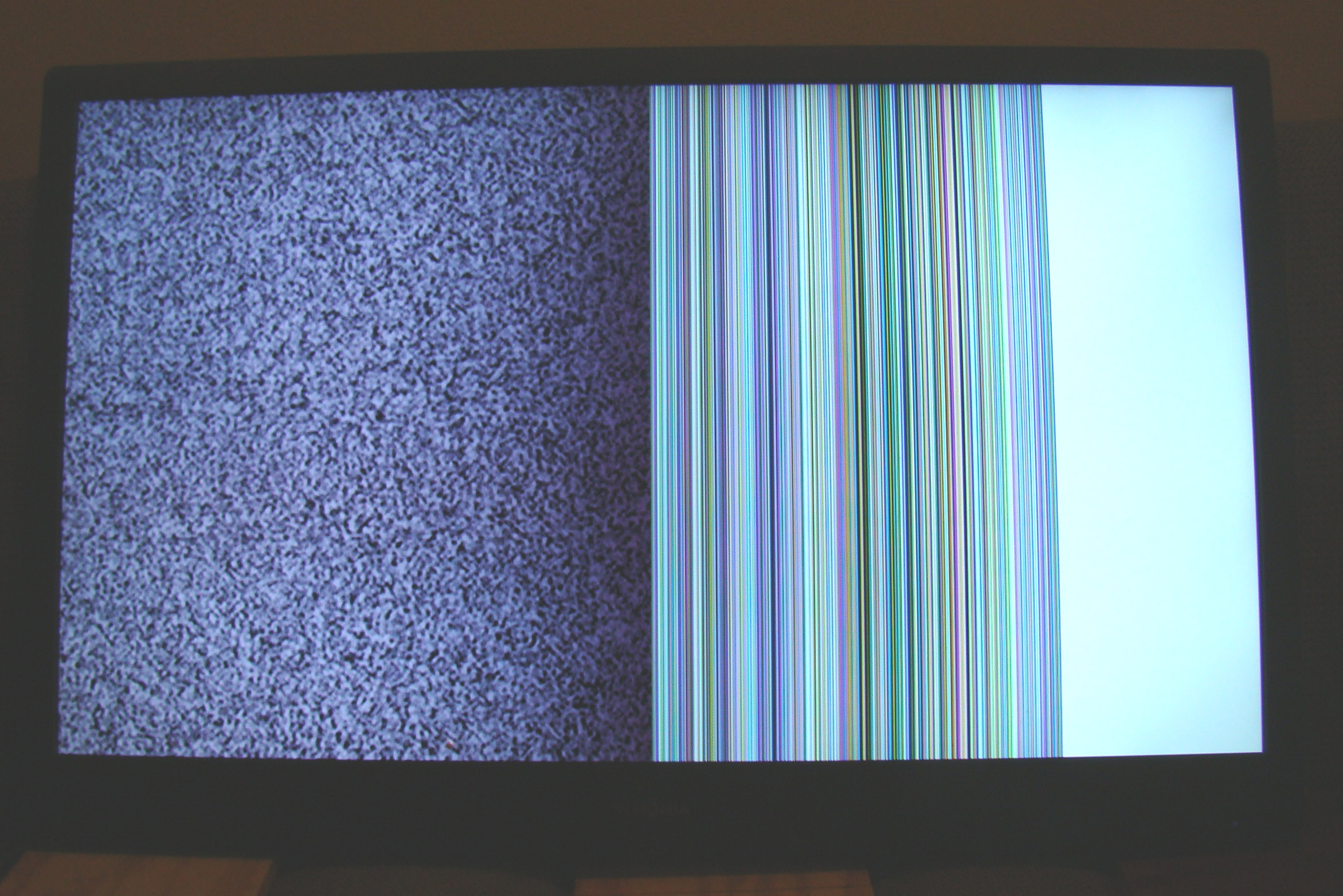

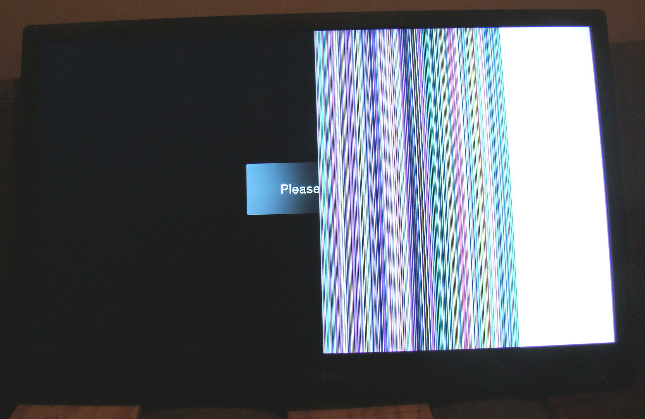

    I came home from work yesterday turned on my set and it showed up with half of the screen no signal snow from cable input (default start input) and half the screen with lines vertical I think this is t-con problem has anyone seen a pattern like this and do you agree or disagree that the repair path should start with t-con or with main board this set also has led address board if this is relevant I am inserting two pics first is prestart image then second is where it stays after start can someone share their opinion thanks Guys any advice would be greatly appreciated

    I would say the LCD Panel Itself is stuffed. You may get lucky and try the tab-bonds applying light pressure etc then wedge them Usually a complete half no picture with lines like that is the panel itself though....

      Don't take my word for it, but doesn't that look like figure 4 of the https://www.badcaps.net/forum/attach...0&d=1359336307 That's the second document from here: https://www.badcaps.net/forum/showpo...4&postcount=12
      I also always have problems identifying problem sources for picture problems.
      Just my two cents.

        I am going to say Panel myself too, Reason for this is the shadow that passes just over onto the good side of the image.... The loss of tcon signal or corrupt signal at the halfway mark seldom effects the working side.
        Check those cables anyway and also the bonds
          Re: insignia ns 42e760a12 half snow and verticals
          The fading towards the middle also indicates a panel problem of some kind to me.
          edit: Newtothis beat me...
